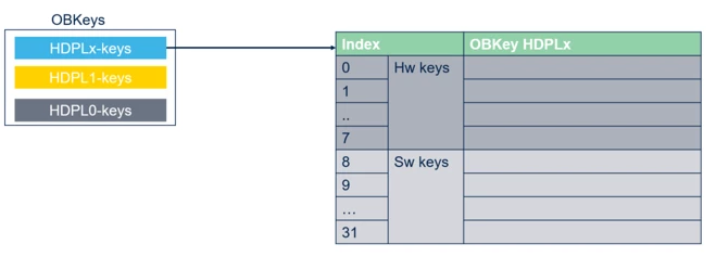

1.1 OBKeys
Only supported on the STM32H5 and STM32H7R/S families.
This is a dedicated nonvolatile memory used to store keys for secure storage and cryptographic usage.
HDPL (HDP level) domains organize the storage. Each domain has its own secure storage area and its own access rules. Access control is enforced with SBS (system configuration, boot, and security block control). The access control depends on the STM32 family (H5 or H7R/S). For more information about SBS, refer to Annex.
  • Data can be provisioned securely (using the RSS function RSSLib->DataProvisioning()).
  • Data is isolated, only authorized parts of the system can access it.
  • Protects against anti-rollback attacks and anti-cloning.
  • Data cannot be extracted from the system or reused.
The OBKeys store two types of keys:
  • Application hardware keys (AHK) also referred to hardware keys: these keys are indexed from 0 to 7. They are not accessible to the user and are injected directly into the SAES engine. These keys can be STiRoT keys or Memory Cipher Engine (MCE) keys (for external memory encryption). The SAES accesses these keys through a special bus.
  • Software keys: Indexed from 8 to 31, related to the user application, accessed by software (read/write), and can be provisioned (bootloader keys, etc.).
The features of OBKeys are as follows:
  • Controls access via HDPL level
  • Crypto isolation: keys can be stored encrypted using DHUK or AHK
  • Provides anti-rollback and anti-replay via EPOCH
  • An HDPL level can access its current OBKey area and the next one in level (N and N+1).

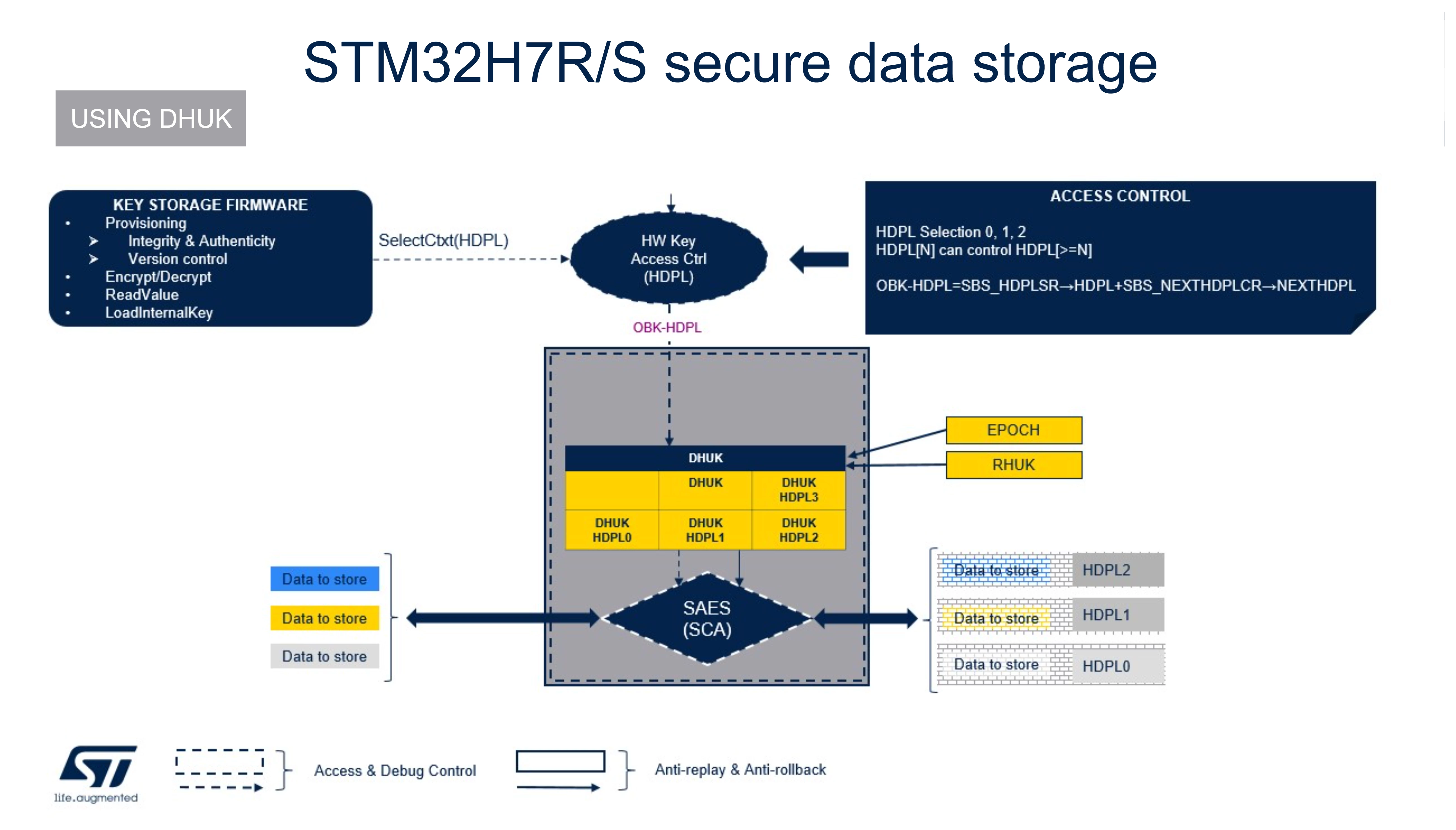

1.3 Secure storage for H7S/R
Three OBKey areas, one for each HDP level (0, 1, 2), up to 1 KB. Below is an overview of the secure storage areas and their attributes:
  • HDPL0: permanently allocated to STMicroelectronics and never erased.
  • HDPL1: designated for initial Root of Trust (iRoT) keys, erasable through regression.
  • HDPL2: for user application or if used the updatable root of trust (uRoT).

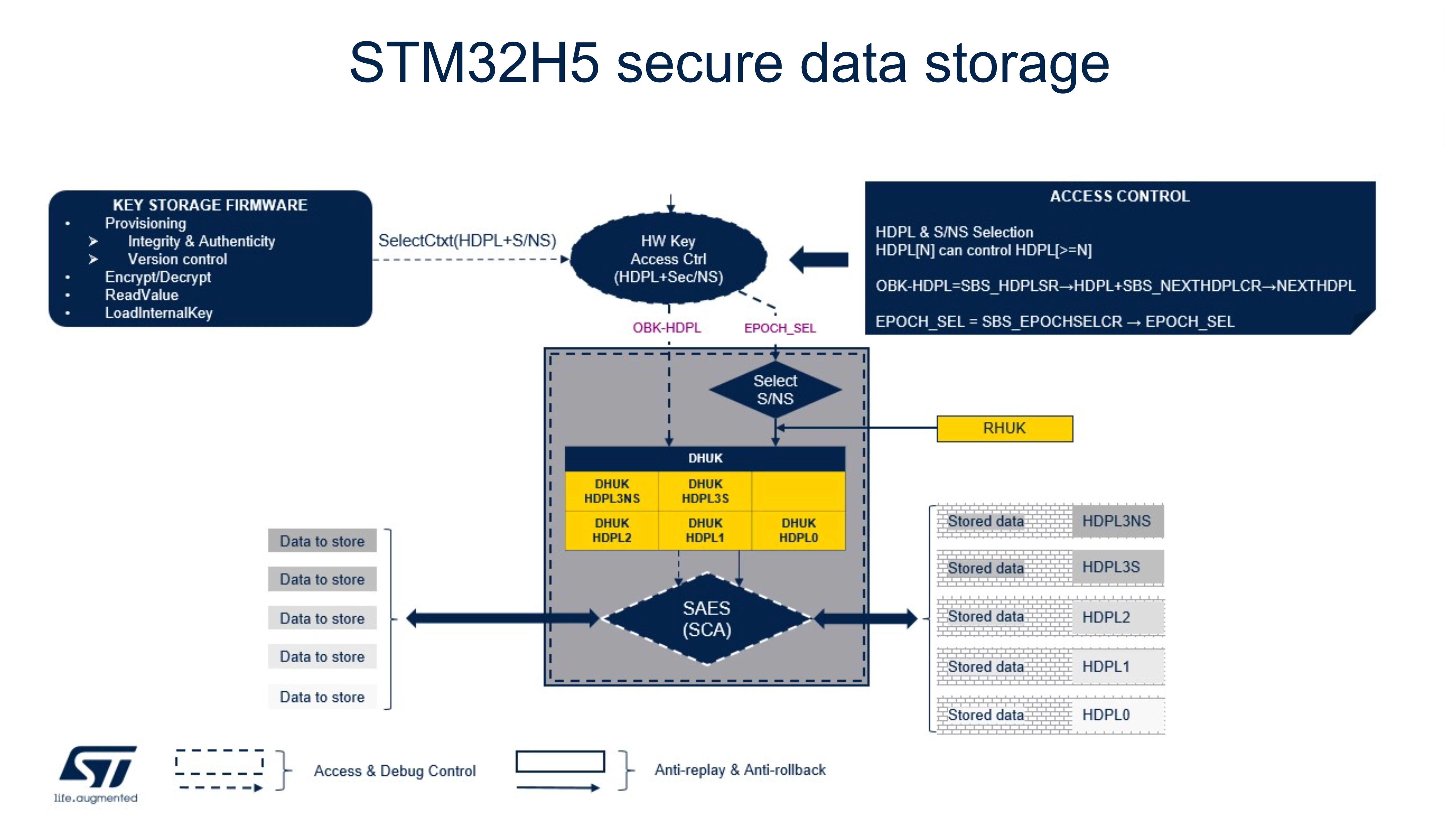

1.4 Secure storage for H5
  • HDPL2: for secondary Root of Trust (uRoT), Operating System (OS), or secure applications, also erasable through regression.
  • HDPL3S: reserved for secure application keys, subject to erasure via regression.
  • HDPL3NS: allocated for nonsecure application keys, erasable through nonsecure regression (NS regression).
The picture below demonstrates the usage of OBKeys:
  1. The key storage firmware selects the current context. This context includes HDPL and the secure or non-secure state. It then passes this information to the hardware key access control unit.
  2. The unit selects the OBK-HDPL and EPOCH according to the current HDPL context and SBS registers. The application sets the EPOCH_SEL.
  3. OBK-HDPL selects the area of secure storage of the flash memory and selects the corresponding DHUK in SAES.
  4. It checks whether the requested domain is accessible. If no violation is detected, the data are encrypted using DHUK.

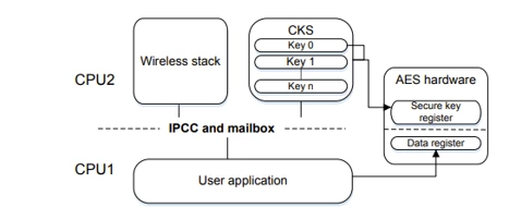

1.6 Customer secure storage (CKS)
This is a solution only available on STM32WB.
The STM32WB has two CPUs: CPU 1 (Cortex®-M4), dedicated to the user application, and CPU 2 (Cortex®-M0+), dedicated to the network stack.
CKS is a secure storage solution, accessible only by CPU 2.
It is a whole mechanism that involves a secure area to store provisioned keys, a mechanism to enable the AES peripheral to access these keys securely without exposing them, and a way to provide the result to the user. CPU 2 manages all of this in full isolation from CPU 1 running the user application.

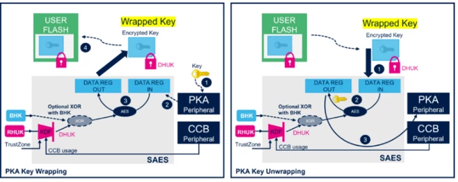

In normal mode, the CPU loads the key into the SAES write-only register; the key cannot be read back afterward.
For key management, SAES supports key derivation. It manages the DHUK through a key derivation function, which is later used for key wrapping and unwrapping.
The DHUK is not exposed, and it is generated when needed. The derivation of the DHUK depends on the STM32 family. However, it generally takes the RHUK and the HDPL level context as inputs.
The key wrapping and unwrapping operation are a key protection mechanism; it serves as a key isolation mechanism. Keys should not be stored in clear text. For symmetric keys, SAES is used for key wrapping/unwrapping. For asymmetric cryptography, PKA and CCB are used alongside SAES; this is explored further in a later section.
The key wrapping process:
  • Select the hardware secret key (DUHK or DUH XOR BHUK)
  • Provide the key to encrypt
  • Perform the wrapping operation (encryption; the user can select the wrapping according to the mode, such as chaining or counter mode)
  • Save in a flash
For the unwrapping process:
  • Write the wrapped encrypted key into the data register
  • Decrypt the key in SAES and put it into the write-only key register
  • The application uses the key as needed
While SAES is designed for secure key handling, it is not optimized for high-throughput encryption. The standard CRYP/AES peripheral provides faster cryptographic acceleration for bulk data, but it cannot protect keys the way SAES does. To get both SAES's key protection and CRYP/AES's speed, SAES provides a key-sharing mechanism: it lets the application select a key already held in secure storage and share it with CRYP/AES for fast processing, without ever exposing the key in plaintext to the application.
Key sharing works in two steps:
  1. SAES decrypts (unwraps) the protected key internally.
  2. SAES transfers the unwrapped key directly into CRYP/AES's key register, a hardware-to-hardware path the application code never has visibility into.
The key is never exposed through software or become readable by the application.

2.3 Private key protection, wrapping and unwrapping
The key in clear text is provided to the PKA, by writing to the PKA memory. The CCB is responsible for sending the key to the SAES data input register.
The key derivation function inside the SAES received an additional parameter specifying CCB usage.
The key wrapping/unwrapping operation uses the AES-GCM encryption algorithm with Galois/counter mode. This is used to achieve authenticated encryption.
The picture below explains the wrapping and unwrapping process of the private key:
