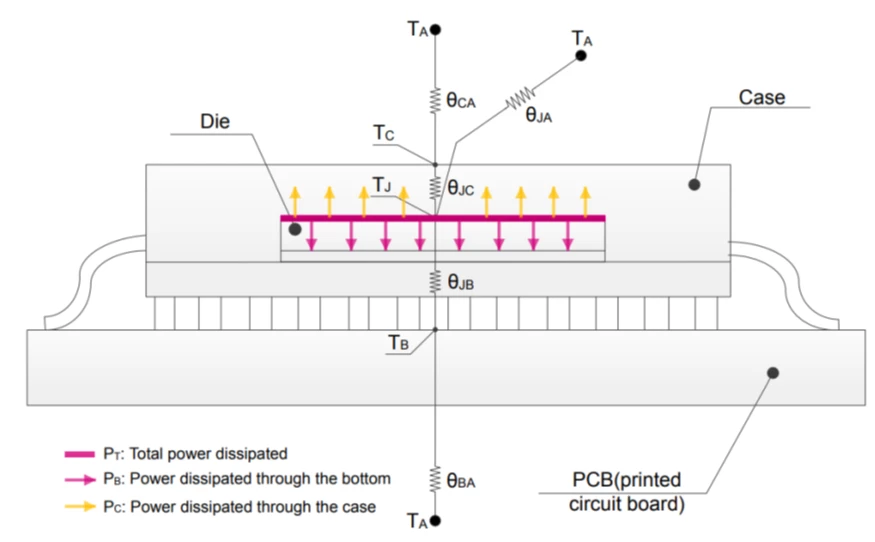

The STM32H7 MCU family clock reaches up to 600MHz and thermal management matters due to power dissipation, see details in the AN5036 Guidelines for thermal management on STM32 applications.
https://www.st.com/resource/en/application_note/an5036-guidelines-for-thermal-management-on-stm32-applications-stmicroelectronics.pdf#page=4https://www.st.com/resource/en/application_note/an5036-guidelines-for-thermal-management-on-stm32-applications-stmicroelectronics.pdf#page=4
1. Measuring the junction temperature
From an STM32 application point of view, the TJ temperature of the die (junction temperature) can be measured by an internal sensor. Notice that the internal sensor is not designed to acquire the temperature of surrounding air, due to various thermal resistances in between.

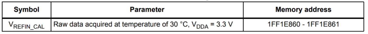

VREFINT = 1.216 V typ
https://www.st.com/resource/en/reference_manual/rm0433-stm32h742-stm32h743753-and-stm32h750-value-line-advanced-armbased-32bit-mcus-stmicroelectronics.pdf#page=993https://www.st.com/resource/en/reference_manual/rm0433-stm32h742-stm32h743753-and-stm32h750-value-line-advanced-armbased-32bit-mcus-stmicroelectronics.pdf#page=993

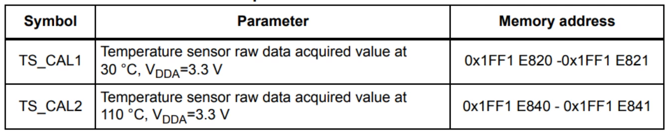

It is possible to increase acquisition accuracy both for temperature sensor and VREFINT using calibration values. Given macros (stm32h7xx_LL_adc.h) are used to evaluate the precise value of temperature and VDDA.
https://www.st.com/resource/en/datasheet/stm32h743ag.pdf#page=178https://www.st.com/resource/en/datasheet/stm32h743ag.pdf#page=178
__LL_ADC_CALC_TEMPERATURE()
https://www.st.com/resource/en/datasheet/stm32h743ag.pdf#page=110https://www.st.com/resource/en/datasheet/stm32h743ag.pdf#page=110
__LL_ADC_CALC_VREFANALOG_VOLTAGE()

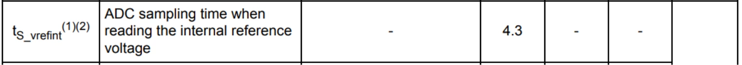

The sampling time for the temperature sensor analog input must be greater than the stabilization time specified in the product datasheet.
https://www.st.com/resource/en/datasheet/stm32h743ag.pdf#page=177https://www.st.com/resource/en/datasheet/stm32h743ag.pdf#page=177
It is also relevant for VREFINT
https://www.st.com/resource/en/datasheet/stm32h743ag.pdf#page=109https://www.st.com/resource/en/datasheet/stm32h743ag.pdf#page=109

i. Configure rank 1: Channel VREFINT, sampling time = 64.5 → 1 /5 MHz * 64.5 = 12.9 μs → tS_vrefint = 4.3 μs.
j. Configure rank 2: Channel temperature sensor, sampling time = 64.5 = 12.9 μs →  tS_temp = 9 μs.
