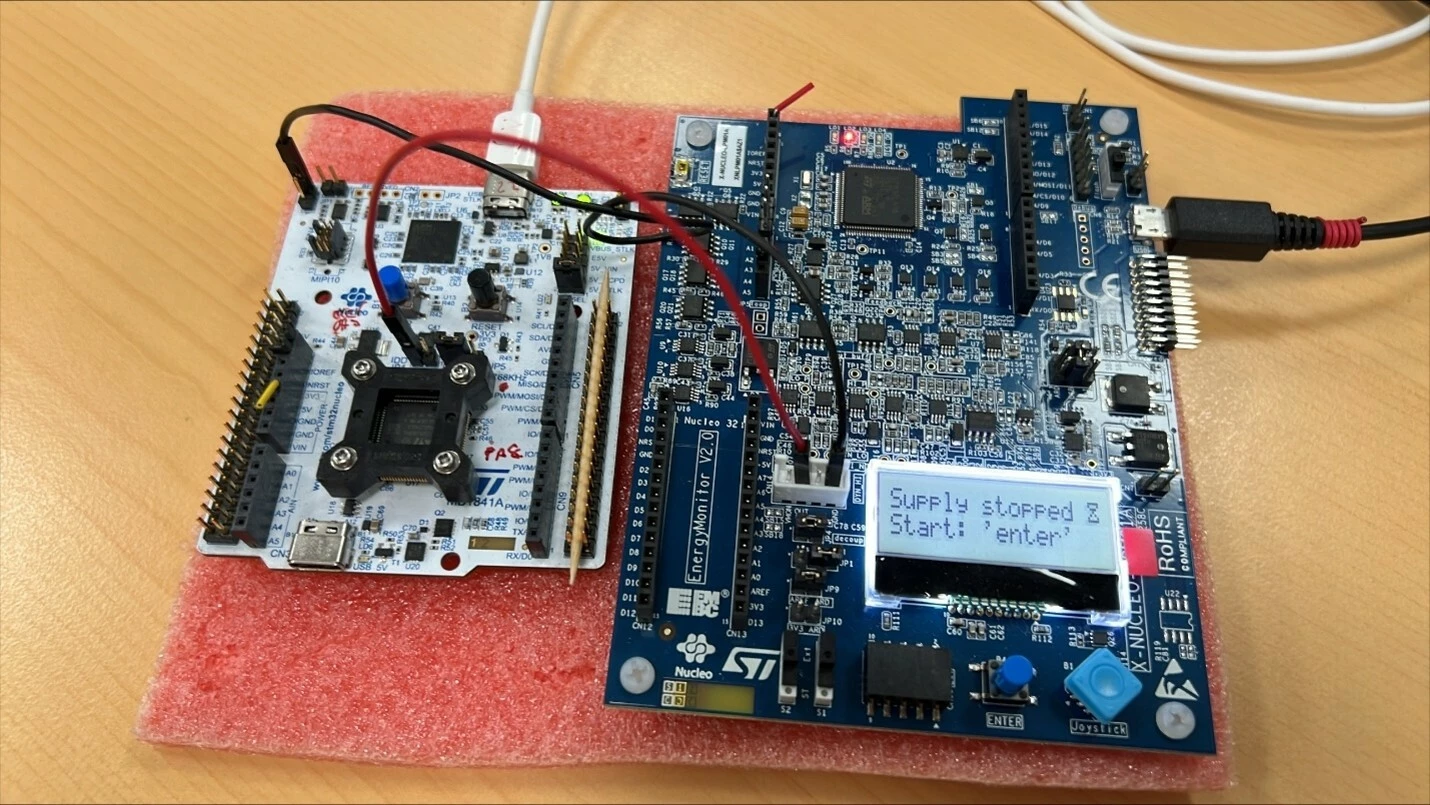

2. Measurement setup
Measure the MCU current in the MCU IDD path. The example documentation describes current measurement using the board IDD path, typically by removing JP4 and inserting the measurement instrument in series. If a specific RTC Stop 3 example or board note specifies a JP5 path instead, follow that example documentation. Using the wrong jumper or measurement path can include or exclude board circuitry and produce misleading current values.
For an external instrument such as STM32-LPM01-XN, do not assume that connecting the tool anywhere on the board gives the MCU current. Insert the instrument in series in the documented MCU IDD path, using the board and tool documentation.
Several low-power examples are not intended to be measured while an active debug session is running. Disabling debug Stop or Standby bits in firmware helps reduce debug-related current, but it is not enough if the debugger remains actively connected and controlling execution.
Also check board-level leakage conditions. Very low current measurements can be affected by the ST-LINK power state and by leakage on PA13 when the MCU is externally supplied while the ST-LINK side is not supplied. If the example documentation recommends configuring PA13 as analog to reduce leakage, note that this can affect debugger connectivity. Keep the board in a documented and repeatable hardware state for every measurement.

Figure 1 (Board Setup)

  1. Prepare the board current measurement path.
Configure the board for MCU IDD measurement according to the example documentation. For most examples, this means removing JP4 and inserting the current measurement instrument in series in the MCU IDD path. If an RTC Stop 3 example or board note specifies JP5, follow that specific instruction.
  1. Connect the measurement instrument.
Use an ammeter, power analyzer, or STM32-LPM01-XN in series in the IDD path. Do not measure from a point that includes unintended board loads unless that is the current you want to characterize.

For reproducible results on NUCLEO-U385RG-Q, measure the MCU current in the documented IDD path, run without an active debug session for final data, record the steady low-power plateau separately from transients, and compare values only in the correct firmware and hardware context. Use PWR_RUN_SMPS as the baseline and PWR_ModesSelection for controlled relative comparisons.

Andrew Neil
August 10, 2026
​@Deepak_1805
 An external current measurement instrument, including STM32-LPM01-XN
AFAIK,  STM32-LPM01-XN is just firmware:
https://www.st.com/en/development-tools/stm32-lpm01-xn.html
The actual “instrument” - the hardware - is the X-NUCLEO-LPM01A expansion board:
https://www.st.com/en/evaluation-tools/x-nucleo-lpm01a.html
Note that this has a maximum dynamic measurement of only 50mA - this is easy to exceed, eg if there is a radio in the system.
The STLINK-V3PWR can do 500mA:
https://www.st.com/en/development-tools/stlink-v3pwr.html
August 10, 2026
Thank you for the additional clarification regarding the measurement hardware.
In ultra-low-power use cases, the X-NUCLEO-LPM01A dynamic measurement capability of up to 50 mA is generally sufficient to capture the relevant current consumption profiles.
At the same time, for applications involving wireless MCUs or other scenarios with higher transient current peaks, I understand that the STLINK-V3PWR may be a more suitable option, given its higher current measurement capability.
Your input is very helpful in distinguishing the most appropriate tool depending on the application context.
