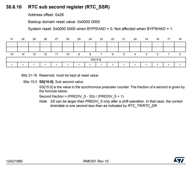

The RTC’s calendar time is stored in two separate registers: RTC_TR and RTC_SSR. The RTC time register (RTC_TR) holds the hours, minutes, and seconds information for the current time-of-day. The RTC sub second register (RTC_SSR) holds the sub seconds information for the current time-of-day. The RTC_SSR register is the focus of this article.
The RTC_SSR register contains the 16-bit value SS, which represents the number of sub seconds in the current time-of-day. More specifically, the value of SS equals the number of divisions in one second at the current time-of-day.
As stated in the reference manual, the RTC has a resolution of 1 / (PREDIV_S + 1) seconds. This means that the maximum number of divisions that are possible in one second is PREDIV_S + 1.
So, in simpler terms, we say:
Maximum # of divisions in 1 second = PREDIV_S + 1

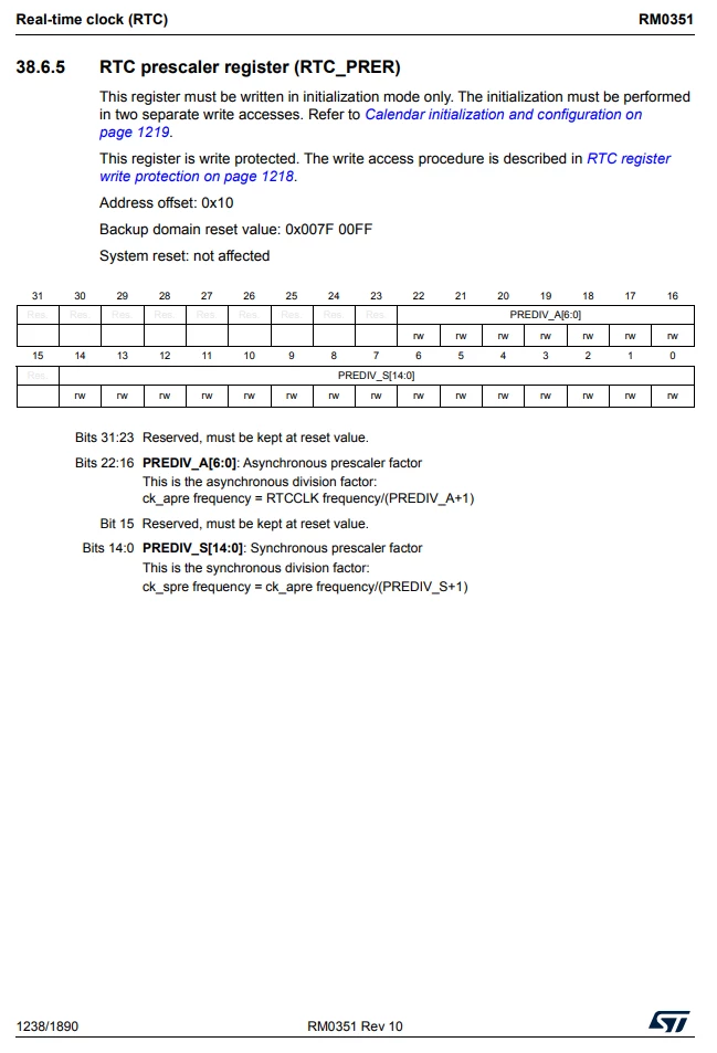

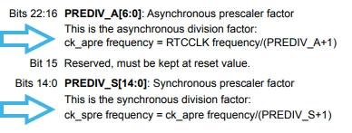

PREDIV_S is a 15-bit user-programmed value that we set in the RTC_PRER register.
For this article, we have arbitrarily chosen to use PREDIV_S = 4096. For your application, compute PREDIV_S appropriately based on your application’s requirements and the equations given in the RTC_PRER register bits description.
By our example, if PREDIV_S = 4096, then we can divide 1 second a maximum of 4096 + 1 times.

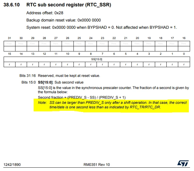

By this logic, (PREDIV_S + 1) is the maximum number of sub seconds we can have in 1 second. Therefore, SS will typically be a value between 0 and PREDIV_S + 1.
As noted in the reference manual, SS can be a value greater than PREDIV_S only when a shift operation is performed to try and synchronize the RTC with a remote clock.

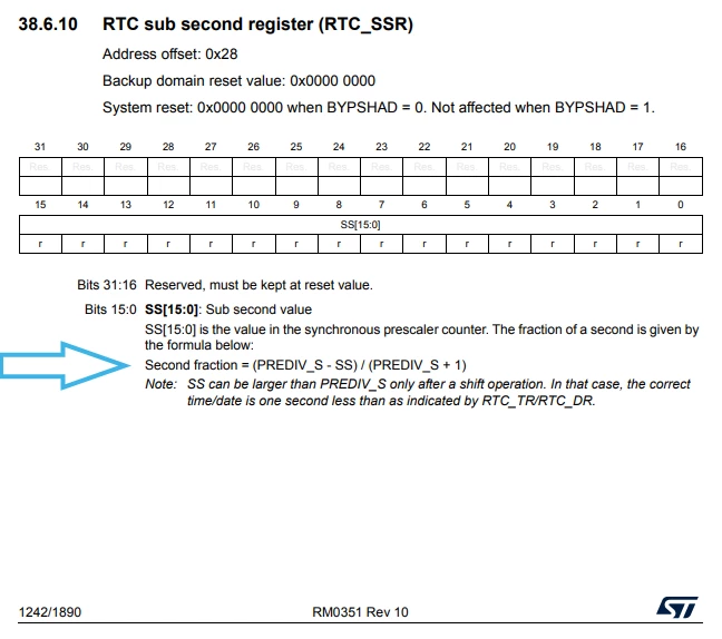

3. Second fraction equation
The Second fraction is an equation given in the reference manual and can be found in the section for the RTC_SSR register.
The Second fraction equation uses the RTC’s sub second value (SS) to compute the number of fractions of a second in the current time-of-day.
In simpler terms, the Second fraction equation converts the RTC’s raw sub second value (SS) into fractions of a second, which is generally a more meaningful way to interpret the value.
