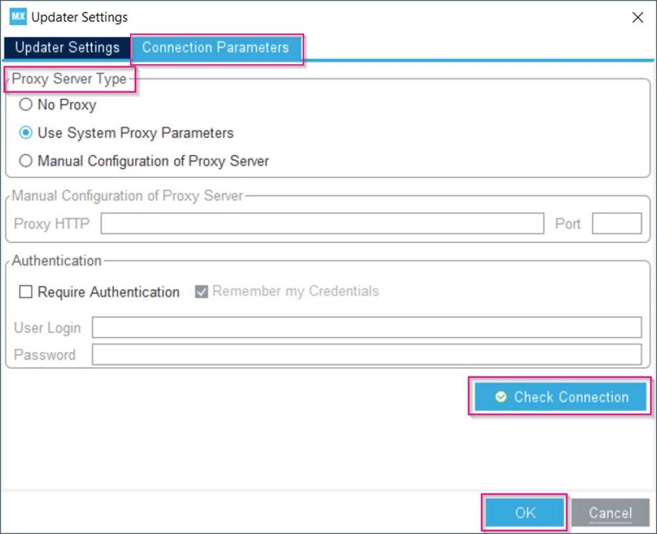

Configure proxy (optional)
If the PC on which STM32CubeMX runs is connected to a computer network using a proxy server, STM32CubeMX needs to connect to that server. When the connection is established, it can access the internet, get self-updates and download firmware packages. Proxy configuration is typically (but not always) required on enterprise networks.

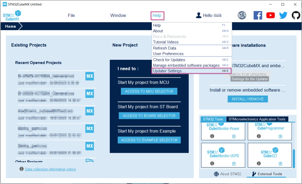

  1. Launch CubeMX and click [Help] > [Updater Settings].
  2. Under the Connection Parameters tab, choose the appropriate Proxy Server Type. Fill in the proxy information, if needed.
    To ensure that CubeMX can access the internet through the configured proxy, press [Check Connection]. Once the connection has been verified, press [OK].
If needed, contact your IT administrator for proxy information (proxy type, http address, port). For detailed information about Connection Parameters, see Section 3.4.2 in UM1718: STM32CubeMX for STM32 configuration and initialization C code generation.

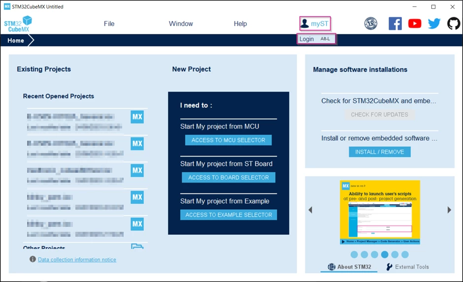

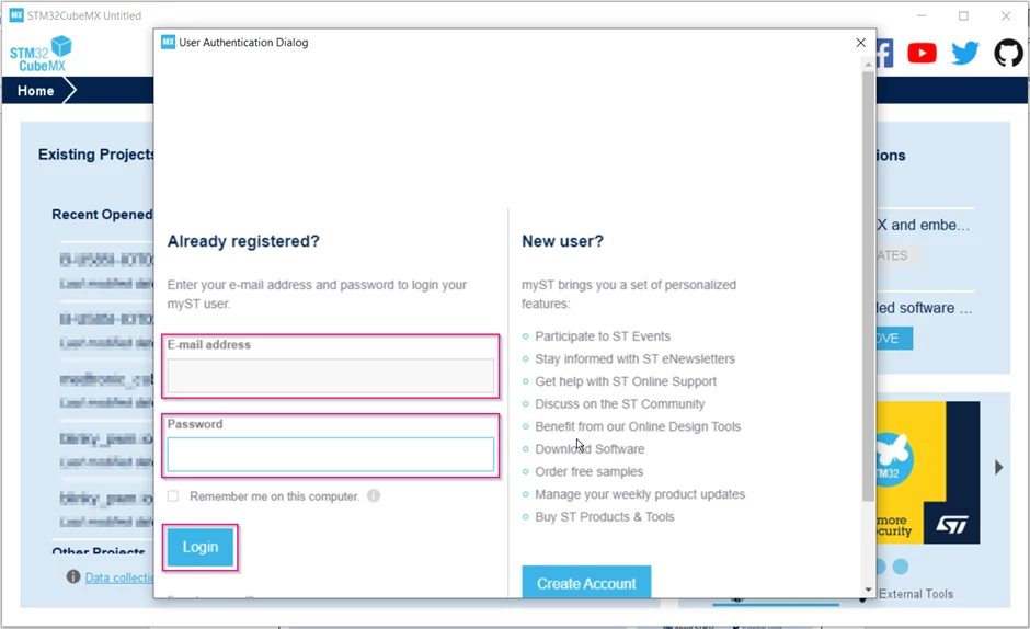

  1. Launch CubeMX and press [myST] -> [Login].
  2. Enter your myST account email address and password, and press [Login]. If you do not have a myST account, press [Create Account] to make one.

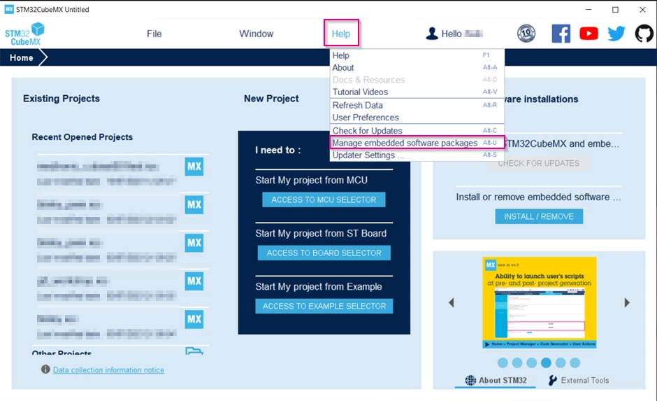

  3. Once you are logged in successfully, press [Help] -> [Manage Embedded Software Packages].AMEMCUSupportCenterAD_0-1693598083578.png

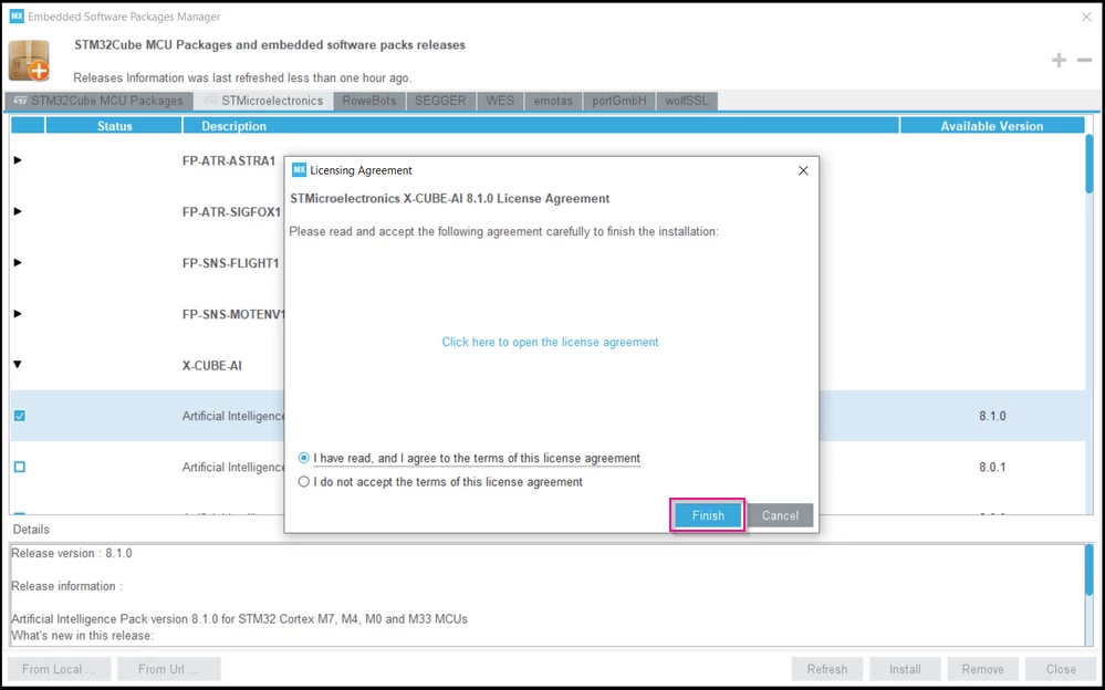

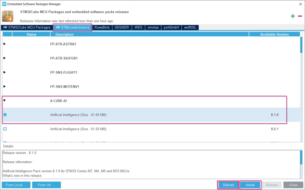

  4. From the Embedded Software Packages Manager window, press the [Refresh] button to get an updated list of add-on packs. Go to [STMicroelectronics] Tab, press [X-CUBE-AI] and select the [Artificial Intelligence] package version you wish to install and click the [Install] button.AMEMCUSupportCenterAD_1-1693598317859.png
  5. Follow the installation steps on the screen and click [Finish].AMEMCUSupportCenterAD_2-1693598686285.png

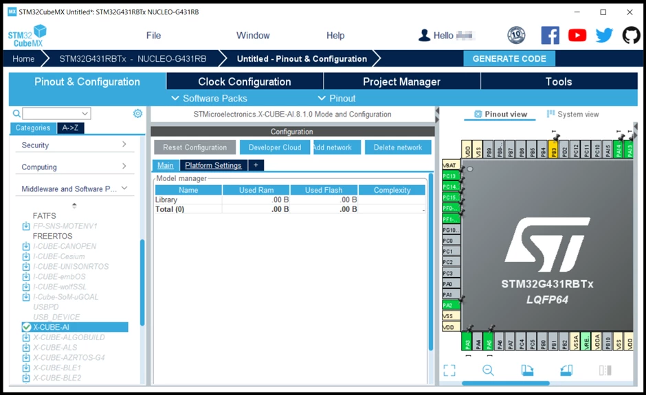

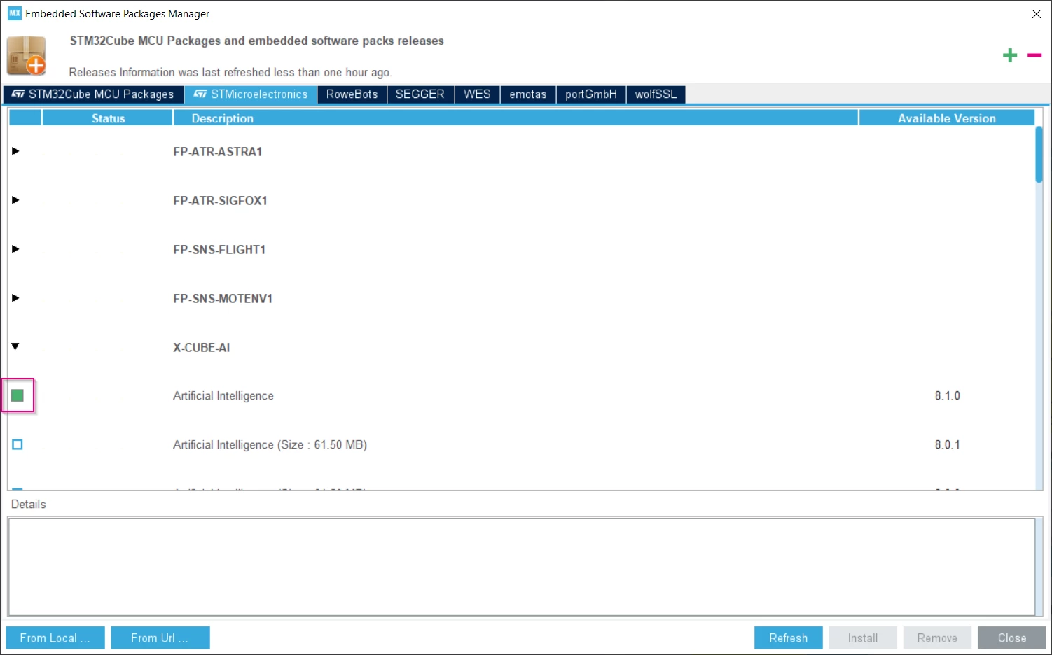

  6. Once installation is successful, the X-CUBE-AI Artificial Intelligence package is marked with a green box. Click [Close] before proceeding.AMEMCUSupportCenterAD_3-1693270154103.png

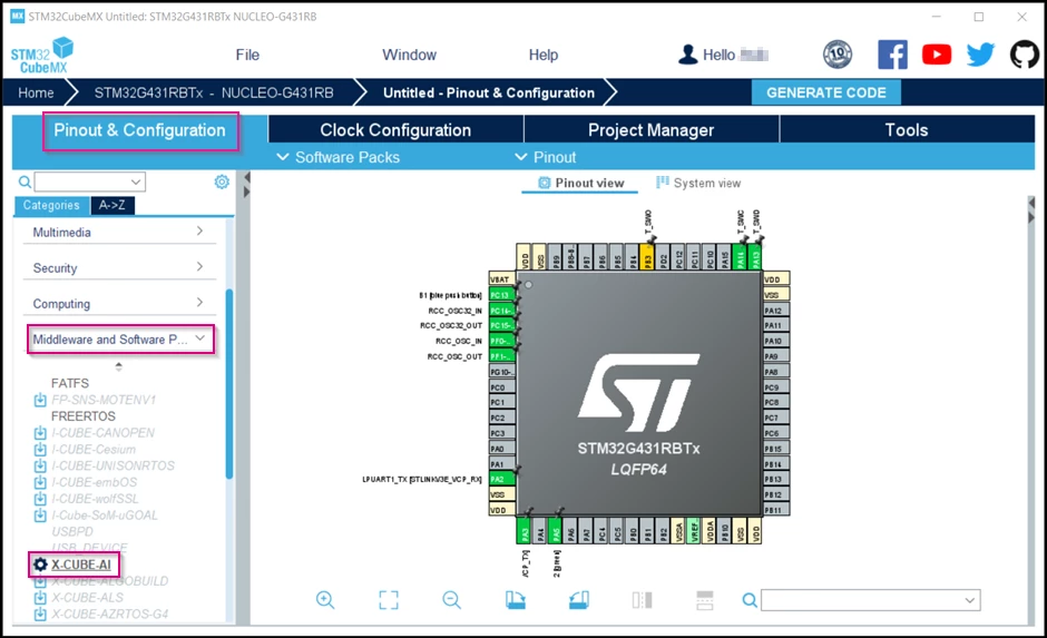

  7. In CubeMX, click [File] > [New Project] and select your preferred MCU from the [MCU/MPU Selector] tab, or select your preferred Board from the [Board Selector] tab.
    Then, under the [Pinout & Configuration] tab, press [Middleware and Software packages], and then select [X-CUBE-AI].AMEMCUSupportCenterAD_0-1694034807120.png

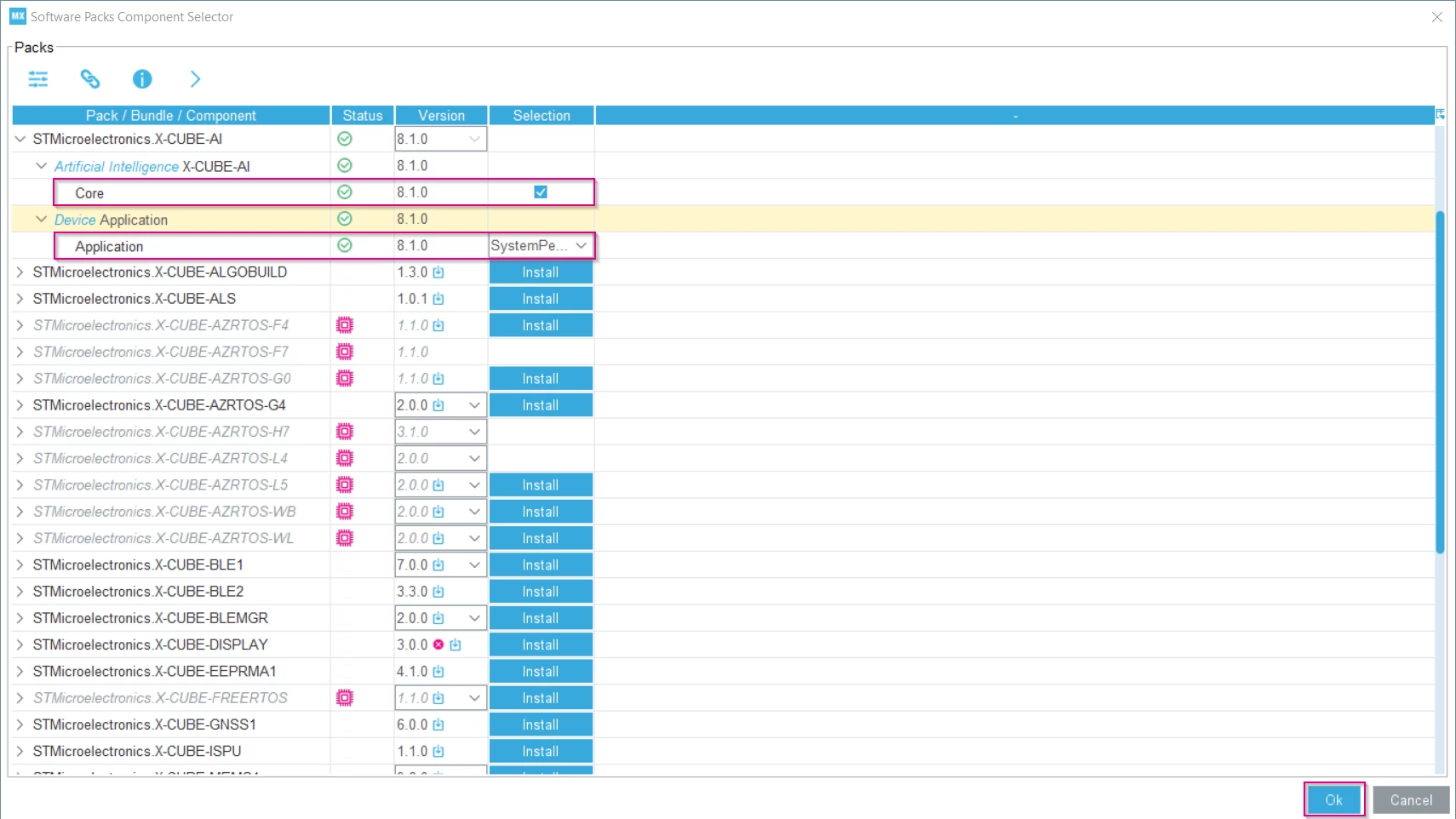

  8. In the Software Packs Component Selector window, select STMicroelectronics.X-CUBE-AI.
    Then enable Core: Artificial Intelligence X-CUBE-AI -> Core -> Enable
    Finally, select the application type: Device Application -> Application -> Select "SystemPerformance".
    Click on [Ok] when done in the Software Packs Component Selector window.
    Note that X-CUBE-AI currently supports three application types, namely SystemPerformance, Validation, and ApplicationTemplate. See section 9, 10 & 11 in UM2526: Getting started with X-CUBE-AI Expansion Package for Artificial Intelligence for more details. AMEMCUSupportCenterAD_5-1693270154134.png

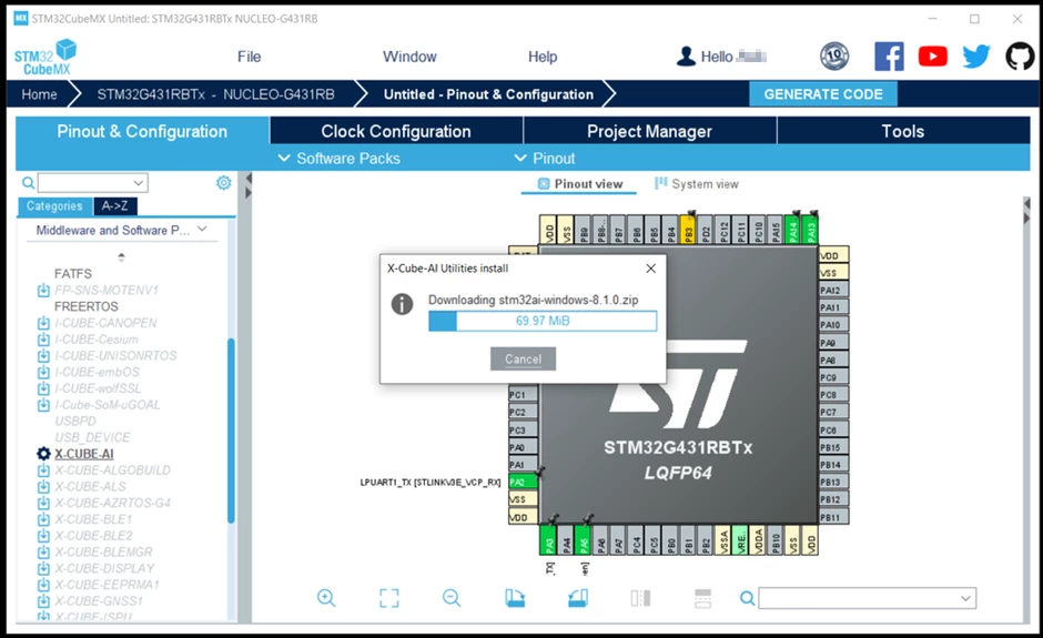

    Since this is the first use of the X-CUBE-AI Expansion Package, an OS-specific part of the package is downloaded and installed automatically.
    9. Once the download is complete, X-CUBE-AI is ready for use in your project.AMEMCUSupportCenterAD_2-1693958738703.png
