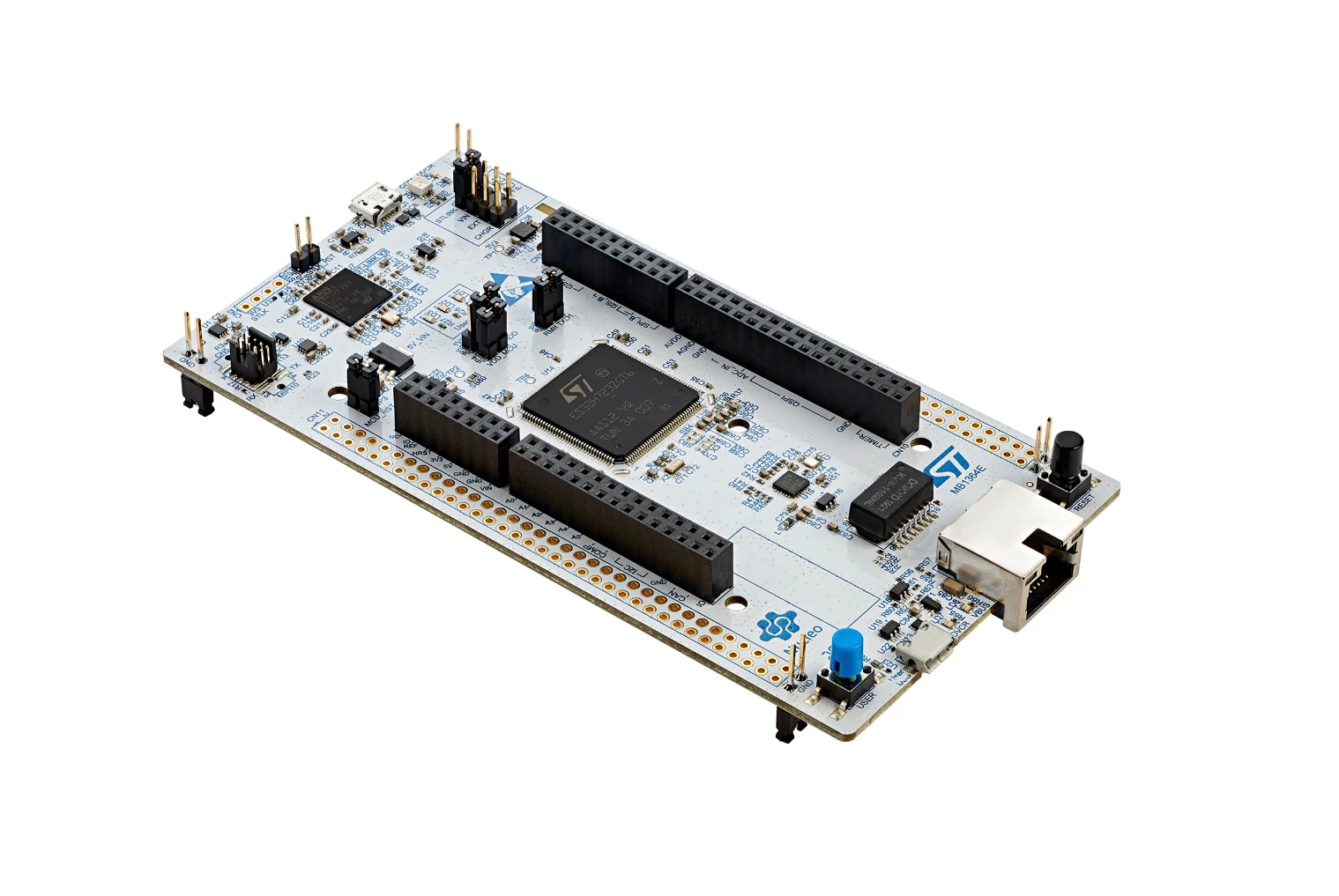

Hello developer and welcome to this article! For this tutorial, we use the NUCLEO-H723ZG board, which has a USB OTG_FS connector interface to open an HID class to work as a mouse. This board has an STM32H723ZGT6 microcontroller, and the steps shown here can be easily adapted to any other STM32. The STM32CubeIDE 1.13.1, the STM32CubeH7 1.11.1, and the X-CUBE-AZRTOS-H7 3.1.0 releases were used to build this tutorial. Standalone support is not present for all STM32 series yet. Refer to the proper release note of each series for more details on the current support.

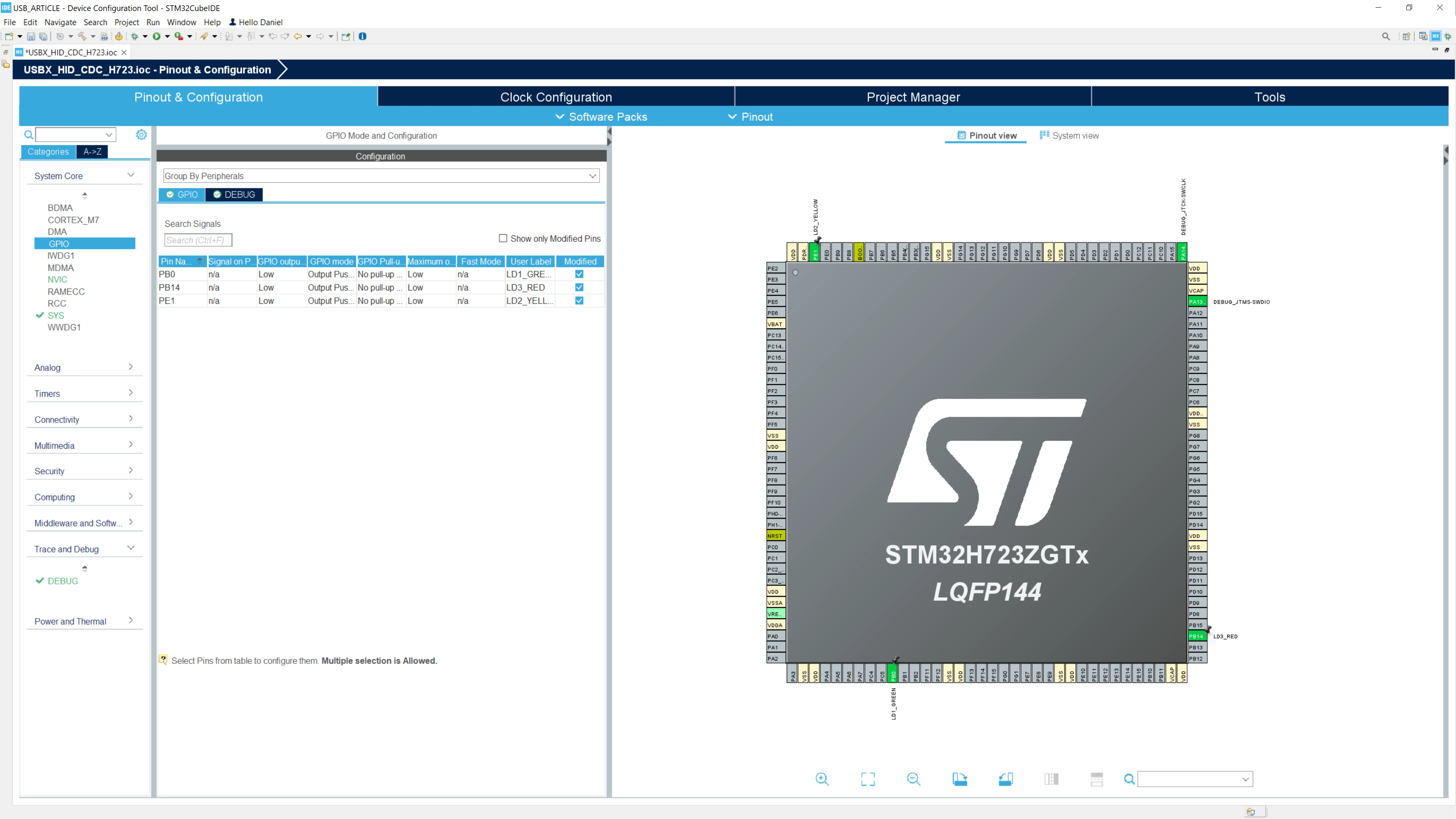

Let us start creating a project for the STM32H723ZGT6 in the STM32CubeIDE and enabling the following pins to get access to the LEDs available on the board.
PB0 as GPIO Output Push Pull, labeled as LD1_GREEN.
PE1 as GPIO Output Push Pull, labeled as LD2_YELLOW.
PB14 as GPIO Output Push Pull, labeled as LD3_RED.
Then configure the PC13 pin as GPIO_Input with the “USER_BUTTON” as label to allow us to read the state of the User Button available on the Nucleo board.

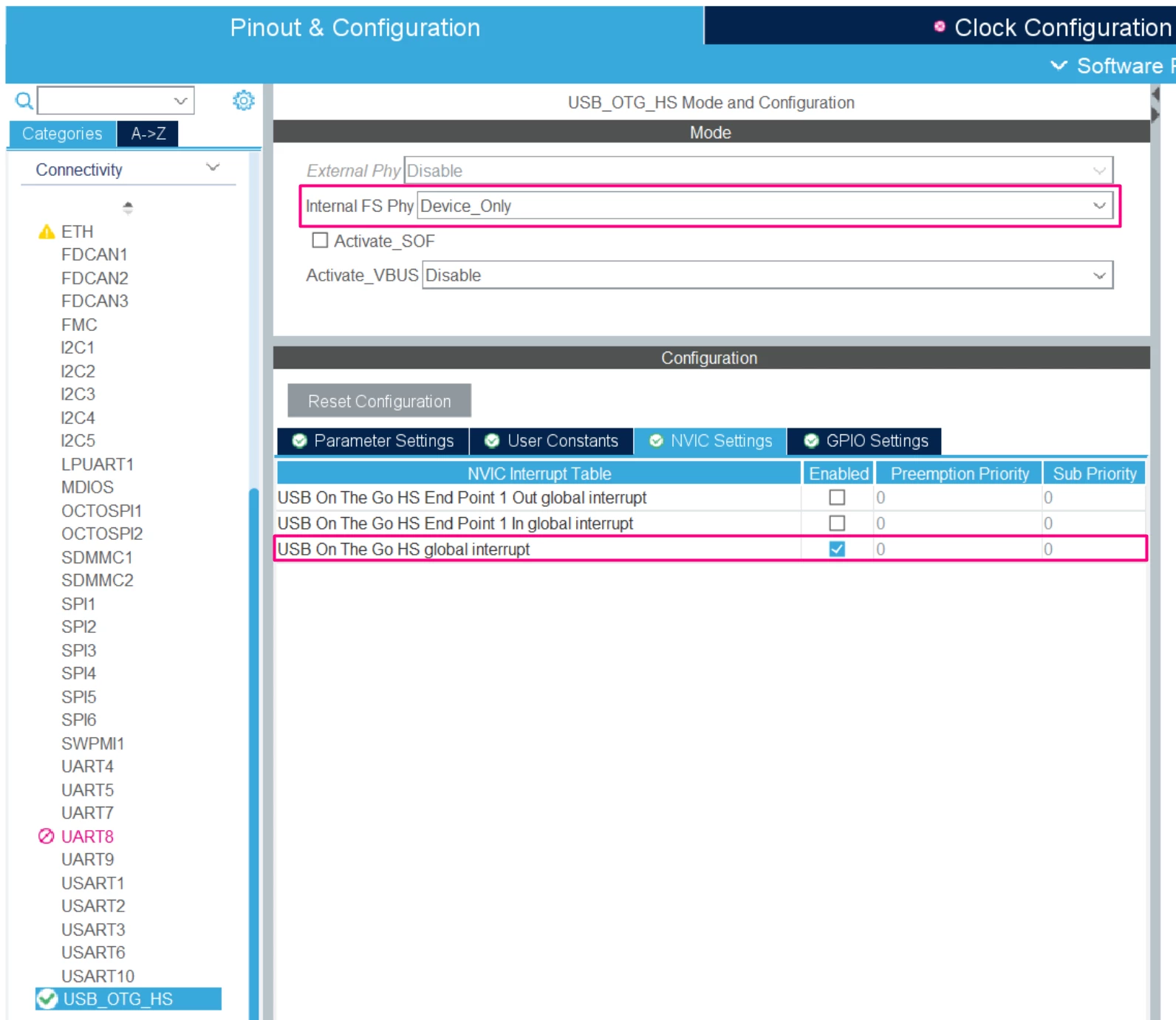

Down to the USB_OTG_HS menu, under the "Connectivity" tab. Once you have selected the USB peripheral tab, select the "Device_Only" option in the "Internal FS Phy." Afterwards, enable the "USB On the Go" HS global interrupt under the NVIC Settings tab. Doing that, the Clock Settings tab will signalize an error, but do not worry, we will correct it in the next step.

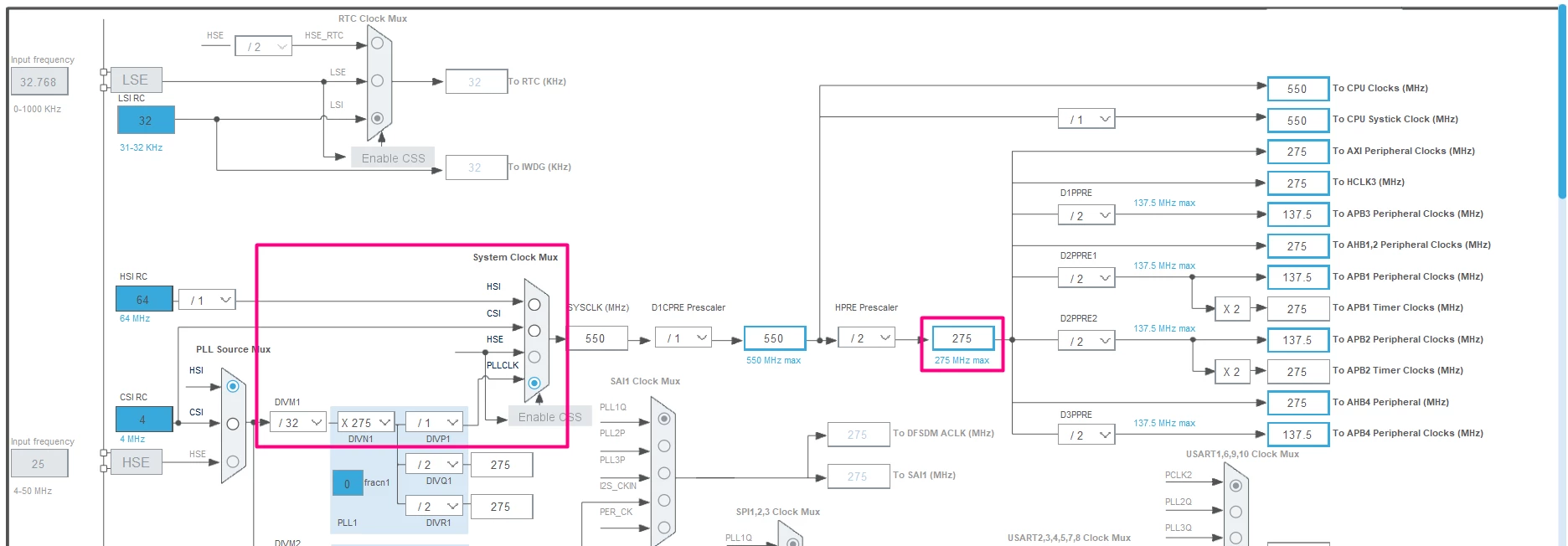

Go to the Clock Configuration tab. We suggest increasing the frequency of HCLK to achieve the best application performance. See the clock example settings used for this application.
Most importantly, change the USB Clock Mux source to the HSI48.

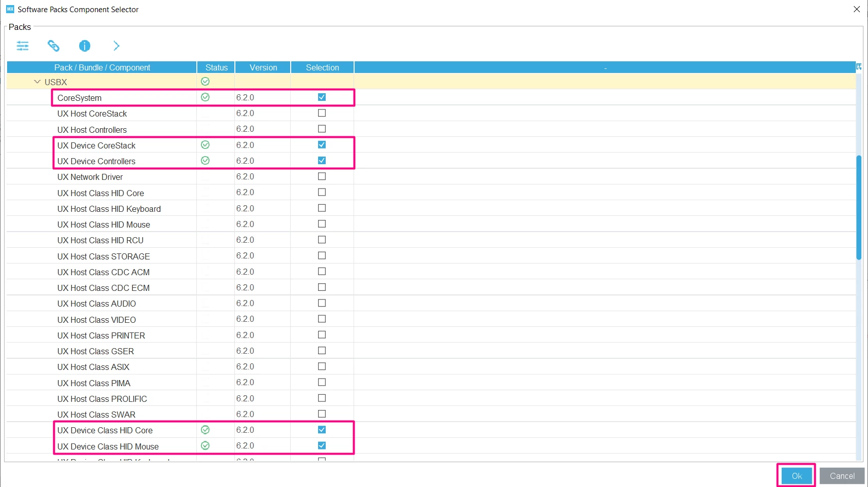

Once the package is installed, enable the following required components:
  • USB USBX -> USBX -> CoreSystem
  • USB USBX -> USBX -> UX Device CoreStack
  • USB USBX -> USBX -> UX Device Controller
  • USB USBX -> USBX -> UX Device Class HID Core
  • USB USBX -> USBX -> UX Device Class HID Mouse
Note: a warning message might appear, but it can be ignored.
You can select different classes depending on your application. Make sure to have the CoreSystem, CoreStack, and Controller enabled. These components are required for the application. After selecting the packages, press OK.

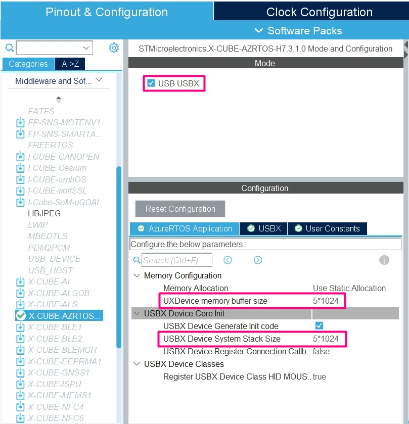

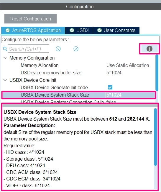

Now, back to the X-CUBE-AZRTOS-H7 under the "Middleware and Software Packs" and enable USB USBX components:
Once the USB USBX package is enabled, a configuration menu is shown. In the AzureRTOS application, we need to increase the UXDevice memory buffer size and the USBX Device System Stack Size. For the HID class, 5KB is sufficient for our application. Enabling the information menu, you are able to see the suggested amount of memory needed for each class when selecting the USBX Device System Stack Size:

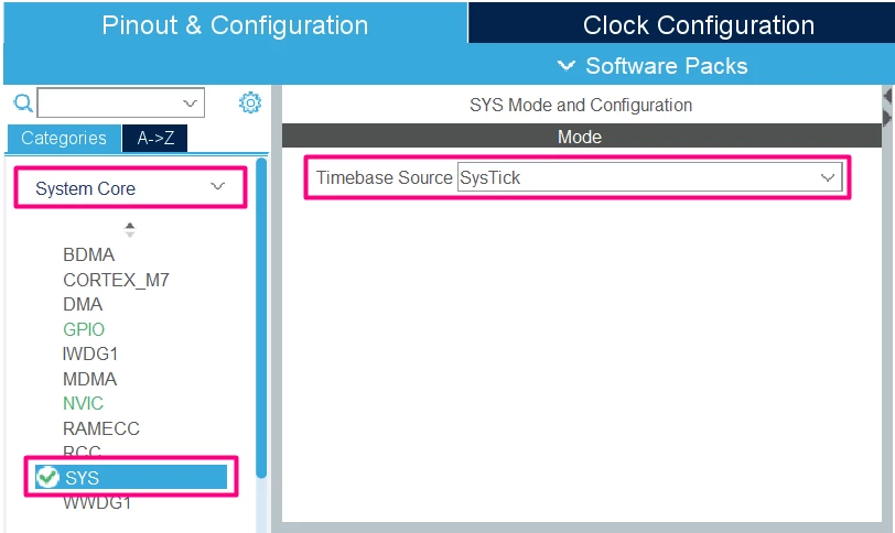

It is necessary to set a timebase for our application. Since we are not using RTOS, we can use the default SysTick to be our timebase. So, go to System Core->SYS and select the SysTick as the timebase source:

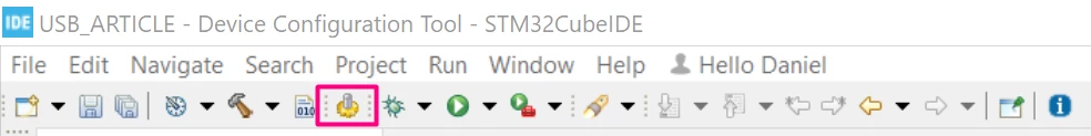

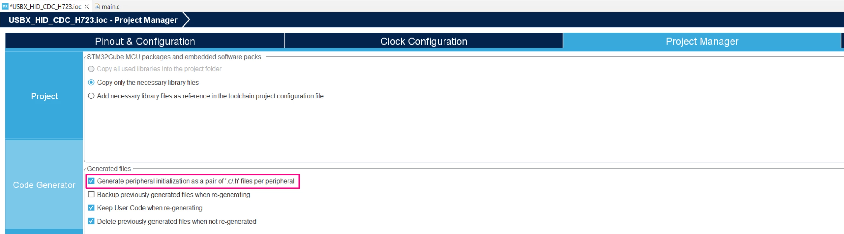

2.3 Code generation
Now, go to the "Project Manager" tab and then the "Code Generator" section. Enable the “Generate peripheral initialization as pair of ‘.c/.h’ files per peripheral”. This facilitates the access to the peripheral resources in the code.

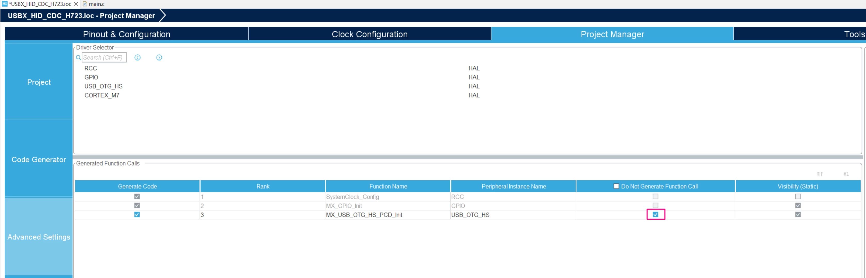

The final last step is to disable the USB_OTG_HS peripheral initialization code in the Advanced Settings also in the Project Manager.
Now, that all the settings are configured you can generate the code. For that you can use the alt + K shortcut or press the generate button.

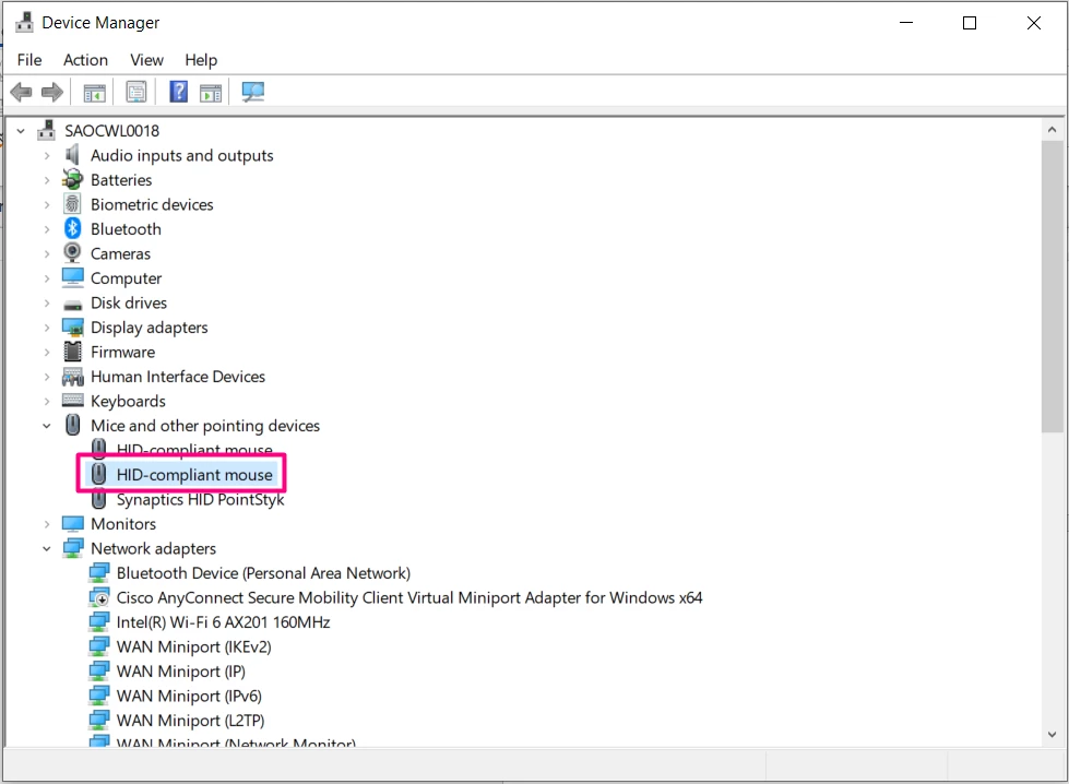

All code implementation is done! You can build and flash the code into your device and try it!
4. Results
After compiling and flashing this code onto the microcontroller, connect a Mini-USB cable to the user USB connector (CN13). When the USB is connected, pressing the user button makes the mouse to move in the diagonal direction and turn on the yellow LED. The yellow LED stays on as long as the user button is pressed.
5. Conclusion
