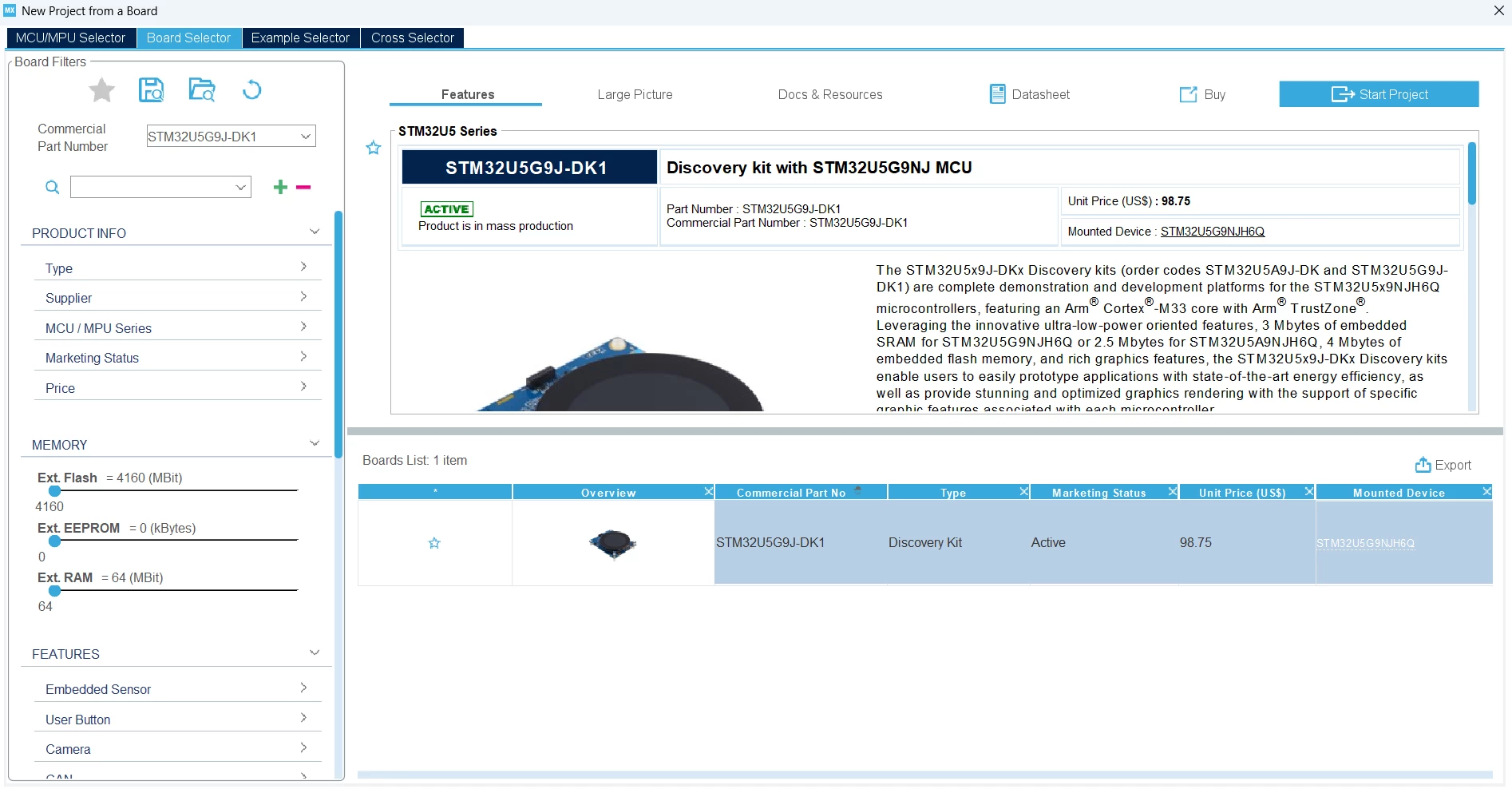

1.1 Create a project
  • Start by creating a new project using the STM32CubeIDE by clicking [File -> New -> STM32 Project]. Use the [Board Selector] tab and select the [STM32U5G9J-DK1].
  • Initialize all peripherals with their default mode.

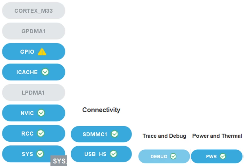

  • Disable TrustZone®
  • In the System View, deconfigure any unnecessary peripherals to optimize resources.

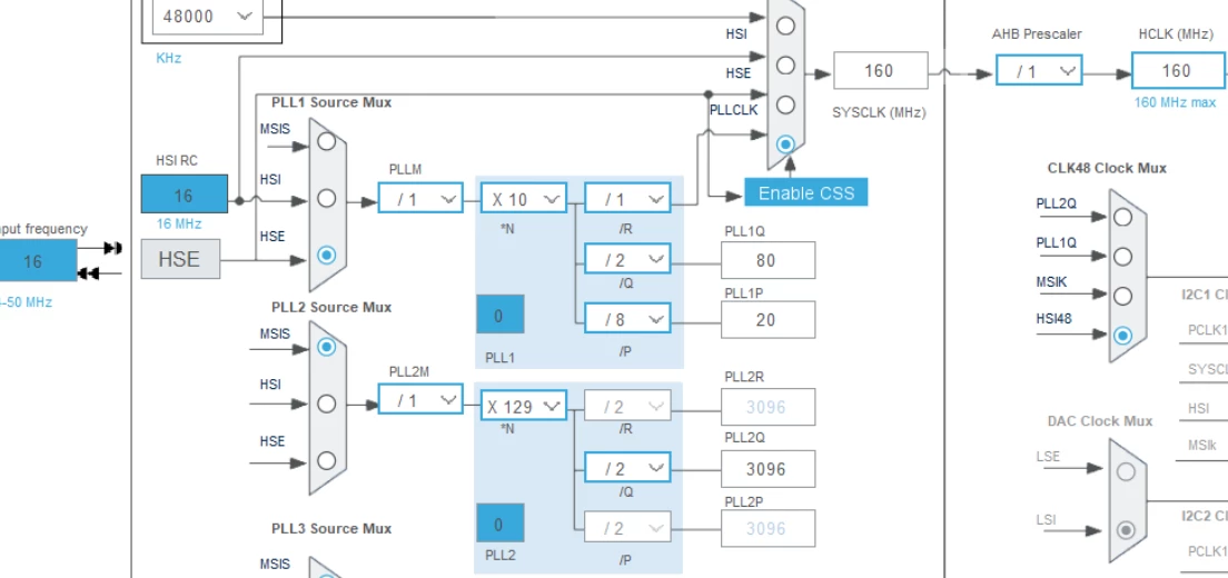

  • In the clock configuration tree viewer, set HCLK to maximum speed.

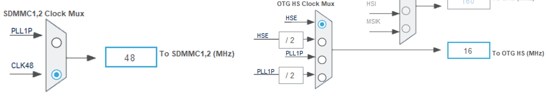

  • Configure SDMMC1 clock source as CLK48 and USBHS clock source as HSE

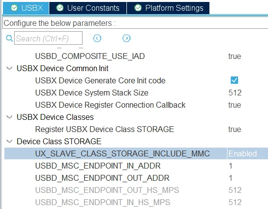

1.2 Configure USBX middleware

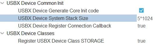

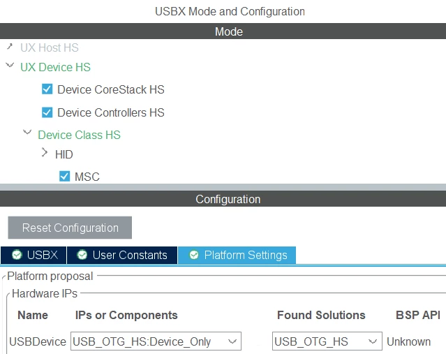

  • Enable the USBX Device middleware package.
  • Configure the following parameters:

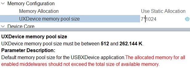

  • Configure the UXDevice memory pool size and USBX Device System Stack Size appropriately:

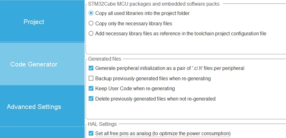

  • In Code Generator Settings, set all free GPIO pins to Analog mode to reduce power consumption.
  • After completing the USBX and peripheral configurations in STM32CubeMX, save your project and generate the initialization code.

  • Exclude SDMMC generated code
    Since the eMMC interface is managed by the BSP driver, exclude or disable the SDMMC peripheral code automatically generated by CubeMX to avoid conflicts or redundant initialization.

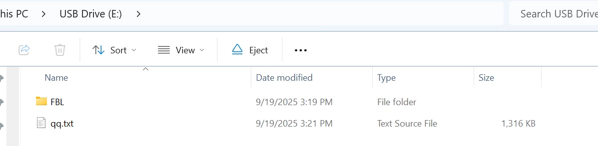

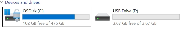

3. Build and flash the application
After building and flashing the firmware to your STM32U5G9J-DK1 board:
  • Connect the board to a PC host via USB.
  • The device should enumerate as a USB mass storage device.
  • The PC detects a new removable drive representing the eMMC storage.
  • Standard file operations (read, write, format) can be performed on this drive.
4. Expected results
  • STM32U5G9J-DK1 enumerates successfully as a USB MSC device.
  • All necessary USB descriptors (device, configuration, string) are correctly provided.
  • The eMMC memory (4 GB volume) is accessible as a removable drive on the host system.
