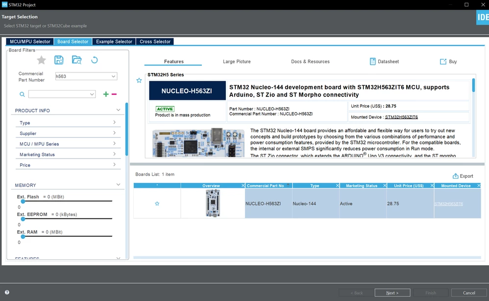

1.1 Create a project
Start by creating a new project using the STM32CubeIDE by clicking [File → New → STM32 Project]. Use the [Board Selector] tab and select the [NUCLEO-H563ZI].
Under the board project options, you can keep the USER BUTTON configuration.

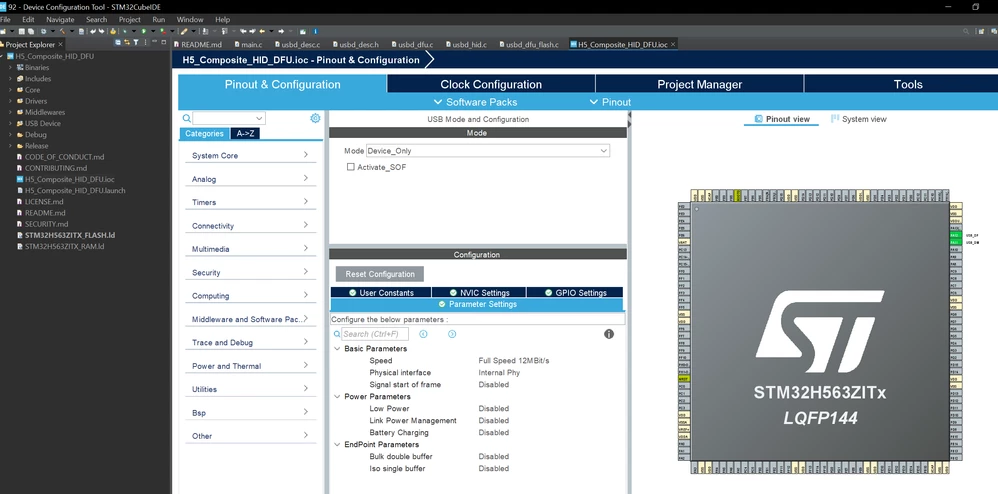

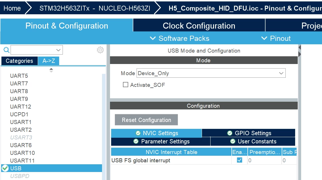

Once the project creation is done, go into [Connectivity] section and enable the USB peripheral [USB_OTG_FS] peripheral in [Device Only mode].
Under [NVIC Settings], enable USB FS global interrupt.

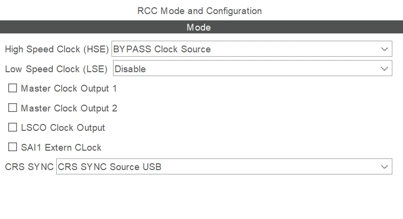

Under [System Core], under [RCC], HSE oscillators is configured in Bypass mode.

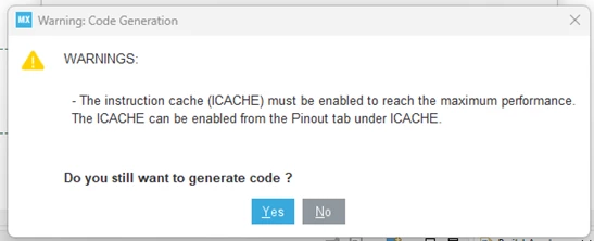

The instruction cache ICACHE should be disabled in our project.

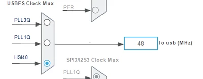

The last step before generating the code is to update the system clock frequency, the USB peripheral is fed with an HSI48. So, activation of CRS Sync Source USB is highly recommended.
Due to USB data rate and packet memory interface requirements, the APB2 clock must have a minimum frequency of 12 MHz to avoid data overrun/underrun problems.

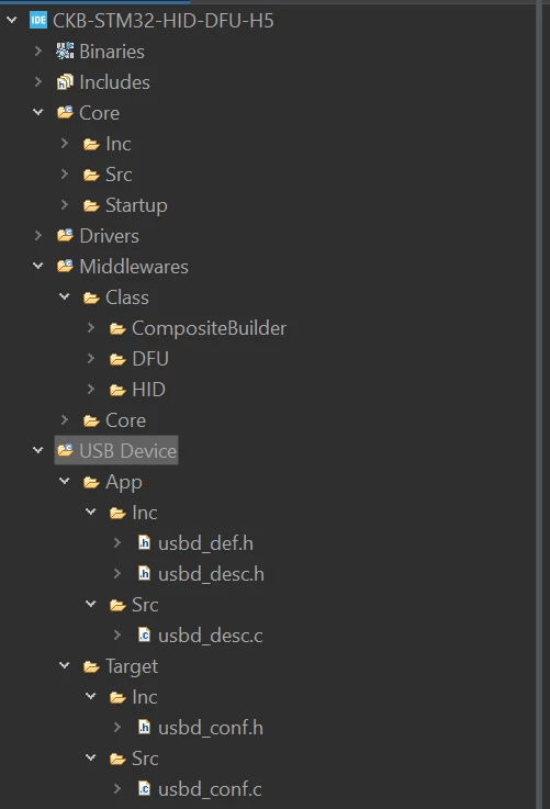

Ensure that the USB Device folder and middleware directory structure includes the following:

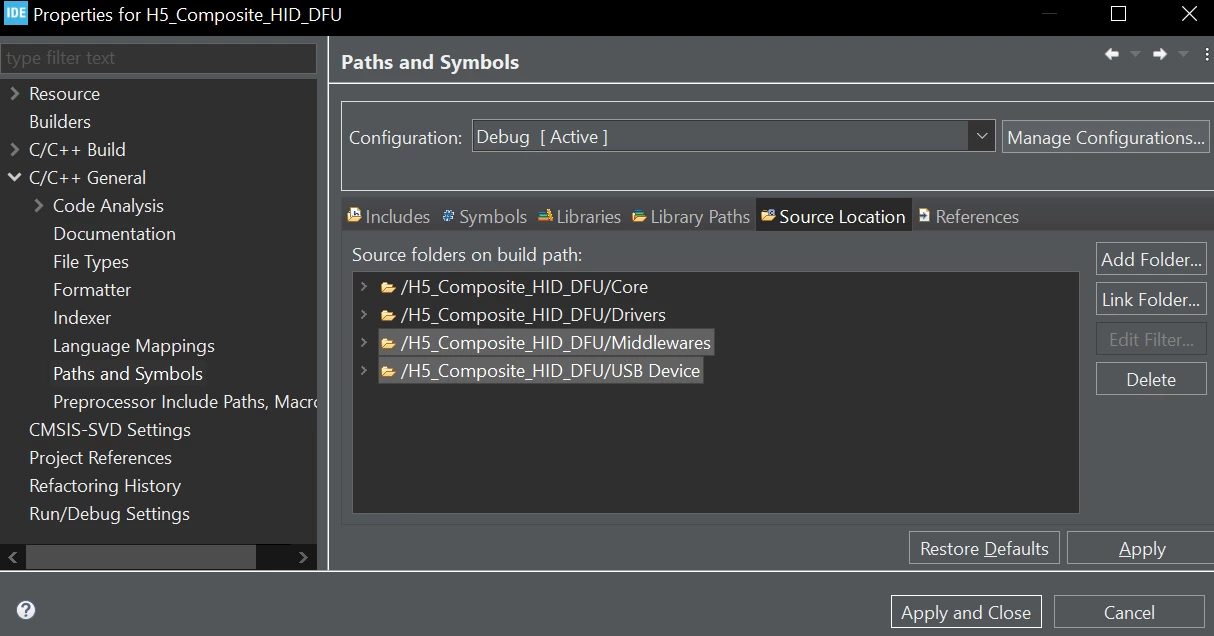

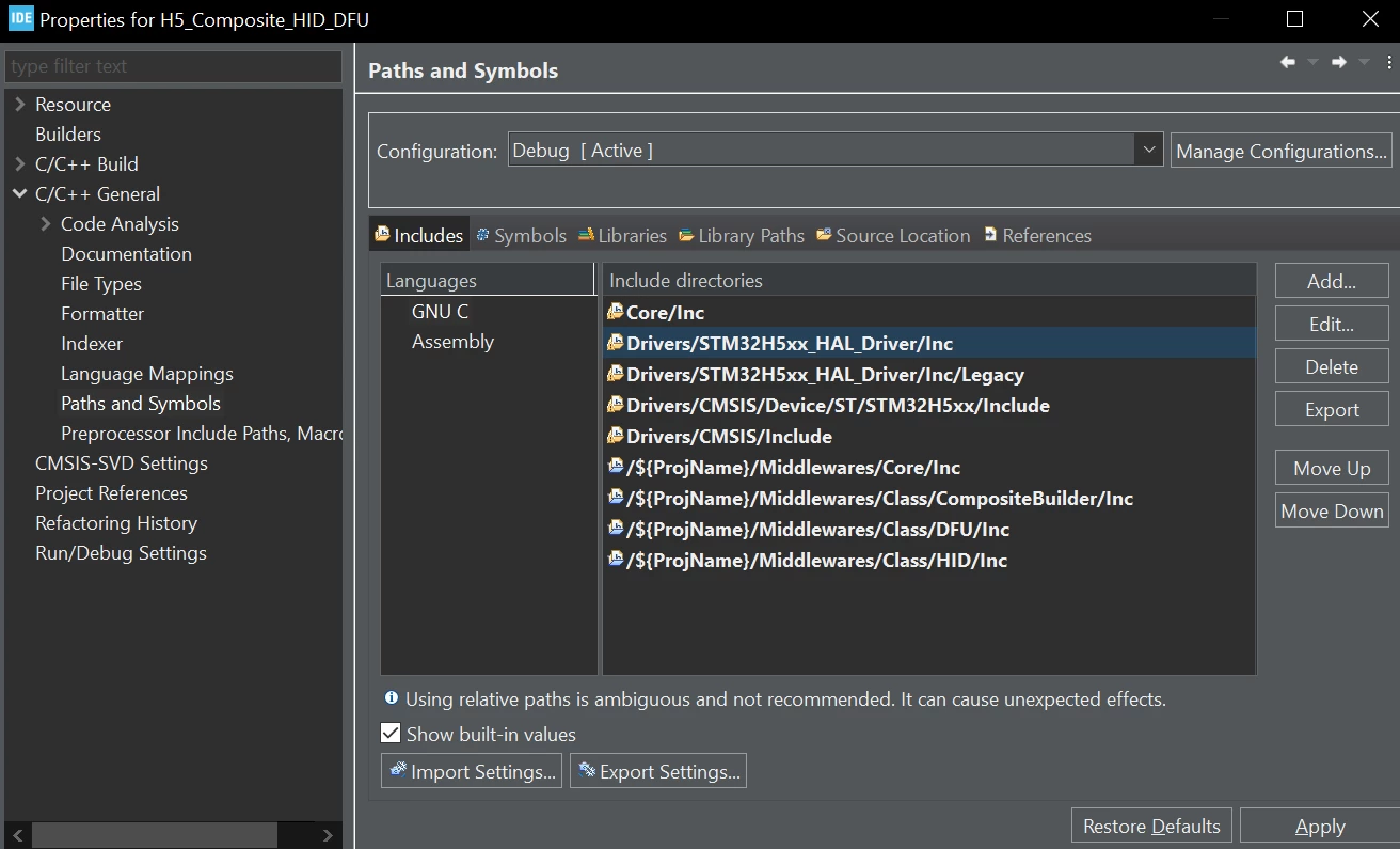

FBL_0-1739199935239.pngUnder [Properties → C/C++ General → Paths and Symbols], ensure to add related file source under [Source Location].
Under [Includes], add middleware header files.
Now, you should be able to compile without issues.

Next step to facilitate the use of this article, you can simply replace the existent USB Device folder including App and Target with the one in the project on GitHub.

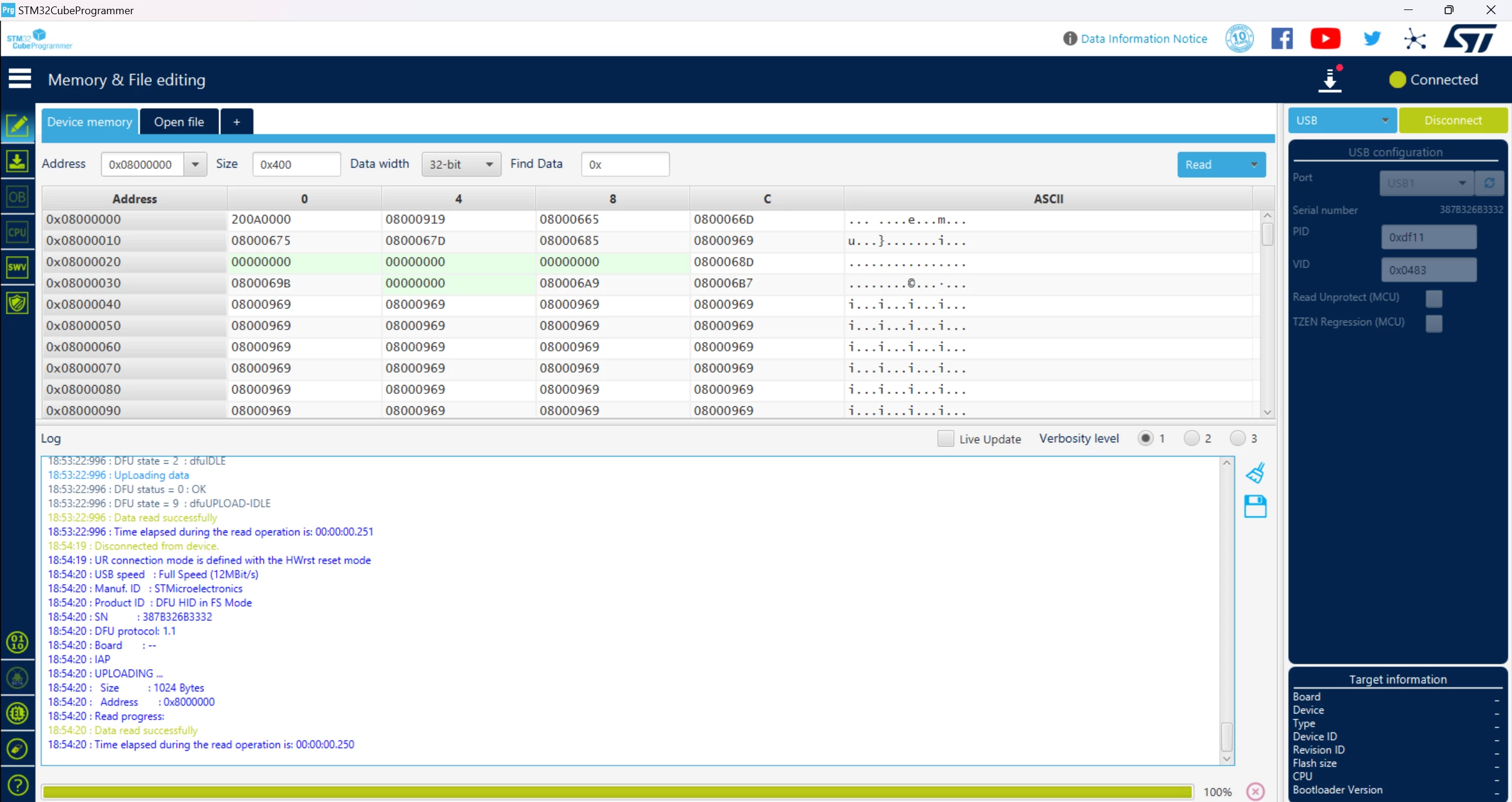

3. Build and flash the application
After building and flashing the application, some more steps are required.

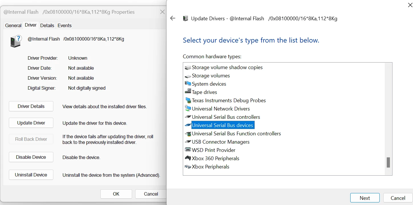

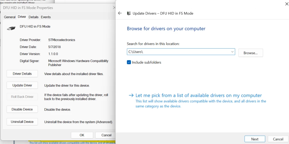

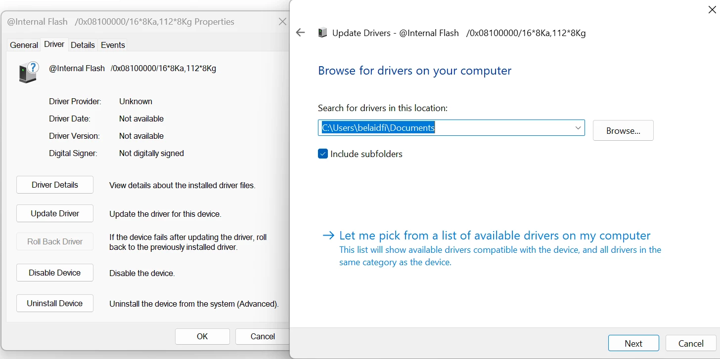

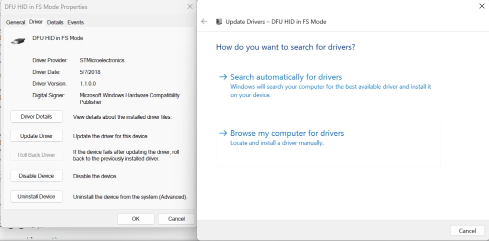

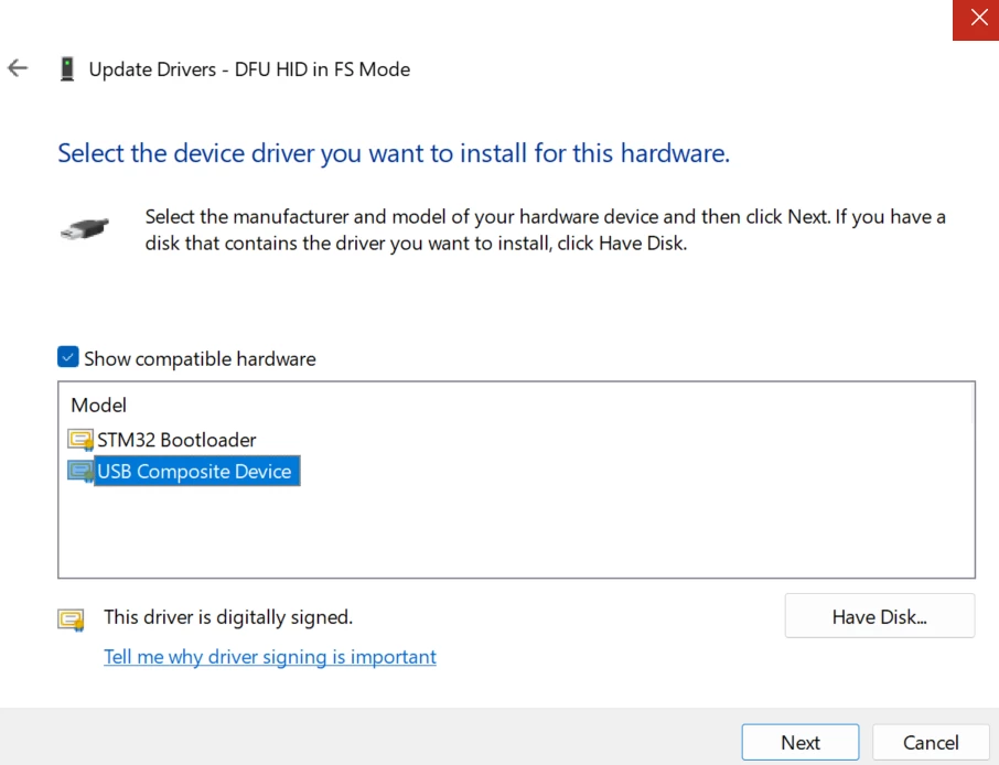

3.1 Update driver
Another step is required updating the driver for DFU, in device manager properties → Update Driver → Browse my computer for drivers.
Then select [Let me pick from a list of available drivers of my computer].
In the [Update Drivers] window, ensure [Show compatible hardware] is checked, then select [USB Composite Device] from the list and click [Next].

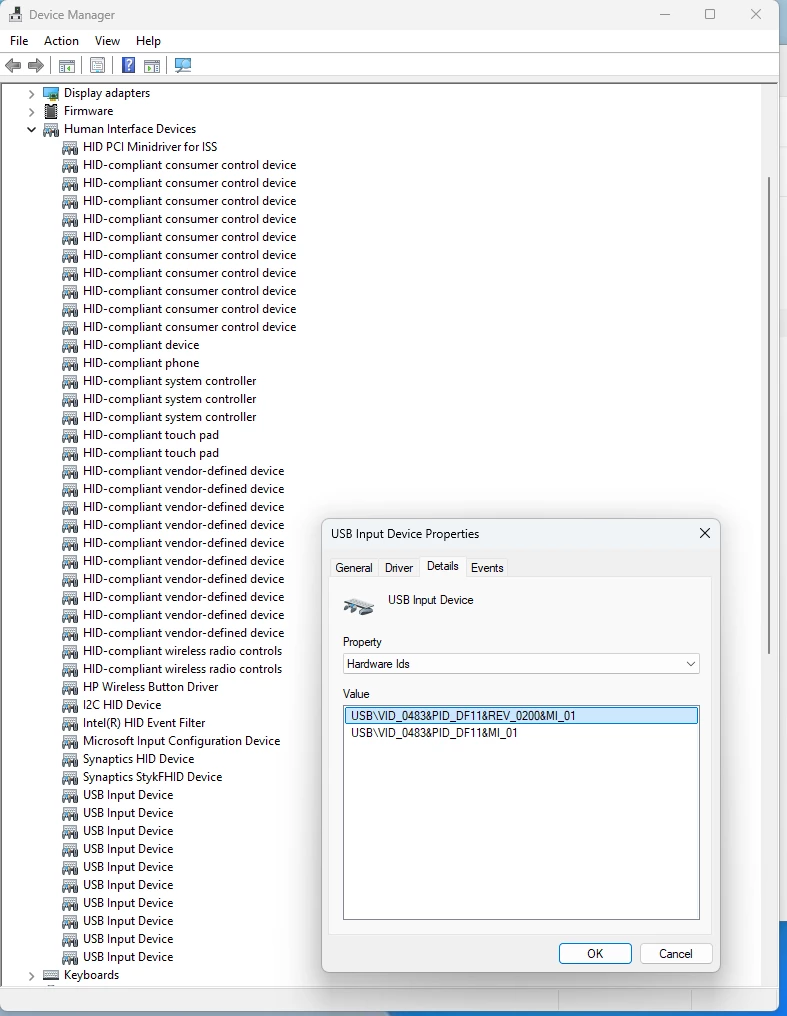

To check HID is functional, you can click on the blue button to see the mouse pointer change position.
Both interfaces (HID and DFU) share the same VID and PID. You can check "Hardware Ids" property under the USB Input Device window.
And you can connect in DFU and have USB HID still functional.

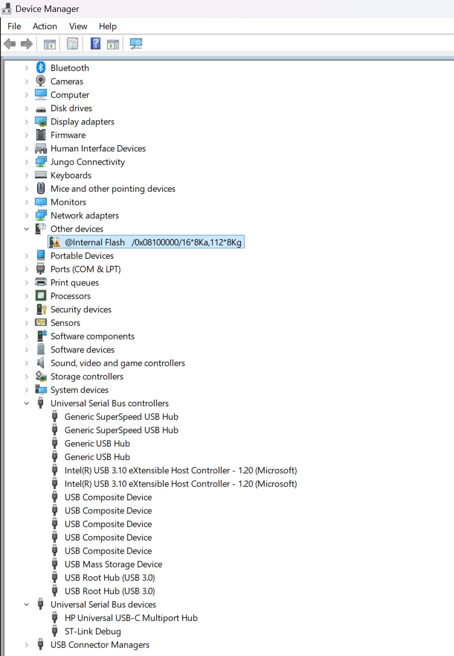

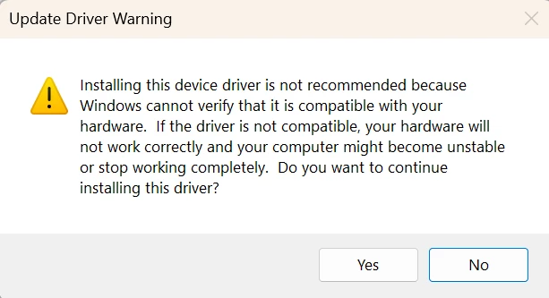

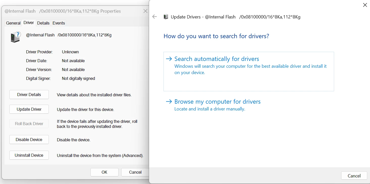

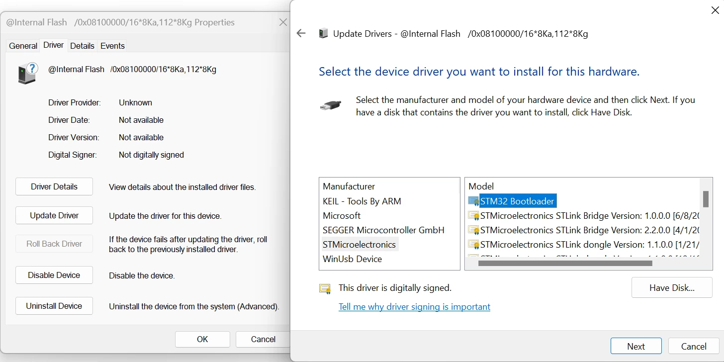

3.2 Troubleshooting DFU enumeration
In case you see this, you can troubleshoot the following issue: DFU is not enumerated correctly,
You can update the driver:
FBL_3-1739901797824.pngFBL_4-1739901828226.pngFBL_5-1739902026136.pngFBL_6-1739902056230.png
Now that the device is recognized as both an HID and DFU device without any issue.
