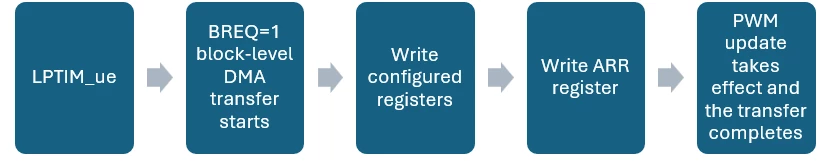

The LPTIM update-event DMA request is a GPDMA block request used to update PWM-related timer registers in a single hardware-triggered transaction. When enabled, it allows the DMA to perform up to three single writes to the low-power timer. It targets up to two of LPTIMx_CCR1, LPTIMx_CCR2, and LPTIMx_RCR, followed by a mandatory write to LPTIMx_ARR to update the PWM period.
This mechanism relies on a dedicated hardware request connection between the LPTIM and the GPDMA, typically configured with BREQ = 1 and SWREQ = 0 in the selected GPDMA channel. In this mode, the request is handled at block level, meaning one LPTIM update event can trigger the complete register update sequence without CPU intervention.
 To support this block-based transfer pattern, a 2D-capable GPDMA channel is used. CxBR1 defines the block-repeat count and direction, and CxBR2 defines the source and destination address offsets used to step through the register sequence.

Below is a simple diagram that explains the process:

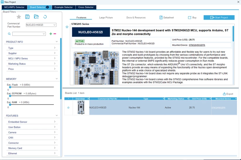

Start by creating a new project using the STM32CubeMX by clicking [File -> New -> STM32 Project]. Use the [Board Selector] tab and select the [Nucleo-H563].

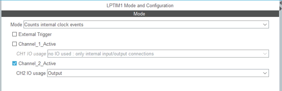

Once the project creation is done, enable LPTIM1 by selecting counts internal trigger mode and enable a second channel with CH2 I/O usage as output.

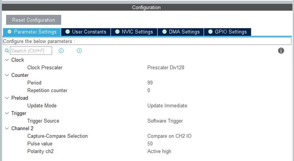

In the “Parameter Settings”, select Prescaler Div128.
Set the “Period” to 99.
Set the “Pulse Value” to 50.

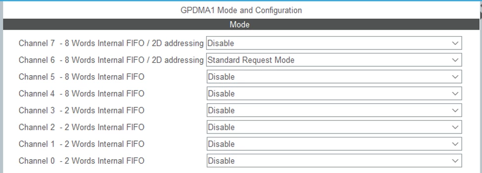

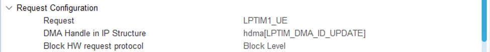

  • In GPDMA1 under “system core”, enable Channel 6 as the “Standard Request Mode”.
  • Under Request Configuration, set “Request” to “LPTIM1_UE”.

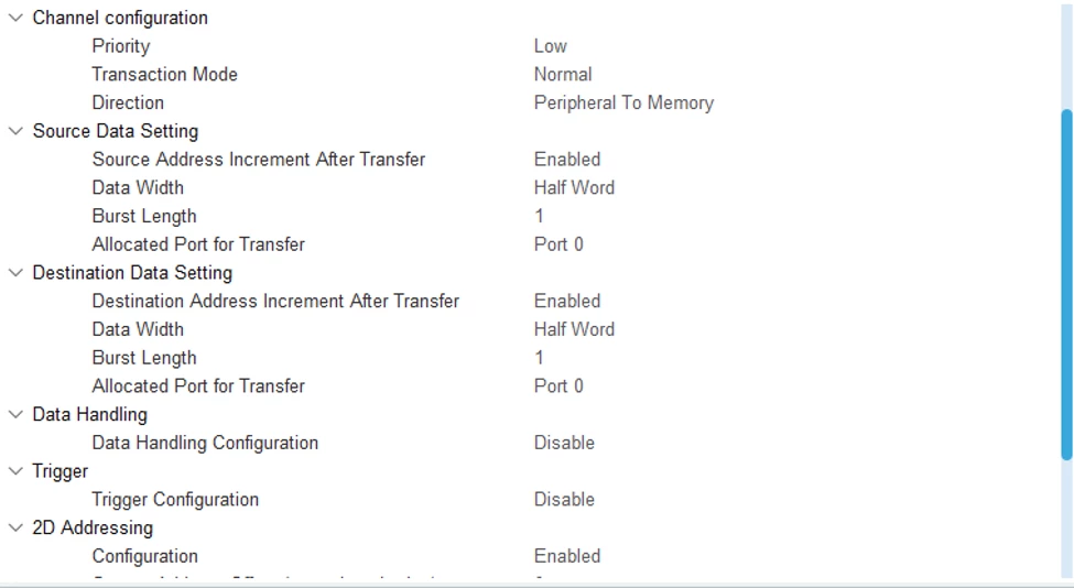

  • Under Channel Configuration, set “Peripheral to Memory” to “Direction”.
  • Under Source Data Setting, set “Source Address Increment After Transfer” to “Enabled”. Set the “Data Width” to “Half Word”.
  • Under Destination Data Setting, set “Destination Address Increment After Transfer” to “Enabled”.
  • Set the “Data Width” to “Half Word”.
  • Finally, set 2D Addressing to “Enabled”.

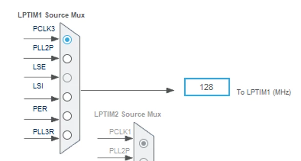

In clock configuration, ensure that LPTIM1 is at 128 MHz so it aligns with the selected prescaler value.

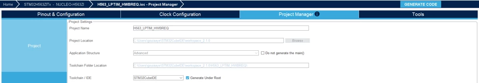

Name the project and generate the code.

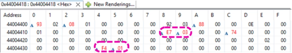

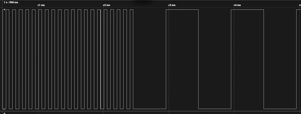

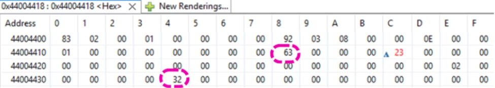

If a logic analyzer or an oscilloscope is used to visualize the signal, both CCR and ARR change during a single synchronized DMA event. In this case, the signal from PG14 can be visualized.
By opening the memory map view, it is possible to observe that before calling:
__HAL_LPTIM_ENABLE_DMA(&hlptim1, LPTIM_DMA_UPDATE);
LPTIM1_CCR2 (address 0x44004434) and LPTIM1_ARR (address 0x44004418) hold the values 0x63 and 0x32, which are equivalent to 99 and 50 in decimal, respectively.
After calling:
LPTIM1_CCR2 holds the value 0x1F4, which is equivalent to 500 in decimal, and LPTIM1_ARR holds the value 0x3E7, which is equivalent to 999 in decimal.
