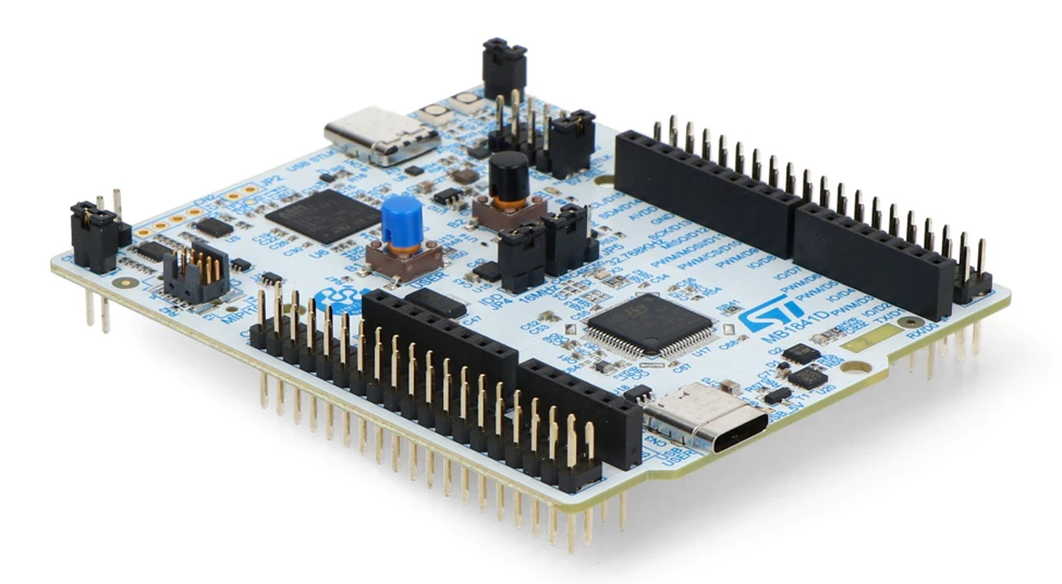

For this article, the NUCLEO-U545RE-Q board is used to implement this application and can be easily tailored to any other STM32. This board features an STM32U545RET6Q microcontroller. For further details about the board, refer to the user manual.
STM32U5 Nucleo-64 boardSTM32U5 Nucleo-64 board

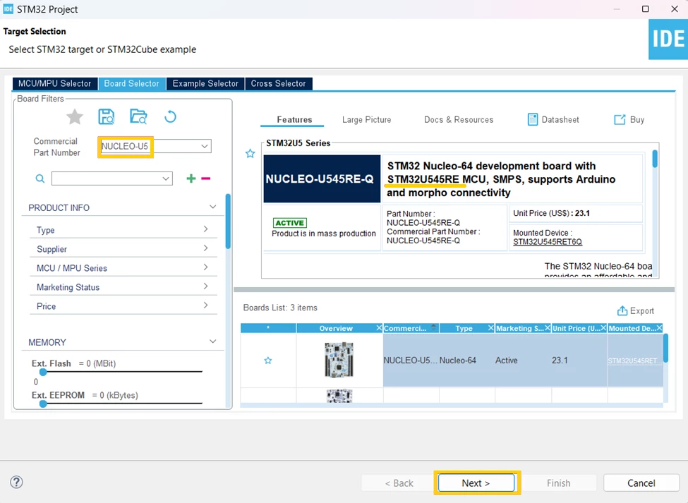

1.1 Create a project

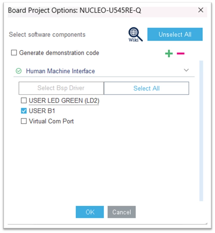

Start a new project in STM32CubeIDE by selecting File → New → STM32 Project. Navigate to the [Board Selector] tab and choose [NUCLEO-U545RE-Q].
After clicking the [Next] button, tick the [USER B1] box in the Board project options.
Board project optionsBoard project options

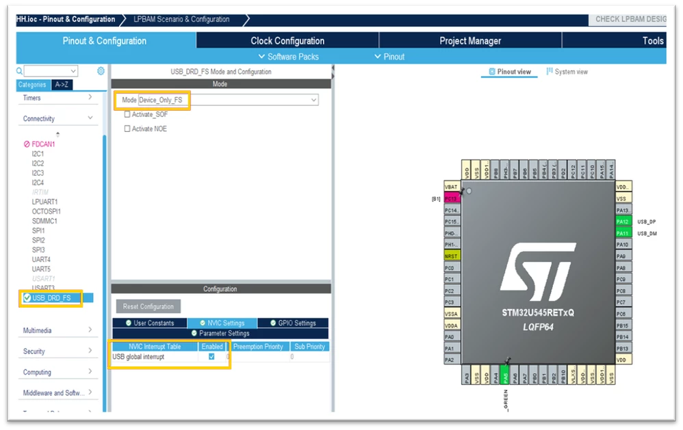

After creating the project, navigate to the [Connectivity] section, enable the USB peripheral [USB_DRD_FS] in [Device Only mode], and activate the USB global interrupt in the NVIC settings.

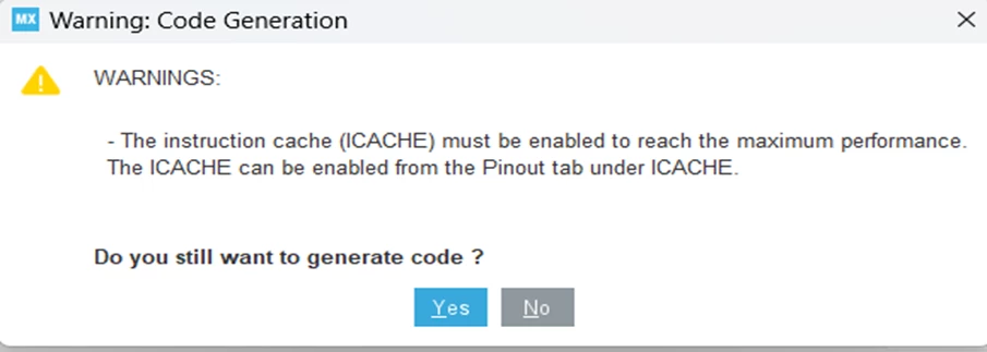

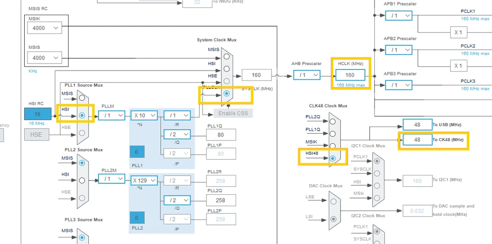

The final step before generating the code is to update the system clock frequency. According to the reference manual, the USB peripheral requires a minimum clock frequency of 48 MHz to avoid data overrun and underrun issues. For this example, the clock frequency is set to the maximum allowable value to achieve optimal performance.
Afterwards, the instruction cache (ICACHE) must be disabled in our project.

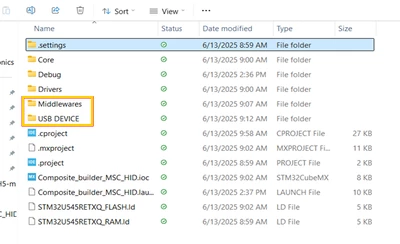

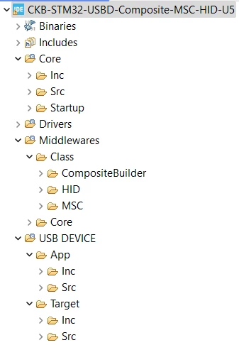

1.2 Add the middleware layer
First, add new folders named Middlewares and USB DEVICE to the project workspace directory.
After that, refresh the project to update and include the newly added folders.
Added foldersAdded folders

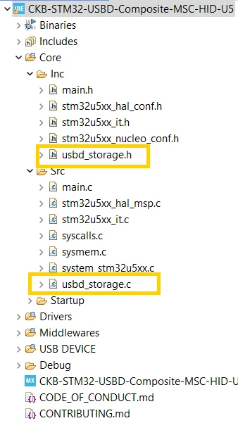

And these are the source files modified for my specific application. You can directly clone them from your application.
File name  Source of files  Destination
usbd_def.h usbd_def.h  USB Device/App/Inc
usbd_desc.h usbd_desc.h
usbd_desc.c
usbd_desc.c  USB Device/App/Src
usbd_conf.h
usbd_conf.h  USB Device/Target/Inc
usbd_conf.c
usbd_conf.c  USB Device/Target/Src
usbd_storage.h
usbd_storage.h  Core/Inc
usbd_storage.c  usbd_storage.c  Core/Src

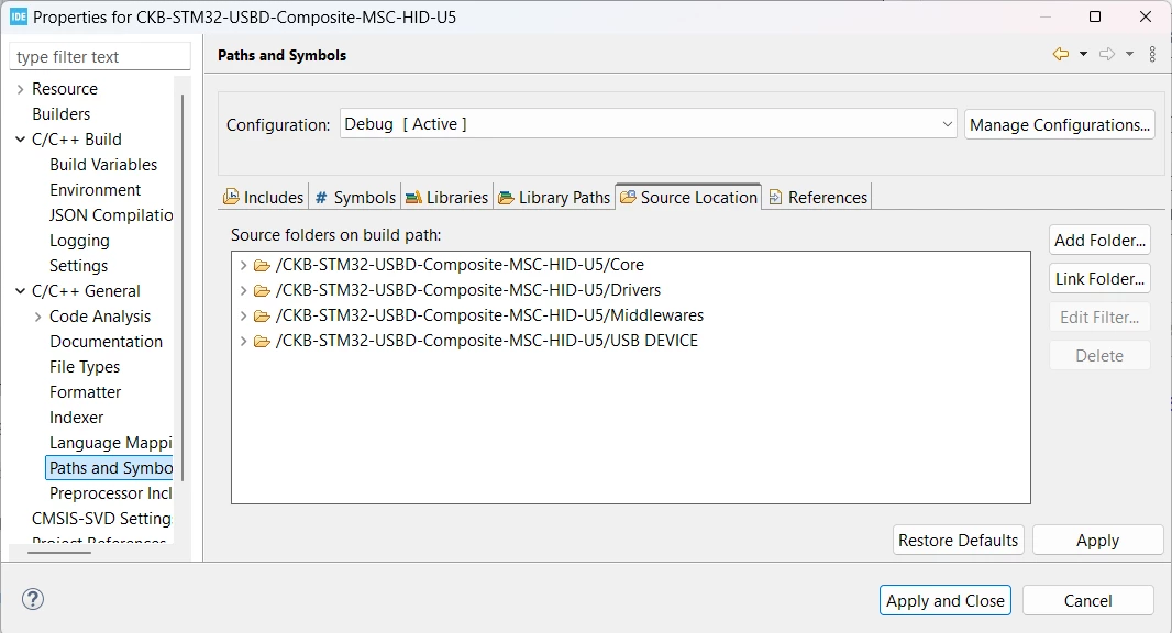

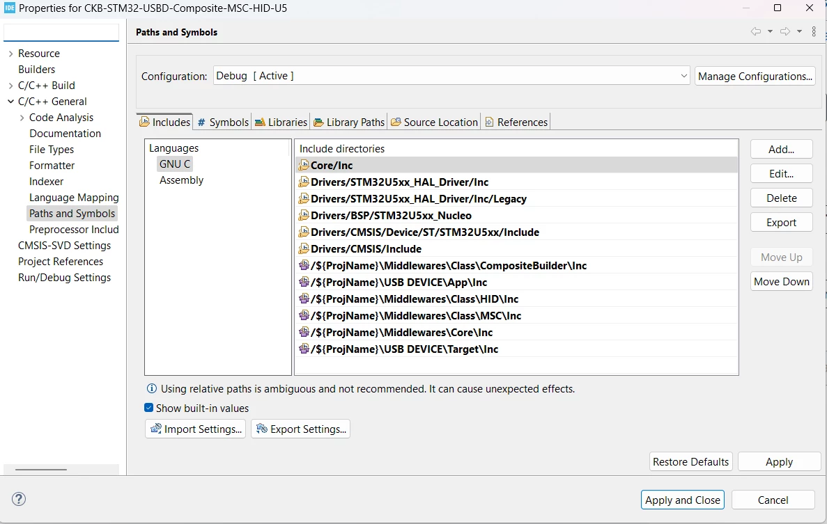

After adding all the files, Under Properties → C/C++ General → Paths and Symbols, ensure to add related the file source under [Source Location].
Build configurationBuild configuration
Under [Includes], add the middleware header files.
After adding all the necessary files and including them in the compilation toolchain, Proceed to modify the necessary files for the application.

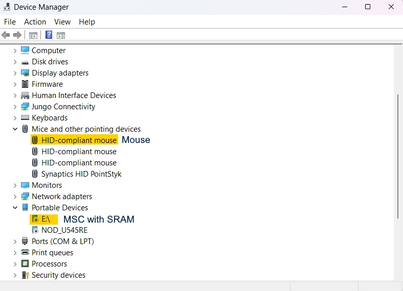

3. Results
After successfully building and flashing the application onto theNUCLEO-U545RE-Q board, connect the board to the PC using the USB user connector. The host PC recognizes the composite USB device as both a mass storage device and an HID mouse.
Now, you can press the blue USER button on the board to see the mouse pointer move on the screen. When opening the file explorer, notice the new USB drive that represents the mass storage device.
As we can see, both USB classes operate simultaneously, demonstrating the successful implementation of the composite device (MSC+HID).
