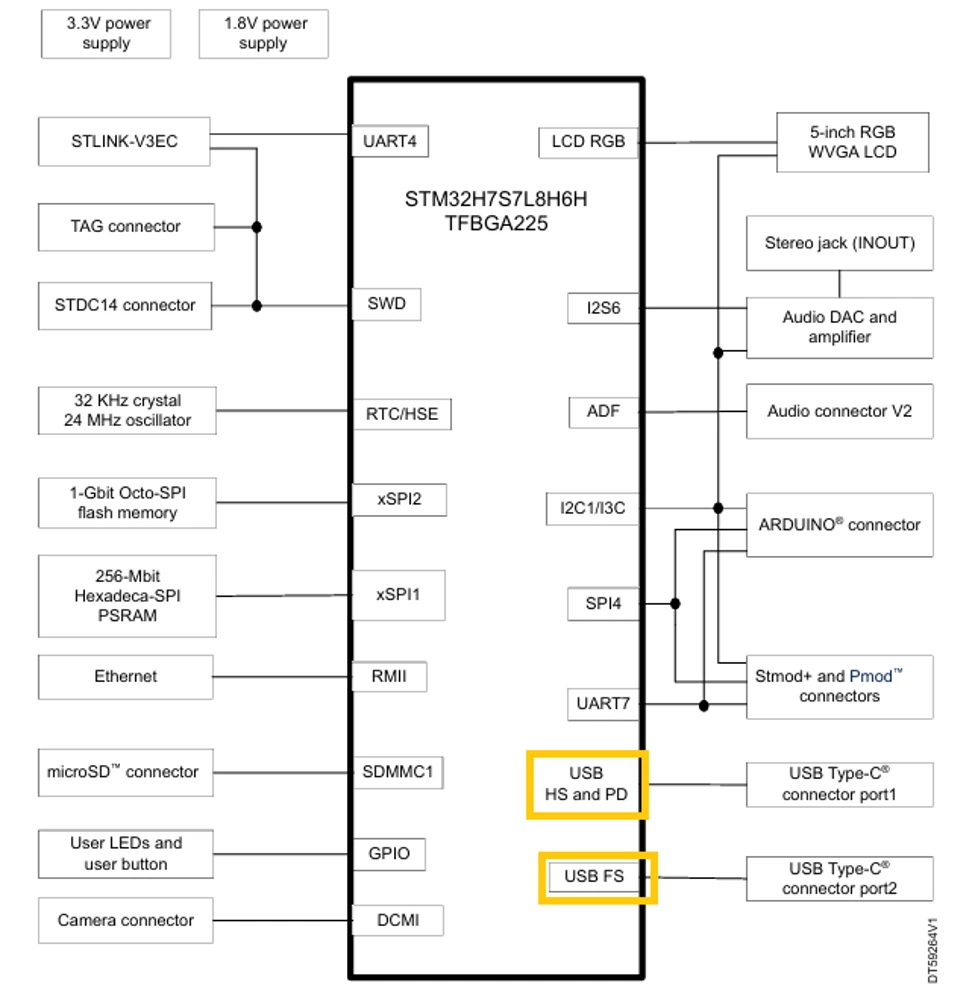

This article describes the implementation of a dual-instance host USB application on an STM32 microcontroller. The goal is to demonstrate that each USB instance operates independently and manages its own class.
This article provides a step-by-step workflow to set up, generate, and adapt the USB application. STM32CubeMX is used to generate the code with CMake and STM32CubeIDE is used to develop the application. It covers USB host core, class assignment to each instance, project generation, and integration in a STM32CubeIDE environment.

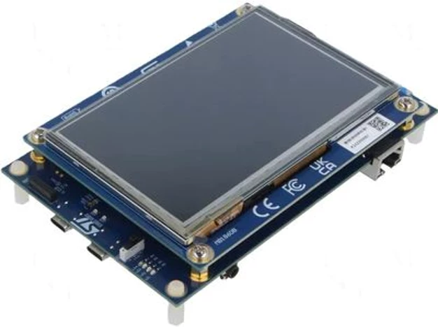

For this article, the STM32H7S78-DK board is used to implement this application. This board features an STM32H7S7L8 microcontroller, which integrates a dual-instance USB core (USB High-Speed and USB Full-Speed). For further details about the board, refer to the user manual.
STM32H7S78-DK

1.1 STM32H7S78-DK overview
The STM32H7S78-DK board used in this application includes 64 KB of boot flash memory. This memory allows the system to boot from and run applications stored in external memory. In this configuration, the application is typically divided into at least two subprojects: [Boot], which manages the initial startup and external memory initialization, and [Appli], which contains the main application code executed from external memory.

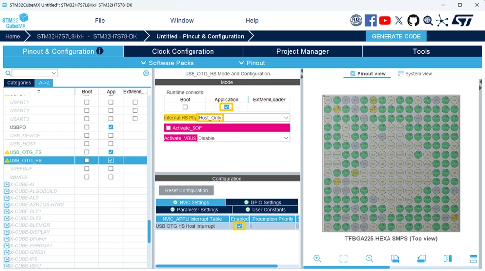

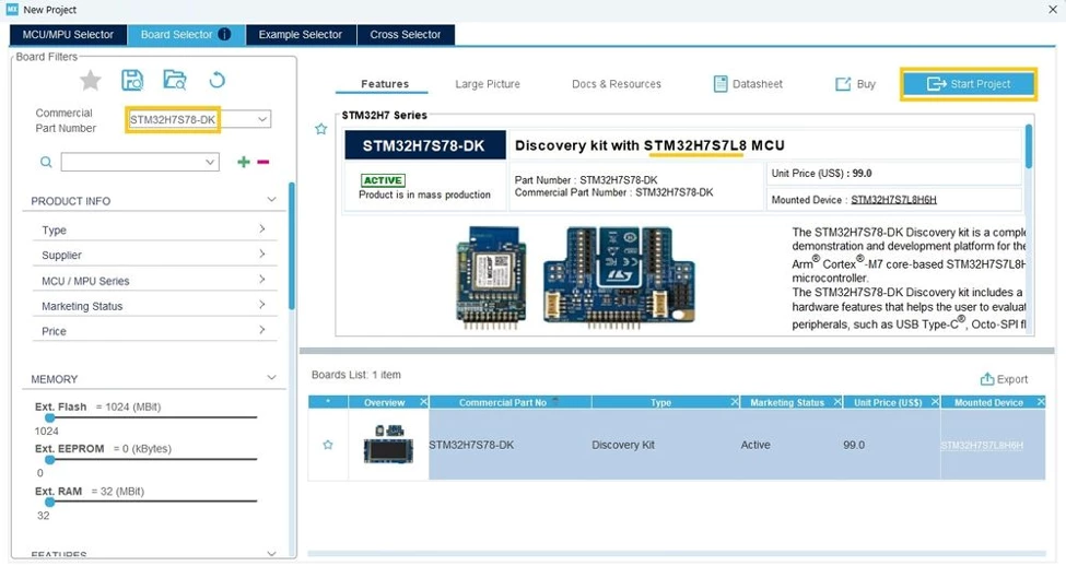

1.2 STM32CubeMX configuration
Start a new project in STM32CubeMX by selecting [File] → [New Project]. Navigate to the [Board Selector] tab and choose [STM32H7S78-DK].
Board project options
After clicking the [Start Project] button, click [Yes] in the Board Project Options dialog box.
Memory protection unit prompt for Cortex®-M7

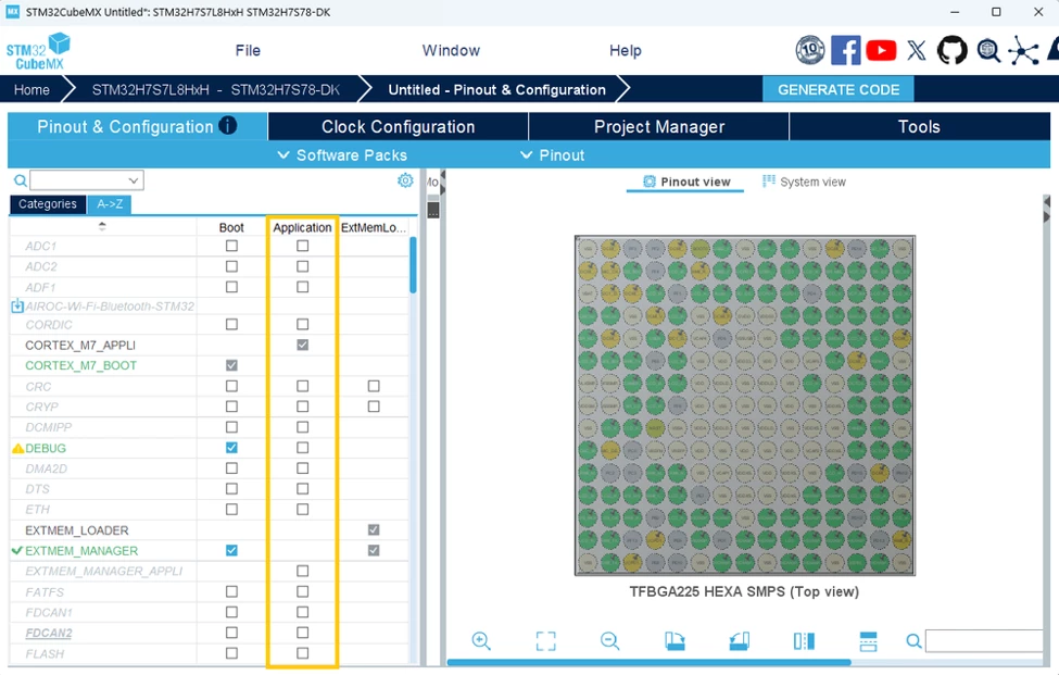

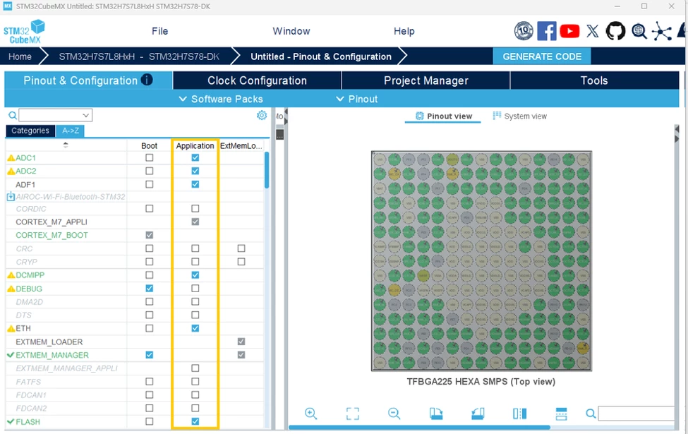

After the project is created, open the Categories view A->Z in CubeMX.
In this table, separate columns for Boot, Application, and ExternalMemoryLoader are shown.
For this tutorial, keep the Boot and ExternalMemoryLoader configuration as provided by the default CubeMX board settings. Focus on the Application configuration to set up a custom application.

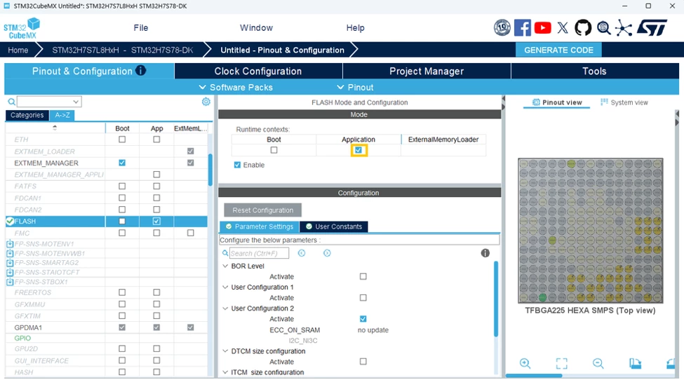

First, in the Application column, manually uncheck all enabled IPs.
Pinout and configuration view

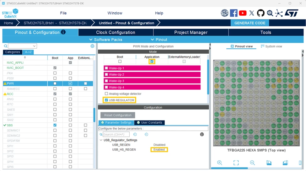

At this stage, we are ready to start enabling and configuring the IPs related to the application.

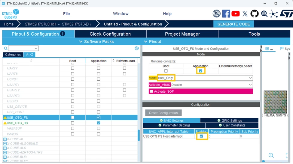

  1. Enable dual-instance USB

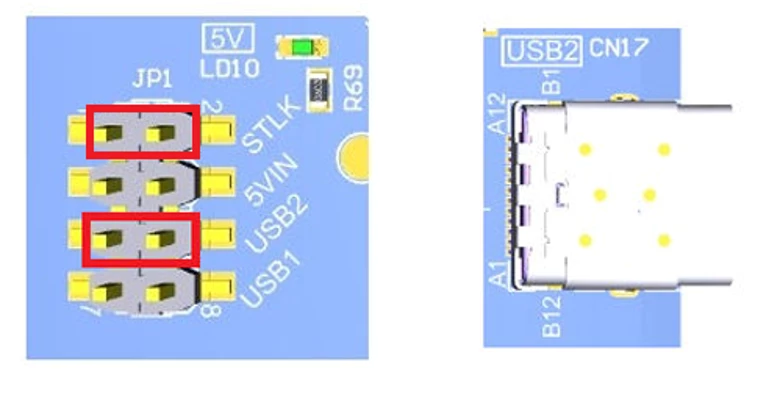

On the STM32H7S78-DK board, Two USB instance-capable interfaces are available: one USB Full-Speed (FS) instance and one USB High-Speed (HS) instance. The board layout provides separate connectors and power-routing support for each USB path, allowing the application to use both instances independently.
To supply VBUS power to the device connected to the first USB2 (FS) instance, the board is configured as follows: the JP1 jumpers are set so that the 5 V rail is routed to the USB_FS VBUS line on the USB2 (Type-C) connector. This configuration allows the board to power the attached USB FS device when operating in host mode.
USB FS POWER

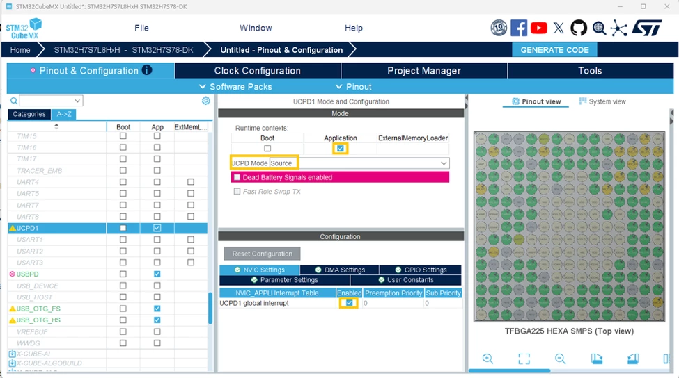

For USB1 (USB Type-C® high-speed, dual-role port), the USB PD controller is typically used in source mode to supply VBUS power to the connected USB device.

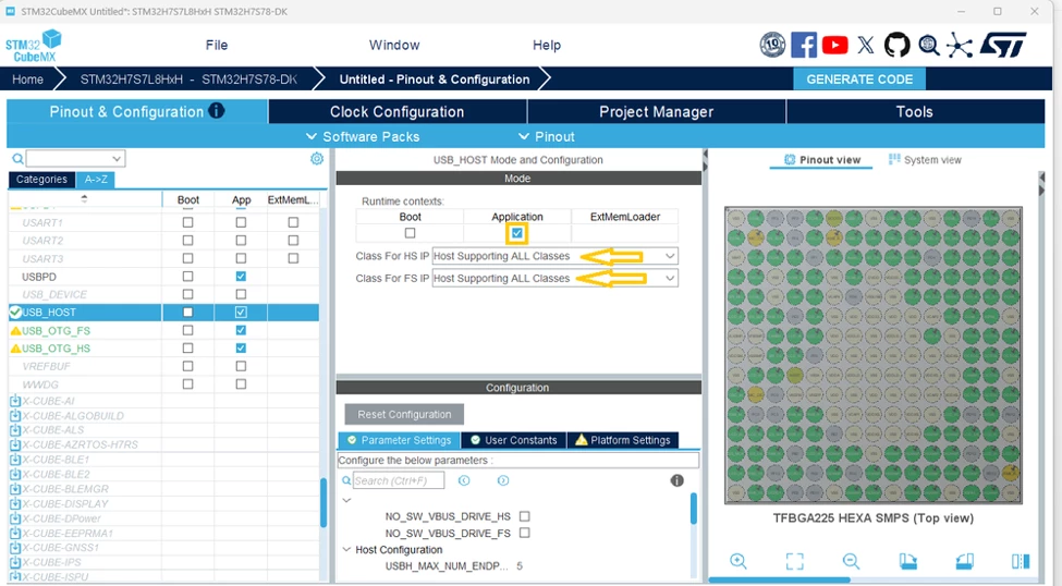

  • USB_OTG_FS
  •  USB_OTG_HS
  •  USB_HOST
In this step, we configure the USB FS and USB HS instances as host supporting all classes, such as HID, MSC, audio, and CDC.

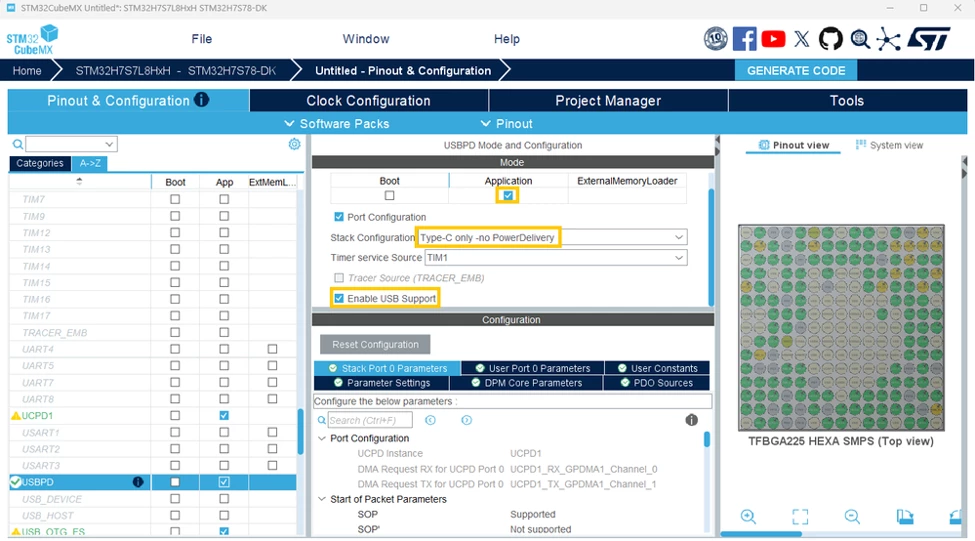

  1. USB-PD configuration

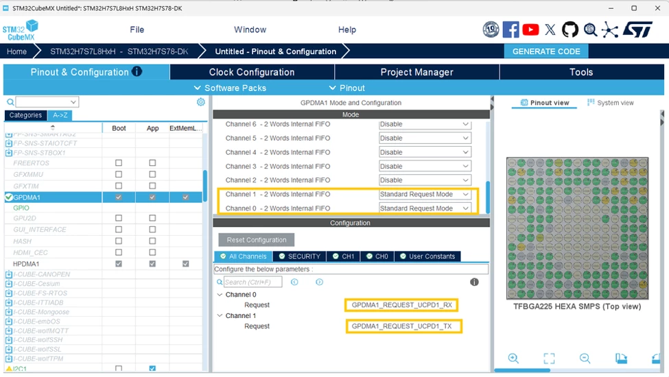

  •  UCPD1
  • GPDMA1
  • USBPD
  • PWR

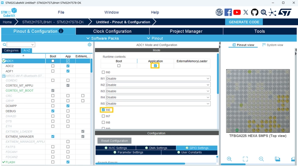

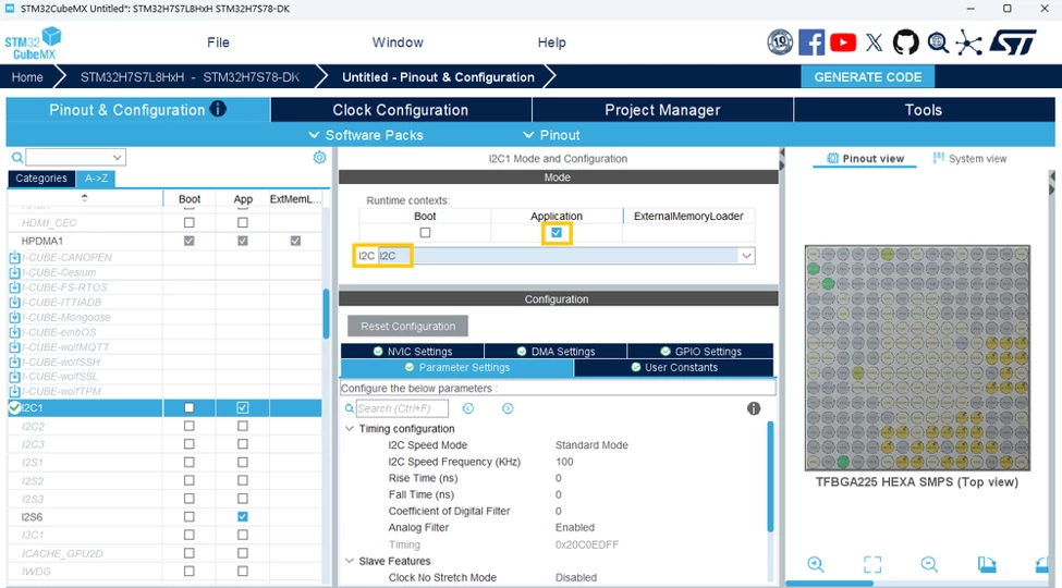

Add the activation of I2C1 and ADC1, which are required to enable VBUS and to detect devices connected to the USB1 port.
  • ADC1
  • FLASH
  • I2C1

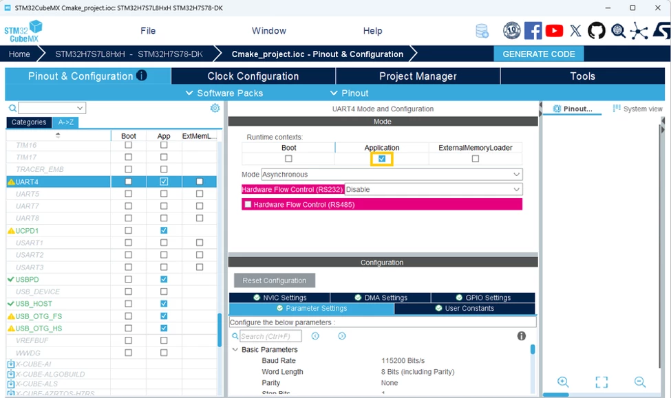

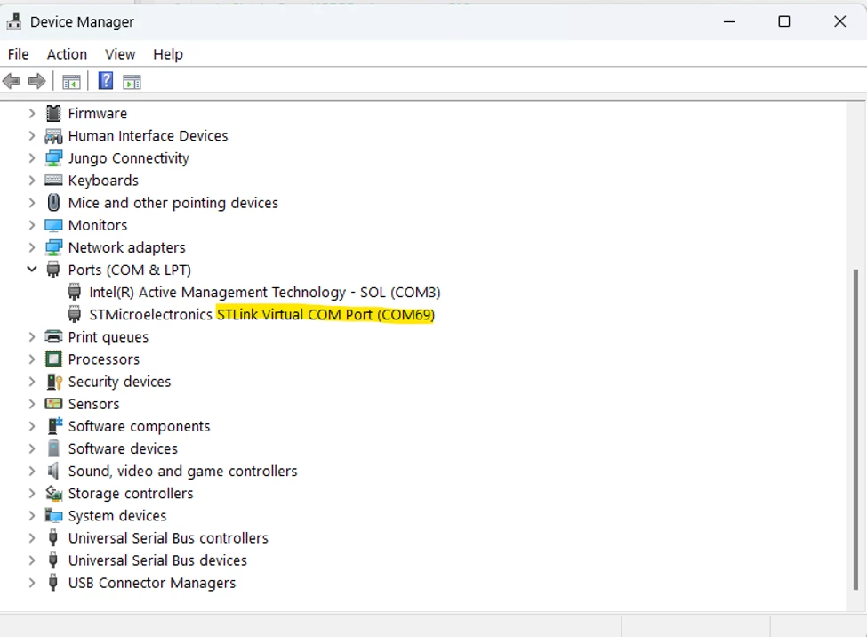

Add the UART4 configuration related to the VCOM of the board to enable viewing messages from the USB enumeration using any HyperTerminal.
  • UART4

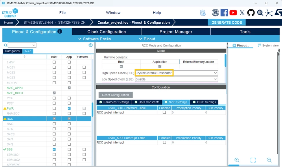

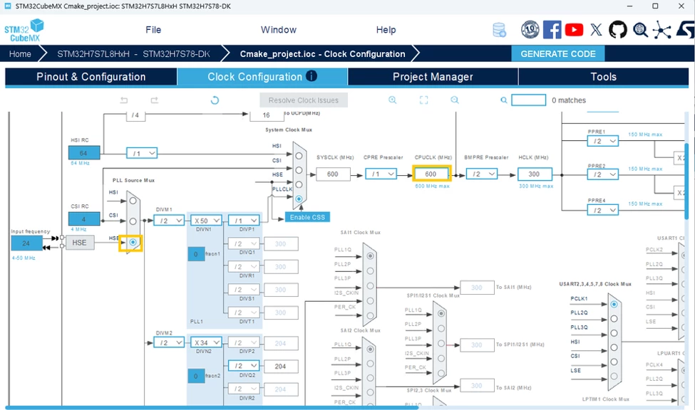

  • RCC
  • Clock configuration

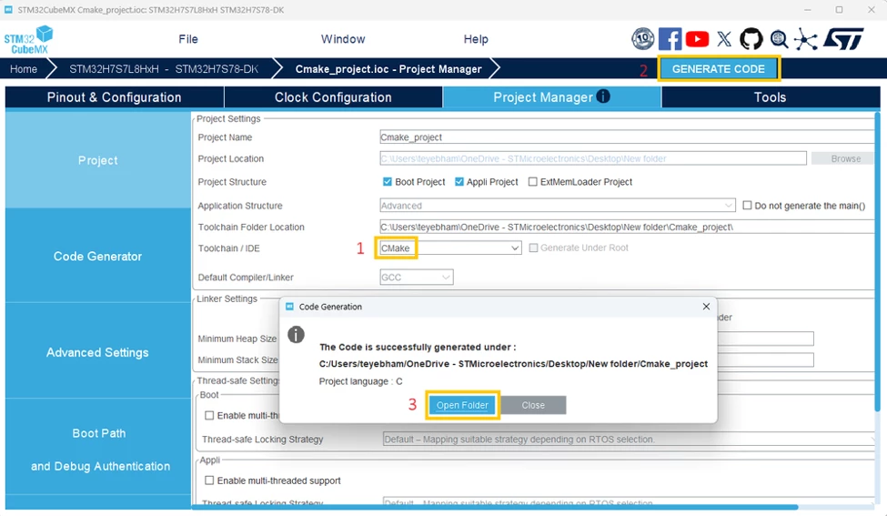

            3.Select CMake as the Toolchain
Now that all configuration is completed for the application, open [Project Manager] and select [CMake] as the toolchain, then click [GENERATE CODE].
 After all steps are completed, use STM32CubeIDE to finalize the configuration, build, and run the application. To import the project, refer to the application note “How to use CMake in STM32CubeIDE.” The application note lists all the steps, but you can follow the steps below if needed.

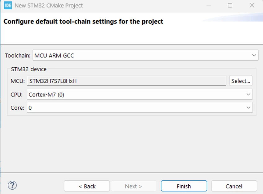

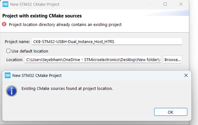

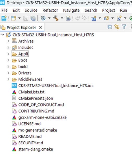

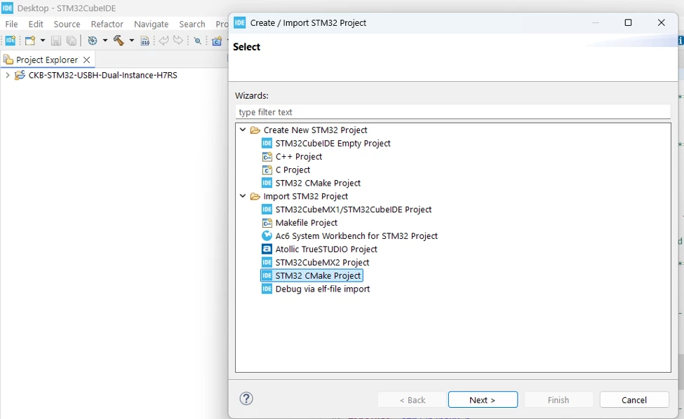

           4.Import the STM32 CMake Project into STM32CubeIDE
Open STM32CubeIDE, click [File] → [Create/Import STM32 Project], and select [Import STM32 CMake Project].
The “New STM32 CMake Project” prompt appears. Enter the project name and browse to the project location, as shown below.
Set the toolchain to [MCU ARM GCC] and select the [STM32H7S7L8HxH] MCU.

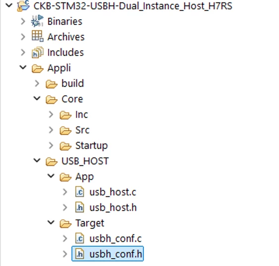

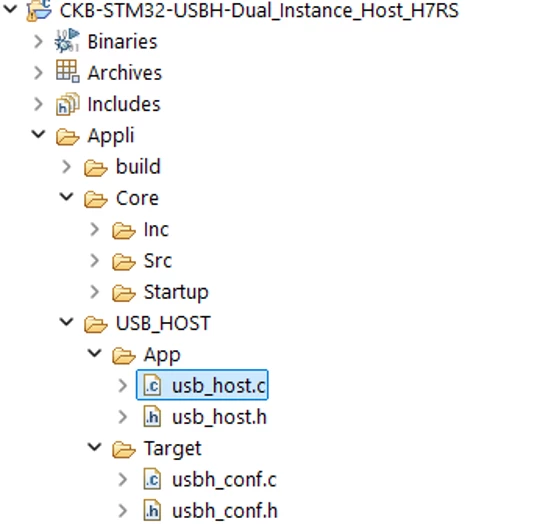

After opening the project with STM32CubeIDE, the project architecture should appear as shown below
2. Develop your own project
Now, focusing on the [Appli] part to complete the development of the application. We start with the USB HOST configuration.

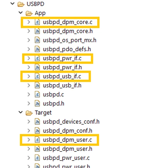

  1. USBPD
Below is the list of files that are modified to activate VBUS for USB HS instance.
  • usbpd_dpm_core.c
 In this file, we modify the USBPD_DPM_Run function.
//do{
if ((HAL_GetTick() - DPM_Sleep_start[USBPD_PORT_COUNT]) >= DPM_Sleep_time[USBPD_PORT_COUNT])
DPM_Sleep_time[USBPD_PORT_COUNT] = USBPD_CAD_Process();
DPM_Sleep_start[USBPD_PORT_COUNT] = HAL_GetTick();
USBPD_DPM_UserExecute(NULL);
//} while (1u == 1u);
 Comment out the do ... while loop since it’s not needed to stop in this function.
  • usbpd_dpm_user.c
In the USBPD_DPM_UserCableDetection function, uncomment these lines to enable cable detection.
void USBPD_DPM_UserCableDetection(uint8_t PortNum, USBPD_CAD_EVENT State)
/* USER CODE BEGIN USBPD_DPM_UserCableDetection */
switch(State)
case USBPD_CAD_EVENT_ATTACHED:
case USBPD_CAD_EVENT_ATTEMC:
if (USBPD_OK != USBPD_PWR_IF_VBUSEnable(PortNum))
/* Should not occur */
HAL_Delay(6000);
NVIC_SystemReset();
break;
case USBPD_CAD_EVENT_DETACHED :
case USBPD_CAD_EVENT_EMC :
default :
if (USBPD_OK != USBPD_PWR_IF_VBUSDisable(PortNum))
while(1);
break;
/* USER CODE END USBPD_DPM_UserCableDetection */
Uncomment the commented switch cases in this function to process the USB PD notification events.

  • usbpd_usb_if.c
Add the USB HS start sequence in the USBPD_USBIF_HostStart function.
void USBPD_USBIF_HostStart(uint32_t PortNum)
/* USER CODE BEGIN USBPD_USBIF_HostStart */
if (USBH_Start(&hUsbHostHS) != USBH_OK)
Error_Handler();
USBPD_TRACE_Add(USBPD_TRACE_DEBUG, PortNum, 0, (uint8_t *) "USBIF host start", 16);
/* USER CODE END USBPD_USBIF_HostStart */
Add the USB HS stop sequence in the USBPD_USBIF_HostStop function.
void USBPD_USBIF_HostStop(uint32_t PortNum)
/* USER CODE BEGIN USBPD_USBIF_HostStop */
if (USBH_Stop(&hUsbHostHS) != USBH_OK)
Error_Handler();
USBPD_TRACE_Add(USBPD_TRACE_DEBUG, PortNum, 0, (uint8_t *) "USBIF host stop", 15);
/* USER CODE END USBPD_USBIF_HostStop */

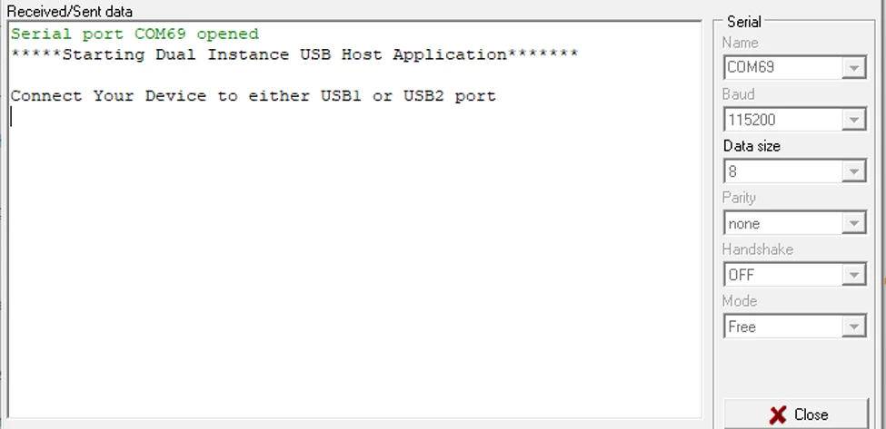

USBH_UsrLog("*******Starting Dual Instance USB Host Application*******\n");
USBH_UsrLog("Connect Your Device to either USB1 or USB2 port");

Modify the debug level value in the file usbh_conf.h, to view the messages from USBH_UsrLog.
#define USBH_DEBUG_LEVEL      2U
Also in the same file, modify the USBH_MAX_SIZE_CONFIGURATION definition to 512U to support audio enumeration.
#define   USBH_MAX_SIZE_CONFIGURATION      512U

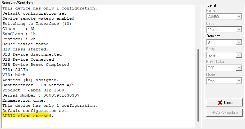

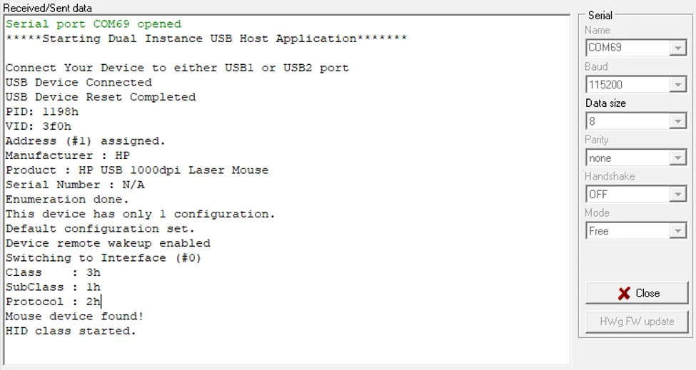

The configuration of the USB FS and HS Host is completed. All supported device classes can be detected, and the state of any connected USB device can be viewed through the HyperTerminal connected to the VCOM port via ST-LINK.
      - Data Length = 8 Bits
      - One Stop Bit
      - No parity
      - BaudRate = 115200 baud
      - Flow control: None

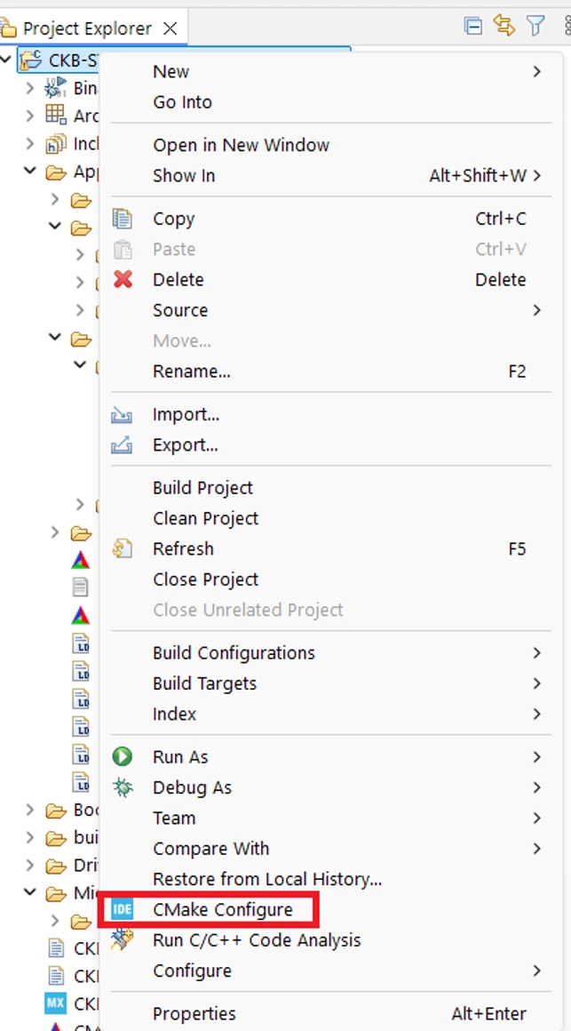

The first step is to update the CMake configuration after adding the paths of the new files.

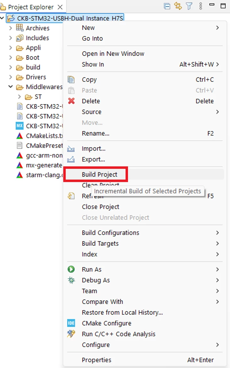

3.2 Build Boot and Appli
  1. Build

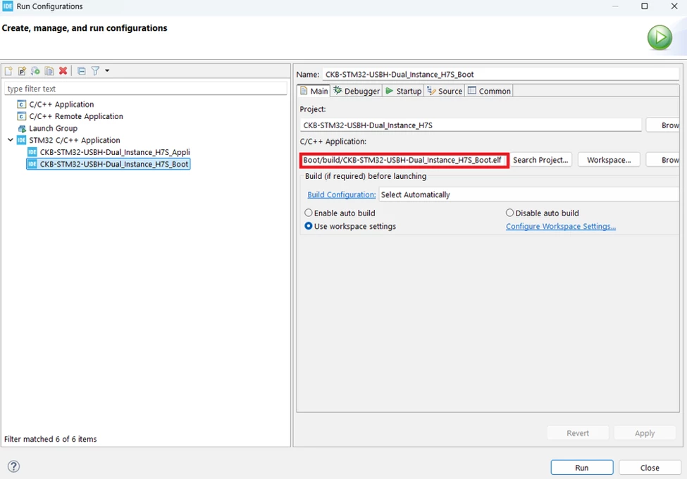

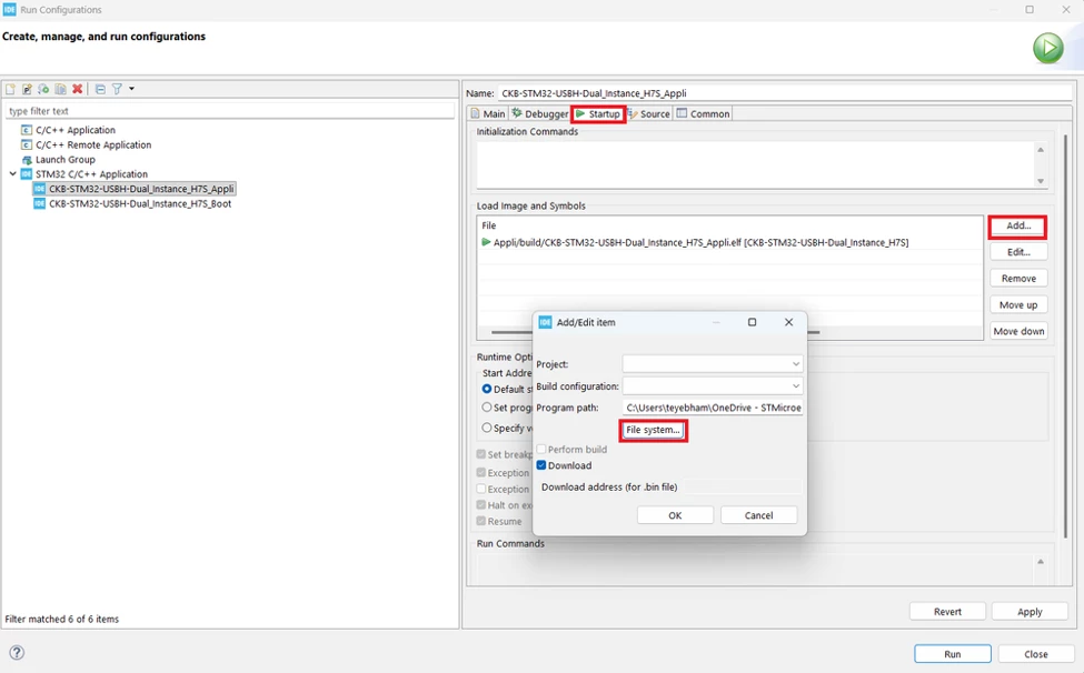

  1. Run Boot and Appli

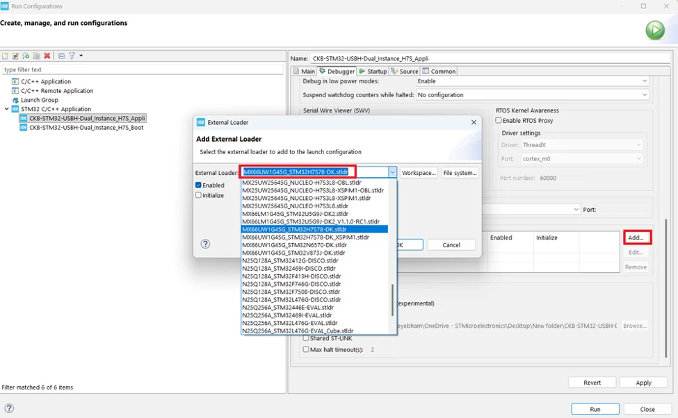

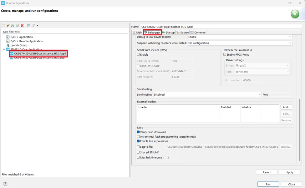

In the debugger configuration, select CKB-STM32-USBH-Dual_Instance_H7S_Appli, then open the Debugger section.
Add the external loader related to the external memory by going to the External loaders section, click [Add…] and select ”MX66UW1G45G_STM32H7S78-DK.stldr”.
Go to the “Startup” section and click [Add…] to include the CKB-STM32-USBH-Dual_Instance_H7S_Boot.elf file in the flashing process.
After completing all the steps and clicking Run, both the Boot and Appli projects will be flashed to the target.

After successfully flashing the application onto the STM32H7S78-DK board, open any HyperTerminal and select the ST-LINK virtual COM port. In my case, it is COM69.
When the board is reset, a message appears in the serial monitor that prompts to pair the device.
I chose the HID device (mouse) to be plugged into the first instance, USB2.
I plugged an audio device into the second instance, USB1.
Both USB instances run correctly, demonstrating the successful implementation of the application. We can also try other devices, such as MSC and CDC devices.
