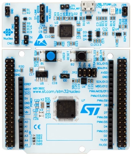

  • NUCLEO-G070RB

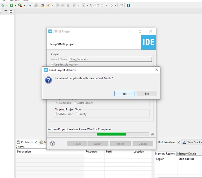

First, we need to create a new project in STM32CubeIDE interface for the STM32G070 board. After creating a new project, go to the Board Selector page and write “NUCLEO-G070RB” in the Commercial Part Number, click on the corresponding board and click on Next.
After that, name the new project created and click on the Finish button. Right after, click on Yes to the pop up about initializing all peripherals.

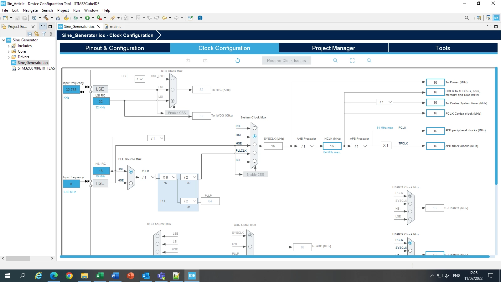

440.png443.pngThe first step is to re-configure the clock that will be used for the TIMER3. Go to the Clock Configuration tab and ensure the HCLK (MHz) has a 16 value.

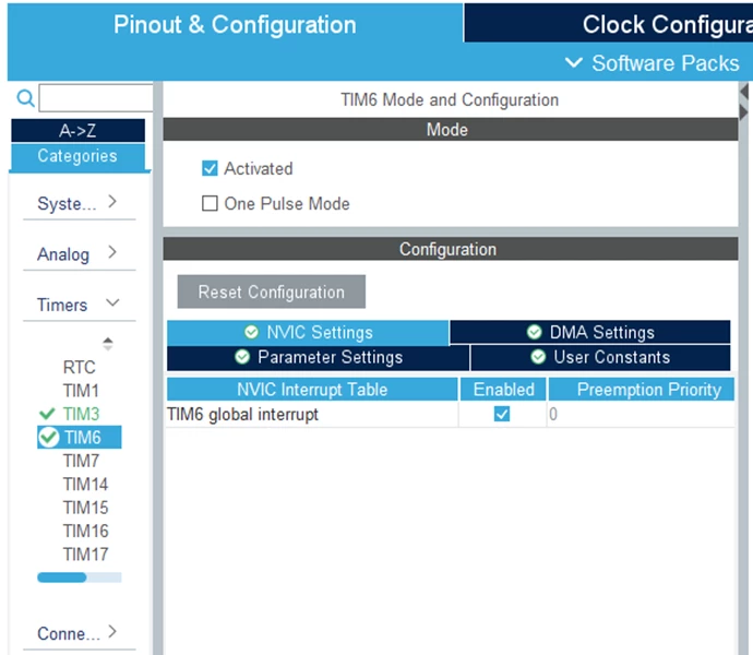

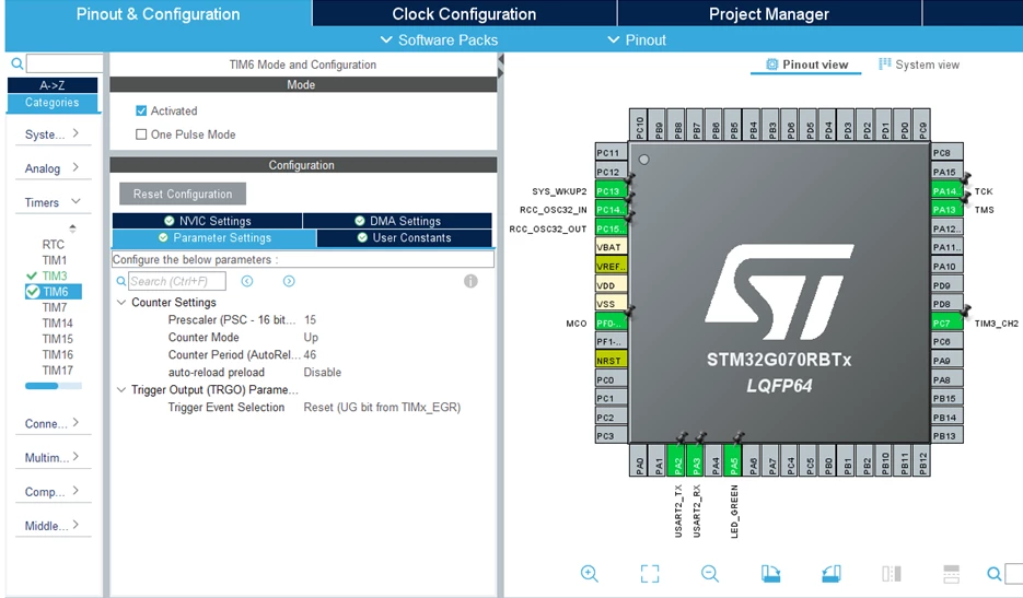

Now, it is time to configure the Auxiliary Timer (TIMER6), used to create the desired frequency by the user input, so it will be a flexible and dynamic configurable timer – it will specify the increment tick to construct the sine wave from the table positions. First, click on the Activate box in the Mode tab. This is the simple formula used to calculate the correct Counter Period got any given frequency received over UART:
Where:
The 360 used is the number of steps taken until the sine wave is completed. Therefore, since the TIM6 Counter frequency is 1MHz and the desirable sine wave frequency is initially 60Hz, that gives a 46 Counter Period initial value.
462.pngAlso check the box to activate the TIM6 global interrupt on the NVIC Settings.

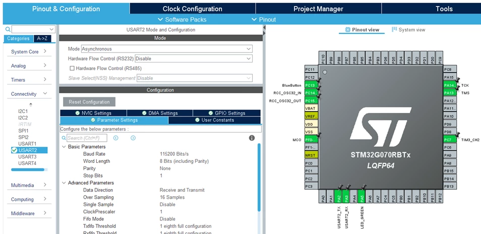

464.pngNow, it is necessary to configure the UART. In the Connectivity, select USART2 and set the Word Length to 8 bits, the Parity to None and the Stop Bits to 1.
467.pngAfter that, check the box in the NVIC Settings to allow the global interrupt.

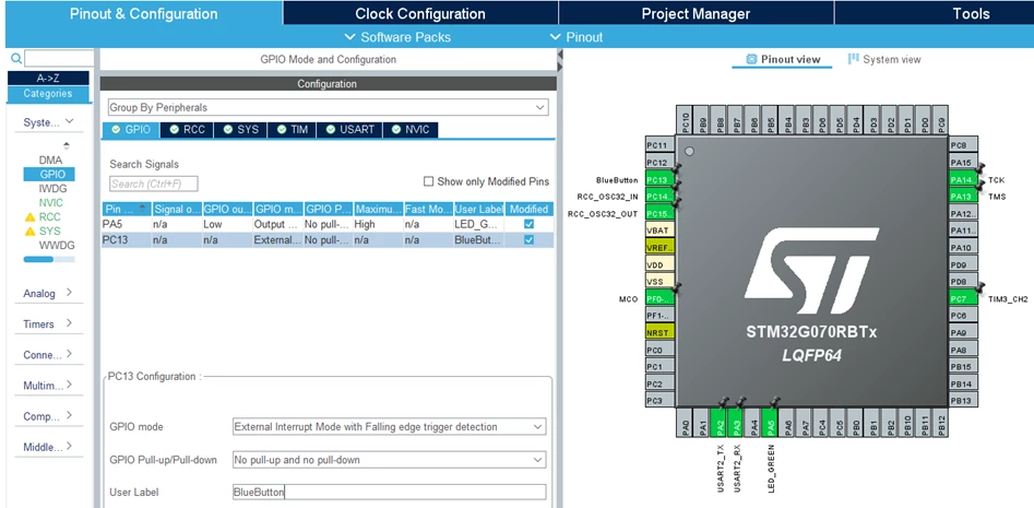

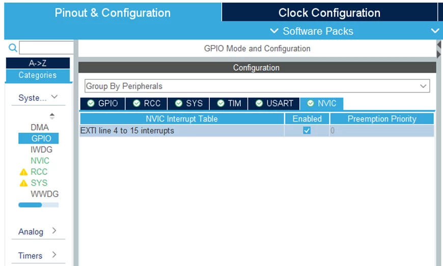

Finally, the only thing that remains is the configuration of the User Button (the blue one), connected to the PC13 pin. Click on the pin PC13 and select GPIO_EXTI13 and go to the System Core, select GPIO and click on the PC13, make sure to use the mode as Falling Edge trigger detection, no pull-up and no pull-down and label it as you wish. The pin will be used to switch the parameter to configure from “frequency” to “amplitude”.
469.pngAfter that, check the box in the NVIC Settings to global interrupt.
