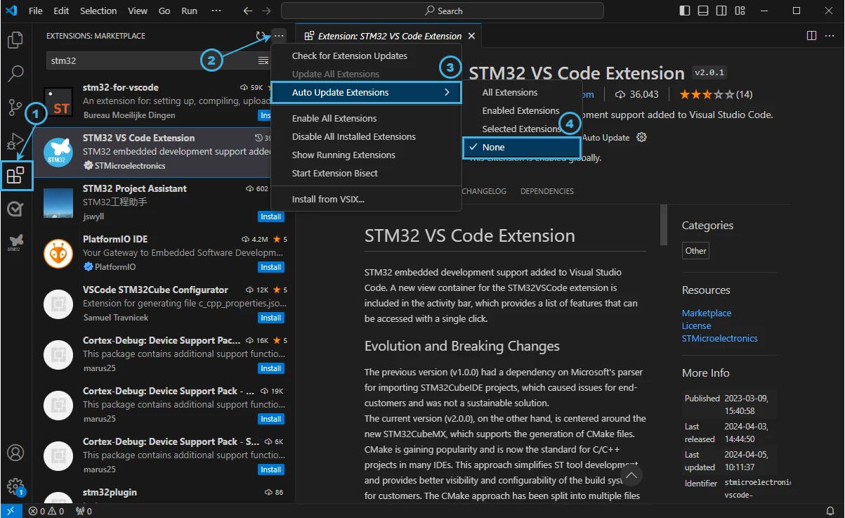

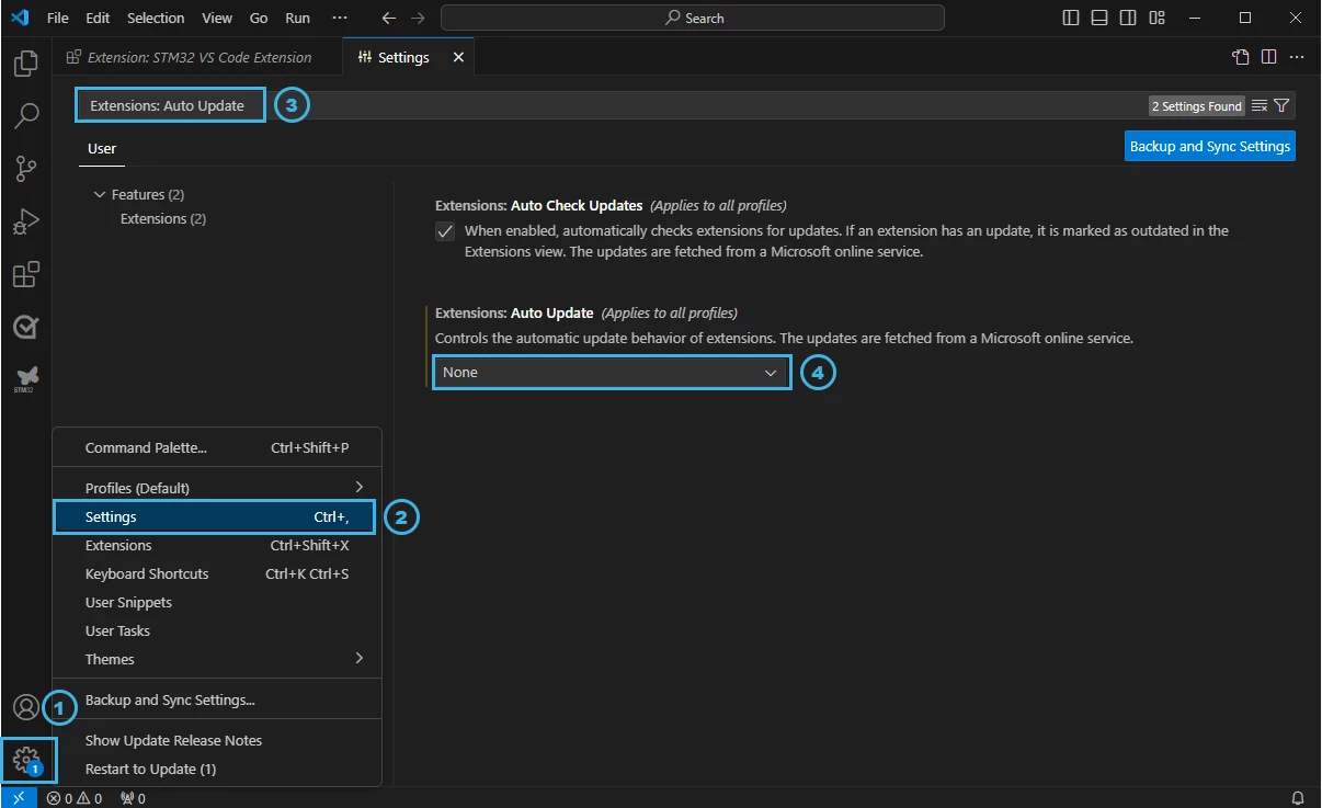

1. Disable extensions auto-updates in VS Code
To avoid extensions update, change the settings "Extensions: Auto Update" in either VS Code Settings editor (Ctrl+,) or directly from the Extensions tab.

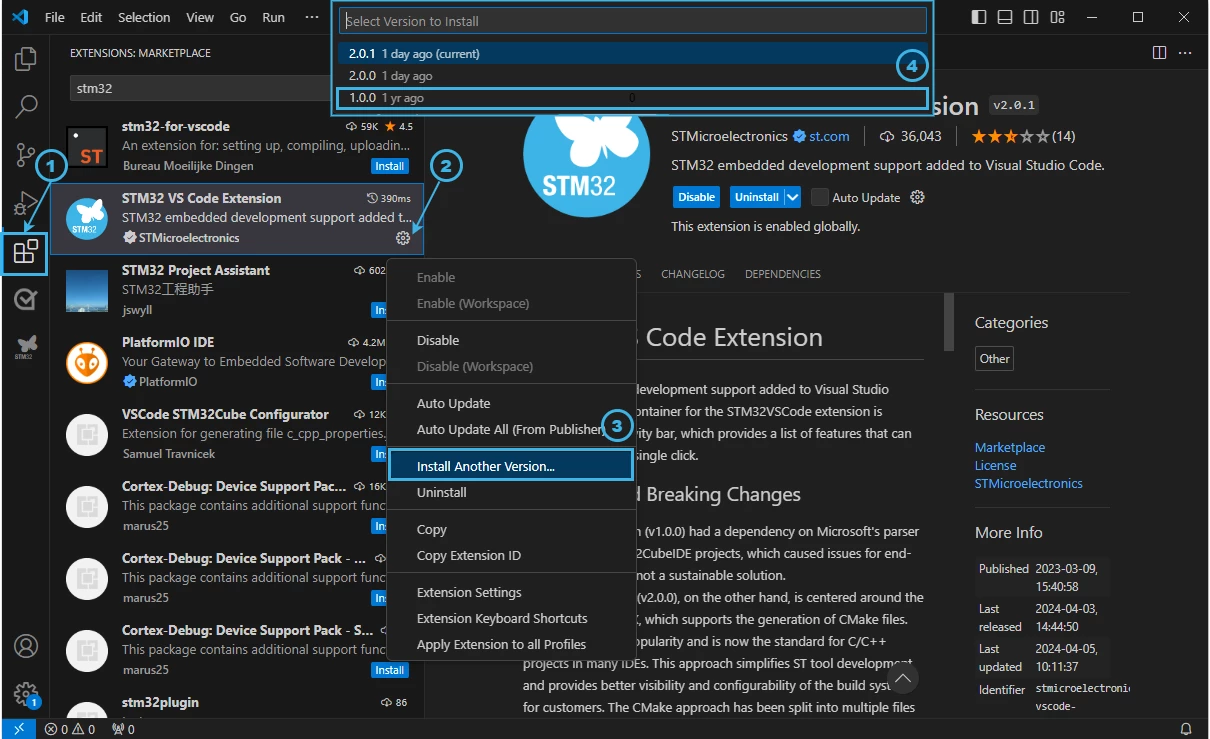

2. Install a previous version of STM32 VS Code extension
In VS Code, users have two options. They can install a new version over the old one, keeping only the latest. Or they can use profiles to keep multiple versions installed.
2.1 Install on the current profile
To install an old version on the current profile:

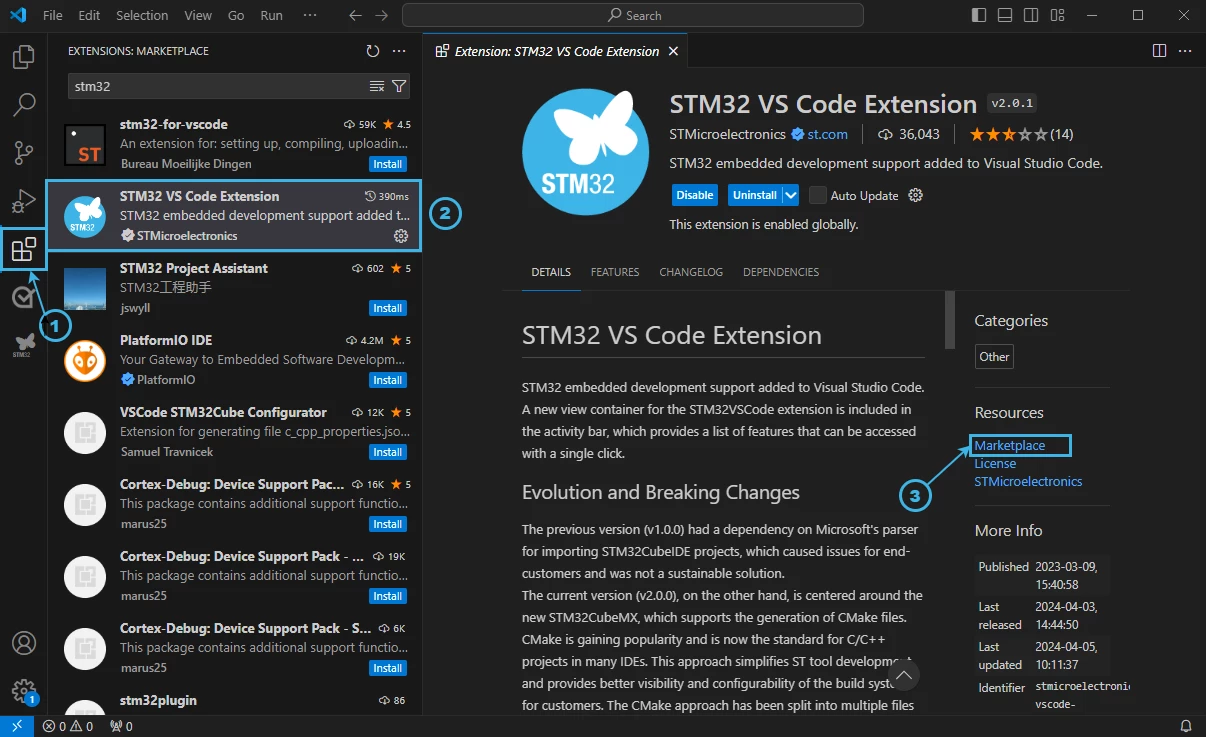

  • Go to the Extensions tab.
  • Pick the STM32 VS Code extension.

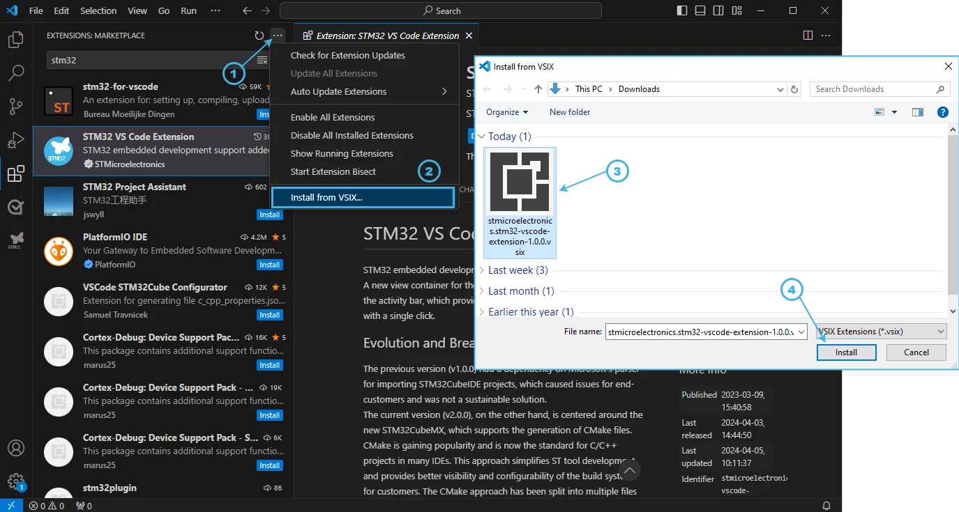

  • Click the gear icon and choose "Install Another Version." A list of versions to select from is then displayed.

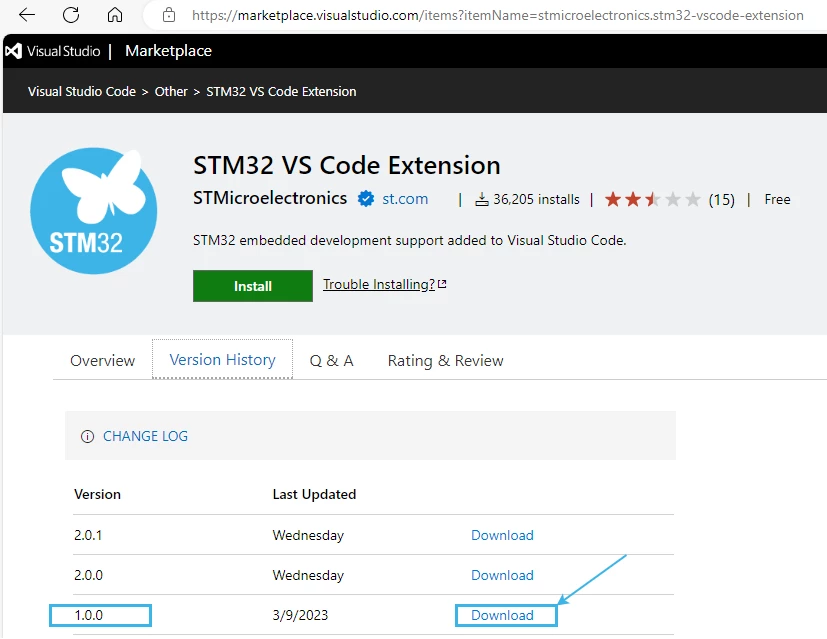

If the version you need isn't listed, get it from the Marketplace and install manually.
  • Go to the VS Code Marketplace from the extension.
  • Download the version that you need.
  • Go back to VS Code and click on "Install from VSIX..."
  • Find and choose the downloaded ".vsix" file, then click "Install" to finish.

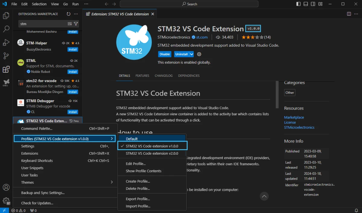

To retain a previous version of the STM32 VS Code extension while installing the latest version, you need to create a new profile by following the steps below:

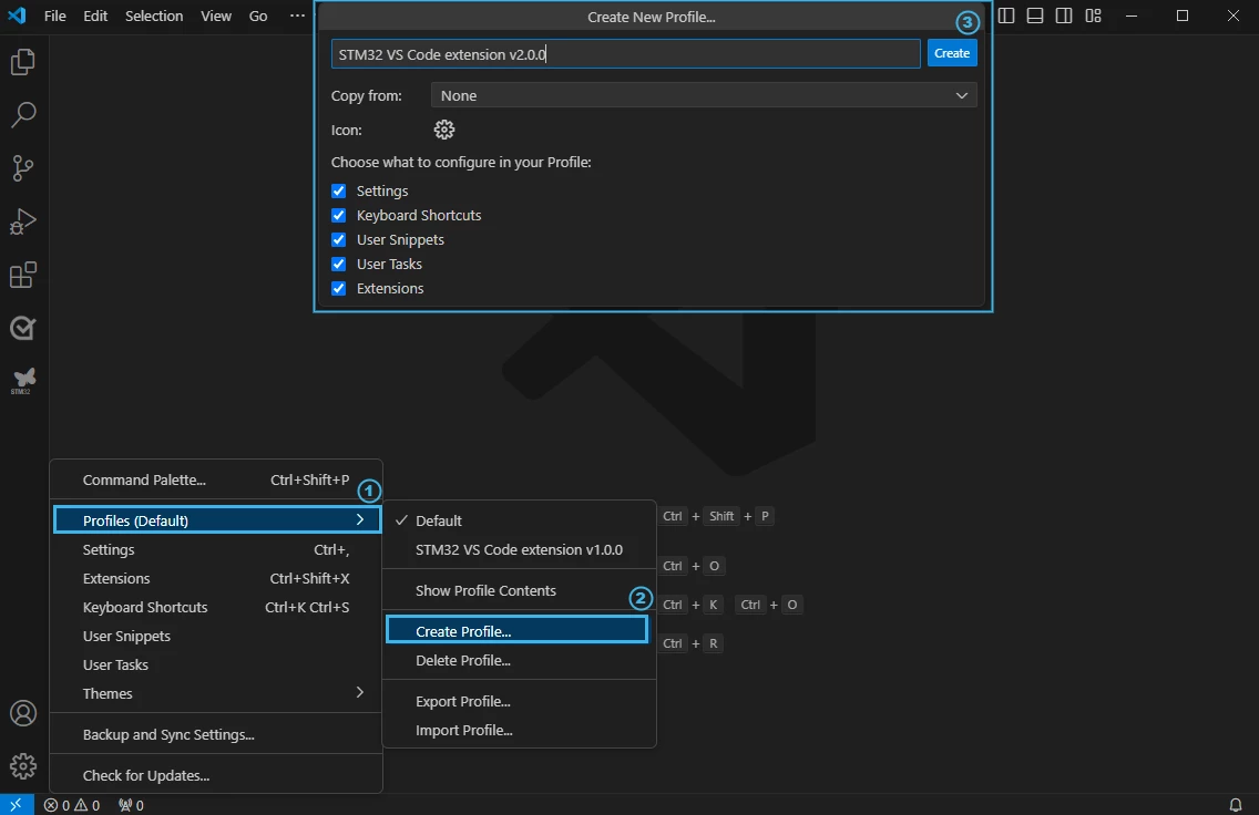

  • Navigate to the VS Code profiles and create a new profile
  • Assign a name to the profile and complete the process by selecting "Create"

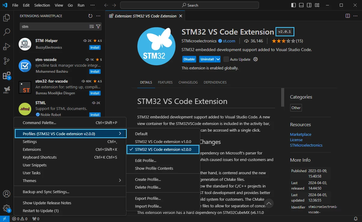

  • Proceed to install the latest version of the STM32 VS Code extension after creating the profile
  • Now, you have two profiles; one contains v1.0.0, and the other contains v2.0.0
