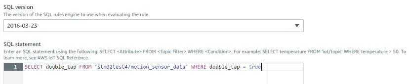

Keep the SQL statement version to 2016-03-23. For the SQL statement itself, write it out as follows:
For context, the SQL statement is looking at the double_tap object in the JSON payload within the motion_sensor_data topic. It only activates the rule if double_tap is true.

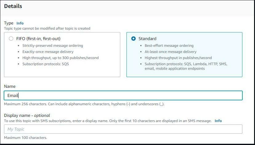

You need to create a new SNS topic. This takes you a new window.
In the new window, set the topic type to standard, give it a name, and create the topic.
