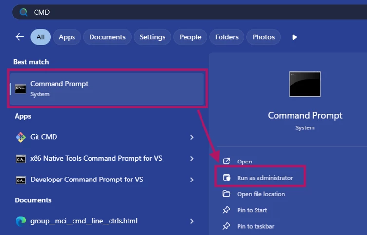

Open Command Prompt and run the software as administrator.

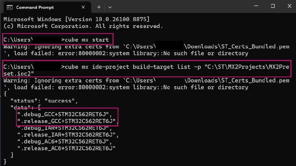

Start STM32CubeMX2 by typing the following:
cube mx start
Wait for it to be initialized, then check the existing preset targets by typing:
C:\Users\username>cube mx ide-project build-target list -p "C:\ST\MX2Projects\MX2Preset.ioc2"
This confirms .debug_GCC+STM32C562RET6 and .release_GCC+STM32C562RET6 are already present.

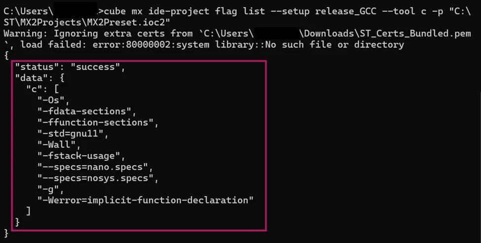

Inspect the default Release flags before removing anything, the default Release/GCC setup on a new project typically carries -Os (size optimization) and -g (debug symbols):
cube mx ide-project flag list --setup release_GCC --tool c -p "C:\ST\MX2Projects\MX2Preset.ioc2"
--setup takes the plain <buildType>_<toolchain> name (for example, release_GCC) without the +<device> suffix shown by build-target list.
-Os: Optimizes for code size rather than speed. This is the default optimization the Release preset ships with before you swap it for -O3.
-fdata-sections: Places each variable/data item into its own linker section, instead of grouping them all together. This lets the linker discard unused data later.
-ffunction-sections:  Same idea, but for functions: each function gets placed into its own section. Usually paired with -fdata-sections.
-std=gnu11: Sets the language standard to C11 with GNU extensions enabled (as opposed to strict ISO C11). GNU extensions add things like statement expressions and certain built-ins that are not in the official C standard but are common in embedded code.
-Wall: Enables a broad set of compiler warnings (unused variables, type mismatches, etc.). Does not stop compilation.
-fstack-usage: Makes GCC emit a *.su file for each source file, reporting how much stack each function uses.
--specs=nano.specs: Links against Newlib-nano, a stripped-down version of the C standard library built for small embedded targets (much smaller footprint than full Newlib).
--specs=nosys.specs: Links against stub implementations of OS-dependent syscalls (_write, _read, _sbrk, etc.) that do nothing by default, since there is no operating system on a bare-metal MCU. These can be overwritten, (for example, to redirect printf to a UART).
-g: Includes debug symbols in the binary.
-Werror=implicit-function-declaration: Turns a specific warning into a hard error: calling a function without a prior declaration or prototype. This is a common source of undefined-behavior bugs in C, so it is escalated from warning to error to force you to fix it rather than ignore it.

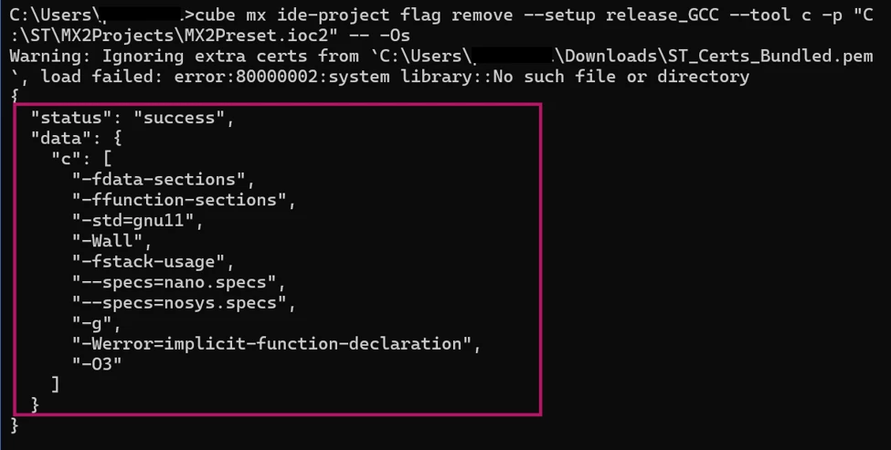

4.1 Replace the optimization flag
Flag values that start with a dash (-O3, -Os, -g) are misread as unknown CLI options unless separated from the named options with --.
Remove the existing flags, for this particular example, Size Optimization (-Os) and Debug Symbols(-g):
cube mx ide-project flag remove --setup release_GCC --tool c -p "C:\ST\MX2Projects\MX2Preset.ioc2" -- -Os
cube mx ide-project flag remove --setup release_GCC --tool c -p "C:\ST\MX2Projects\MX2Preset.ioc2" -- -g
Add the Speed Optimization flag (-O3):
cube mx ide-project flag add --setup release_GCC --tool c -p "C:\ST\MX2Projects\MX2Preset.ioc2" -- -O3
The Preset flags should look as shown below after the commands:

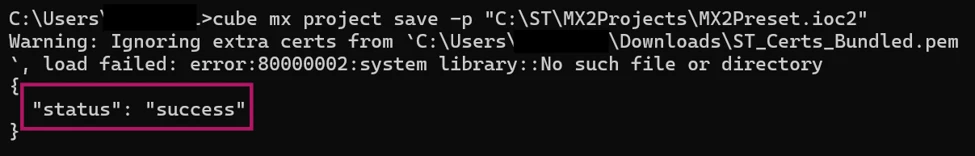

4.2 Saving the project
cube mx project save -p "C:\ST\MX2Projects\MX2Preset.ioc2"
This writes the flag changes into the *.ioc2 file. Nothing in the generated project folder changes yet, as that happens at the generate step.

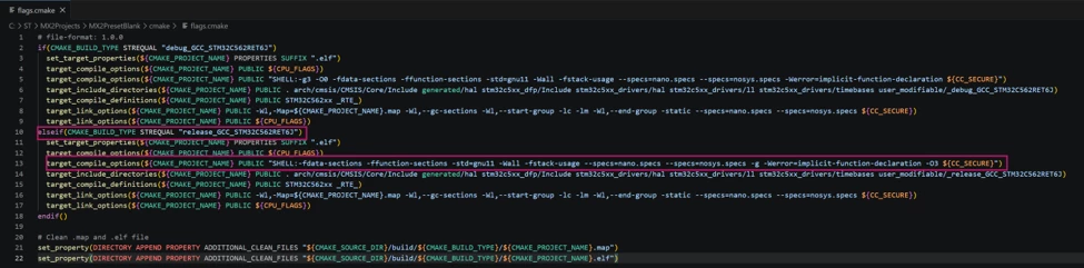

Both build targets must be exported together, in the same command, into a destination folder that does not already contain a generated project. Existing files at the destination are preserved by default unless told otherwise. Generating a single target at a time leaves flags.cmake and CMakePresets.json on their prior (Debug-only) state, even with --force.
For the initial generation, use a fresh destination folder, for this a file named “MX2PresetBlank” was created:

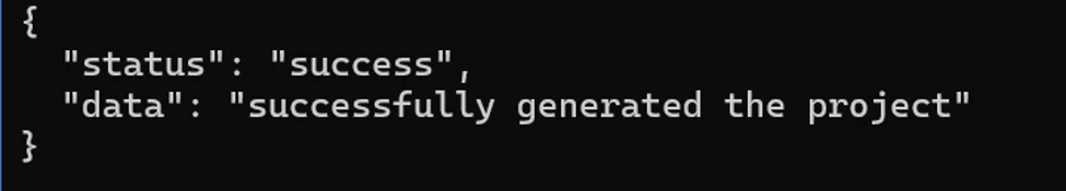

cube mx ide-project generate -p "C:\ST\MX2Projects\MX2Preset.ioc2" --build-target .debug_GCC+STM32C562RET6J .release_GCC+STM32C562RET6J --destination "C:\ST\MX2Projects\MX2PresetBlank" --format CMake --source include-packs-from-local
After that, the following message should appear:

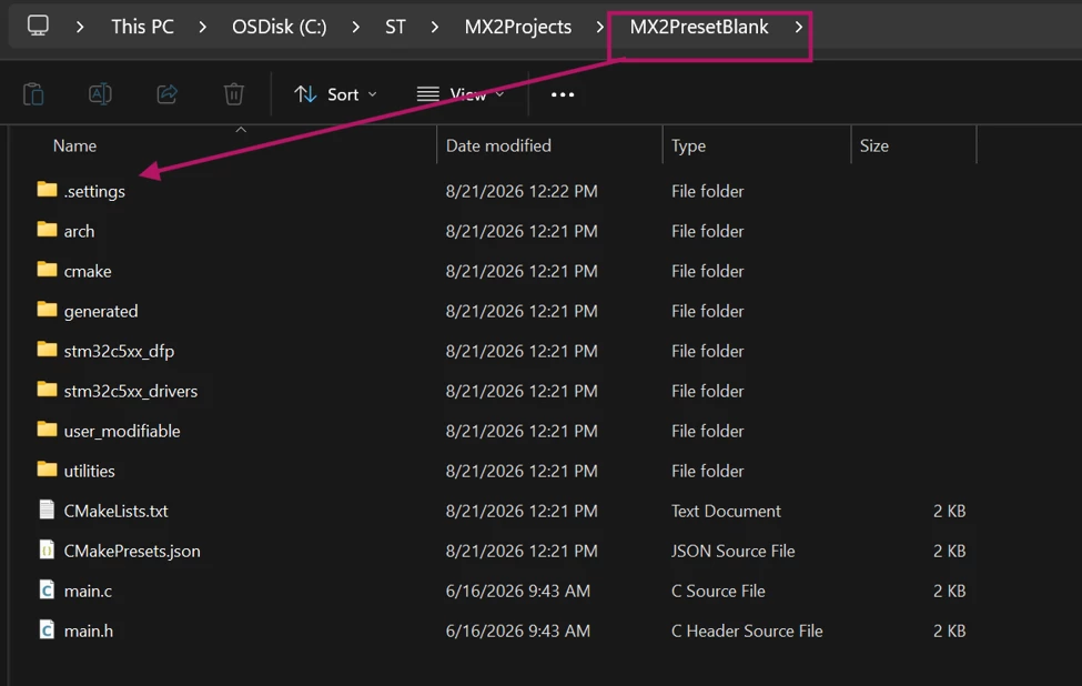

Going into the recently created folder, a generated project structured as such can be seen:

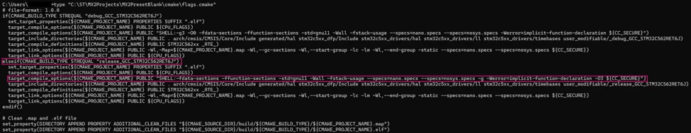

4.4 Verify the generated files
To verify the generated files, use the following commands in the Command Prompt:
type "C:\ST\MX2Projects\MX2PresetBlank\cmake\flags.cmake"
Alternatively, open "C:\ST\MX2Projects\MX2PresetBlank\cmake\flags.cmake" directly from File Explorer:
flags.cmake should now contain two if(CMAKE_BUILD_TYPE STREQUAL ...) blocks (one for debug_GCC_STM32C562RET6, one for release_GCC_STM32C562RET6) with -O3 present in the Release block and no -Os / -Og / -g.

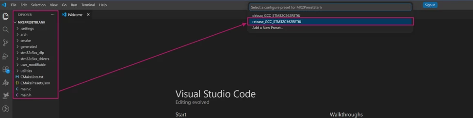

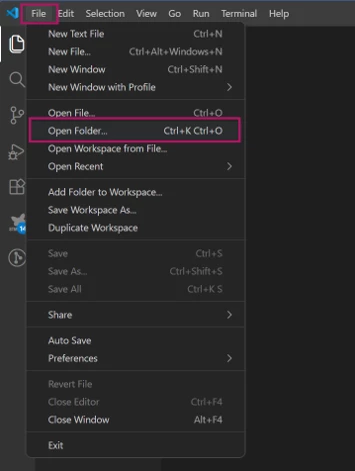

4.6 Verifying in STM32CubeIDE for VS Code
  1. File >> Open Folder, and select the generated project folder (MX2PresetBlank).
  2. Ctrl+Shift+P >> CMake: Select Configure Preset >> choose the Release preset (release_GCC_STM32C562RET6).
  3. Now, the project with the new preset can build successfully.
