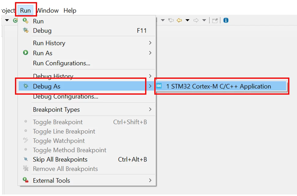

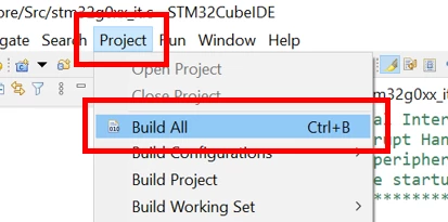

 6. Project Build
Build the project, enter debug mode and run the code
  • Enter Debug session: this programs the code into the flash and then starts the debug session
  • Then click on the Resume icon which will execute the code.
