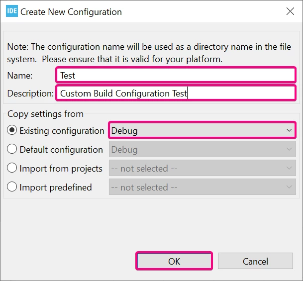

The steps below specify how to create the new compilation settings:
  1. Create an STM32 project, using the STM32CubeIDE.

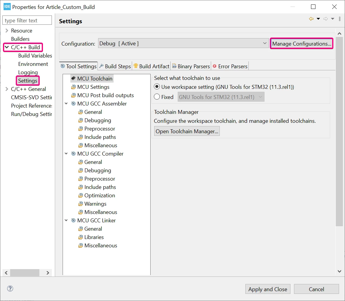

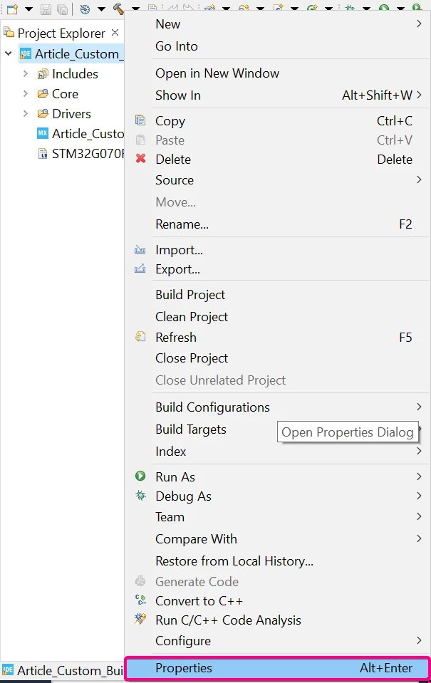

  2. Right click on the Project > "Properties"
  1. Go to "C/C++ Build" > "Settings" > "Manage Configurations."

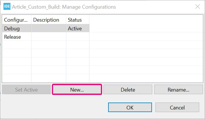

  1. In the "Manage Configurations" tab, click on "New."

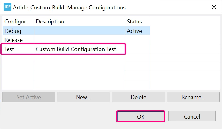

  1. Give it a name and description > “Copy settings from: Existing Configuration (Debug)" > "OK."
The added build configuration might look like the following. Click OK and then “Apply and Close.”

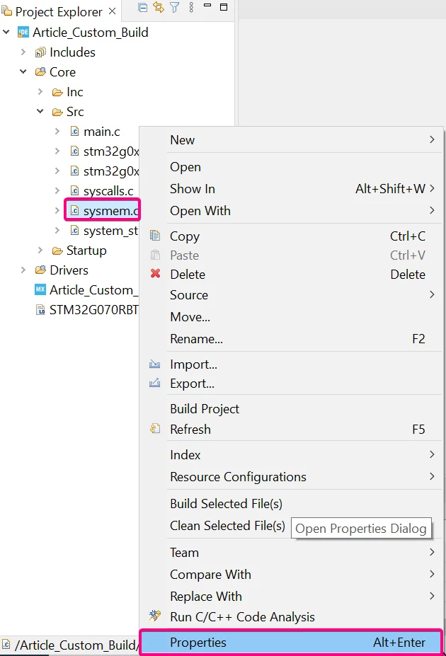

 After following the basic steps mentioned the user can, for example, exclude a file from building. This can be achieved by following the steps below.

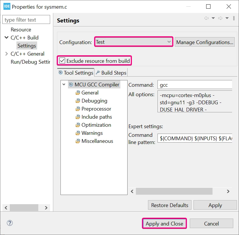

  1. Back to the Project Tree > Right click in the file you would like to exclude from the build/debug configuration created > "Properties".
  1. Go to "C/C++ Build" > "Settings" > Select Configuration “Test” > Check the box "Exclude Resource from Build" > " Apply and Close."

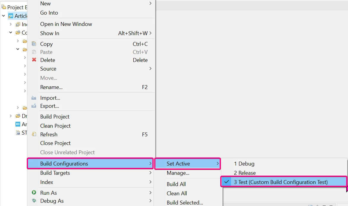

  1. Right click on the Project > "Build Configurations" > "Set Active" > Be sure "Test" is selected.

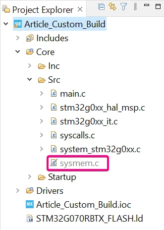

  1. It looks like this (For this test, the file "sysmem.c" was selected not to be compiled):
The same steps can be replicated, so each selected build configuration only compiles the desired files.

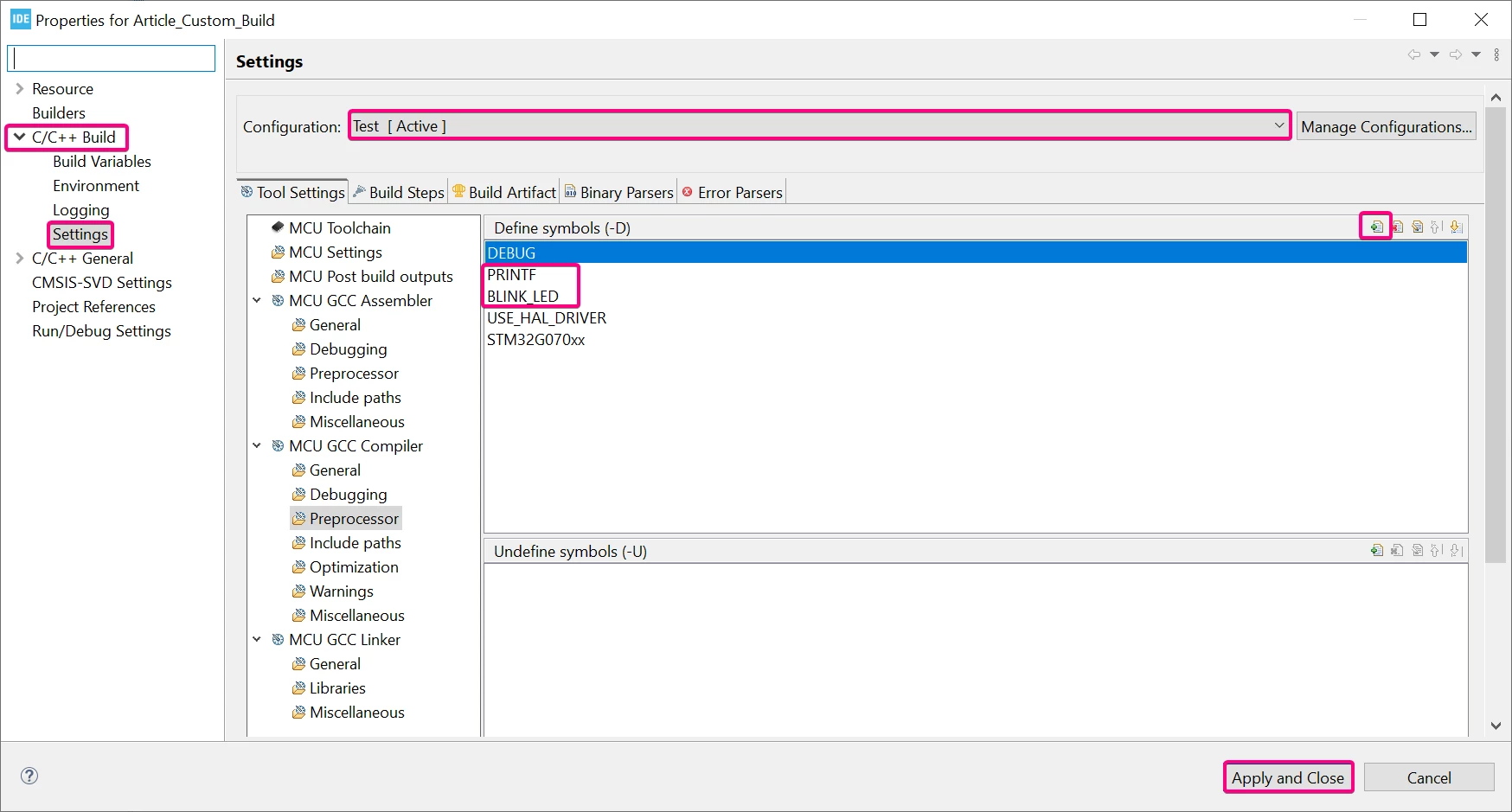

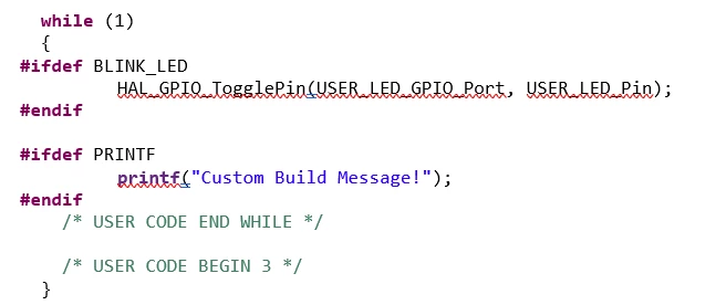

2.1 Adding compiling symbols
 A compilation symbol can be another extremely useful resource in the application code. Let us check a simple example using the custom build feature.
Add the code below:
 while (1)
#ifdef BLINK_LED
	 HAL_GPIO_TogglePin(USER_LED_GPIO_Port, USER_LED_Pin);
#endif
#ifdef PRINTF
	 printf("Custom Build Message!");
#endif
 /* USER CODE END WHILE */
 /* USER CODE BEGIN 3 */
In the "Project Properties", go to “C/C++ Build” > “Settings” > “MCU GCC Compiler” > “Preprocessor” > “Add New”
Note: Remember to specify the build configuration to be used, in this example, “Test.”
 Add “PRINTF” and “BLINK_LED” Symbols:
After applying the changes, the code within the #ifdef statement will be compiled in this building configuration.

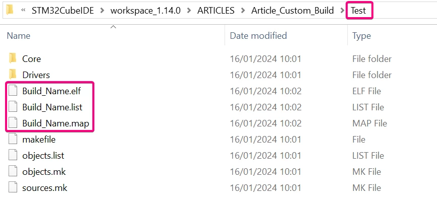

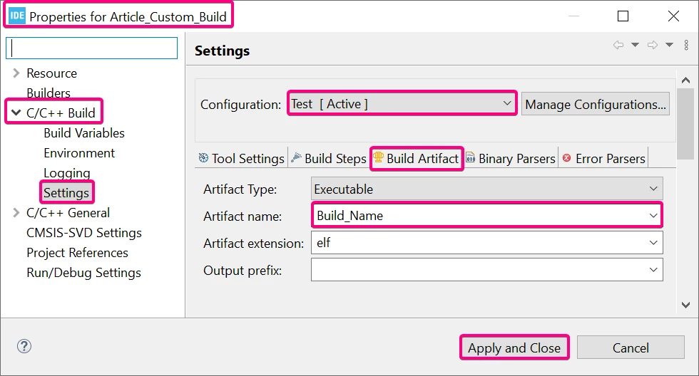

2.2 Creating different build artifact names
Creating different build artifact names can be useful for quickly identifying which project settings were used to create the given application. Each binary file created can have a custom name associated to its build configurations.
  1. Right click on the Project > “Properties” > “C/C++ Build” > “Settings” > “Build Artifact” > “Artifact Name”:
After building with “Test” build configuration active, the compilation files will appear as:

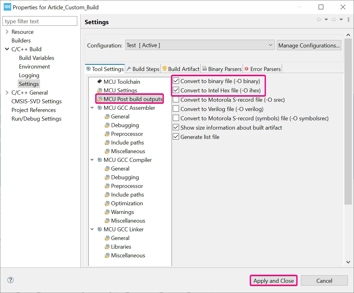

3.1 Adding .BIN and .HEX files
In Project Properties > “C/C++ Build” > “Settings” > “MCU Post Build Outputs” > Check the boxes to generate the files after build.

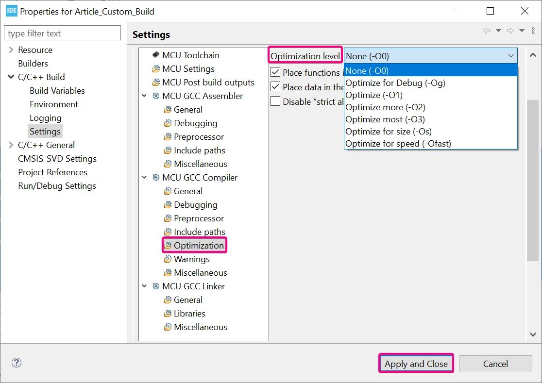

3.2 Changing optimization level
In "Project Properties" > “C/C++ Build” > “Settings” > “MCU GCC Compiler” > “Optimization” > Select the desired “Optimization Level.”

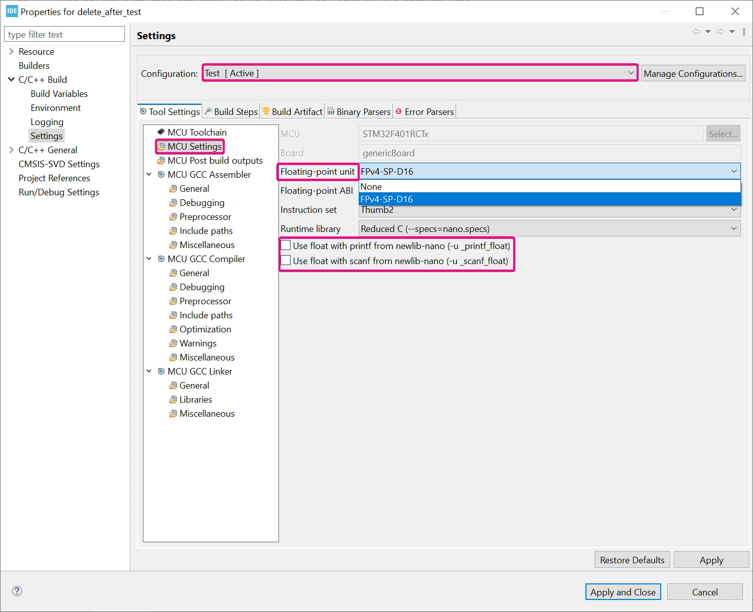

3.3 Adding theFPU (Float Point Unit)
Using the Custom Build feature, user can easily enable or disable the FPU for each build configuration, by just selecting the Build configuration, for example “Test,” and defining the FPU.
