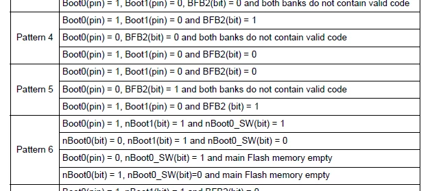

  • The starting point is AN2606. There one can find the version of the bootloader inside the MCU, supported peripherals and pinout. For the F429 it is the Chapter 33.
  • At the start of the Chapter 33 a Pattern 5 is mentioned

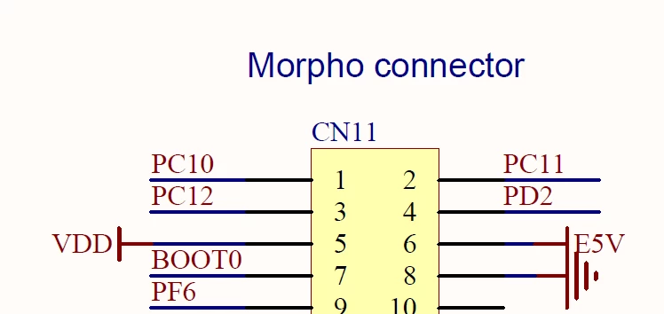

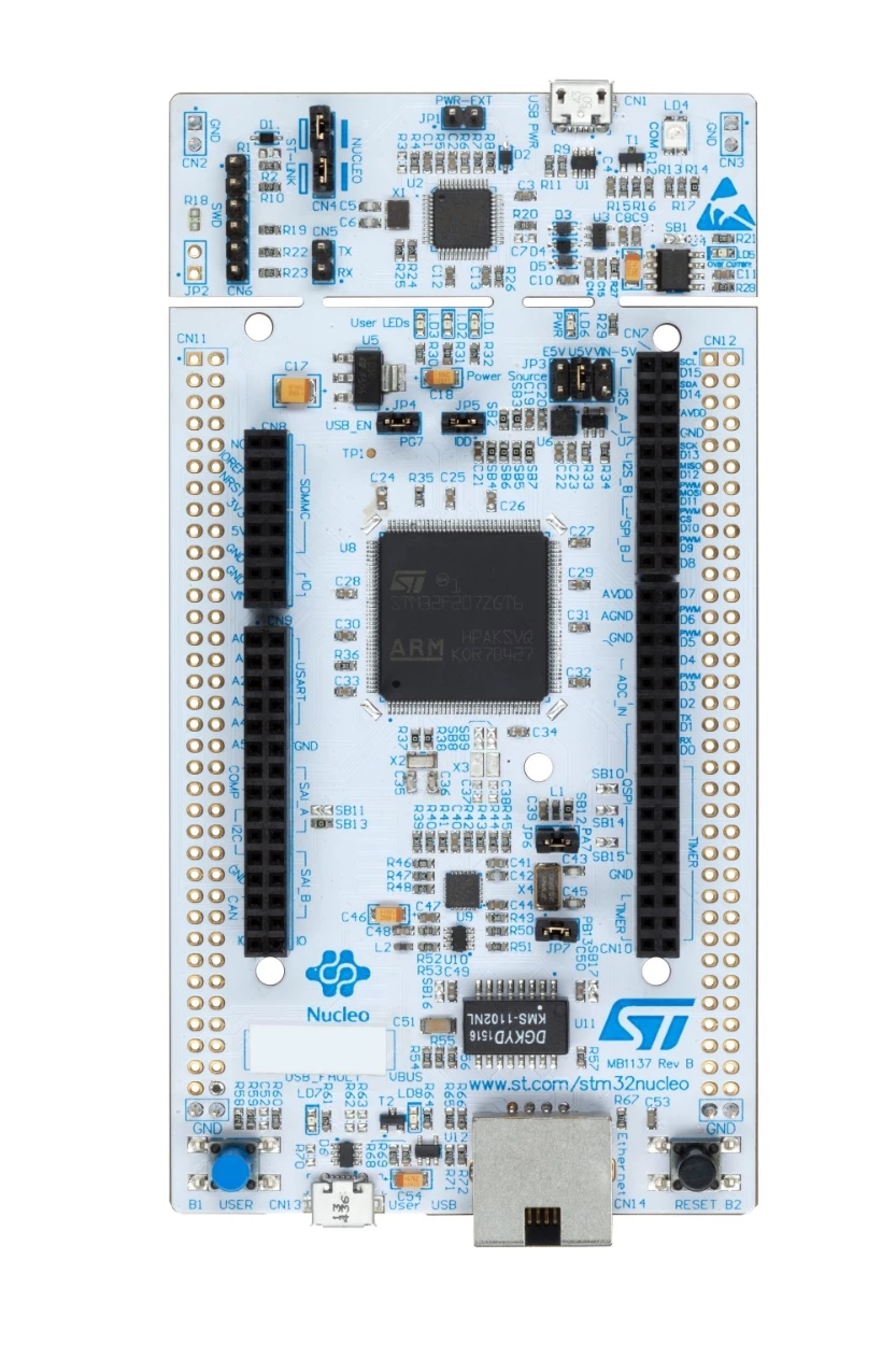

  • Referring to the pattern, one of the options is to set the hardware BOOT0 pin to logic ‘1’, activating the bootloader after Reset of the MCU
  • The BOOT0 pin location can be found in the schematic of the Nucleo
  • The pin is on the unmounted CN11 connector, right next to VDD so it can be easily tied up by a wire.

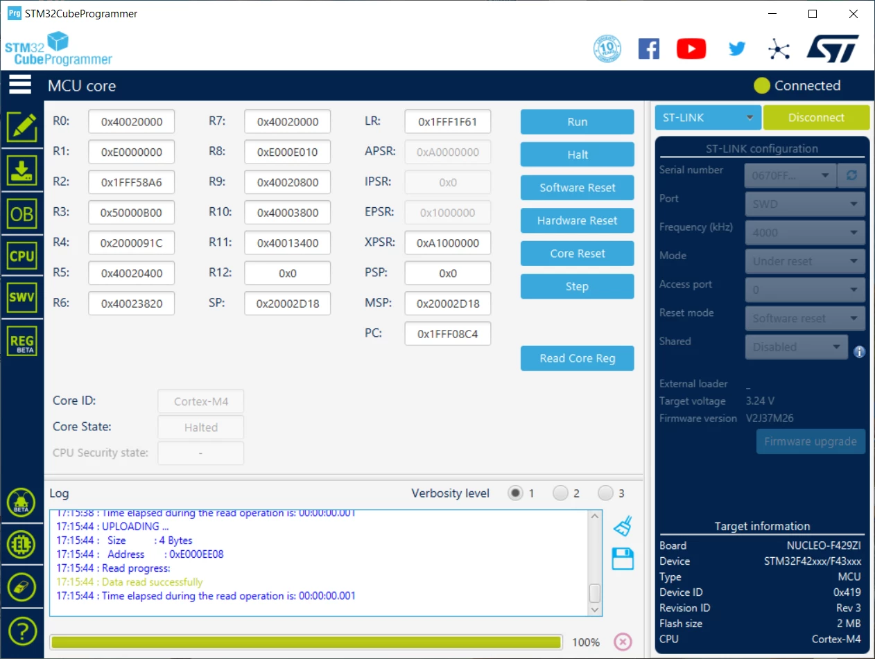

  • One can also verify that the bootloader is indeed running, by connecting to the onboard ST-Link with CubeProgrammer.
  • The connection to the debugger can be done by SWD with default parameters.
  • In the CPU tab, when the core is Run and then Halted, the ProgramCounter should be in the 0x1FFF XXXX range, as opposed to 0x0800 XXXX range for normal Flash execution.

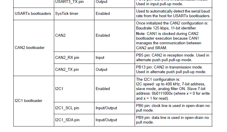

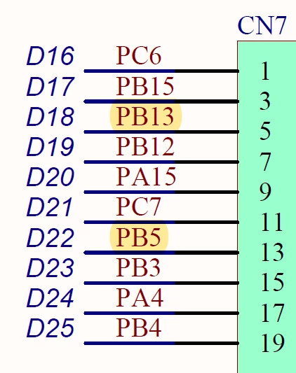

  1. How to identify the CAN bootloader pins
  • Back in AN2606, Table 69 tells that the CAN(2) peripheral is indeed supported by the bootloader FW and is on pins PB5, PB13.
  • This step is crucial, as some bootloaders support CAN, but then the pins that are used (CAN interface can be used by couple of sets of pins, but only one set is selected for the BL) are not routed out on some package versions (usually smaller), or omitted on the certain evaluation PCB.

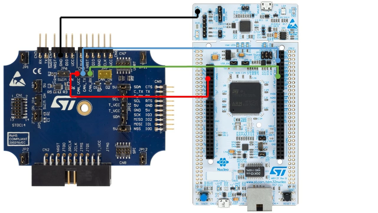

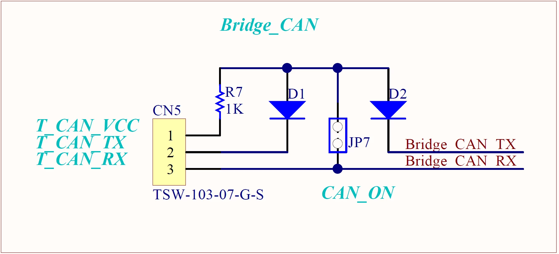

  1. How to connect to the CAN interface
  • Now that the MCU is running in bootloader mode, pins are identified, it is time to connect the interface.
  • The ideal case is when the PCB has CAN transceivers, then it should be unplugged from the bus and connected only with the bootloader host (as some message IDs may be shared with the IDs described in the AN3154). However, the majority of STM32 evaluation PCBs (Nucleo, Discovery, Eval) has no transceiver.

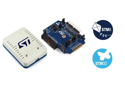

  • The tool that can act as bootloader host is the PC with CubeProgrammer and ST-LinkV3
  • This tool features no transceivers either, so to connect to a PCB with transceivers an add-in board with transceiver is required, or the CAN Rx, Tx pins should be accessible on the PCB. Connection without transceivers also ensures that there are only two nodes on the ‘bus’ (bootloader target and host).
  • The ST-LinkV3 comes with a daughterboard, which features CAN pins with diodes for the connection to the target. No other tools are needed, only a set of wires to connect the CAN (T_CAN_RX, T_CAN_TX) pins, GND (accessible on headers of the daughterboard) and VCC (T_CAN_VCC).
  • As opposed to for example UART, the Rx and Rx must be connected together (to ensure that the 'bus' can hear the message on both sides) and Tx lines connected through the diodes.
  • Using the ST-Link V3 with the daughterboard mounted, 4 wires and a jumper, connection to the CAN BL can be achieved. On the picture above, GND, VCC, Rx, Tx must be connected and CAN_ON jumper fitted.

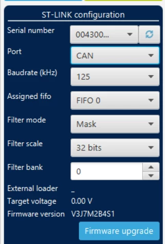

  1. How to program the MCU using CAN Bootloader

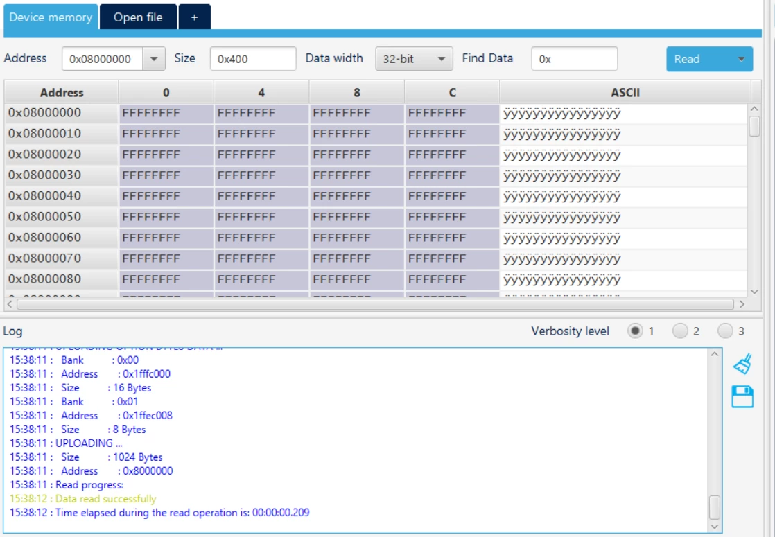

With the hardware connection set up, both boards connected to power via USB, the connection can be now established. Moving back to CubeProgrammer, the connection is as simple as selecting the CAN interface. If the connection is successful, the content of the memory should appear.
  • Select the ST-Link V3
  • Port is the CAN
  • Baudrate and other settings should be kept at default values
  • When the connection is successful, content of the memory should appear
  • The device can now be programmed as when using the CubeProgrammer with SWD/JTAG connection, only without the debug capability. Binary can be loaded through the Erasing and Programming tab, Option bytes can be modified, only the CPU tab will not work.

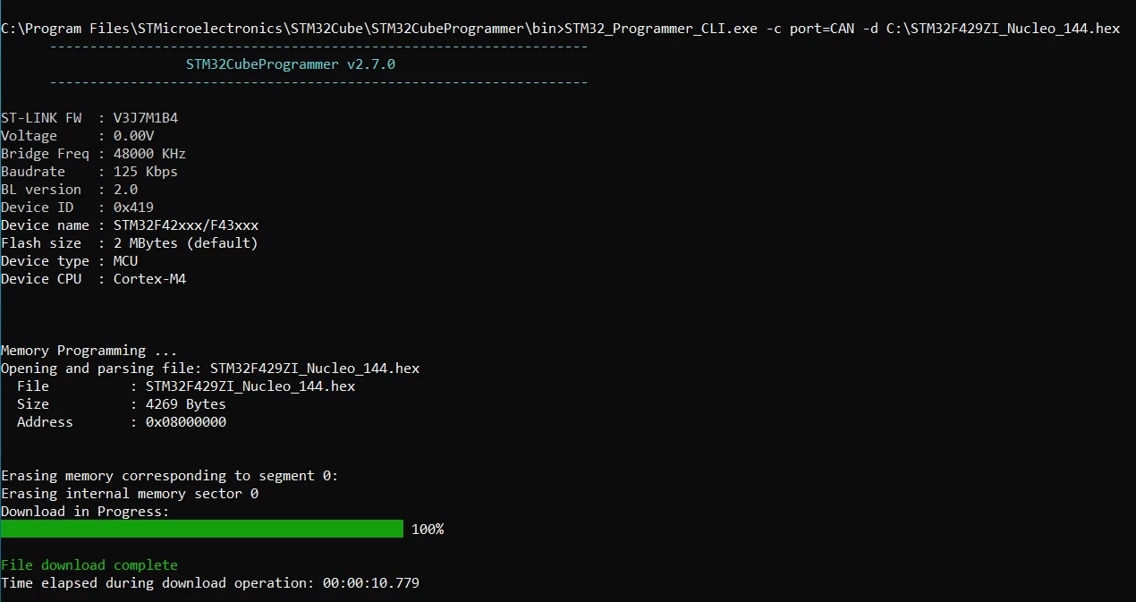

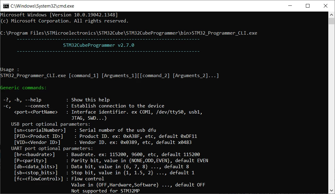

  1. How to program the MCU using CAN Bootloader – from a script
The CubeProgrammer also comes with CLI version (command-line-interface). That can be used for automation of the programming process through the bootloader.
The CLI version is in the same installation folder as the CubeProgrammer GUI. Usually:
C:\Program Files\STMicroelectronics\STM32Cube\STM32CubeProgrammer\bin\ STM32_Programmer_CLI.exe
 Invoking the CubeProgrammer CLI from command line without any parameters will list all possible configurations.
In this example, the CAN configuration can be used as follows:

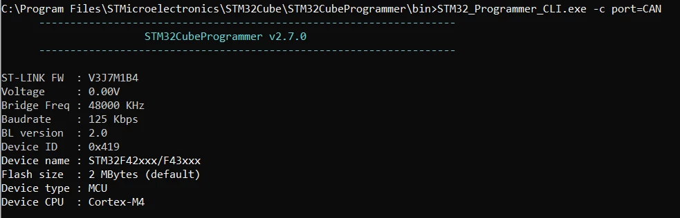

STM32_Programmer_CLI.exe -c port=CAN
Downloading a binary to the device is then as simple as providing the connection parameters and a path to the binary:
STM32_Programmer_CLI.exe -c port=CAN -d C:\STM32F429ZI_Nucleo_144.hex
These commands can be used in a script on the host PC, allowing the automation of e.g. programming process.

Can you please clarify this statement: "This tool features no transceivers either, so to connect to a PCB with transceivers an add-in board with transceiver is required", what do you mean by an add-in board?

Hello! Where did you get the Bridge CAN schematic? The figure name is "17.png" in this article.

@GhostSherry
The STLinkV3 does not feature any transceivers onboard, only the CAN pins directly from the MCU, therefore if a PCB you want to connect to has the standard 9 pin connector for example, there is usually a transceiver. In which case you would need another board between STLink and the PCB with transceiver for the STLink so that both boards can communicate with each other through CAN.

@Zeeshan3154
The diagram comes from the documentation for the STLinkV3. I took a snippet to depict the circuitry of the CAN bridge.
