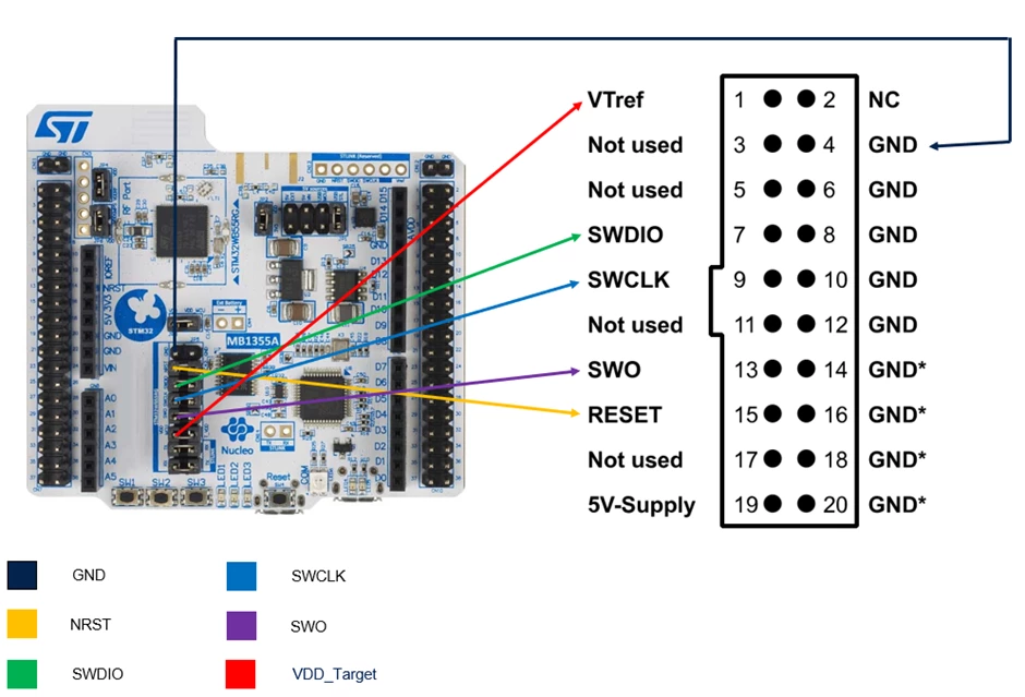

2. NUCLEO-WB55RG Hardware Modifications:
Step 1. On the NUCLEO-WB55RG board, keep jumper JP2 ON. This is necessary as it allows the MCU to be powered from the user USB port, in which we configure in step 2 below. Note that there are multiple ways to provide the STM32WB55 with 3.3V, but this is one of the easiest ways to do so.
Step 2. On the NUCLEO-WB55RG board, on JP1 (5V source), relocate the jumper from USB_STL or whichever other position that the jumper was previously placed, to USB_MCU.
3. NUCLEO-WB55RG and J-Link Debug Probe Pin Connections:
Step 3. On the NUCLEO-WB55RG’s, connect the STM32WB55’s debug pins (left-hand side of JP5) to the following pins on the J-Link debug probe to establish the necessary connections:
Signal NUCLEO-WB55RG (JP5) J-Link Debugger
SWCLK Pin 7 – SWCLK Pin 9 – SWCLK / TCK
GND Pin 1 – GND Pin 4 – GND
SWDIO Pin 5 – SWDIO Pin 7 – SWDIO / TMS
NRST Pin 3 – NRST Pin 15 – NRST
SWO Pin 9 – SWO  Pin 13 – SWO / TDO
Target’s VDD Pin 11 – VDD_MCU Pin 1 – VTREF
In this case, the printing of the signals on the board accurately corresponds to the pins’ location, so you can just go ahead and connect to the pins as appropriate.
1016.pngStep 4. Now, power the J-Link debug probe and power the NUCLEO-WB55RG by connecting a micro-B USB to the NUCLEO-WB55RG’s on-board user USB port.
Launch J-Flash and connect. Congratulations! Now, you have successfully established a connection between the STM32WB55RG on the Nucleo board and Segger’s J-Link debug probe.

Nice one. As mentionned there are multiple ways to provide 3.3V but my prefereed one when using a segger J-Link is by getting it from the probe itself (5V supply) to the Nucleo VIN sparing a USB cable. The only thing needed is a "Target.PowerOn (BP_STATE_ON);" directive in jlink/ozone project.
