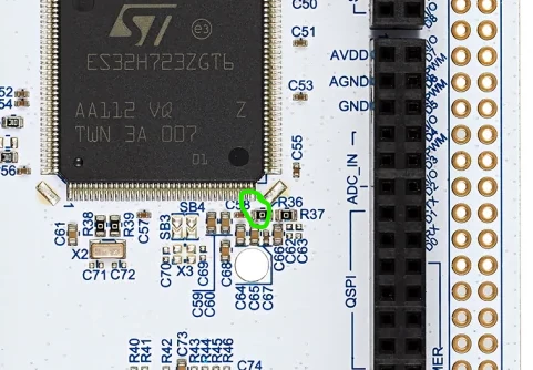

I'm a beginner, so i want to confirm things before i begin. I want to provide external reference for the 16-bit ADC. So from what you have said , i need to remove the  R36 (i'm using the same board), then i need to set the vrefbuf to external reference voltage, and the Vref+ pin on the board will be the input, to my external source will be connected.
I want to confirm, the one rounded by green circle is the R36.
With respect to the table, the max voltage i can supply to Vref+ is 3.6 so 3.3 should be fine, correct me if i'm wrong.
Also is there anything i should do for safety to avoid situation like this
