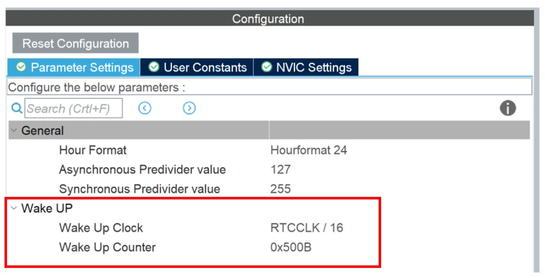

In this example, the counter is set to trigger after 10 seconds:
  • Wakeup Time Base = 16 /(~32.768KHz )  = 0.488 ms
  • Wakeup Time = 0.488 ms  * WakeUpCounter
  • WakeUpCounter = Wakeup Time / 0.488 ms = 10s / 0.488 ms = 20491 = 0x500B

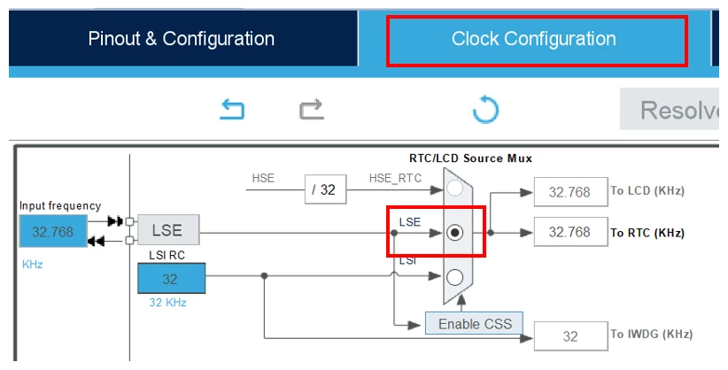

  5. Set the clock source of the RTC to LSE (external 32.768 KHz crystal that is on the Nucleo board) by selecting LSE for the RTC Source Mux in the Clock Configuration Tab as seen below: 1780.png

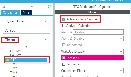

  6. In the Pinout & Configuration Tab, under Timers, select RTC and check the Activate Clock Source option to enable it:pepfof_0-1758029395643.png
Now the RTC is enabled and can be further configured to use one of the two aforementioned schemes for generating the wake-up interrupts. These schemes are presented below and are to be implemented separately. Section 3.2 will describe the usage of the Internal WakeUp Counter, and Section 3.3 will describe the usage of the Calendar and Alarm features of the RTC.

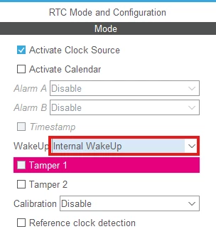

  1. Enable the Internal WakeUp feature of the RTC by selecting Internal WakeUp in the WakeUp dropdown of the RTC configuration panel.pepfof_0-1758031684245.png
  2. Configure the WakeUp counter. Select RTCCLK / 16 as the Wake Up Clock and then set the Wake Up Counter to 0x500B according to the calculation in Section 2 of this article.1778.png

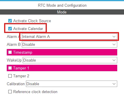

  1. Enable the Calendar and Alarm features in the RTC configuration panel:
    • Check the Activate Calendar option.
    • For one of the available alarms (Alarm A in this instance), select Internal Alarm from the appropriate dropdown.
    Note that the Calendar Time and Date are not modified in this example and are set to their default value of Jan 1. of the 0th year. As we will be configuring the alarm to trigger every minute with masking, this does not make a difference in our application. In real-world applications, these fields need to be modified by user code for proper time-keeping.Screenshot 2025-09-16 112405.png

    With this configuration, the timestamp will match the one specified by Alarm A every time the RTC's calendar has the value of "5" in the Seconds field, meaning that it will trigger on the 5th second of every elapsed minute.
    With proper time-keeping implemented by the user application, this setup can be modified and the masking removed to generate the EXTI interrupt at an arbitrary timestamp.
