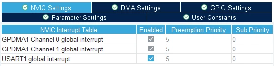

So, I added NVIC settings for USART1. (set 'USART1 global interrupt')
 And it is goood operation.
March 5, 2025
enabling the usart global interrupt fixed the issue of only sending the packet once :D
