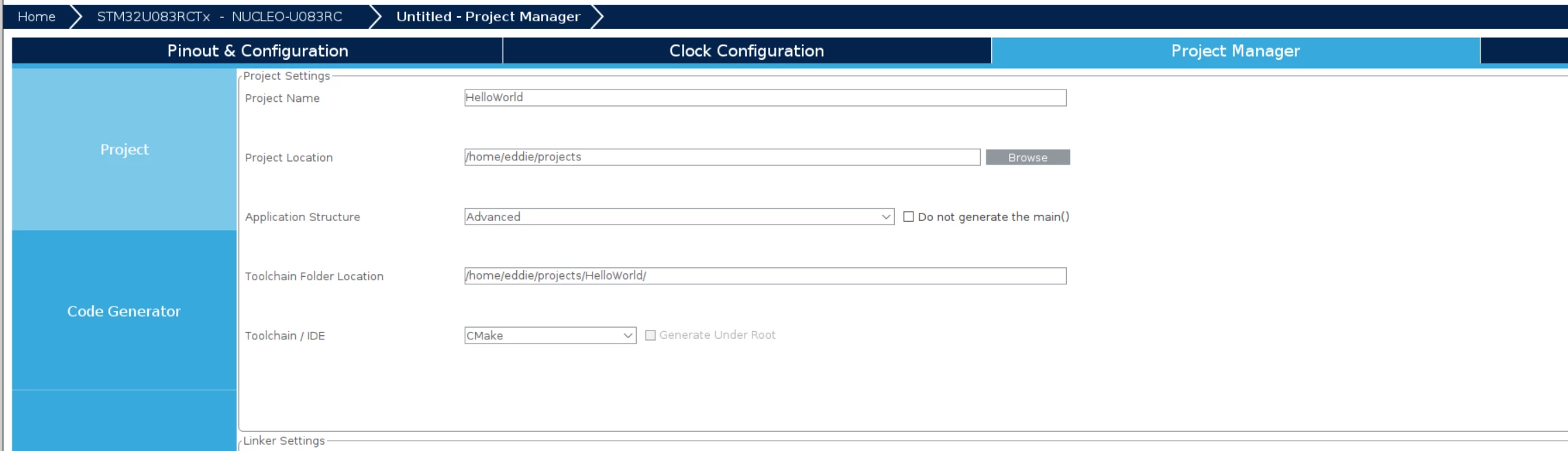

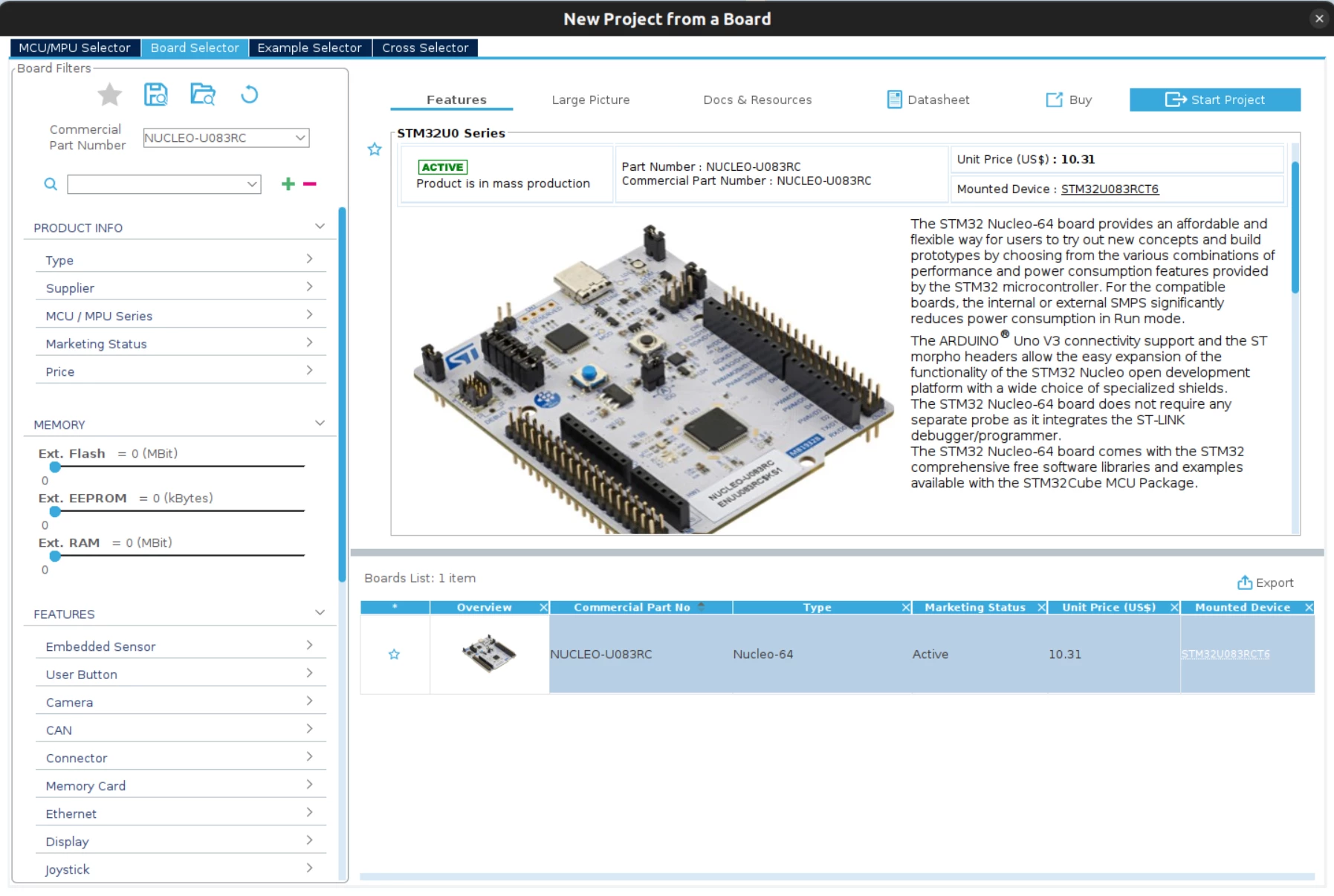

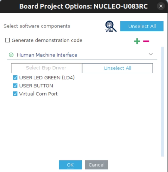

First, we can start off by making a simple project. For this article a Nucleo-U083RC is used, and the project made is based off of the board selector.
We initialize all the BSP peripherals code to their defaults.
The important bit here is that we set Toolchain/IDE to CMake so that we can import this project into the STM32 VS Code extension
Generate the project and import it using the STM32 VS Code extension per the video tutorial seen here.

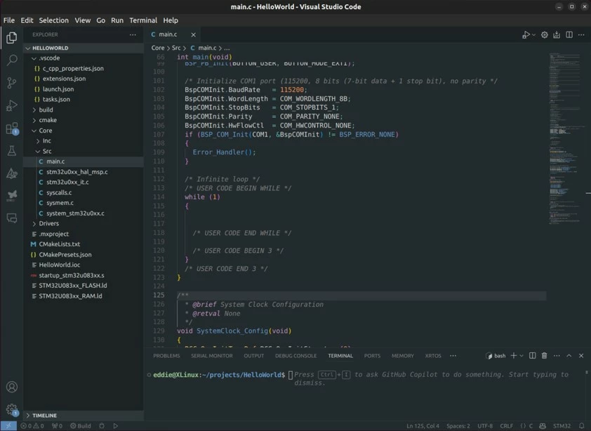

Add simple blink LED code into the main function so we can have a visual representation that the code is running on our hardware
 /* Infinite loop */
 /* USER CODE BEGIN WHILE */
 while (1)
 BSP_LED_Toggle(LED_GREEN);
 HAL_Delay(1000);
 /* USER CODE END WHILE */
 /* USER CODE BEGIN 3 */
You can now launch a debug session per the tutorial video above and verify everything works as expected.

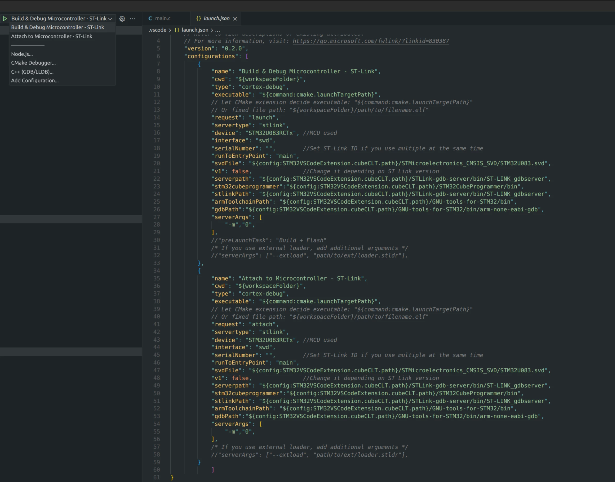

3.2 Customizing the launch json
The launch.json file in VS Code is used to configure debugging sessions, specifying how the debugger connects to your target device. For STM32 development, this file defines parameters such as the GDB server, target interface, and any specific initialization commands. By customizing launch.json, you can adapt your debugging setup to work with different tools, like OpenOCD, and tailor the experience to your specific requirements.
In the image below, you'll notice that the available debug sessions, [Build & Debug Microcontroller - ST-Link] and [Attach to Microcontroller - ST-Link] correspond directly to the two configurations defined in the launch.json file. The name element in each configuration determines what appears in the dropdown menu for selecting a debug session.

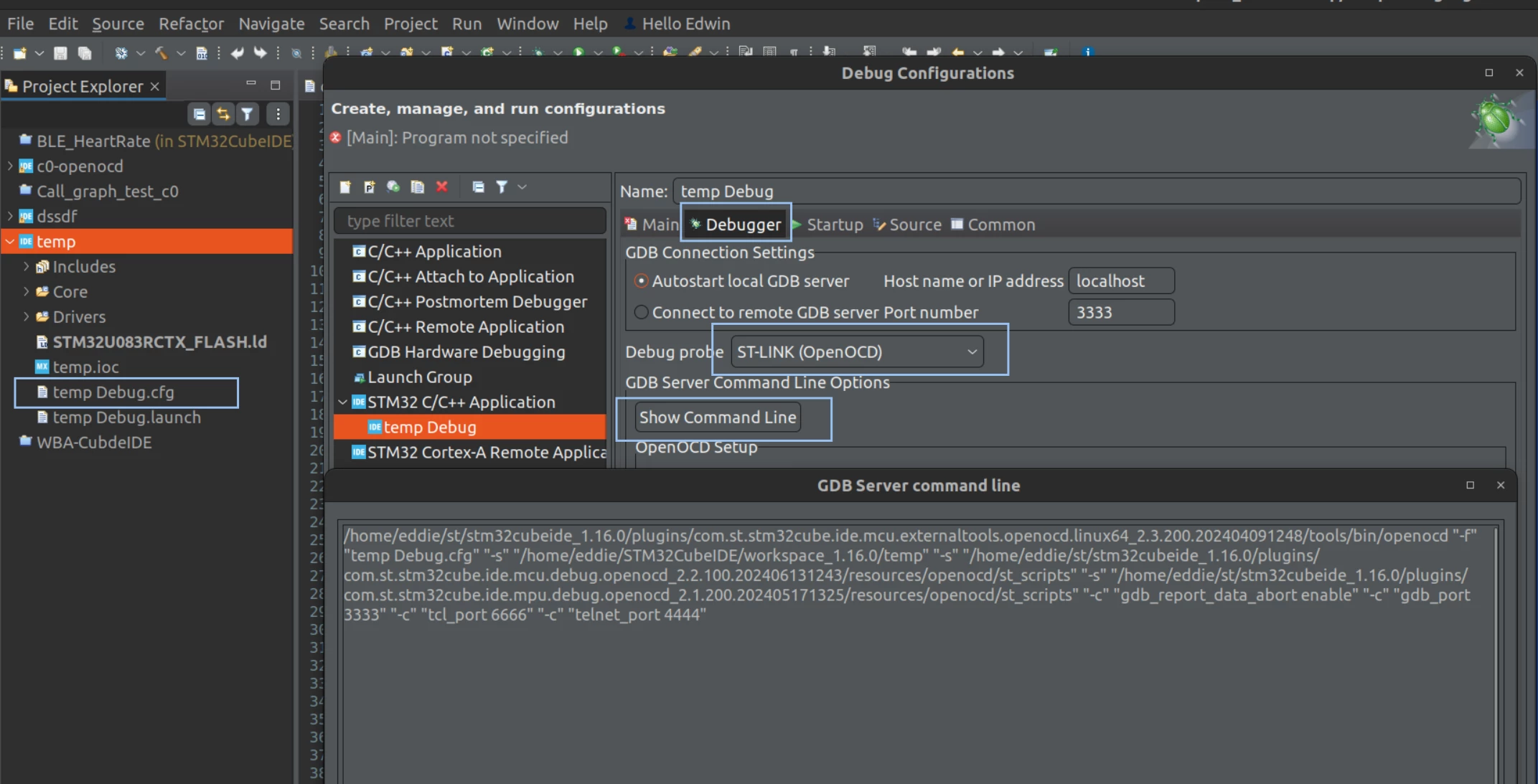

Before we can modify the json file we need to get our hands on a configuration file that is generated by STM32CubeIDE, since it does support OpenOCD by default.
3.2.1 Steps to generate an OpenOCD config file
  • Make a STM32CubeIDE project for the same device/board.
  • Open the debug configuration and change the debug probe setting from [ST-Link GDB-Server] to [ST-Link Openocd].
    In the image below you can see that once the debug probe is changed a new file is generated on the left-hand side of Project Explorer.
  • Copy the contents of the Debug.cfg file (my project is called temp, which is why it says "temp Debug.cfg"). In a few steps, we paste it into a new file.
  • Furthermore, if you plan to use the STM32CubeIDE included OpenOCD fork, press the [Show Command Line] button to show the command line arguments. Take note of the path for the OpenOCD executable and the path for the scripts folder. Copy and paste those somewhere for use in the next step.

3.2.3 Adding a new debug session to launch.json
In the code below, I’ve added the entire launch.json as not to cause confusion about json syntax. The only new item is the last section is the OpenOCD debug session. I’ll go over each element below.

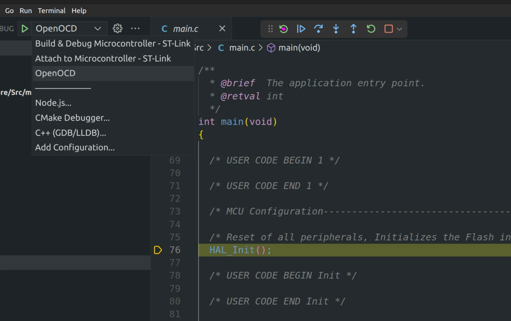

At this point, you should be able to debug you application per usual.
