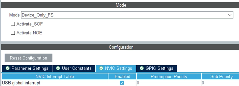

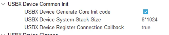

In connectivity, under USB-DRD-FS, select device_Only_FS in mode and activate USB global interrupt in the NVIC settings.

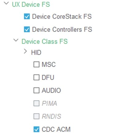

In USBX, under middleware and software packages,
enable Core system. Under UX device FS, enable Device CoreStack FS and DeviceControllers FS. Enable CDC ACM in device class FS.
In the USBX settings window, allocate 10 KB for the UX device memory pool size and 8 KB for the USBX device system stack size.

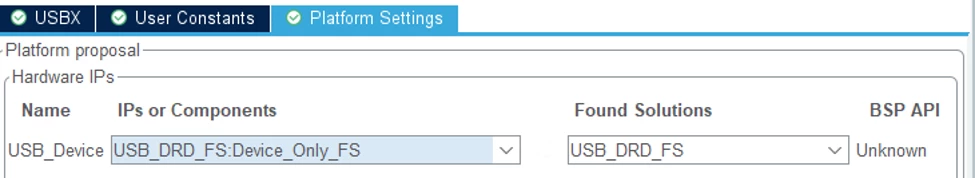

In platform settings, select USB_DRD-FS in found solutions.
In the clock configuration settings, ensure that USB receives a 48 MHz frequency. The easiest way to do this is to select HSI48 as the clock source.

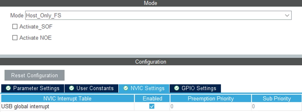

In connectivity, under USB-DRD-FS, select Host_Only_FS as mode and activate the USB global interrupt in NVIC settings.

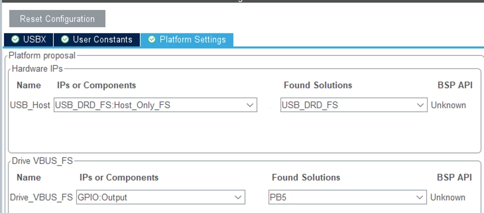

Enable PB5 pin as GPIO output. Under platform settings, select it in “Found Solutions” under the Drive_VBUS_FS window.
The Drive_VBUS pin may change from product to another. Consult the board schematics to see what the dedicated pin used is.

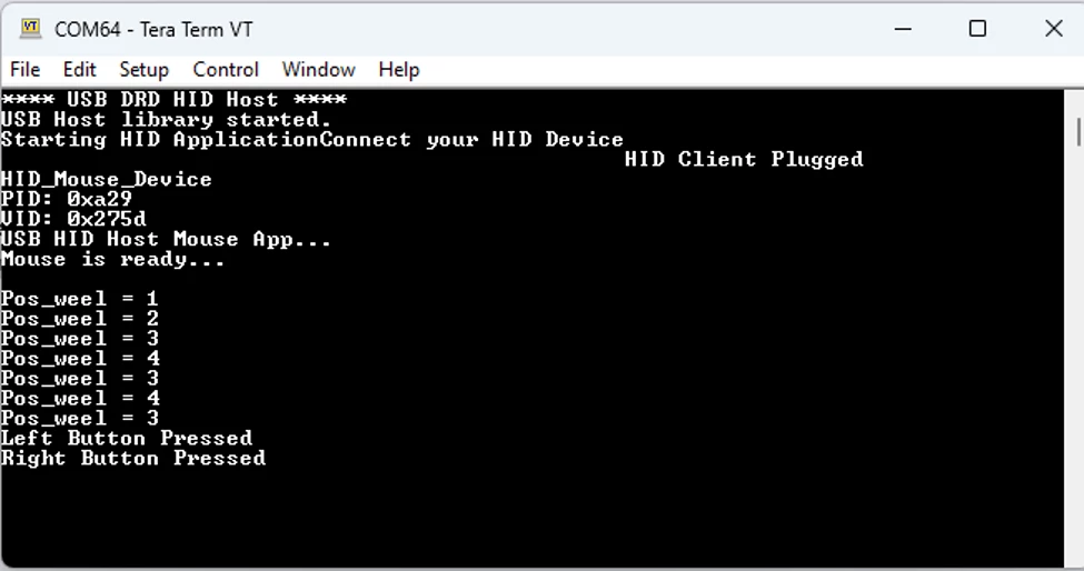

Build and flash your project. The application should start in host mode initially.
Connect a mouse or keyboard to the board USB connector (CN3) using the type C male to type A female adapter. Open the serial monitor and set the baud rate to 115200 bit/s.
You should be able to see mouse or keyboard activity registering in the terminal window.
When the USER button is pressed, the board should switch to device mode. When you disconnect the mouse and attach the USB connector (CN3) to PC, a new USB serial device should appear that prints “hello world” repetitively.
