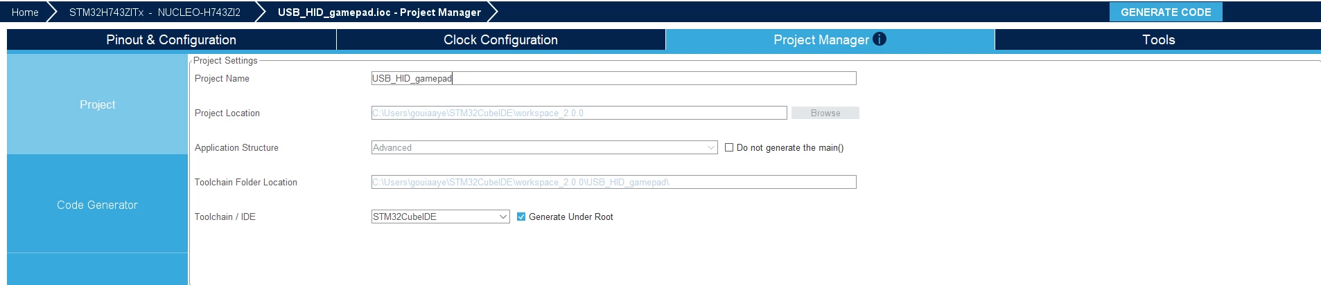

Start by creating a new project using the STM32CubeMX by clicking [file -> New -> STM32 Project]. Use the [Board Selector] tab and select the [NUCLEO-H743ZI2].
Once the project creation is done, press [Pinout → Clear pinouts].

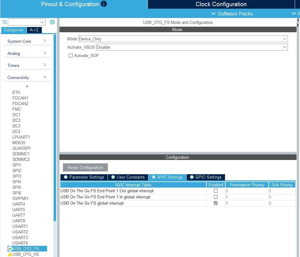

Enable the USB peripheral [USB_OTG_FS] peripheral in device only mode, located in the [Connectivity] section.

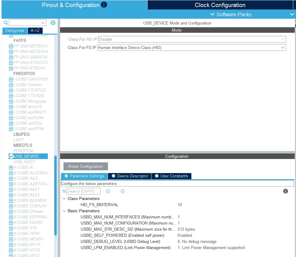

Select [Human Interface Device Class (HID)] in the class for FS IP in [USB_DEVICE] under "Middleware and Software Packs].
In "clock configuration", ensure that USB is receiving 48 MHz.
Select a name for your project and click the [Generate Code] button.
