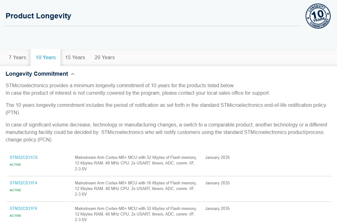

The products covered by the program are listed in the Product Longevity page.
The STM32 microcontrollers part numbers supported by the program are listed in the tab 10 Years. The date of availability is shown for each part number in the column “available until.”
In this example taken in 2025, ST warrants that the STM32N6 parts listed are available for ordering until January 2035 (2025 + 10 years).
In 2026:
  • If the product continues to be part of the program, the “available until” date changes to “January 2026” (2026 + 10 years)
  • If the product is not part of the program anymore, the “available until” date stays at “January 2025”

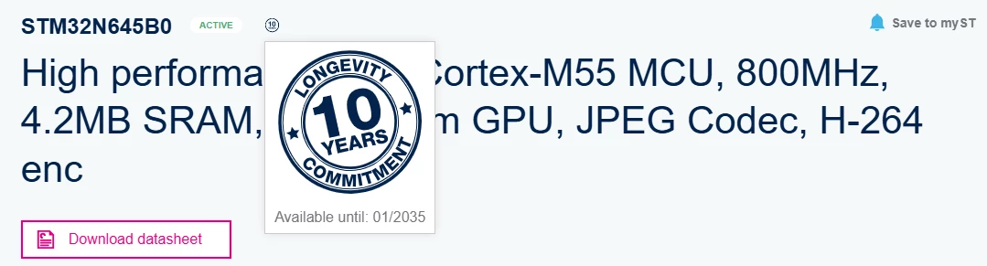

Alternatively, this information can be found directly on the product page. Look for the circle icon labeled “X years longevity commitment" next to the part number on top.
For example, when accessing the page for the STM32N645B0 part number, a small circle icon appears to the right of the product name. Clicking over this icon displays the current warranted time in a pop-up. Clicking further redirects you to the web page listing all products in the category.
