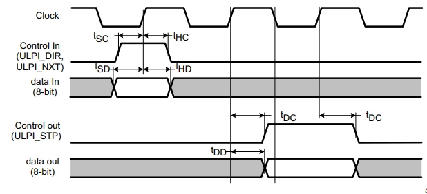

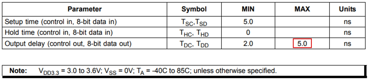

According to datasheet "USB3300 Table 6-2: UPLI interface timing output clock:"
USB3300 Datasheet Table 6-2: ULPI INTERFACE TIMINGUSB3300 Datasheet Table 6-2: ULPI INTERFACE TIMING
  •     Clock setup/hold time(tSC/tSD : tHC/tHD): min. 5 ns / 0 ns
  •     Data/Control output delay(tDC/tDD): (typ.) 2 ~ 5 ns

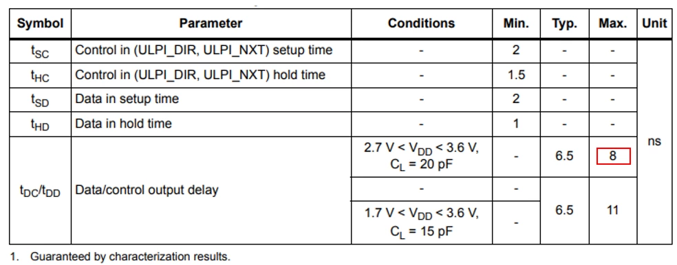

According to datasheet "STM32F77 table 96. Dynamic characteristics: USB ULPI" as an example:
Control in (ULPI_DIR, ULPI_NXT)
  •     Clock setup/hold time(tSC/tSD : tHC/tHD): min. 1 ns / 2 ns
  •     Data/Control output delay(tDC/tDD) @3V3: (typ.) 6.5 ~ (max) 8 ns
tDC/tDD Data/control output delay (assuming @3V3)  8 ns
Clock period (tCLK) – tv(OUT)max = 1/60(MHz) – 8 ns = 8.6 ns
ts(IN), which is tSC, tSD set-up time (control in, 8-bit data in) equal to 5 ns.
  • ts(IN) =5 ns ≤ (clock period (tCLK) – tv(OUT)max=8.6 ns
Around 8.6 ns setup time for this PHY is sufficient.
Caution: @1V8 5.6 ns is risky, so you should look for a different ULPI PHY to meet the requirements.
