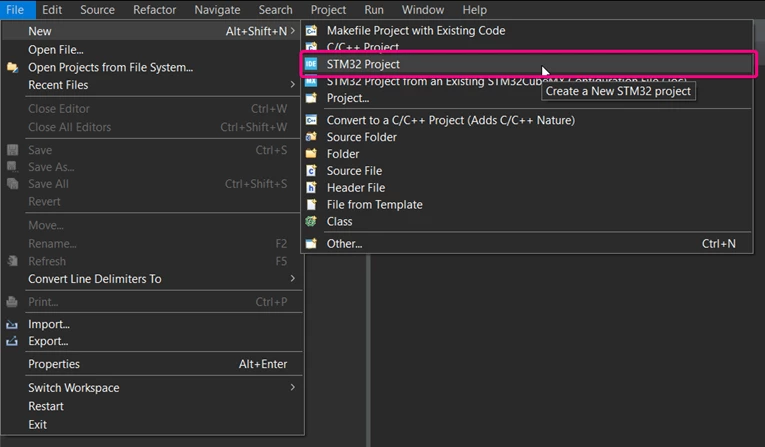

First, let’s create a STM32CubeIDE project for the STM32F7 series and then add our logic.
 After opening the software, click on File -> New -> STM32 Project:

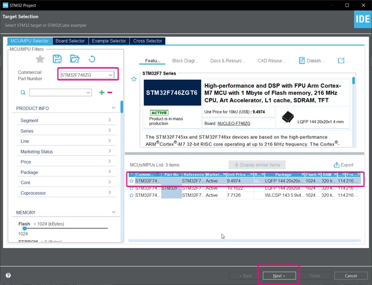

After the menu loads, search for STM32F746ZG, you can easily locate it with the it with the corresponding Nucleo board and press ‘next’.

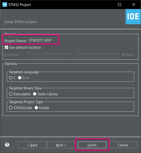

Name your project (avoid using special characters and spaces) and click finish with the default settings.

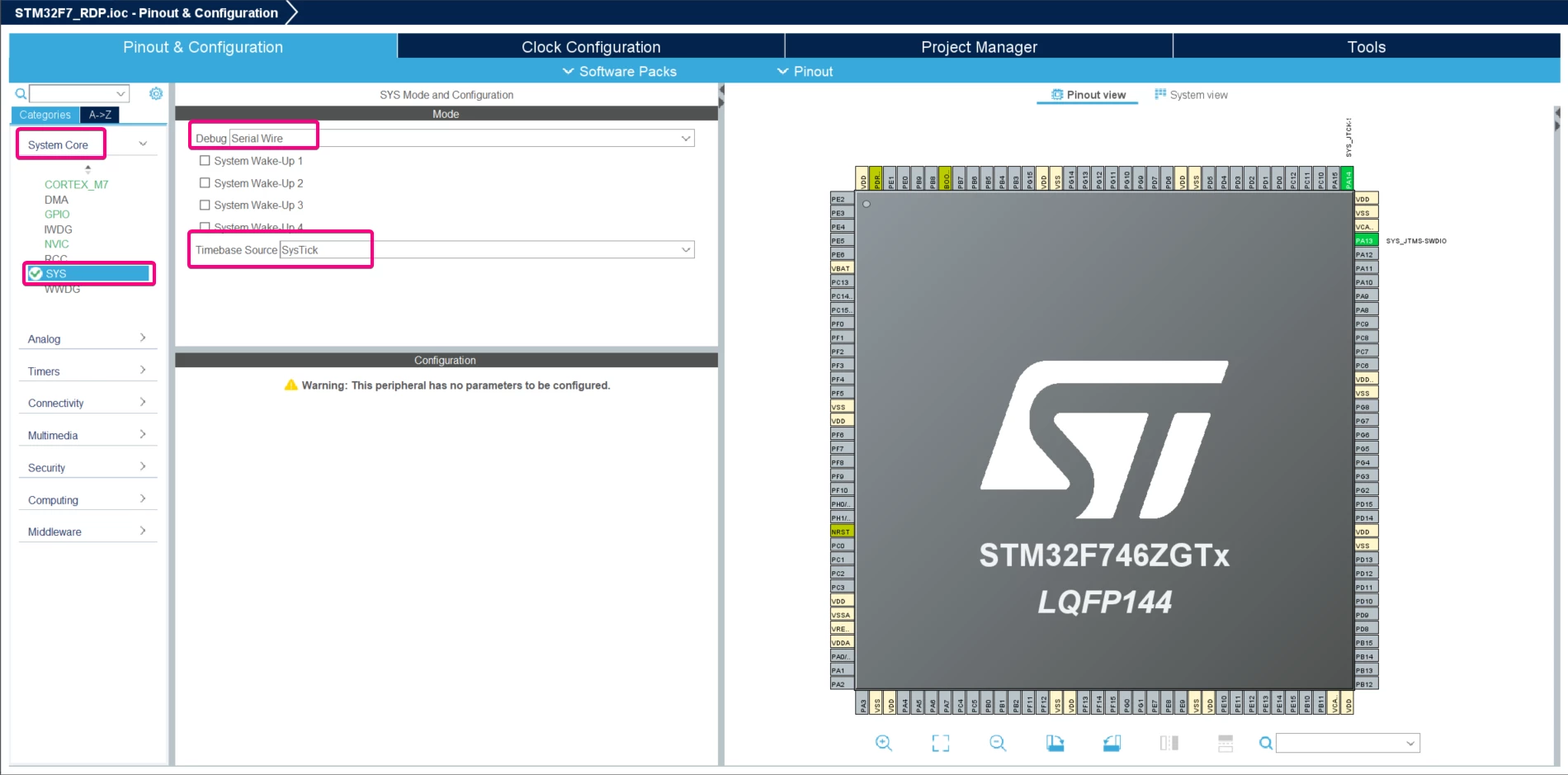

To setup the microcontroller’s SWD go to System Core > SYS and enable the Debug Serial Wire, we can use the default Timebase source as SysTick

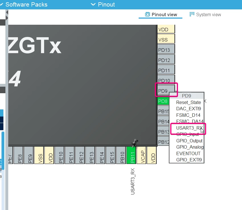

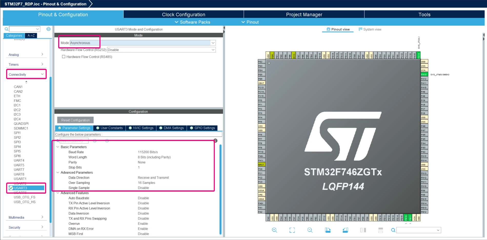

Next, we will configure USART3, which is connected on this Nucleo board to the on-board ST-LINK. With the help of ST-Link’s virtual COM port, we will then use this link to relay messages. Go to Connectivity > USART3 and set it to Asynchronous mode. The default basic parameters under configuration tab should work, but feel free to adjust it to your preferences, just remember that this will be used later when configuring your terminal.
In the nucleo 144 boards the USART3 is wired to the pins PD9 and PD8, thus you must manually reassign them since the Cube MX software will configure RX and TX pins to PB11 and PB10. You need to left click the PD9 pin in your microcontroller and select the USART3_RX option. That must also be done for the PD8 pin and the USART3_TX.

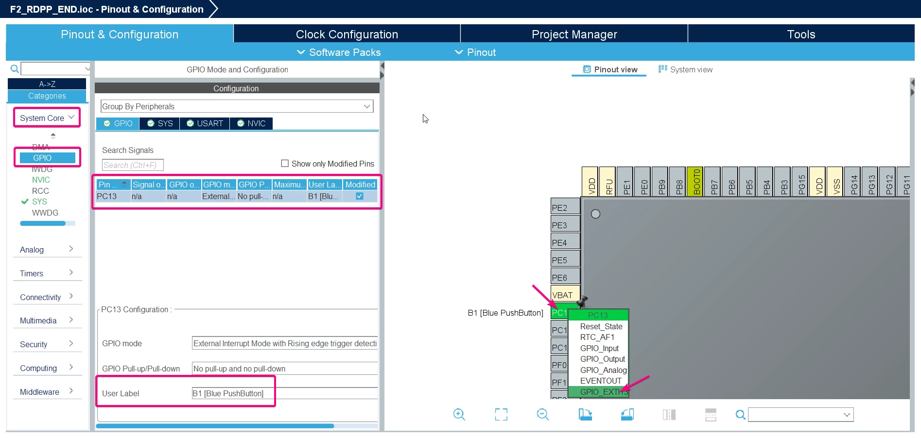

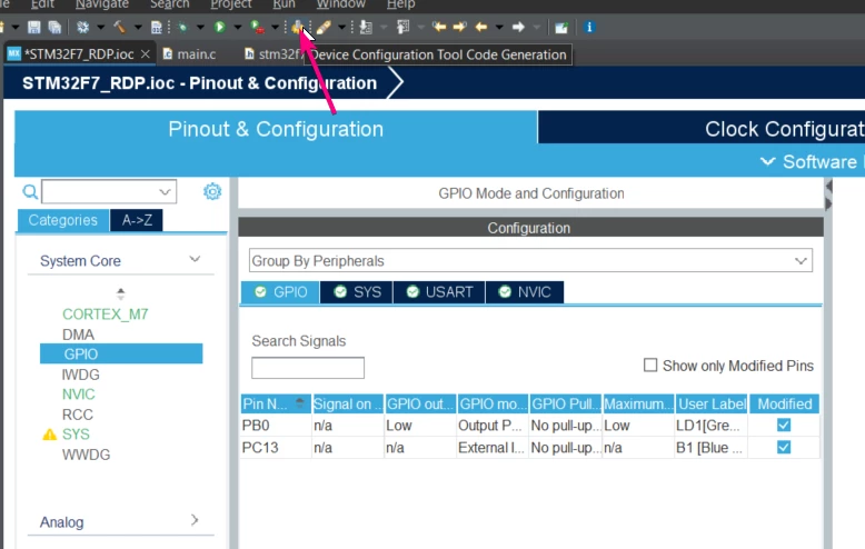

For the button pin and LED, we’ll use the hardware available in the NUCLEO board, this means that PC13 will be the push button and we can configure it by clicking and selecting ‘EXTI_13’. After that, setup a user label for the button doing the following: System Core > GPIO > PC13 and under User Label type ‘B1 [Blue PushButton]’.

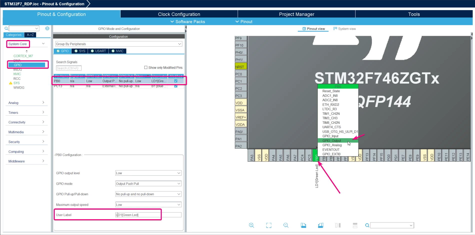

As for the LED, we will use the PB0, as it controls the onboard Green LED. On the dropdown menu select GPIO_Output, and similarly to the button pin, go to System Core > GPIO > PB0 and under User Label type ‘LD1 [Green Led]’.
It is now possible to either click on the Device configuration tool code generation icon in the top bar or press Alt+K. This will generate a basic project with all the configuration we selected using the GUI.

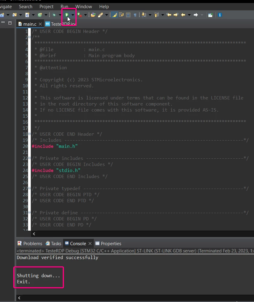

To test this code, we must follow a specific flow. First you should program the NUCLEO board with the code created. After building, click on the green button on the STM32CubeIDE, highlighted below:

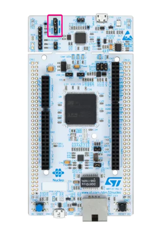

After this, the NUCLEO board must be disconnected from the USB’s computer and the CN4 jumpers removed from the ST-Link as shown:
Now the board must be plugged back in, which will power up the board and restart program execution.
Note: The reason behind removing the ST-Link jumpers is to prevent the debug connection by the ST-Link (which automatically happens at board power up) from interfering with the RDP entry/exit.

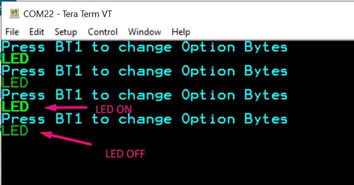

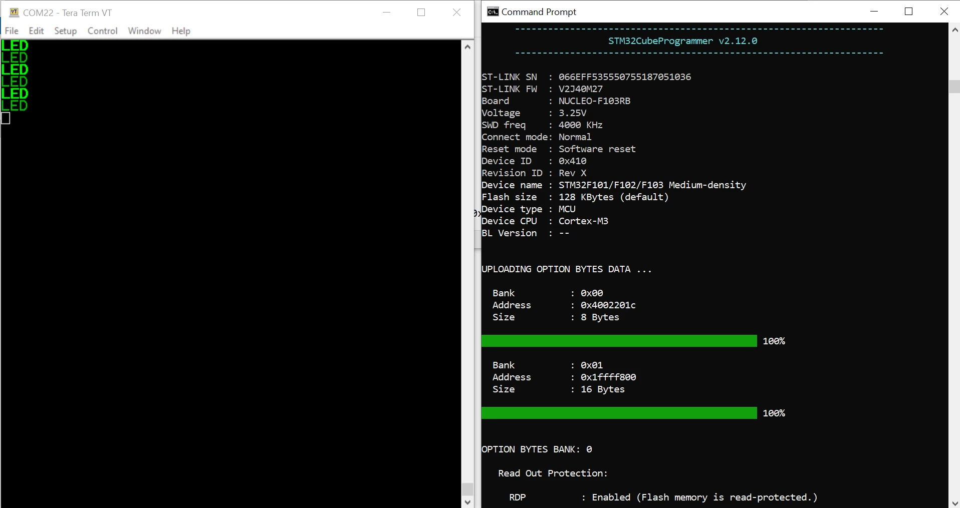

To confirm this, you can open a terminal, such as tera term and configure it to match the USART2 configuration we setup earlier, just to recall, it was: 115200/8/N/1. The terminal should display the following:

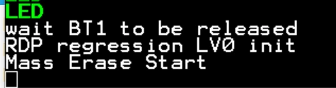

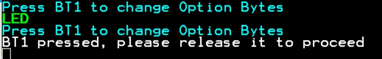

Now press and hold the blue button until the following message appears:
 Release the blue button to change the RDP level to 1. The MCU will reset itself and display the new RDP level message with a faster LED blink rate.
Press and release the blue button again to restore the RDP level to 0, causing a mass erase of the MCU.
At this point the Flash memory is automatically mass erased.

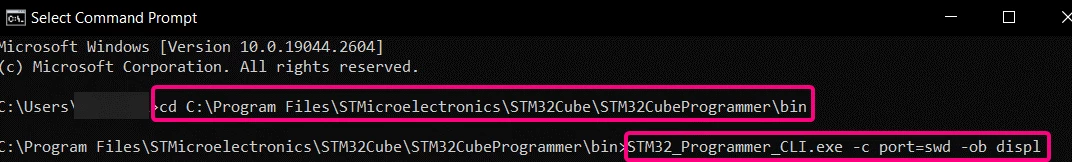

To confirm the RDP regression, fit the CN2 jumpers back in (no need to power cycle) and use the STM32CubeProg (GUI or CLI) to read the memory. Here it is demonstrated using the CLI to read the option byte.
Open your windows command prompt and type the following commands as shown
cd C:\Program Files\STMicroelectronics\STM32Cube\STM32CubeProgrammer\bin

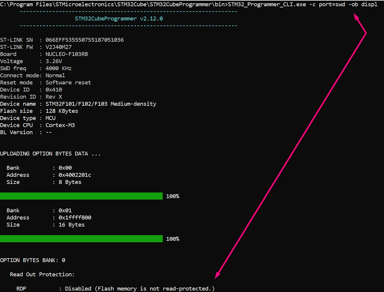

If the RDP regression worked, you’ll see a message like the following:

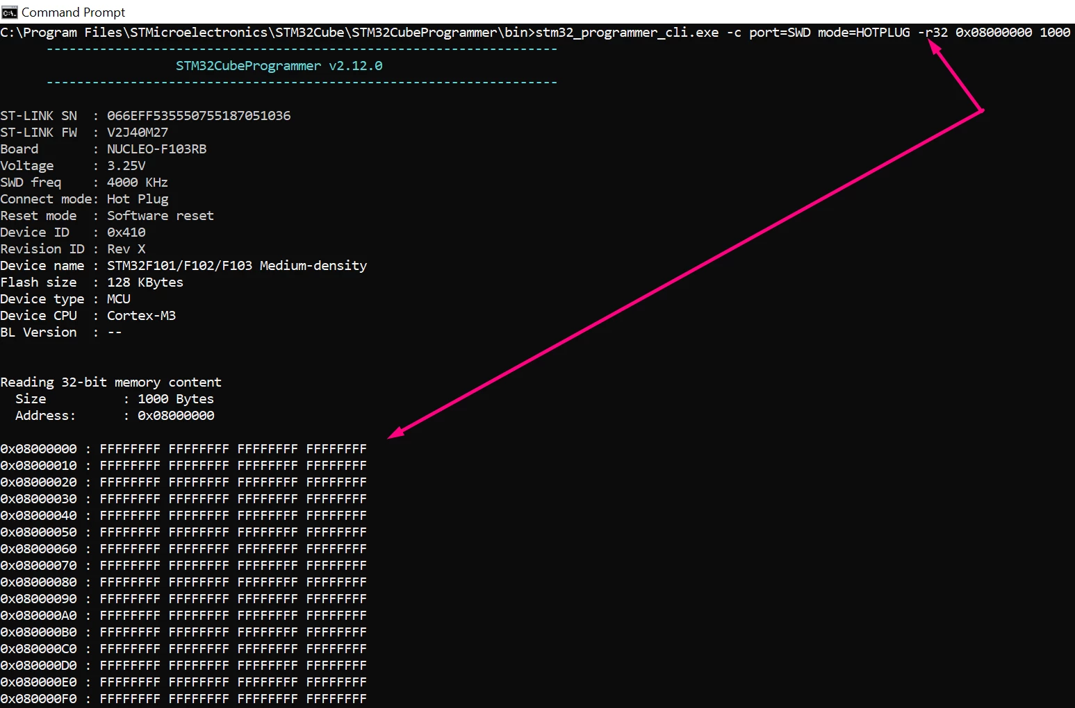

By using the command ‘STM32_Programmer_cli.exe -c port=swd mode=HOTPLUG -r32 0x08000000 1000’ you can see the contents of the flash memory, which as we expected, are all FFFF FFFF:

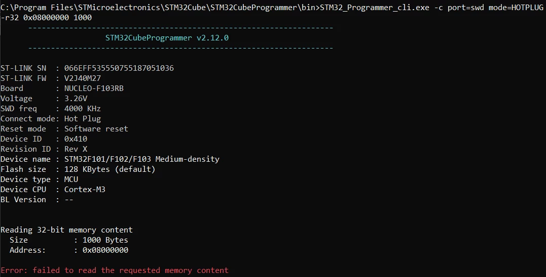

In order to see the RDP protection taking place, you can re-do the steps (reprogram your code using the CubeIDE, remove CN2 jumpers, power cycle, press the button to set RDP level 1) and fit the CN2 jumpers after it was set to level 1. Now, you can reissue the option byte command ‘STM32_Programmer_CLI.exe -c port=swd -ob displ’ to view the RDP status. Be aware that this will trigger the read-out protection and after the execution of this command your microcontroller will halt completely and recover only after a power cycle.
To further explore, you can try to check the Flash contents again using the command:
, but this time you’ll receive an error message as the microcontroller has protected the Flash content, and again the micro will halt until it is power cycled.
