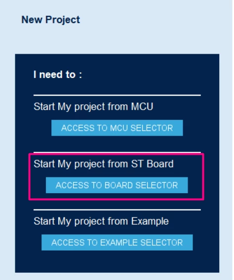

Start by creating a new project using the STM32CubeMX for the selected board. This can be quickly accomplished by using the main menu and selecting the [Start My project from ST Board]:

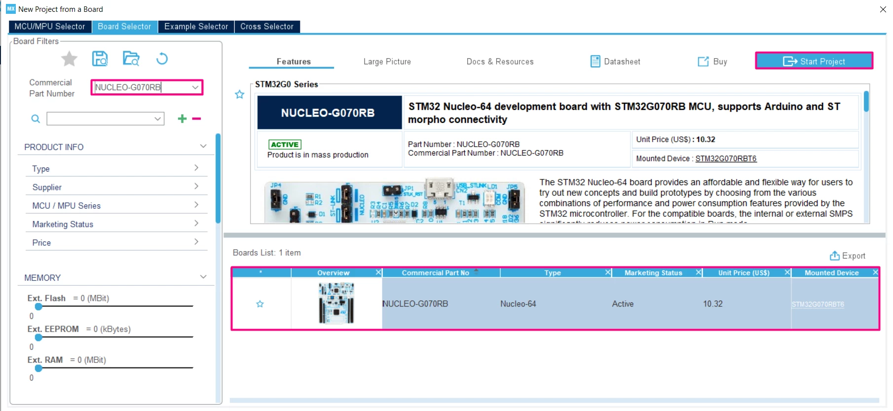

Once the new window opens, locate the empty field of [Commercial Part Number]. Type in the board [NUCLEO-G070RB] (adjust to your board if needed), select the board and click [Start]. Another window pops up asking [Initialize all peripherals with their default Mode?], click [Yes].

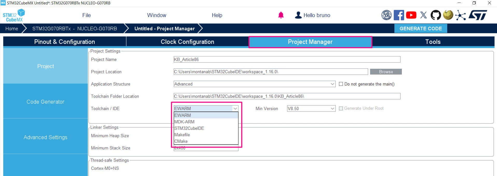

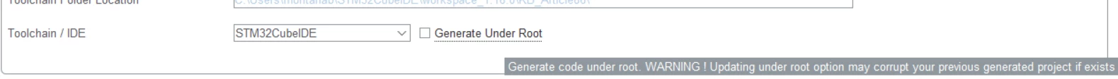

In the [Project Manager] tab, we can specify which IDE we want to use for the project and code generation. This is also the place where we can specify the project location and the project name. Make sure you fill the information aligned with your preferences. Keep in mind that for the STM32CubeIDE, you need to make sure your project does not have [Generate Under Root] checkbox selected, as it can corrupt other generated projects.
1.1. For IAR EWARM
1.2. For STM32CubeIDE
Click on the [Generate Code] button on the upper right corner once for each IDE. You should have this folder structure:

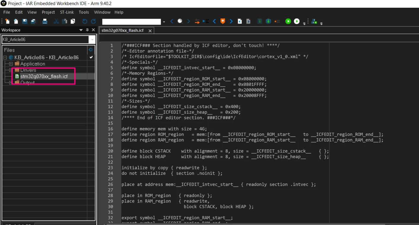

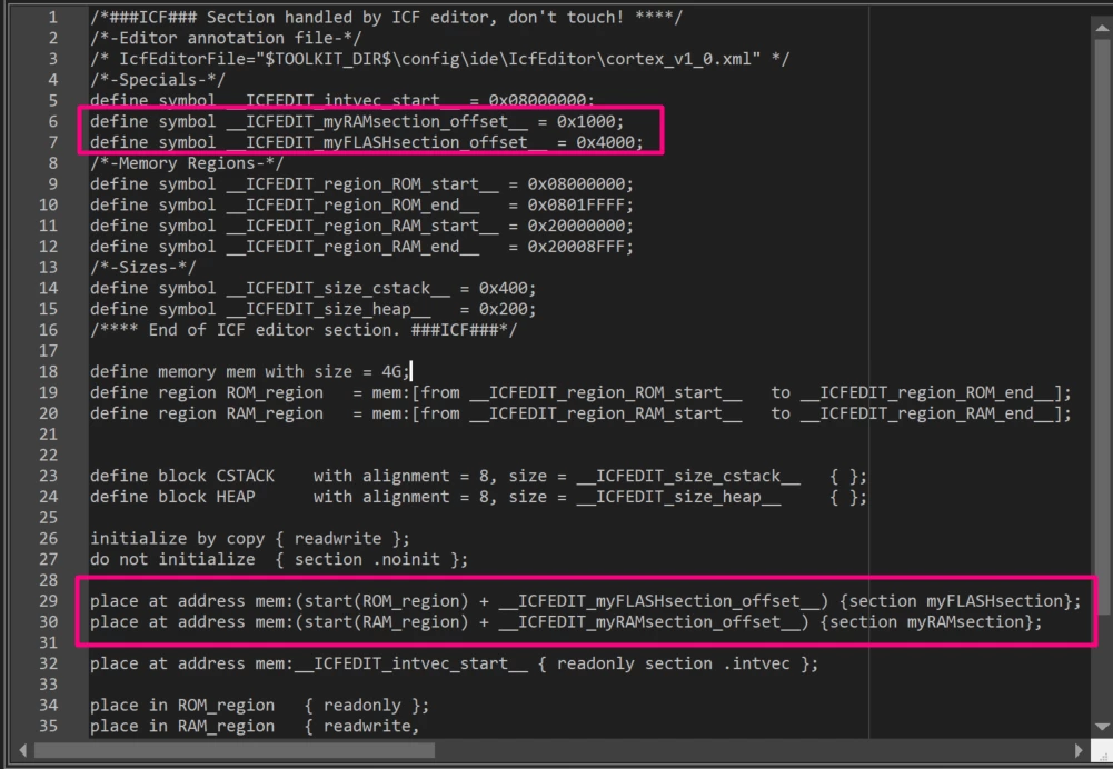

Locate and open the[stm32g070xx_flash.icf. This file can be more easily found in the EWARM folder, but is not visible from the EWARM workspace by default. You can drag and drop the stm32g070xx_flash.icf in the EWARM workspace and open it to edit.
To create the sections in existing regions, we can use the command [place at address mem:]. Therefore, we create two sections, one for the RAM and another one for the flash. To establish the starting point of the section, two symbols definition are created, leading to this:
define symbol __ICFEDIT_myRAMsection_offset__ = 0x1000;
define symbol __ICFEDIT_myFLASHsection_offset__ = 0x4000;
And the sections can be added like this:
place at address mem:(start(ROM_region) + __ICFEDIT_myFLASHsection_offset__) {section myFLASHsection};
place at address mem:(start(RAM_region) + __ICFEDIT_myRAMsection_offset__) {section myRAMsection};
Here is a visual representation of the places to add the mentioned edit commands:

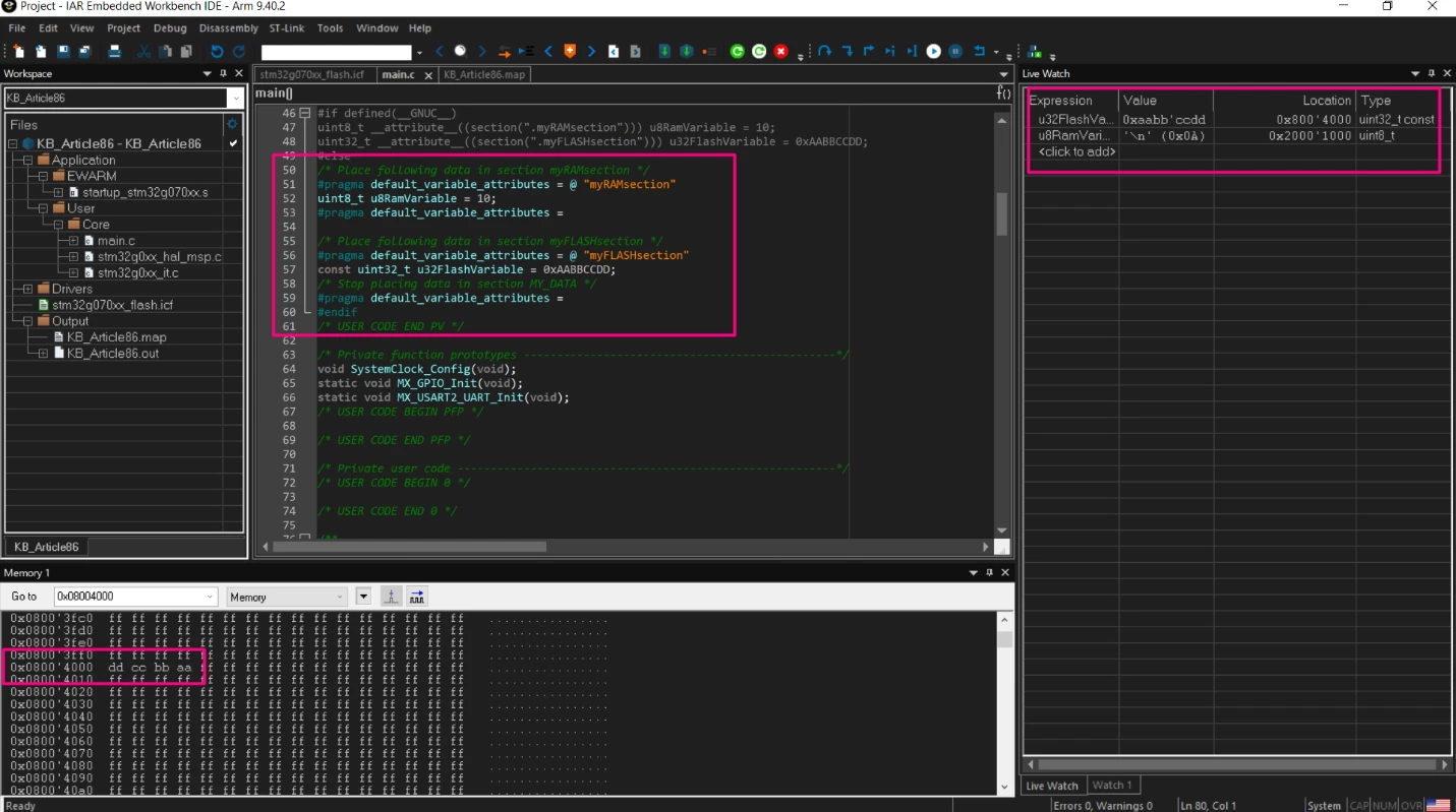

Also, on IAR EWARM only, make sure to change the optimization level from its default HIGH to NONE. This allows the debugging experience to be better for this simple example code. You can change the optimizations by going into the [Project][Options][C/C++ Compiler][Optimization] tab.
This way we have a variable called u8RamVariable in a section .myRAMsection that is located in the address 0x20001000 in RAM for both IDEs and in a similar fashion, we have an initialized variable that resides inside a flash memory section myFLASHsection, called u32FlashVariable. Of course, you can read this variable normally, but if it is needed to change its value during code execution. The same procedure of a regular flash programming needs to be used, including unlocking the flash, erasing the page and only then proceeding with the programming. The variable in flash was just to showcase the usage of the sections.
5. Results

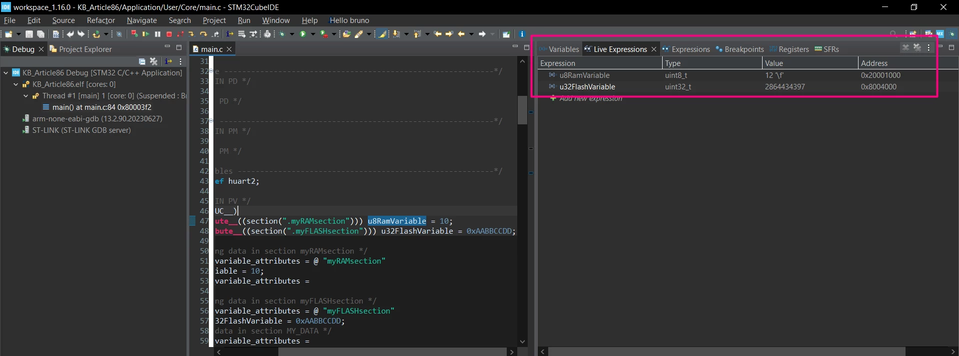

Press [Ctrl + B] on STM32CubeIDE or [F7] on EWARM IAR to build the project, there should be no errors. Now, connect the NUCLEO-G070RB to the computer using a USB/Micro USB connector and enter in debug mode. The process for the IDEs is rather similar, as both allow live view of the variables and memory as well.
In the STM32CubeIDE, it is possible to add the variables in the live watch:
And IAR EWARM, it is possible to add them in the live watch as well.

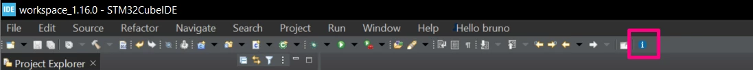

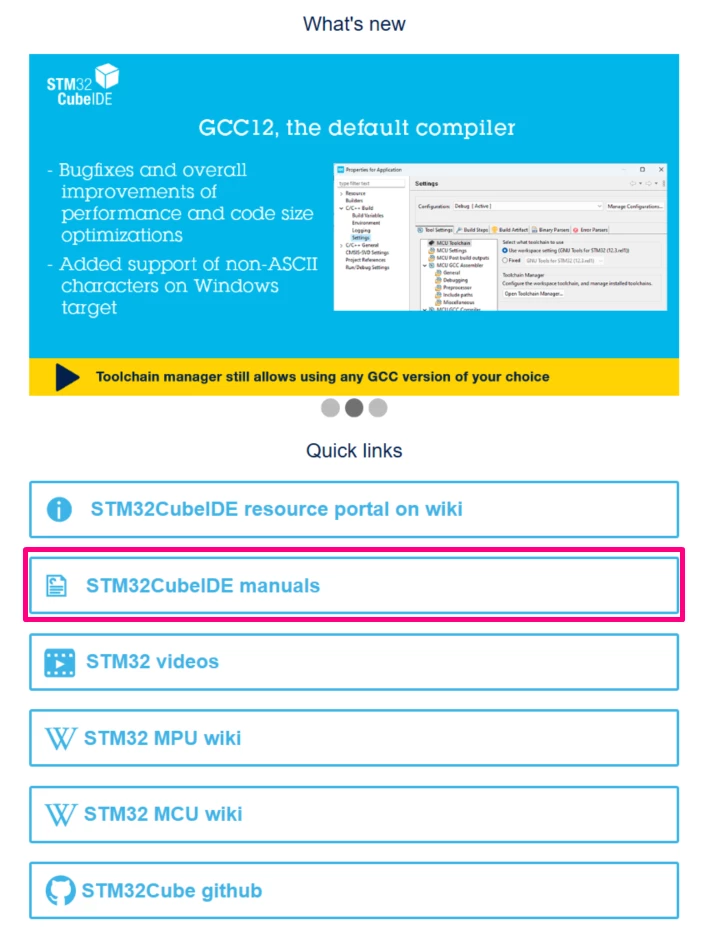

Here is a small tutorial on how to locate additional documentation regarding the GCC/STM32CubeIDE. Within STM32CubeIDE, locate and click on the [Information Center] button.
In the home page, click on [STM32CubeIDE manuals].

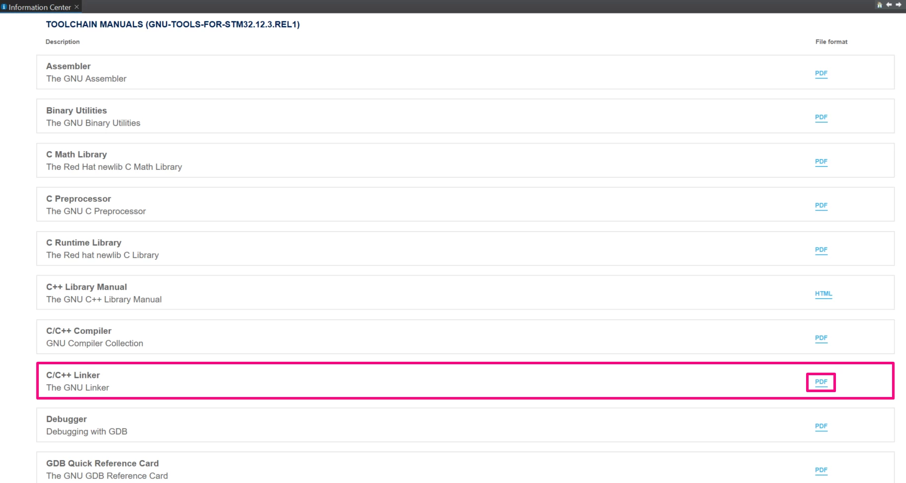

This page offers multiple useful links for tools of the STM32CubeIDE. Scrolling down, you are able to find the document about the linker script and GCC below the [TOOLCHAIN MANUALS] section.
