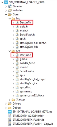

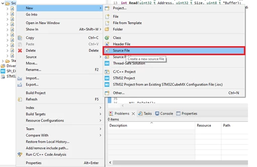

First, create the file that will receive all the necessary External Loader functions. In Core -> Src click with right mouse button, go to New ->  Source File and create a file named “Loader_Src.c”.
This file needs to receive the following functions in these specific format (the same names, types, parameters and return values). These functions will be used by STM32CubeProgrammer to manage the external memory and you should place your memory driver inside that, according to the function purpose. These are the functions will need to populate:
int Write(uint32_t Address, uint32_t Size, uint8_t *buffer);
int Read(uint32_t Address, uint32_t Size, uint8_t *Buffer);
int SectorErase (uint32_t EraseStartAddress ,uint32_t EraseEndAddress);

The other two files that we need to create are “Dev_Info.c” and “Dev_Info.h”. These files will manage the header memory information used by STM32CubeProgrammer to read, program and erase the device – there are examples available in the STM32CubeProgrammer installation folder and also referred in the UM2237. So, let’s start creating these files from scratch. Create “Dev_Inf.h” in Core - > Inc folder, and “Dev_Inf.c” in Core -> Src.
Starting by the header code, we need to create a specific struct that will receive all the necessary information about the memory and communication type.  So, add the following code on the file.
#define 	MCU_FLASH 	1
#define 	NAND_FLASH 2
#define 	NOR_FLASH 3
#define 	SRAM 4
#define 	PSRAM 5
#define 	PC_CARD 6
#define 	SPI_FLASH 7
#define 	I2C_FLASH 8
#define 	SDRAM 9
#define 	I2C_EEPROM 10
#define SECTOR_NUM 10				// Max Number of Sector types
struct DeviceSectors
 unsigned long		SectorNum; // Number of Sectors
 unsigned long		SectorSize; // Sector Size in Bytes
struct StorageInfo
 char 	 DeviceName[100];				// Device Name and Description
 unsigned short DeviceType;					// Device Type: ONCHIP, EXT8BIT, EXT16BIT, ...
 unsigned long DeviceStartAddress;			// Default Device Start Address
 unsigned long DeviceSize;					// Total Size of Device
 unsigned long PageSize;						// Programming Page Size
 unsigned char EraseValue;					// Content of Erased Memory
 struct 	 DeviceSectors	 sectors[SECTOR_NUM];
In “Dev_Inf.c” we only need to declare and initialize that struct and store it on the .Dev_info section of the RAM (for that, an __attribute__(section(“.Dev_Info”)) is placed in the struct declaration). The variable data of the struct should be changed to be compatible with the memory.

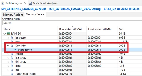

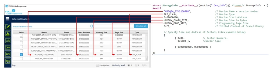

The struct data is shown by Cube Programmer when the External Loader is present on that.

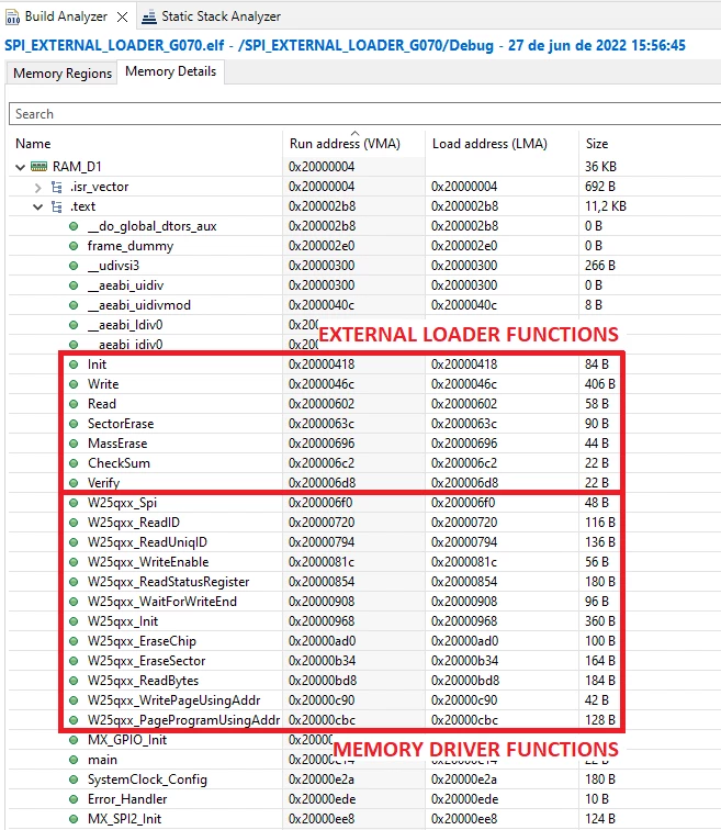

Building the project, the functions (including the memory driver functions) should be inside the .text section that are in the RAM_D1 memory area and a section named .Dev_Info with the StorageInfo struct was created.

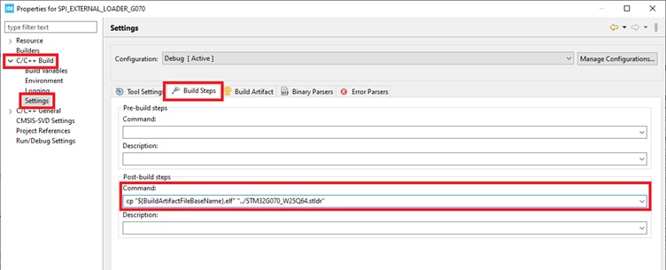

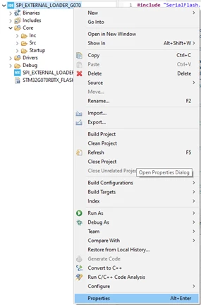

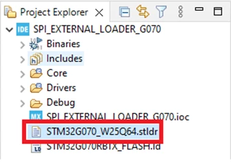

The final creation step of the external loader is to set the STM32 Project settings to generate the .stld (ST Loader) file after build the files. For that, click with right mouse button on the project and go to Properties.
In the settings, go to C/C++ Build -> Build Steps and add the following text in Command text box of Post-build steps:
cp "${BuildArtifactFileBaseName}.elf" "../STM32G070_W25Q64.stldr"
288.pngBuild the application and check in the project files if the STM32G070_W25Q64.stldr file was created (you can change the name if you want in the command text).

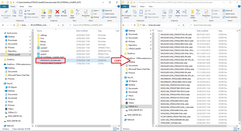

Now, the driver is ready to be used and we need to import that in the STM32CubeProgrammer. Copy the STM32G070_W25Q64.stldr file (that’s located in the root project folder) to the External Loader folder of the STM32CubeProgrammer. A fast way to locate this file is clicking with right mouse button on that and going to Show In -> System Explorer, so the file explorer should be open in the file located folder.

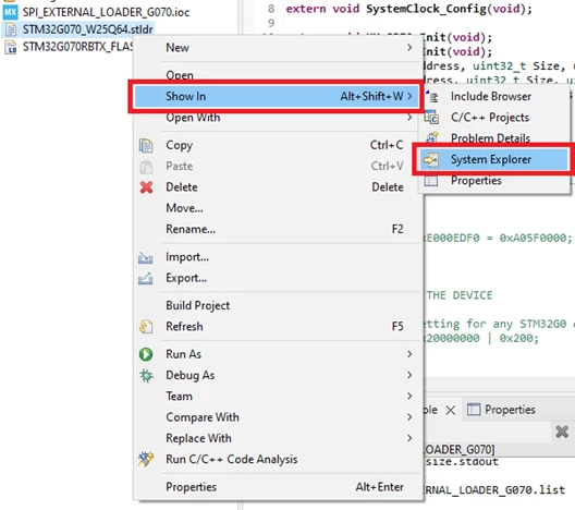

Then, copy and paste the *.stldr file to External Loader folder of the STM32CubeProgrammer, located in:
“C:\Program Files\STMicroelectronics\STM32Cube\STM32CubeProgrammer\bin\ExternalLoader”
(this path can change depending of your installation path, another way to reach on that is clicking with right mouse button on the STM32CubeProgrammer desktop shortcut and going to “Open file location” and search for the ExternalLoader folder on the opened location).

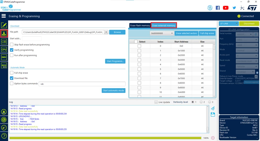

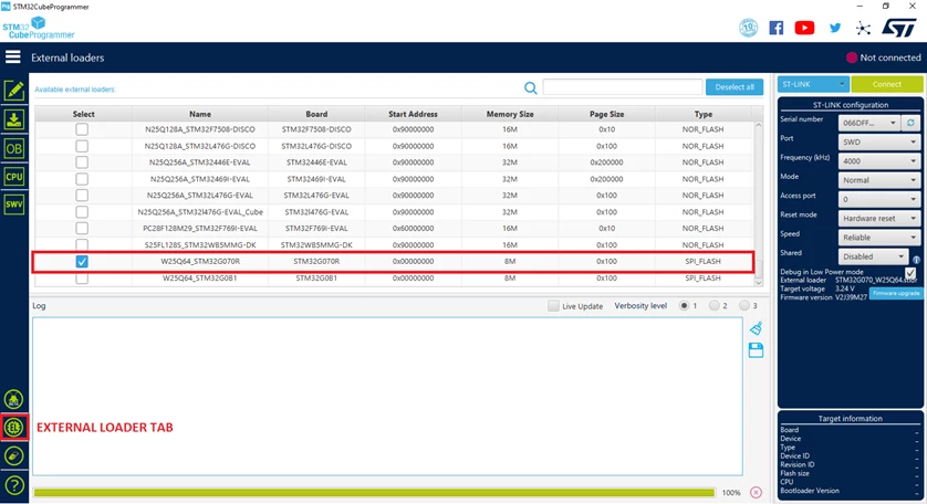

291.pngFinally, open the STM32CubeProgrammer and go to EL (External Loader) tab, search for the created loader and active that checking the current box.

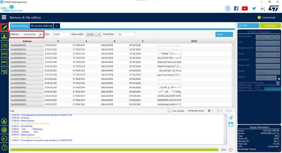

Going back to “Memory & File edition” and searching for an address of the external memory, if the process done well, you will see the content stored on that. In this case there are a sequence stored on the memory that starts from the 0x00000000 address.
If all the steps were properly made, the External Loader is running properly and now you can directly read, program and erase external memories. Congratulations!
