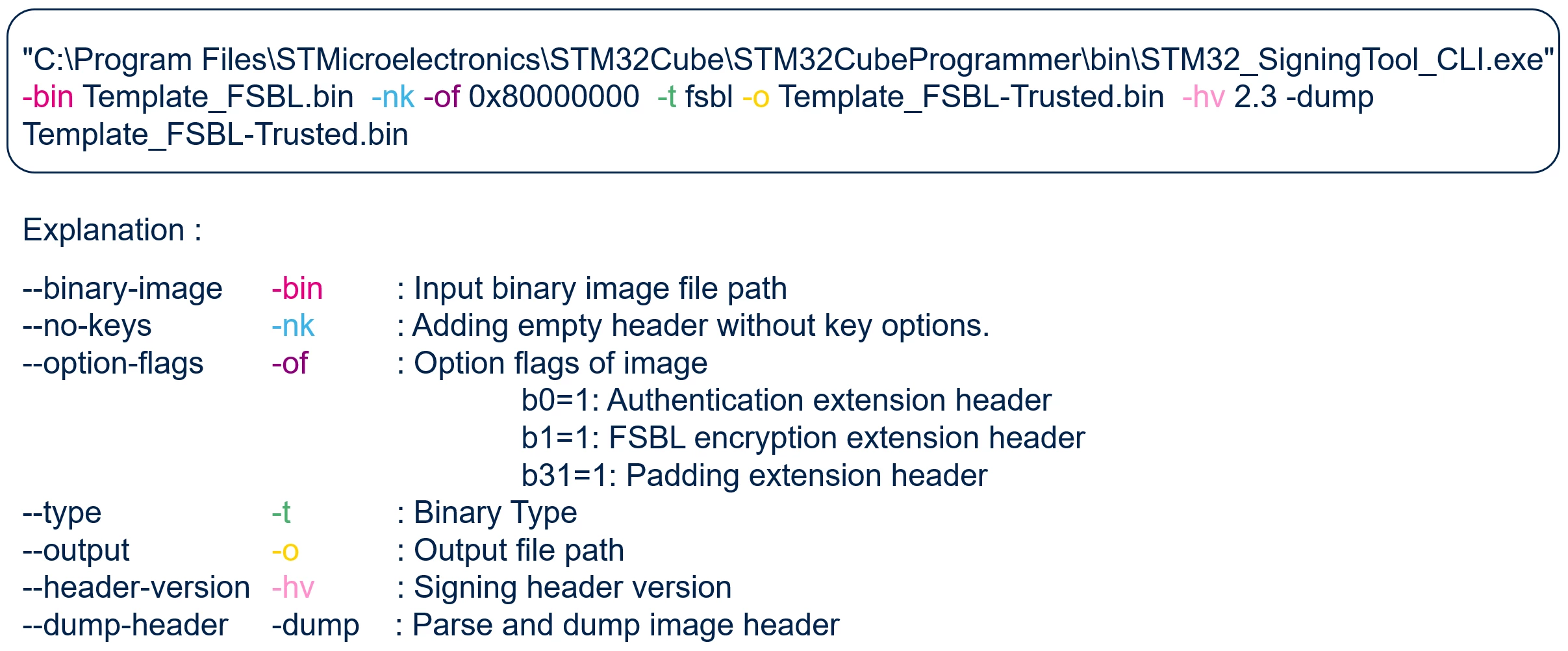

cd "${ProjDirPath}/Debug" && echo y | "C:\Program Files\STMicroelectronics\STM32Cube\STM32CubeProgrammer\bin\STM32_SigningTool_CLI.exe" -bin "${ProjName}.bin" -nk -of 0x80000000 -t fsbl -o "${ProjName}-Trusted.bin" -hv 2.3 -dump "${ProjName}-Trusted.bin" -align
Each command of the script above can be broken down to three main functionalities:
  • cd "${ProjDirPath}/Debug": Change to the directory where the binary file is expected to be.
  • echo Project Name: ${ProjName}: Prints the project name to verify the macro resolution.
  • echo y: Types ‘y’ to allow the overwriting the previous signed binary.
  • "C:\ProgramFiles\STMicroelectronics\STM32Cube\STM32CubeProgrammer\bin\STM32_SigningTool_CLI.exe" -bin "${ProjName}.bin" -nk -of 0x80000000 -t fsbl -o "${ProjName}-Trusted.bin" -hv 2.3 -dump "${ProjName}-Trusted.bin" -align: Runs the signing tool with the specified parameters and echo the outputs into the console.
The last command uses the STM32 Signing Tool parameters to set the proper configuration of the signed binary. The commands explanations are highlighted in the image below:

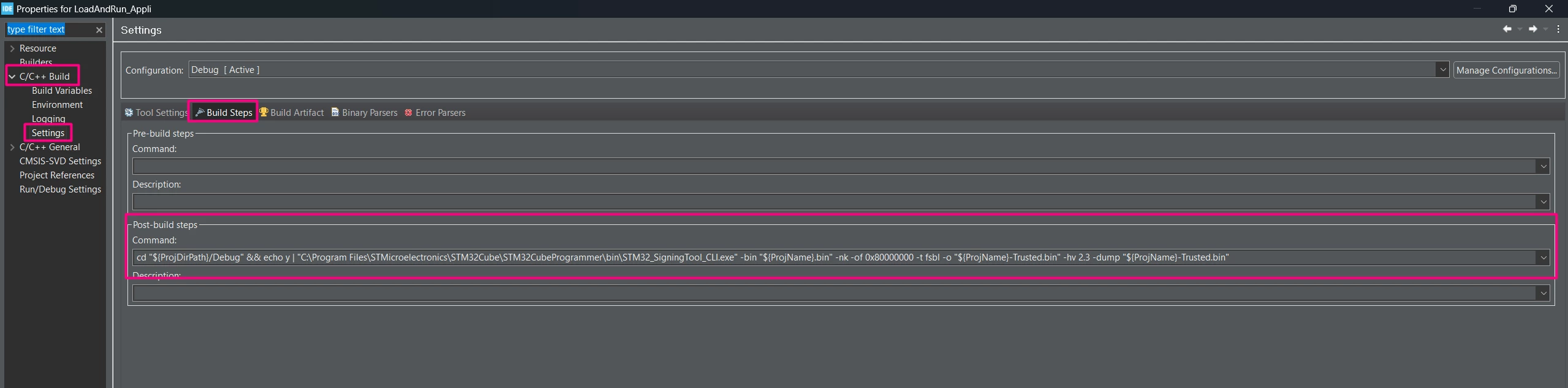

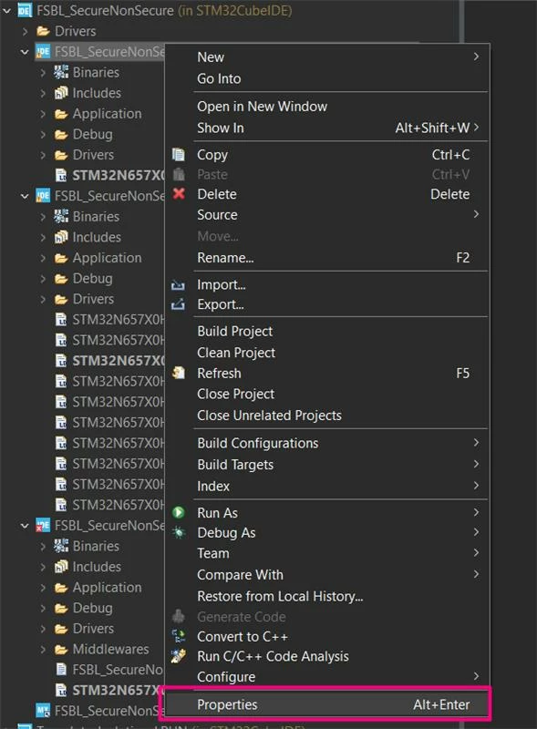

First, after importing or creating a project, right-click on the project name and click on [Properties].
A window should open. In the left part of the menu, click on the arrow next to [C/C++ Build], then select [Settings]. In the right part, a [Settings] configuration should appear. Select the [Build Steps] option. Finally, paste the command inside the [Post-build steps] text box, then apply the configurations and exit the window.

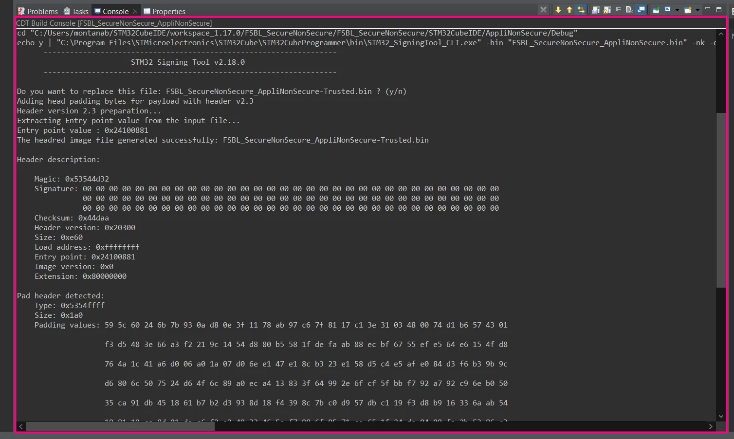

Now, whenever the project is built, the binary will have the header added as a post build action. The user can observe the message in the console output, as shown in the image below.
Most applications for the STM32N6 have two or more projects as part of the active workspace. It's important to emphasize that the post build command outlined can be implemented for all projects.
