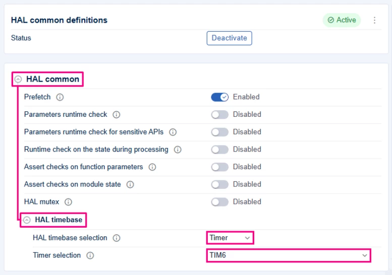

    • In the "Peripherals" section, activate [TIM6].
    • Go to the "Project Settings" section.
    • In the [HAL common definitions] → [HAL common], set the "HAL timebase" to [TIM6] instead of SysTick.
      • This allows the SysTick to be used by FreeRTOS™ as its kernel clock tick source.
      • TIM6 is used by the HAL for HAL_GetTick() and timeouts.

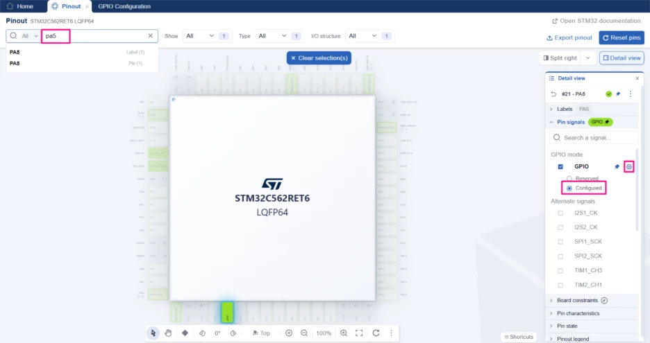

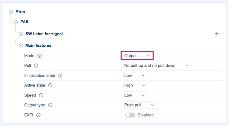

  • Configure a user LED
    • In the pinout view, locate the on‑board user LED.
    • Set the corresponding pin to GPIO_Output.
    • Optionally assign a user label (for example, LED_GREEN or USER_LED) for clarity.

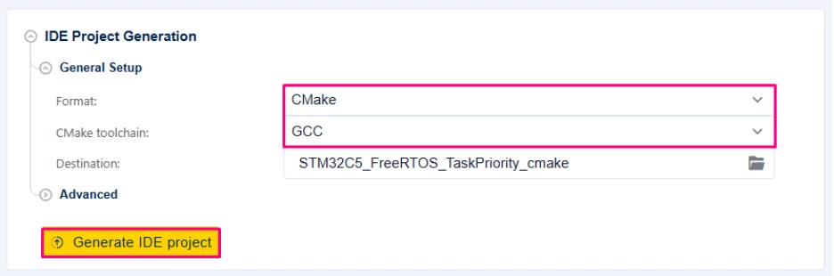

  • Generate the project
    • In the "Project Settings" →  "IDE Project Generation" → "General Setup" section.
    • Choose [CMake] as the project output format.
    • Select the appropriate toolchain (GCC/ARM).
    • Generate the code.

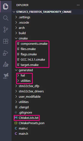

1.3 Understanding CMake project structure and middleware integration
In an STM32CubeMX2 CMake project, the top-level CMakeLists.txt acts primarily as a hub: it creates the application target and then delegates most of the configuration to smaller .cmake modules.
After STM32CubeMX2 generation and initial CMake configuration, a typical project layout looks like:
1.4 Top-level CMakeLists.txt
Your top-level file is intentionally minimal:
cmake_minimum_required(VERSION 3.20)
set(CMAKE_EXPORT_COMPILE_COMMANDS TRUE)
set(CMAKE_C_COMPILER_FORCED TRUE)
set(CMAKE_CXX_COMPILER_FORCED TRUE)
include(cmake/target.cmake)
include(cmake/${TOOLCHAIN_FILE})
project(STM32C5_FreeRTOS_TaskPriority)
add_executable(STM32C5_FreeRTOS_TaskPriority)
include(cmake/files.cmake)
include(cmake/flags.cmake)
include(cmake/components.cmake)
# Stubs for project-specific customizations
target_sources(${CMAKE_PROJECT_NAME} PRIVATE)
target_include_directories(${CMAKE_PROJECT_NAME} PUBLIC)
target_compile_definitions(${CMAKE_PROJECT_NAME} PUBLIC)
target_compile_options(${CMAKE_PROJECT_NAME} PUBLIC)
target_link_options(${CMAKE_PROJECT_NAME} PUBLIC)
target_link_directories(${CMAKE_PROJECT_NAME} PUBLIC)
target_link_libraries(${CMAKE_PROJECT_NAME} PUBLIC)
The main roles of these files are:
cmake/target.cmake + toolchain file
  • Describe the STM32C5 device (core type, clock, FPU, security, etc.).
  • Pass these parameters to the toolchain file, which derives the proper GCC flags:
    • -mcpu, -mfpu, -mthumb, security flags, endianness, etc.
  • Builds the CMSIS_COMPONENTS_LIST used by the CMSIS/RTE machinery.
  • Adds subdirectories such as arch/cmsis, stm32c5xx_dfp, stm32c5xx_drivers, generated/hal, generated/utilities.
  • Links their resulting targets to your application.
This file is also the integration point for middleware. For FreeRTOS™, you do not manually list the *.c files; instead the developer has to:
  • Append the relevant FreeRTOS™ components to CMSIS_COMPONENTS_LIST (for example, Core + Heap_4).
  • lLnk the resulting STMicroelectronics_freertos_X_Y_Z target to ${CMAKE_PROJECT_NAME}.
The CMake logic in the STM32C5 FreeRTOS™ package then automatically adds the correct kernel sources, portable layer, heap implementation, and include paths.
cmake/files.cmake
  • Registers the application sources, for example:
    • main.c, main.h.
  • Middleware sources themselves remain in the STM32C5 package structure and are brought into the build via components.cmake (through the FreeRTOS™ package CMakeLists.txt), not listed directly here.
cmake/flags.cmake
  • Sets the *.elf suffix and applies CPU flags.
  • Configures optimization and debugging options.
  • Sets global include directories (CMSIS core, HAL, DFP, user configuration).
  • Adds core definitions (for example STM32C562xx, _RTE_).
  • Configures linker options (map file, garbage collection, specs).

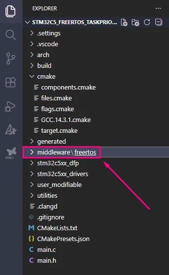

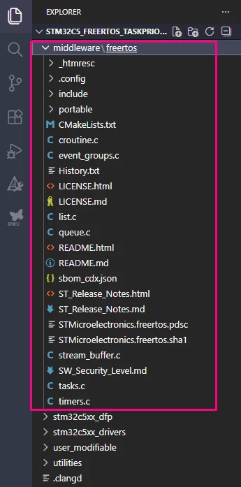

2.1 Add the FreeRTOS folder into the project
From your STM32C5 firmware package, locate the FreeRTOS™ middleware folder:
<STM32C5_Package>/middleware/freertos/
Create a corresponding folder inside your project, for example:
Copy and paste all the files:

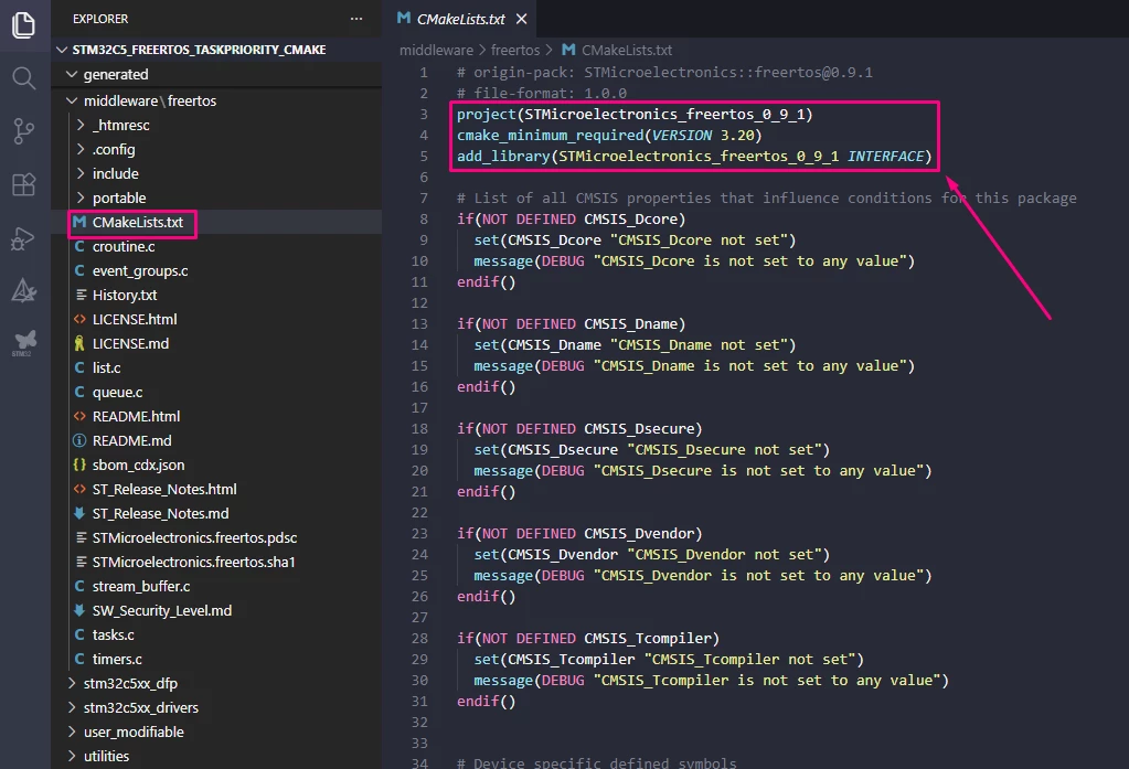

  • By adding the middleware/freertos subdirectory, the CMakelists.txt located inside it is added to the project.
  • Adding the two FreeRTOS component strings to CMSIS_COMPONENTS_LIST activates:
    • RTOS_FreeRTOS_Core_11_2_0, and
    • RTOS_FreeRTOS_MemMang_Heap_4_11_2_0.
  • When middleware/freertos/CMakeLists.txt runs, it checks:
if("Cvendor:STMicroelectronics#Cclass:RTOS#Cgroup:FreeRTOS#Csub:Core#Cversion:11.2.0" IN_LIST CMSIS_COMPONENTS_LIST)
 # add kernel sources, includes, portable layer…
endif()
if("Cvendor:STMicroelectronics#Cclass:RTOS#Cgroup:FreeRTOS#Csub:MemMang#Cvariant:Heap_4#Cversion:11.2.0" IN_LIST CMSIS_COMPONENTS_LIST)
 # add heap_4.c
endif()
  • It uses target_sources and target_include_directories on STMicroelectronics_freertos_0_9_1 to add all required files and paths.
By linking STMicroelectronics_freertos_0_9_1 into ${CMAKE_PROJECT_NAME}, your application automatically gets:

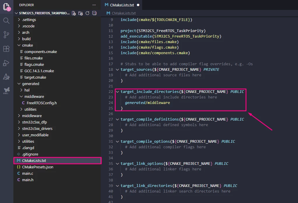

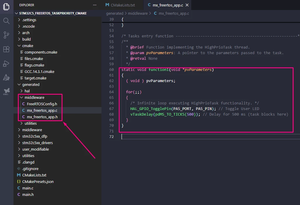

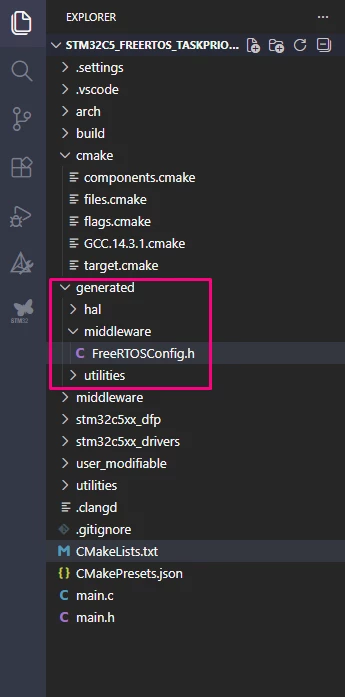

2.3 Ensure FreeRTOSConfig.h is available
A project-specific FreeRTOSConfig.h must be provided. Create a generated/middleware folder and add FreeRTOSConfig.h. Start from a reference configuration from the STM32C5 package or a standard FreeRTOS™ Cortex® M33 example. To make this header visible to the application code, add an include path in the CMake configuration, typically in the top-level CMakeLists.txt.
Create a generated/middleware folder and a configuration header FreeRTOSConfig.h, for example:
<ProjectRoot>/generated/middleware/FreeRTOSConfig.h
Start from a reference configuration from the STM32C5 package or from a standard FreeRTOS™ Cortex®‑M33 example. For this example, the FreeRTOSConfig.h, mx_freertos_app.c, and mx_freertos_app.h are attached.
To make this header visible to your application code, add an include path in your CMake configuration. A typical approach is to add it to your top-level CMakeLists.txt:

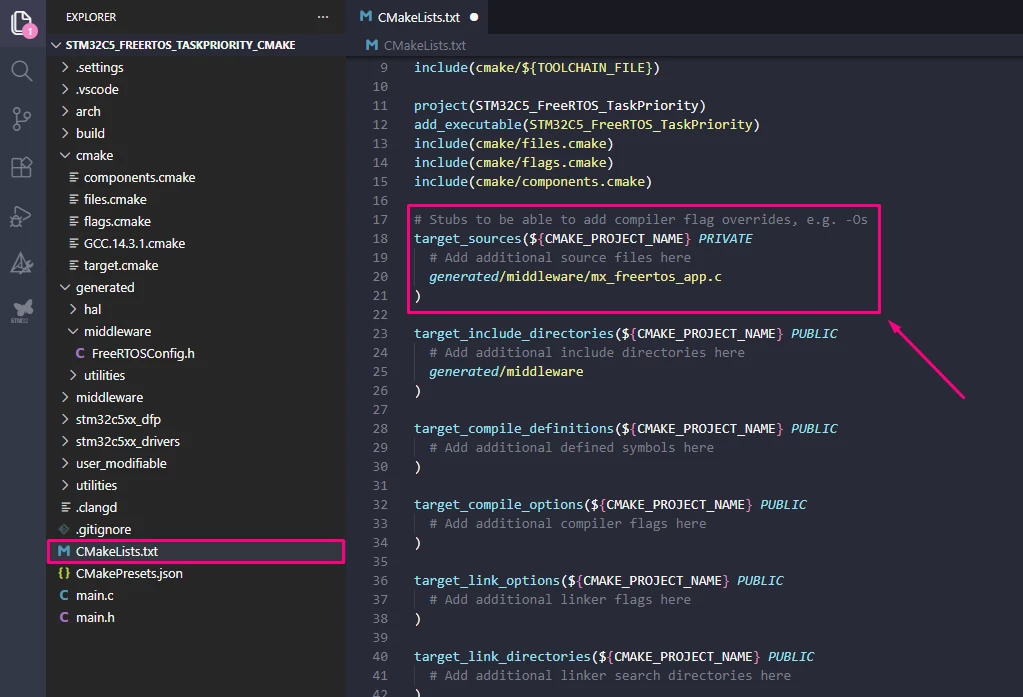

2.4 Register application files that use FreeRTOS™
In the top-level CMakeLists.txt file, add a source file where tasks are created and the scheduler is started:
Create mx_freertos_app.c and implement a basic LED task, for this example you can use the attached mx_freertos_app.c and mx_freertos_app.h and paste inside generated/middleware:
Then, call in main.c after the HAL and peripherals initialization:

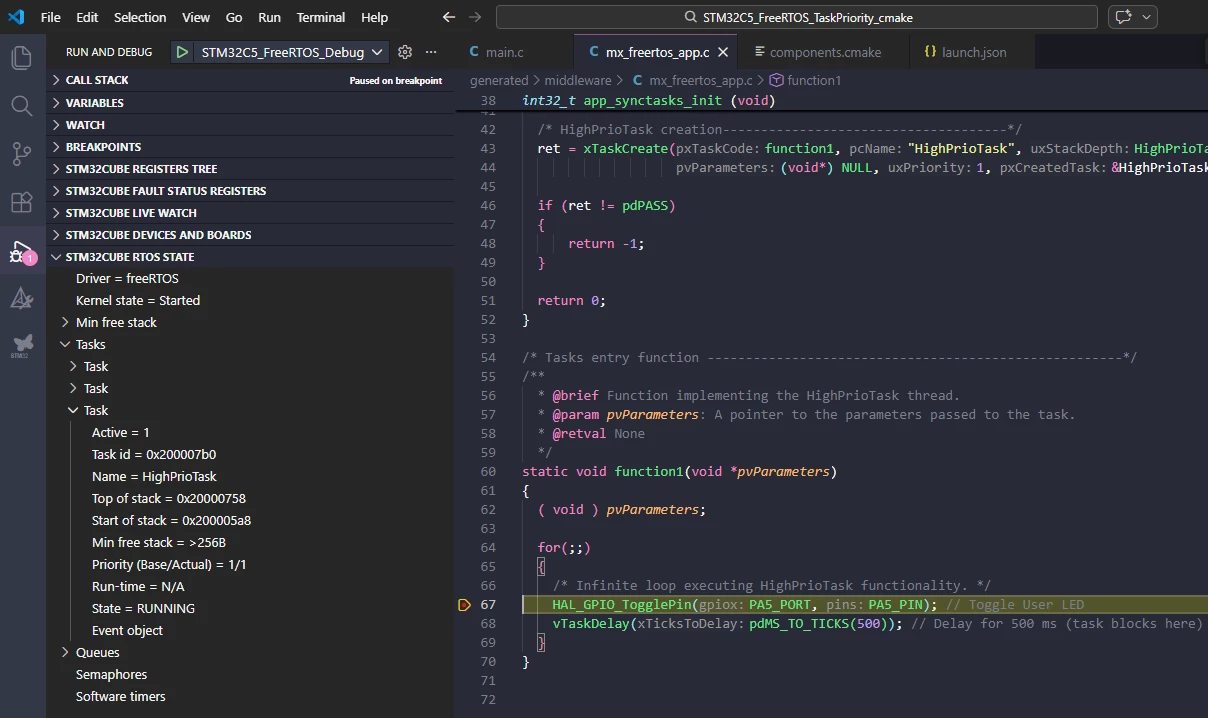

  • SysTick is free for use by FreeRTOS™.
  • The STM32C5 FreeRTOS™ package selects the ARM_CM33_NTZ port for GCC based on CMSIS_Dcore, CMSIS_Dsecure, and CMSIS_Tcompiler.
The scheduler should start and the LED should toggle at the expected interval.

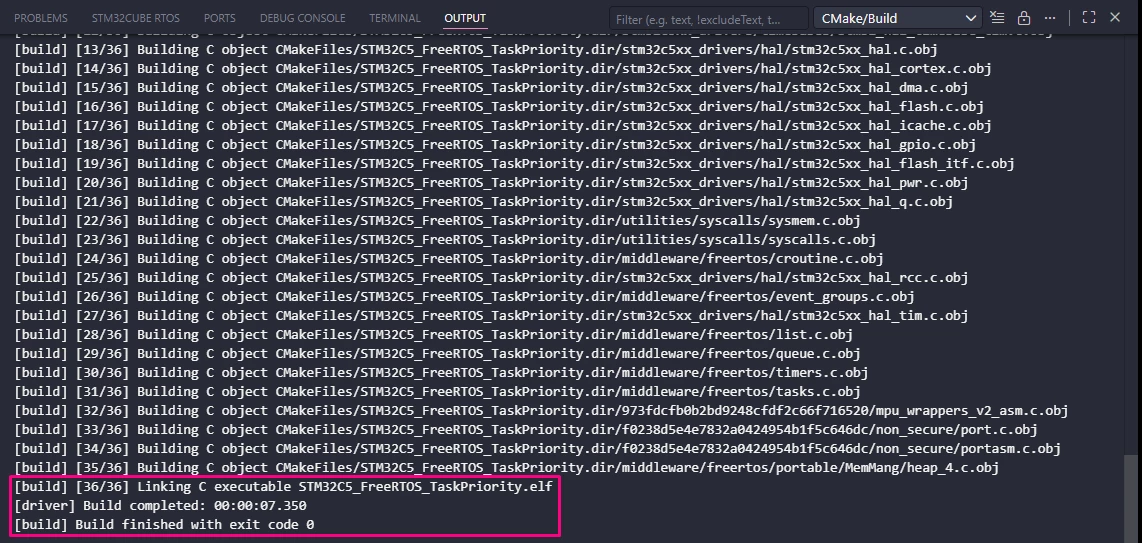

3. Configure, build, and verify
  1. Reconfigure CMake so that:
    • The updated CMSIS_COMPONENTS_LIST is processed.
    • STMicroelectronics_freertos_0_9_1 is configured with the correct sources and includes.
    • app_freertos.c is part of the building.
  2. Build the project:
    • If you see missing FreeRTOS.h or FreeRTOSConfig.h, verify include paths to the FreeRTOS package and your config header.
    • If you see duplicate heap or port files, check that only one heap variant is enabled (here: Heap_4) and that you are not adding manual FreeRTOS™ sources anywhere else.
  1. Flash and run on the NUCLEO‑C562RE:
    • The user LED should blink via the FreeRTOS™ task, confirming that the middleware is correctly integrated and scheduled.

  1. Locate the middleware package
    • Browse the STM32Cube package under Middlewares/ and identify the middleware folder (for example, USB_Device, FatFs, LwIP, etc.)
    • Look for a corresponding CMakeLists.txt inside that folder. This file defines the middleware CMake target and its conditions.
  2. Inspect the middleware CMakeLists.txt

  3. Expose configuration headers and includes
    • Add include paths with target_include_directories(${CMAKE_PROJECT_NAME} PUBLIC) to the top-level CMakeLists.txt file for any project‑specific configuration headers (for example, usbd_conf.h, ffconf.h, lwipopts.h) stored under generated/middleware or a similar directory.
  4. Use the middleware from your application
    • Add application code (for example, USB class callbacks, FatFs mount logic, LwIP network bring‑up) to the top-level CMakeLists.txt with target_sources(${CMAKE_PROJECT_NAME} PRIVATE)
