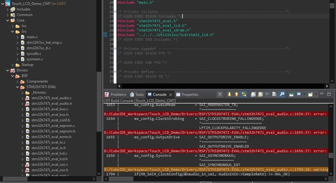

Hello @mattias norlander / Hello community members,
I am facing similar issue while adding the BSP to my project. Below is the screenshot of my workspace. I am using STM32h747I-Eval board.
What I did was I copied the BSP folder from "LCD_DSI_CmdMode_DoubleBuffer" example and pasted it on my project's 'drivers' folder. I get too many errors, I added paths to my BSP folder. Still the errors persists. What am I missing?
mattias norlander
Jan 29, 2024 9:29 AM UTC
Sorry @Sen_Koc ,
Looking at your screenshot the error output is cropped. I can only see :
error :
You need either to upload the or paste the build-log, or you if you can enlarge the build console and maybe use line wrapping...
My first guess would be that the defines are not updated in the stm32.._hal_conf.h to be in-sync with the requirements from the BSP related code. For example is this symbol defined:
#define HAL_SAI_MODULE_ENABLED 1
