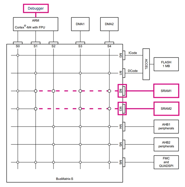

Accessing SRAM during Sleep mode for debugging purposes on the STM32L476 MCU requires a specific device configuration, relative to the memory architecture of the STM32L4 and the optimization strategies for low-power consumption.
To summarize, SRAM access is constraint in the following contexts:
  • SRAM access is disabled in Sleep mode to reduce power consumption, which is a default behavior in low-power operations.
  • The debug interface loses its ability to read or write to SRAM memory during Sleep mode, affecting real-time debugging capabilities.
  • Tools and functionalities that depend on uninterrupted memory access, such as SEGGER Real Time Transfer (RTT), are unable to operate as intended when the microcontroller is in a low-power state.
This article explores the memory architecture of the STM32L476, the limitations encountered in low-power modes, and presents a DMA-based workaround to overcome these challenges.

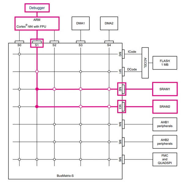

1.1. SRAM memory structure and access
In the STM32L476 microcontroller, the memory architecture is built around a BusMatrix that manages access arbitration between various controllers. This includes the Cortex®-M4 core's I-bus, D-bus, and S-bus, as well as DMA controllers. This matrix also connects to eight target components, such as internal flash, SRAM1, and SRAM2. This architecture ensures efficient data transfer tailored to specific use cases.
The D-bus (S1) is a crucial link between the Cortex®-M4 core's data bus and the BusMatrix. It is utilized by the core for literal loads and during debug access, providing uninterrupted access to SRAM. This facilitates efficient operation and debugging by offering a direct pathway to SRAM via the D-bus, enabling real-time data inspection and manipulation.

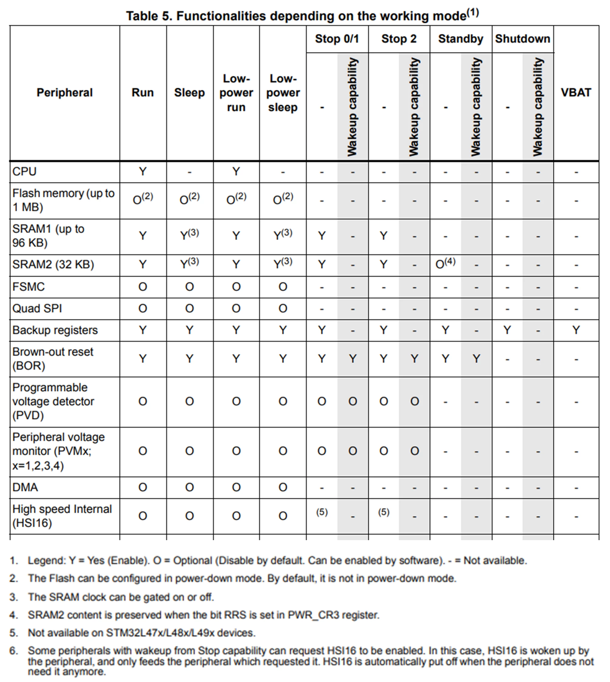

The STM32L476 has several low-power modes available to save power when the CPU does not need to be kept running. Each of these modes is designed to provide a balance between power conservation and the ability to maintain system state, keep some peripherals available or respond to external events.
For example, in Sleep and low-power Sleep modes, the CPU is halted while all other functions remain operational (excepted USB OTG_FS and RNG in low-power Sleep mode). SRAM and register contents can be preserved, but the debug interface's access to SRAM is disabled to reduce power supply consumption.
1.3. Limitation in low power modes
As mentioned above, the D-bus allows for the manipulation of variables and analysis of the program in debug mode with the STM32L476.
In Sleep and low-power Sleep modes, the VCORE domain is halted to reduce power consumption, and the SRAM clock can be gated on or off (the contents of the SRAM and registers can be nevertheless preserved). However, to further minimize power usage, the access paths to these SRAM memory blocks are power off.
While the STM32L476's low power modes are beneficial for power conservation, they introduce a configuration change for developers who need to debug applications:
  • Debugging in Sleep and low-power Sleep modes: The debug interface, which typically uses SRAM access for monitoring and modifying application state, is unable to perform these operations when the microcontroller is in Sleep and low-power Sleep mode.
  • SEGGER RTT and other debug tools: Real-time debugging tools that rely on continuous memory access are particularly affected, as they can only function with active SRAM access.

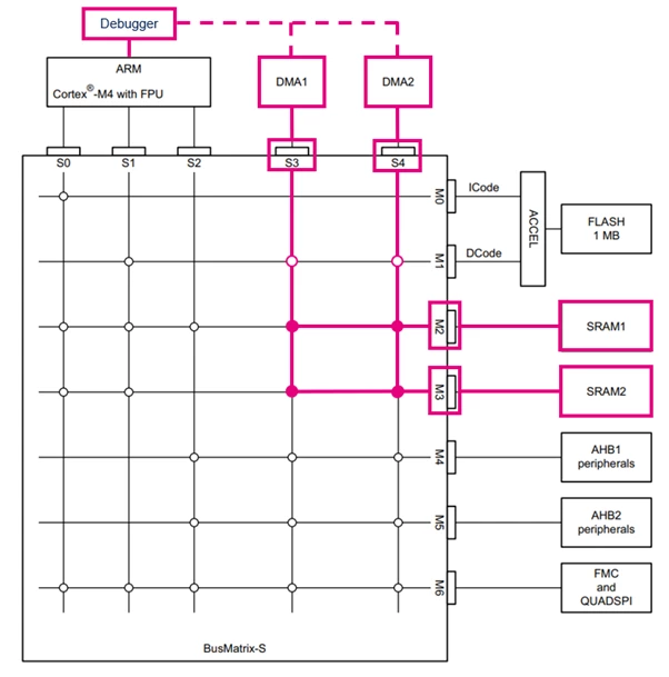

The Direct Memory Access (DMA) controller in the STM32L476 offers the solution to the SRAM access challenge during Sleep and low-power Sleep modes. While the CPU and its buses may be inactive during these modes, the DMA can remain operational. This is because the DMA is designed to perform high-speed data transfers independently of the CPU. It's particularly useful for power-saving strategies where the CPU is not required to be active.
The DMA's ability to access memory and peripherals without CPU intervention can be leveraged to maintain a "hidden" access path to SRAM during Sleep mode. By configuring the DMA to perform transfers involving SRAM, we can ensure that the BusMatrix, which arbitrates access to memory, remains active. This is due to the BusMatrix's design, which automatically activates when at least one master (such as the DMA) is on.
2.2. How to use DMA to access SRAM
To utilize DMA for SRAM access during Sleep mode, follow these steps:
  • DMA configuration:
Begin by configuring the DMA channel with SRAM as the destination address. This can be SRAM1 or SRAM2, depending on where the data of interest resides.
Set the source address to a peripheral that is active during Sleep mode or another memory region that is not restricted in low-power modes.
Configure the transfer size and enable the DMA channel, ensuring that the transfer does not start immediately but is ready to be triggered.
  • Trigger source:
Identify a trigger source that remains active during Sleep mode. This could be a timer or an external interrupt line.
Configure the trigger source to initiate the DMA transfer when required. This could be set up to occur periodically or based on a specific event.
  • Entering Sleep mode:
Before entering Sleep mode, ensure that all necessary peripherals, including the DMA and its trigger source, are correctly configured and enabled.
Enter Sleep mode with the confidence that the DMA maintains access to SRAM.
  • Data transfer:
Once in Sleep mode, the DMA responds to the trigger source and carries out the memory transfer. This effectively creates a window during which SRAM can be accessed, despite the CPU being inactive.
The data transferred by the DMA can be used to monitor the application state or facilitate debugging by moving relevant data to a location where it can be accessed post-wake-up.
  • Monitoring and Debugging:
After waking up from Sleep mode, the data transferred by the DMA to SRAM can be inspected.
This allows developers to analyze the state of the application during low-power mode without disrupting the low-power consumption benefits.
By following these steps, developers can create a system that allows for SRAM access during Sleep mode. It allows for effective debugging and monitoring without compromising on the low-power consumption that the STM32L476 is designed for.
