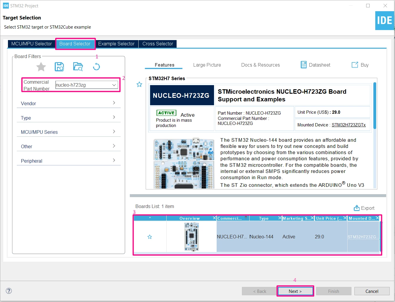

Launch STM32CubeIDE (version used 1.7.0), select your preferred workspace, click on Launch. Once open, locate the Information Center, select to Start New STM32 Project – alternatively, click on File->New->STM32 Project. For this demo, we’ll use the NUCLEO-H723ZG as the starting point

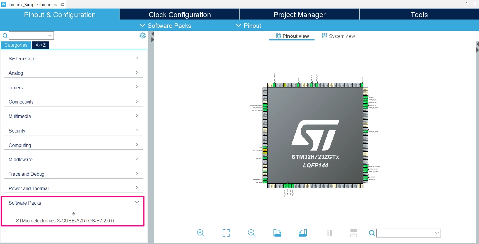

Time to add the software pack:
Browse and locate the AzureRTOS pack in the component selection window and open the RTOS ThreadX and check the Core box and click OK
This will add the Software Pack in the lower part of the Categories:

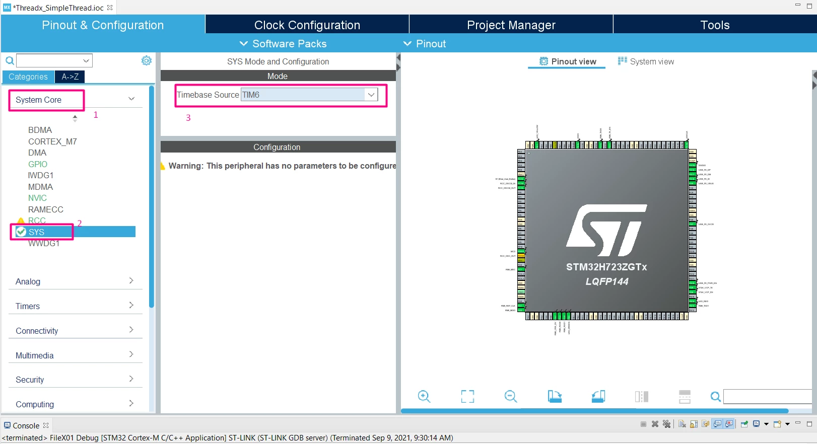

As this demo is just meant to create small printfs to indicate which thread it is and use the mutex, the default settings are alright, but we do need to do one other modification. By default, the HAL driver will use the Systick as its primary time base, but this timer should be left to the AzureRTOS only. We can simply select a different time base for the HAL by clicking in the System Core/SYS and selecting the time base Source as TIM6:

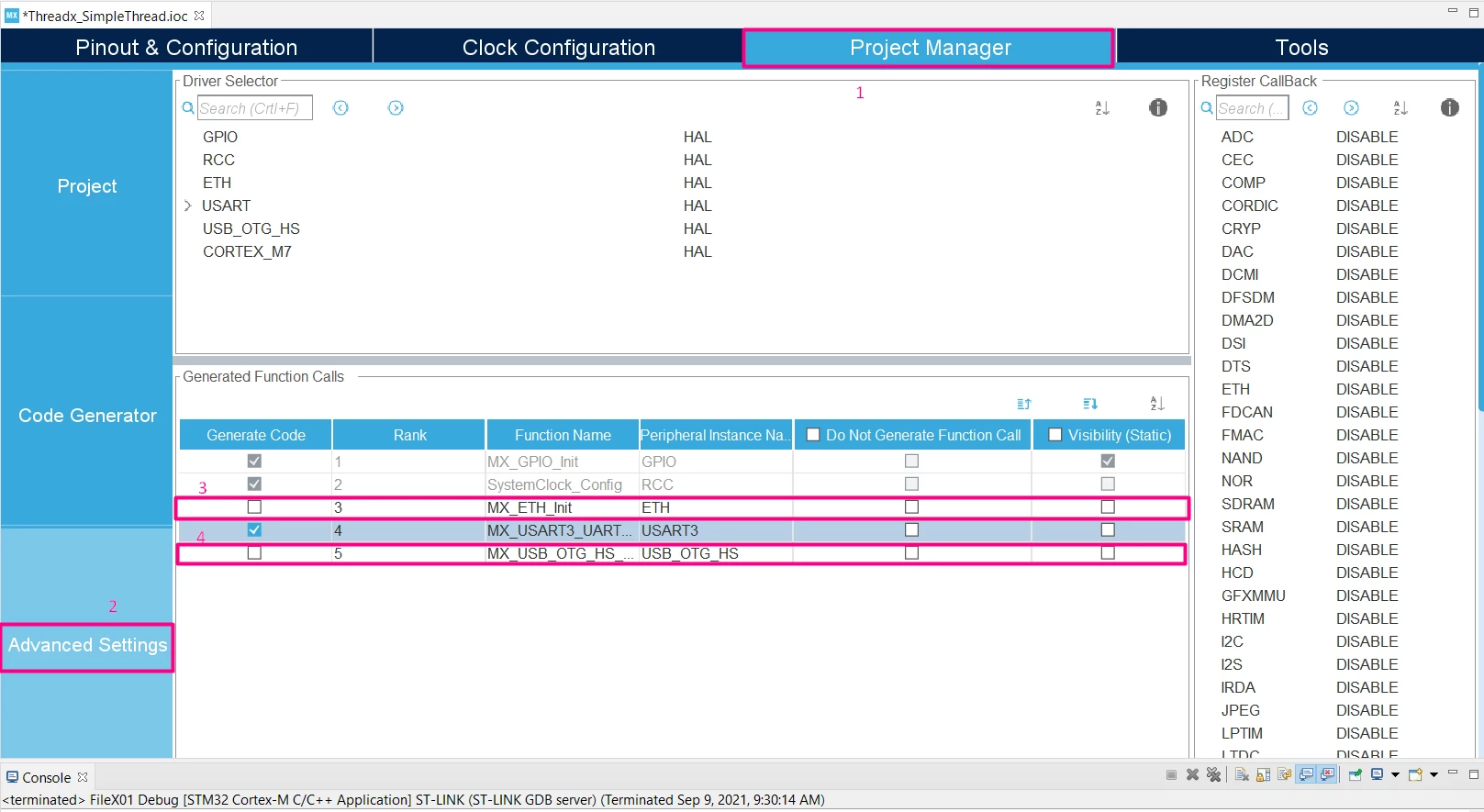

As the USB and Ethernet are not used in this demo, we can remove it by unchecking the boxes at the Project Manager tab/ advanced settings:

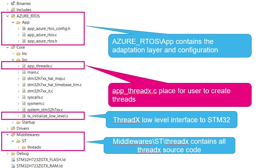

All set, we can press Alt+K to generate the code and Ctrl+S to save it. The project now has a new set of folders, this is the detail of its structure:
