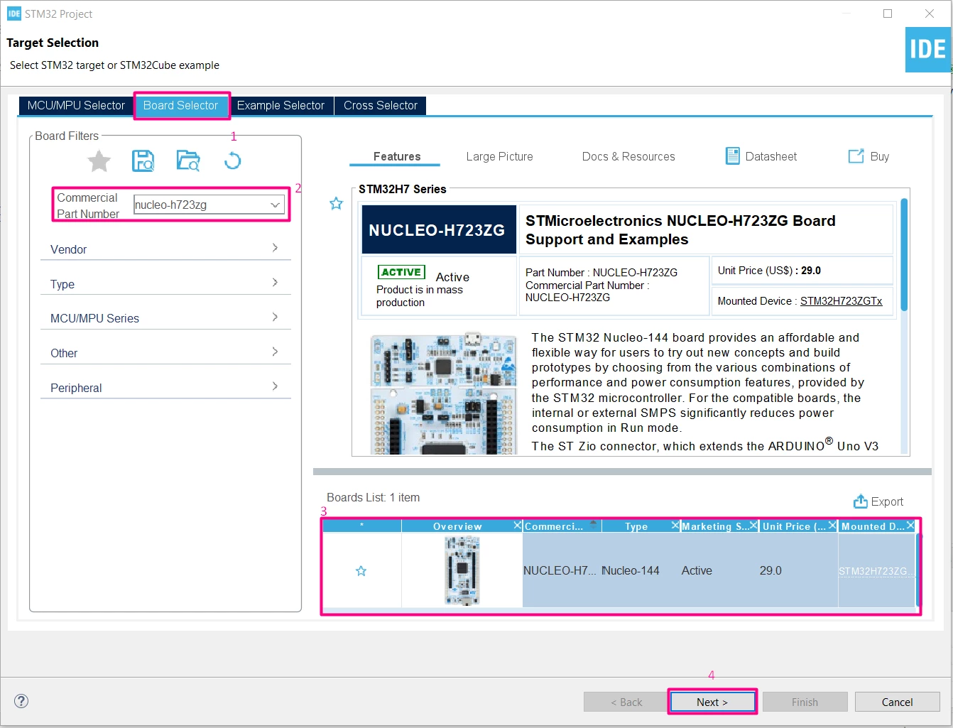

Launch STM32CubeIDE (version used 1.7.0), select your preferred workspace, click on Launch. Once open, locate the Information Center, select to Start New STM32 Project – alternatively, click on File->New->STM32 Project. For this demo, we’ll use the NUCLEO-H723ZG as the starting point
Give your project a name, just remember to avoid space and special characters – the name given by this article is “Queue”

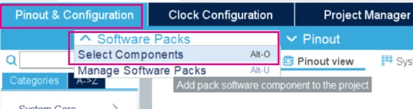

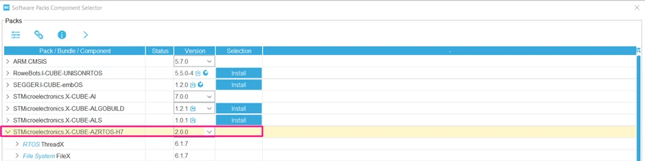

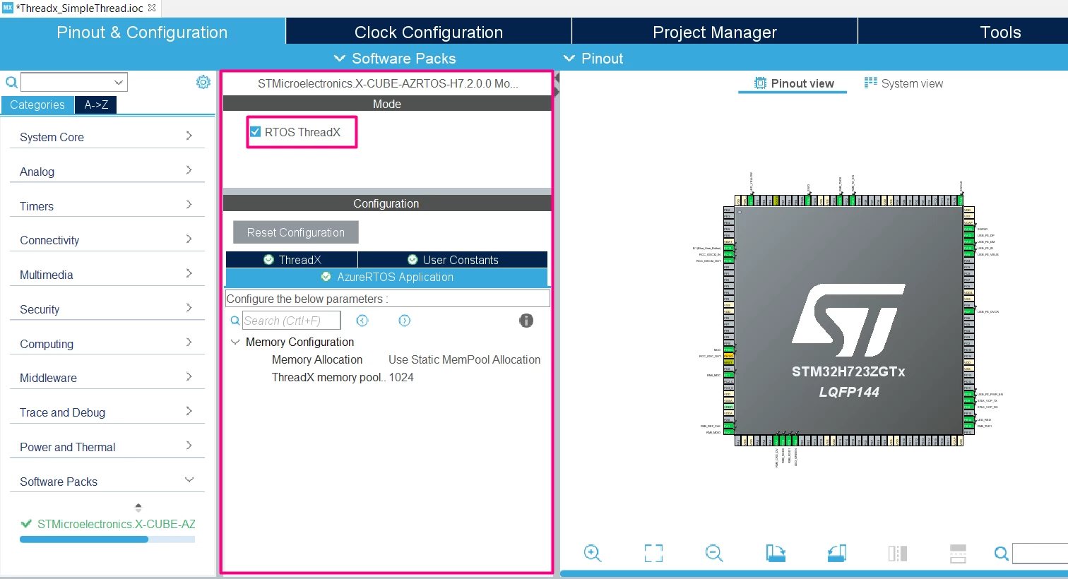

Time to add the software pack:
Browse and locate the AzureRTOS pack in the component selection window:

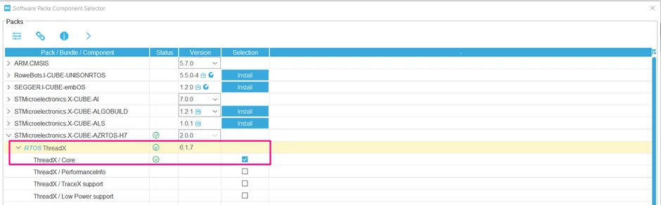

Open the RTOS ThreadX and check the Core box and click OK

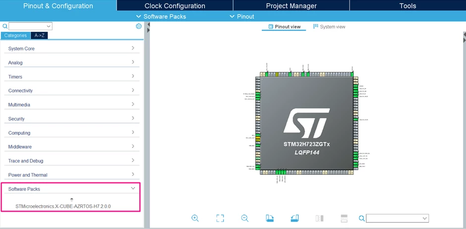

189.pngThis will add the Software Pack in the lower part of the Categories:
Now, by clicking on it, you can add the RTOS ThreadX box, this will show the configuration options for the AzureRTOS application

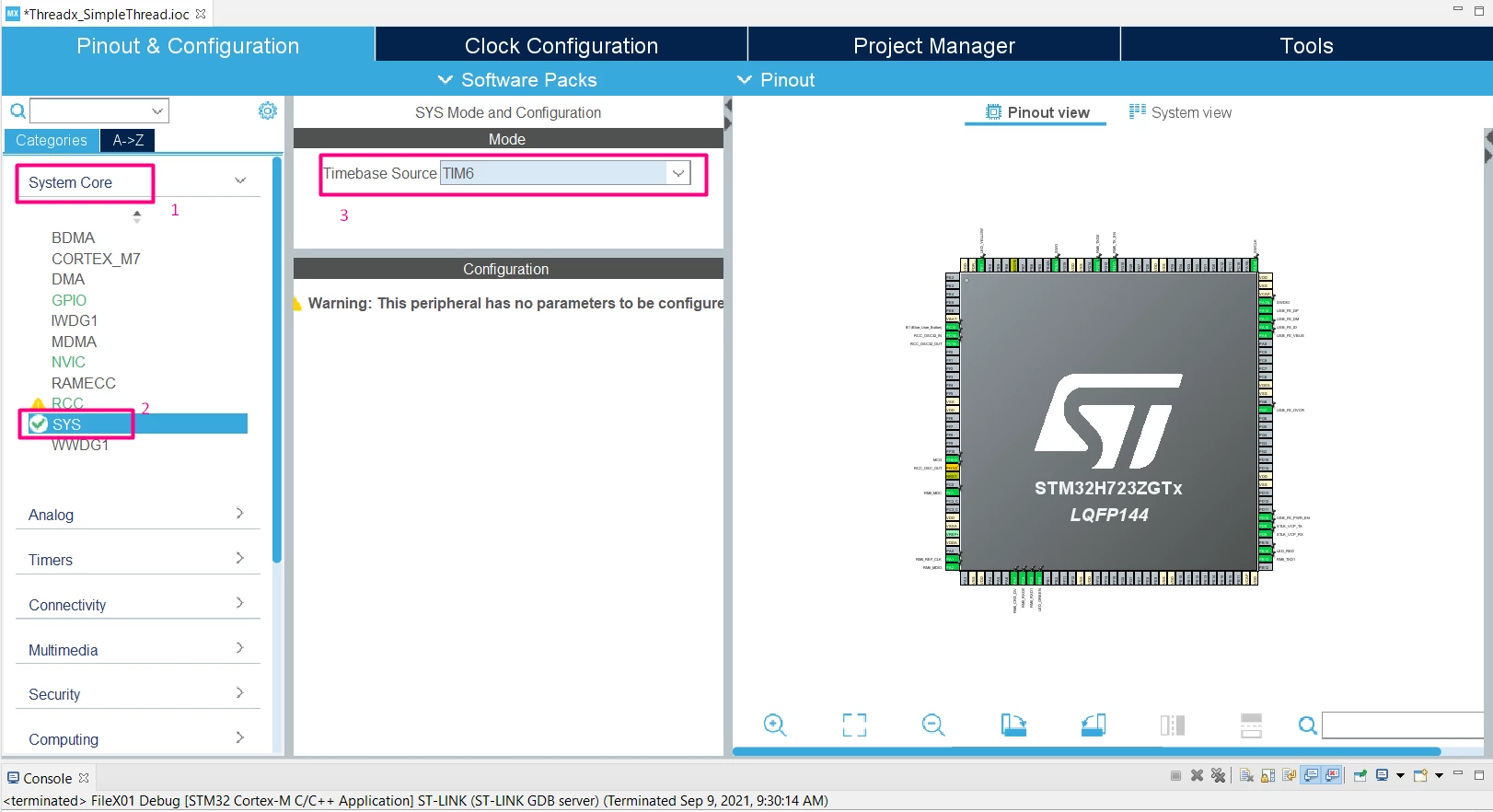

As this demo is just meant to create small printfs to indicate which thread it is and use the message queue, the default settings are alright, but we do need to do one other modification. By default, the HAL driver will use the Systick as its primary time base, but this timer should be left to the AzureRTOS only.
If the HAL library doesn’t have a separate time source, the compilation will fail because both libraries want to use the SysTick_Handler interrupt. To prevent this, we can simply select a different time base for the HAL by clicking in the System Core/SYS and selecting the time base Source as TIM6:

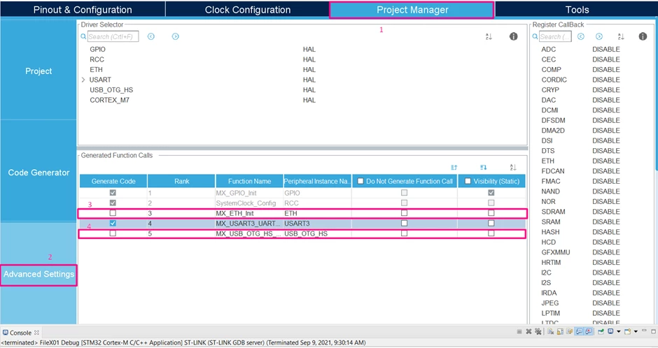

One final modification, to prevent generating too much unused code, we can decide to not create the functions for USB and Ethernet, as they were natively added when we created the design based on the board, this can be done by removing the Generate Code for them:

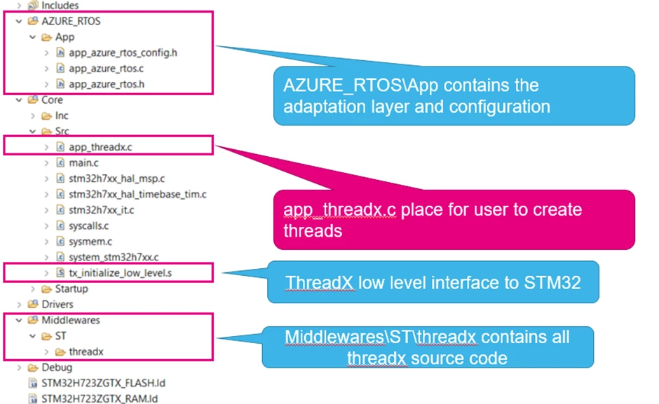

The project now has a new set of folders, this is the detail of its structure:

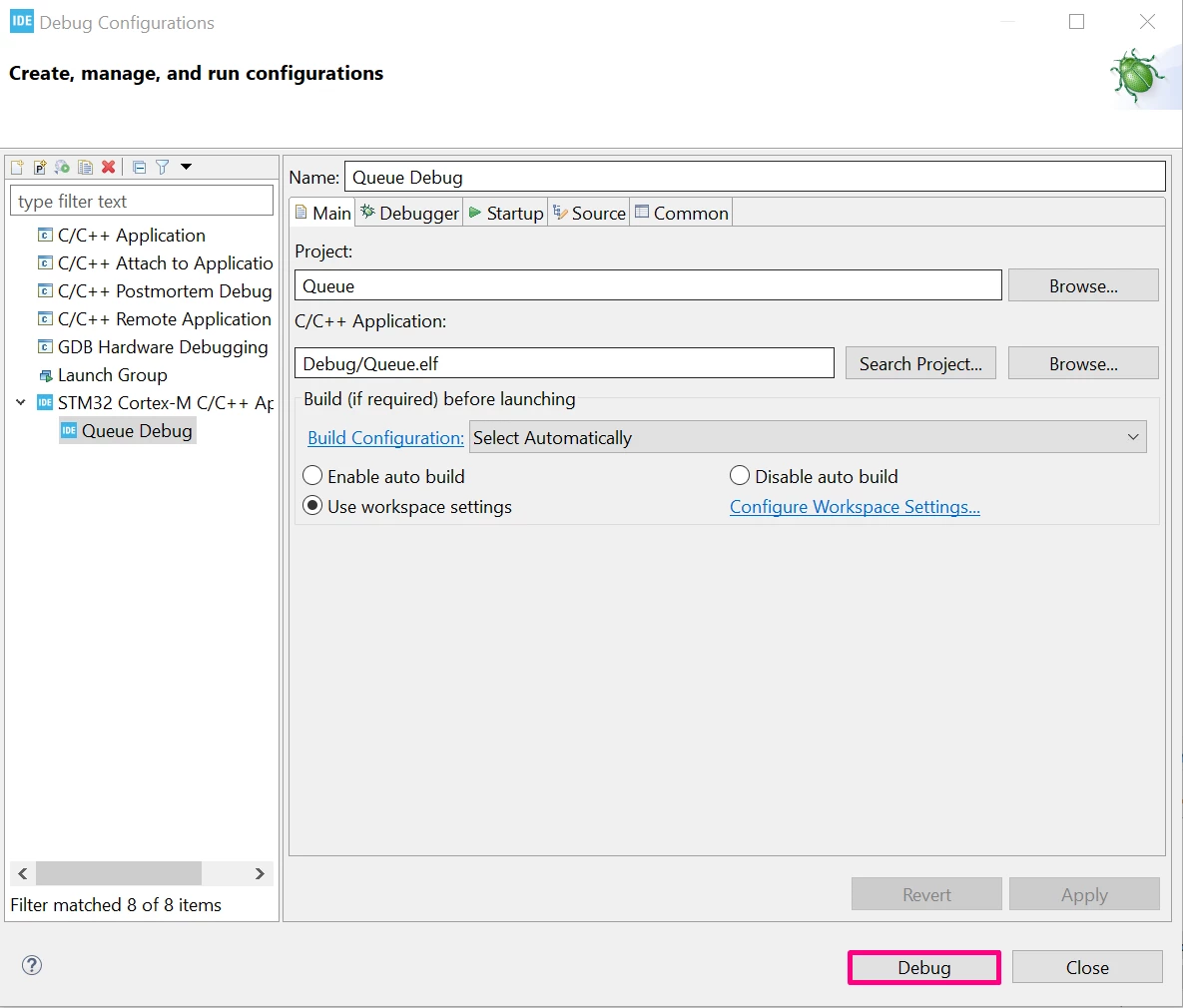

Connect the board to the computer and enter in debug mode by first clicking in the project name, then menu Run/Debug As/STM32. In Edit Configuration window, click Debug:

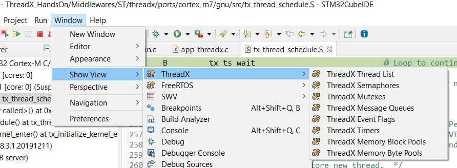

Once in the Debug perspective, click in the resume button to enjoy your ThreadX application with mutex working. You can also use the Window/Show View/ThreadX/ThreadX Thread List and do it again for the ThreadX Queue to enhance the overall debugging options (the thread list will be automatically loaded once the application runs for a bit and is paused):

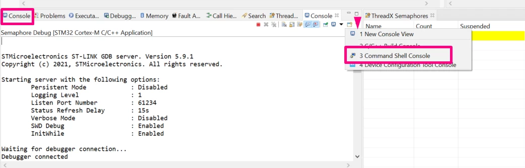

Now, the last step is to enable the console inside the STM32CubeIDE to see the print messages. Locate the Console tab and click Command Shell Console:

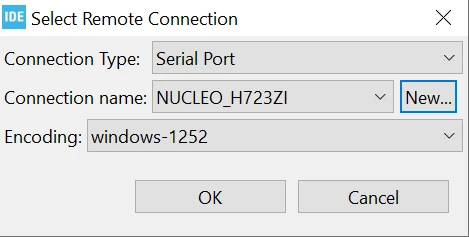

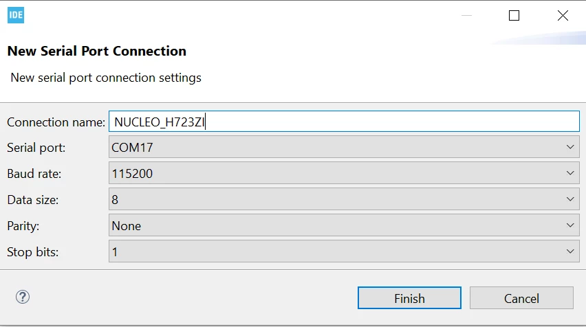

In the pop-up window, change the Connection Type to Serial Port and click on New… to add the VCOM related to your STLINK:
You can give the port a name, so it is easier for later usage as well, in this case, it will be labelled as NUCLEO_H723ZI:
By clicking finish, the message on the console will indicate it is now connected.

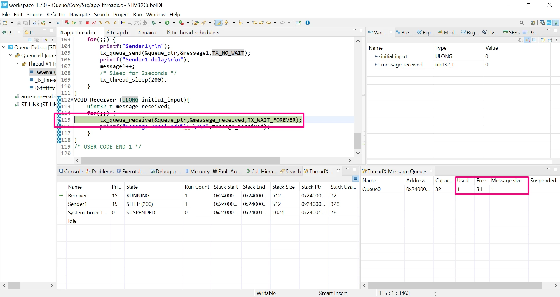

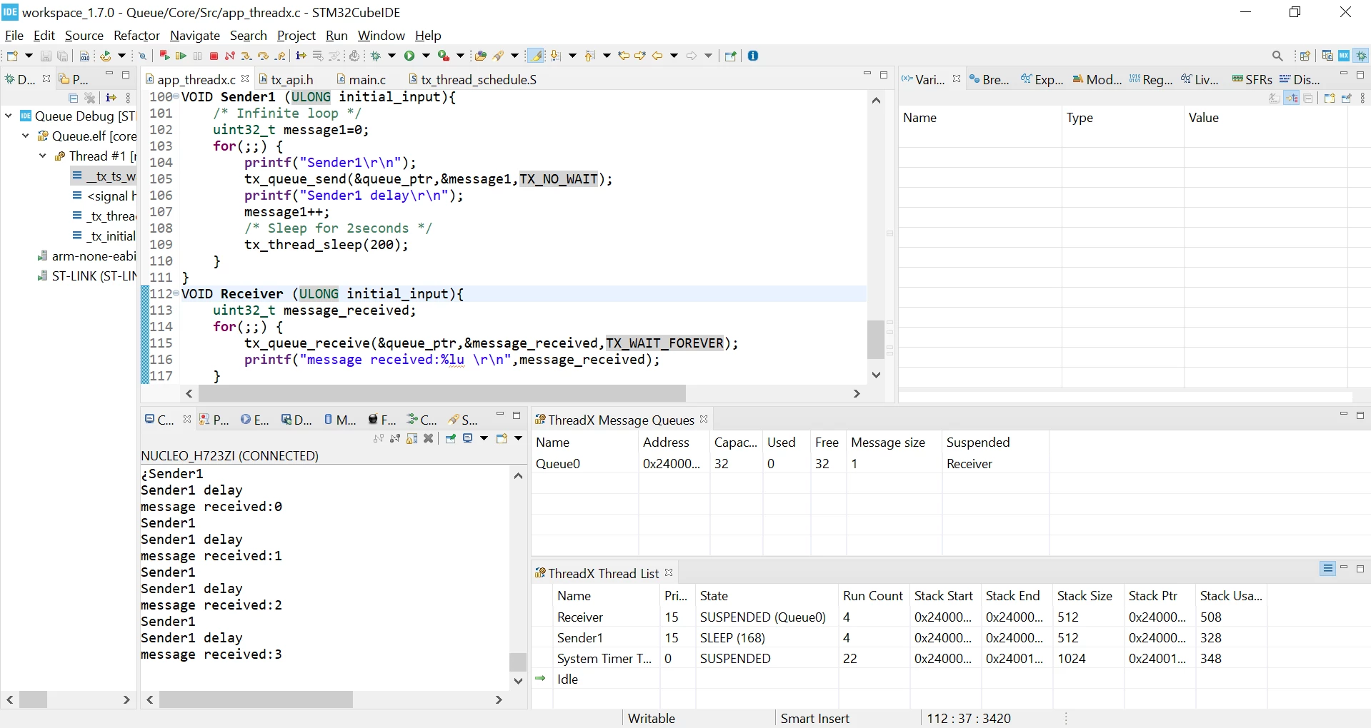

Here is the debug view when adding a breakpoint in the Receiver Thread with the views for threads and queues enabled. It is possible to see the size of the queue as 32, and this is because upon the queue creation it was set to have a single word (32bit long or 4 byte long) with a stack size of 128 bytes, so 128/4 = 32. You can also check that the Message Queue tab is showing that currently, the queue has 1 message there, thus the Free size is 31:
By removing the breakpoint, adding the console view and hitting F8, we can see the code running with the messages being displayed:
