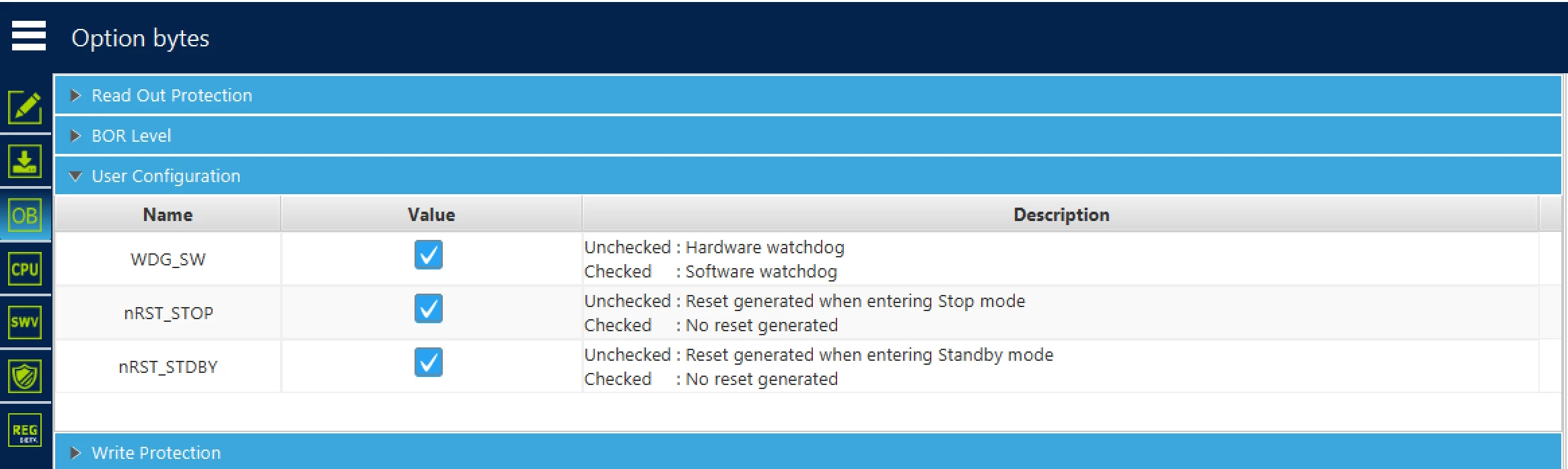

Apr 23, 2024 8:37 AM UTC
Hey @Stefanie LAU,
I have an STM32F405RGT6 and also noticed I dont have the tab in Step 3 (Boot address and Option bytes).

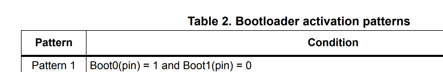

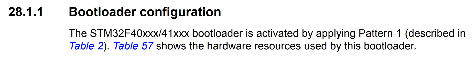

I looked at AN2606 section 28 (STM32F40xxx/41xxx devices) and verified that I need Pattern 1:
Which gives me Boot0(pin) = 1 and Boot1(pin) = 0:
When you replied to @MStev.4  about needing to verify the value of nBoot1 in the user option bytes, where is this done? As seen in the image below I have the following settings in the Option bytes:
Thank you.
