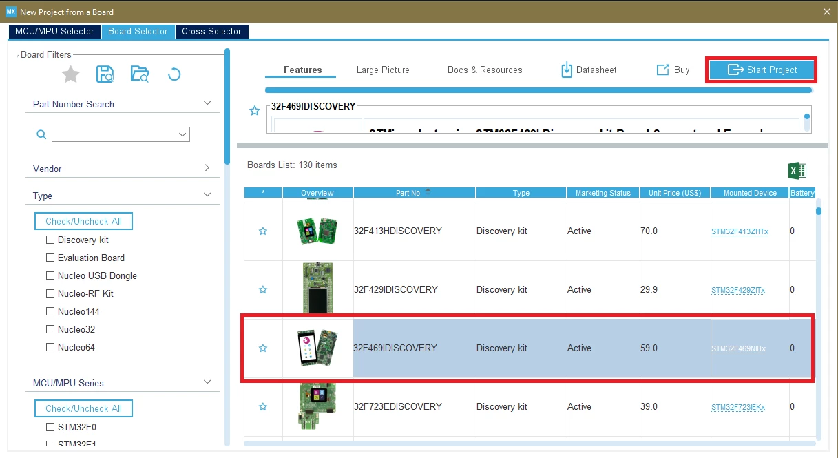

1.1. Launch CubeMX and select the STM32F469-Discovery from the Board Selector list, then click on "Start Project"
Note : For CubeIDE, follow the same steps but launching the CubeMX from CubeIDE instead, interface is identical.
1.2. Agree to initialize peripherals to their default settings clicking "Yes" in the dialog box

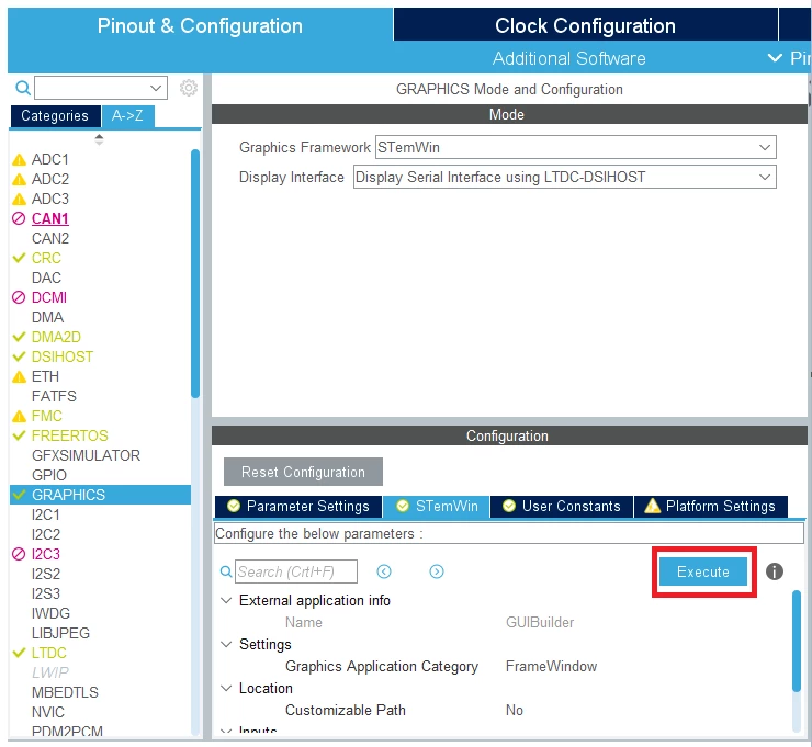

GRAPHICS - Mode - Graphics Framework : select "STemWin"
GRAPHICS - Mode - Display Interface : select "Display Serial Interface using LTDC-DSIHOST"
GRAPHICS - Configuration - Parameter Settings: set "User GUIBuilder Tool" to "Enable"
GRAPHICS - Configuration - Parameter Settings: set Physical Display Size - X Size to "800"
GRAPHICS - Configuration - Platform Settings: select PH7 as LCD Reset Pin
1.6. Select your IDE from the list in the Project Manager -> Project section
1.7. Generate the code once

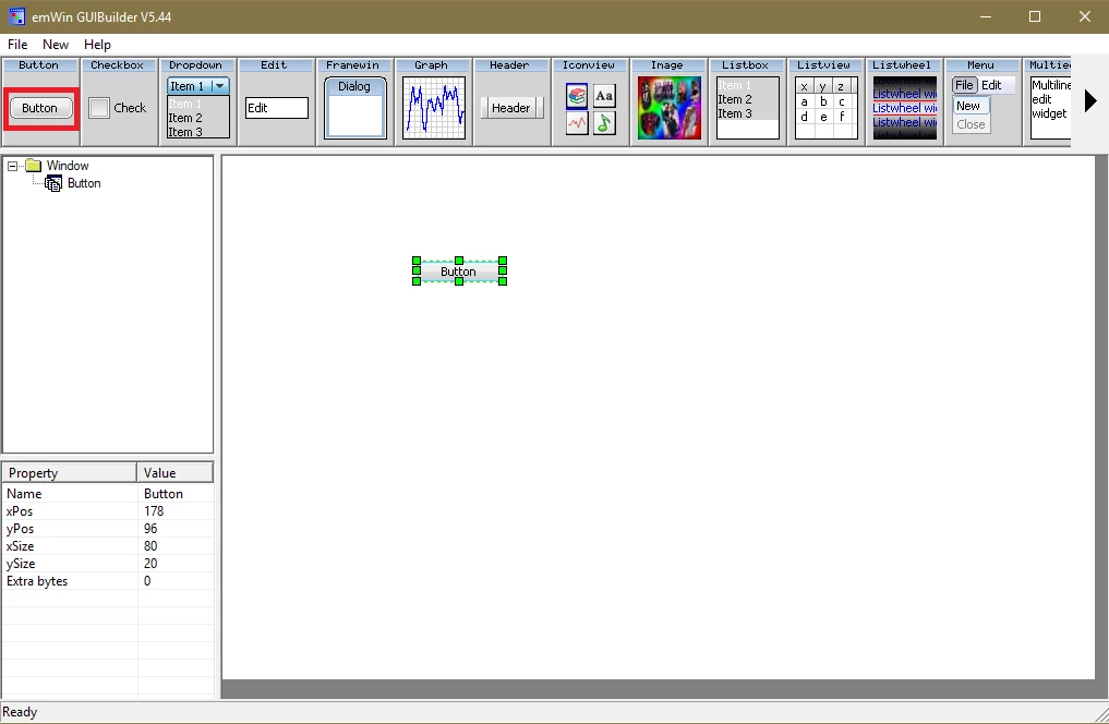

1.8. Go back to pinout & Configuration then in the GRAPHICS peripheral
In the Configuration launch GUIBuilder by clicking Execute
1.9. In GUIBuilder let's just add a buttton
1.10. Select "File->Save", agree to overwrite existing file
1.11. Close GUIBuilder and generate the code again

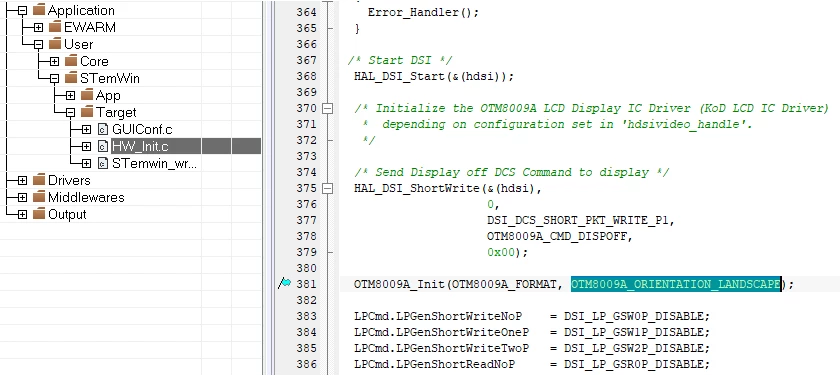

HW_Init.c needs to be updated manually, depending on the chosen IDE this file is either in a target folder or in the src one.
Update needed:
Replace OTM8009A_ORIENTATION_PORTRAIT by OTM8009A_ORIENTATION_LANDSCAPE in OTM8009A_Init call :

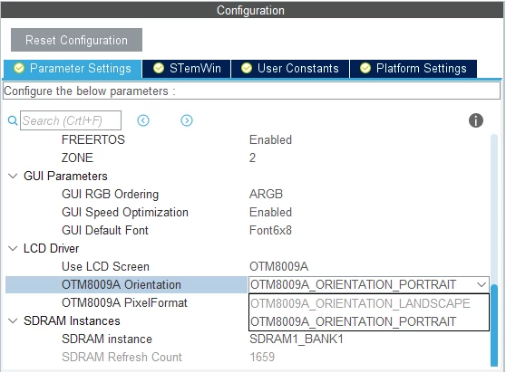

Explanation
The DSI display present on this discovery board has a specificity that forces to split its refresh into 2 steps to avoid flickering.
So as far as LTDC and DSI are concerned the width of the display is set to 400 instead of 800.
Unfortunately the parameter specifying the display orientation that will be transferred to the display low-level driver is based on the ratio between width and height extracted from LTDC configuration.
In this case width is smaller than height so PORTRAIT mode is selected and LANDSCAPE is greyed-out :
that is why the modification must be done directly in the source code and must be done again each time the code is re-generated from the CubeMX.
