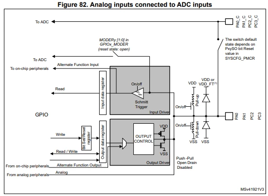

What is the state after reset of STM32H7 analog switches between Pxy_C and Pxy pins/balls?
The
Reference Manual RM0399 Rev 3 (page 584) gives a figure as the one below, but not all Pxy_C and Pxy are accessible depending on the STM32H7 package.
The default state of the analog switches can be deduced from the STM32H7 package and can be read with a debugger.

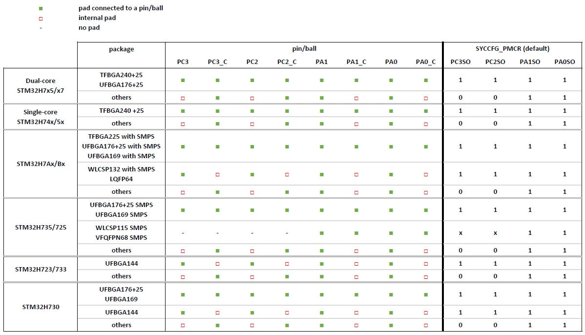

1. Rules
  1. GPIOs are in analog mode during and just after reset (except the debug pins in alternate function mode after reset).
  2. But the digital alternate functions are accessible after reset whatever the package.
2. Default state
According to these rules, the default state of the switches depends on the package:
  1. If both Pxy and Pxy_C are available, the corresponding switch that connects the two internal pads is open by default.
    • The alternate functions are accessible through Pxy pin/ball while the ADC input is available through Pxy_C pin/ball.
  2. If only Pxy is available, the switch is open by default.
    • The alternate functions are accessible through Pxy pin/ball. To use the ADC connected to the internal pad Pxy_C, the switch shall be closed. In this case, the other functions of the Pxy pin/ball are no more accessible.
  3. If only Pxy_C is available, the switch is closed by default.
    • The alternate functions are accessible through Pxy_C pin/ball. To use the ADC connected to the internal pad Pxy_C, the switch shall be opened.
3. SYSCFG peripheral mode configuration register (SYSCFG_PMCR)
The switch state can be read/modified in SYSCFG_PMCR.PxySO (Pxy Switch Open):
0: Analog switch closed (pads are connected through the analog switch)
1: Analog switch open (2 separated pads)
At this point, the datasheet is needed to know which pins are available on the STM32H7 package (pinout/ballout figure and pin/ball definition table).
The value of this SYSCFG_PMCR register can also be read in a debugger (after having enabled the clock by __HAL_RCC_SYSCFG_CLK_ENABLE()).
4. Examples
