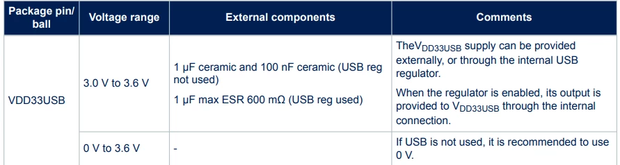

1. VDD33USB pin configuration
According to STM32H7 datasheets, when USB is not used, the VDD33USB pin should be handled as follows:
- USB PHY deactivated and related USB GPIOs (DP and DM not used)
- Connect the VDD33USB pin to VDD. This will not impact your power consumption.
- Ensure that the VDD33USB supply level detector is disabled in the firmware to avoid any unintended behavior.

Note:
For STM32H7RS, when USB is not used, we don't have a particular constraint. Users can connect VDD33USB to 0 V to minimize any possible leakage.
