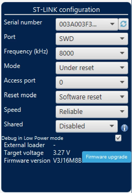

Hi, I'm using NUCLEO-WB05KZ, read the user manual, I'm following the instructions in paragraph 7.12
But I can't cause the target to return to the boot section.
What shall be the exact jumper configuration on the MB1801 Board, and in the MB2032B target
(note that JP1 in MB2032 is assembled).
What shall be the exact STlink configuration on the programmer?
And what shall be the procedure to return to the Bootloader?
