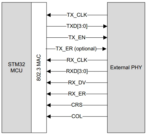

3. MII signals
RM0481 figure 822 page 2768RM0481 figure 822 page 2768
  • Transmit (Tx):
    • TXD[3:0] (transmit data): A bundle of four data signals driven synchronously by the MAC sublayer and qualified (valid data) on the assertion of the TX_EN signal.
    • TX_EN (transmission enable): Indicates that the MAC is presenting nibbles on the MII for transmission.
  • Receive (Rx):
    • RXD[3:0] (receive data): RXD is a bundle of four data signals driven synchronously by the PHY and qualified (valid data) on the assertion of the RX_DV signal.
    • RX_DV (receive data valid): Indicates that the PHY is presenting recovered and decoded nibbles on the MII for reception.
    • RX_ER (receive error): indicates to the MAC sublayer that an error was detected somewhere in the frame.
  • Clocks:
    • TX_CLK: A continuous clock that provides the timing reference for Tx data transfers.
    • RX_CLK: A continuous clock that provides the timing reference for Rx data transfers.
  • Control:
    • CRS (carrier sense): This signal is asserted by the PHY when either the transmit or receive medium is non-idle.
    • COL (collision detection signal): This signal must be asserted by the PHY upon detection of a collision on the medium and must remain asserted while the collision condition persists.
