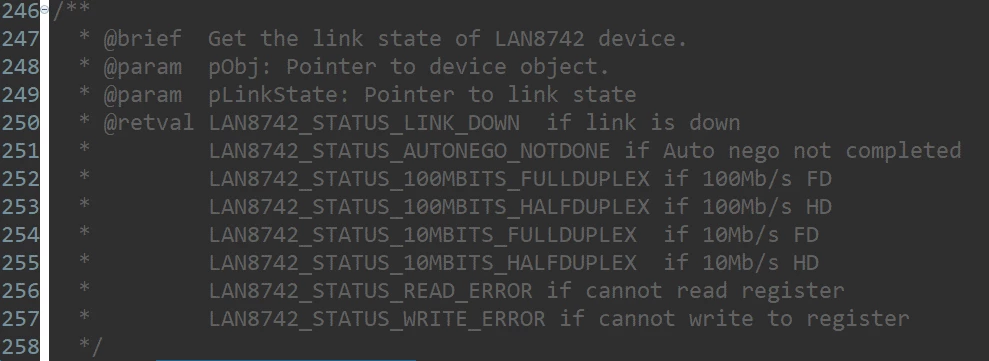

1.1. How to ensure that PHY is working correctly
In the PHY library (lan8742.h), the LAN8742_GetLinkState function is utilized to check the state of the PHY device specified in the parameters. As illustrated below, this function returns status codes that indicate the link status. It informs us if the link is up or down, the result of the autonegotiation process, and the selected speed and duplex settings. Additionally, it could signal if an error occurred during the read/write process to or from the registers.
When we are not getting the proper response from PHY, we can focus on the following potential causes
  1. The crystal oscillator providing the source of a clock, which is propagated to the Ethernet peripheral is present and within the PHY specifications
  2. Depending on the mode we are trying to configure (MII, RMII) we need to make sure that we are using the correct pins as the pins generated by an MX project could not be in line with the hardware mapping done with the board
  3. Refer to the schematics provided by ST Nucleo, evaluation, or discovery boards as a reference design
  4. Refer to the documentation of the PHY that you are using to see if there is any requirements or limitations related to hardware mapping, spacing, and pullup resistors.
  5. Special care should be taken with the reset circuit as it can cause the PHY to desynchronize after reset.
If the hardware implementation is done correctly, we should at least be able to see the Ref_clk throw a scope and get a response after the PHY init sequence.

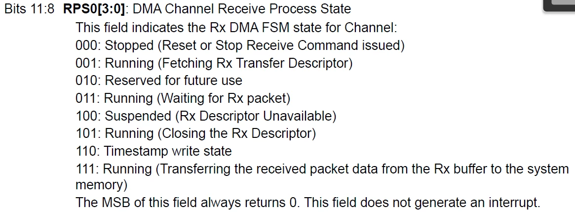

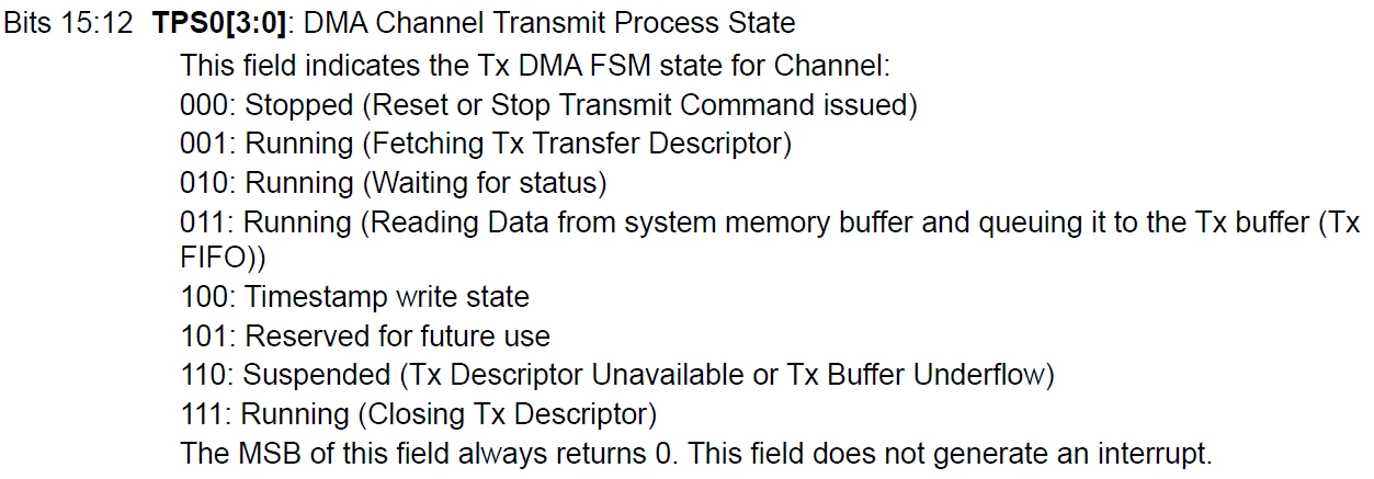

2.2 Debug status register (ETH_DMADSR)
This register provides us with the state of the Finite State Machine (FSM) for both DMA channels, transmit (Tx) and receive (Rx). It allows us to determine whether the Ethernet is functioning correctly. If there are issues, the register can help pinpoint the exact stage where the process is experiencing a hang-up.

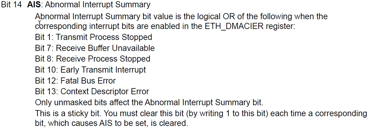

2.3. Channel status register (ETH_DMACSR)
During each interrupt routine, the application reads the status register to determine the current status of the DMA. This status can be found in the ETH_DMACSR register, which provides information on whether the transmit or receive process has been completed or if it has been halted due to an error. The types of errors that can be detected include unavailable receive or transmit buffers (RBU/TBU), context descriptor errors (CDE), or even fatal bus errors.
2.4. How to trace received packets in each layer
Before starting the tracing process, we need to make sure that the Ethernet has been initialized successfully by reading the value of the debug register (ETH_DMADSR). It should contain the value 3 (011) which indicates that the receive process is running correctly. Next, we can start checking the following registers:
