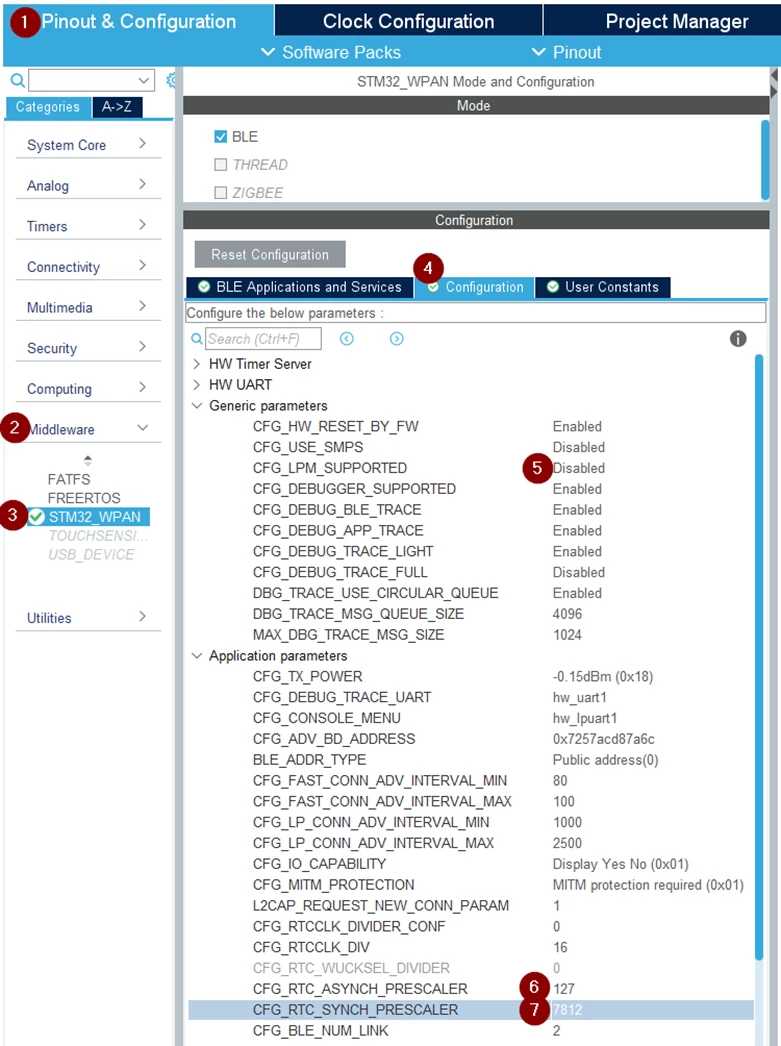

  1. Open its BLE_p2pServer.ioc with CubeMX v6.3.0+.

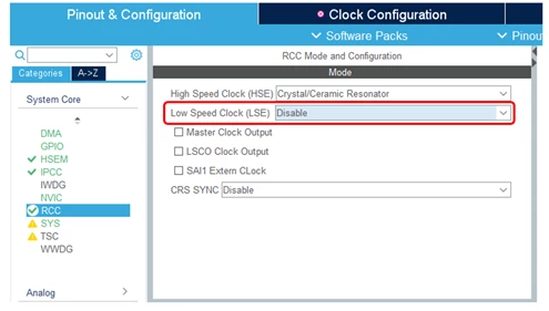

  2. From the “RCC” configuration window, change the LSE mode to “Disable”

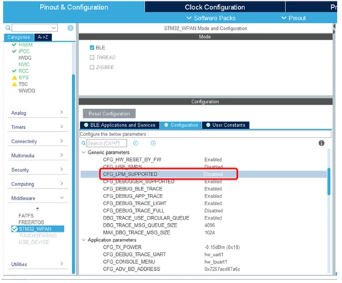

  1. From the “STM32_WPAN” middleware configuration window, go to the “Configuration” tab
    1. Change the CFG_LPM_SUPPORTED parameter to “Disable”. This disables the low power manager support to keep the system always in Run mode.
    1. Change the CFG_BLE_LSE_SOURCE parameter to “Enable” to select the extern HSE as the source of the RF wake-up.

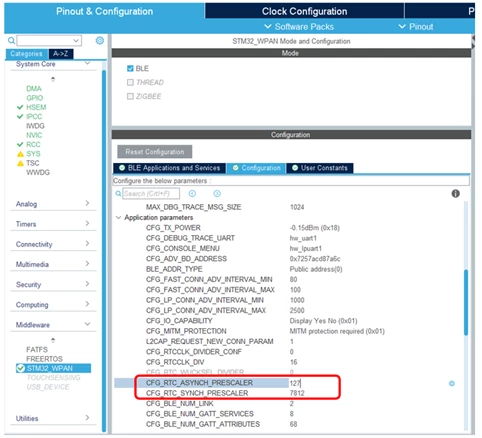

    1. Change the CFG_RTC_ASYNCH_PRESCALER parameter to 127 and CFG_RTC_SYNCH_PRESCALER to 7812 to obtain an internal clock frequency of 1 Hz (ck_spre). This will also keep the same real time base for the Virtual Timer utility (from hw_timerserver.c).

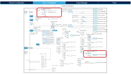

  1. Change the clock tree configuration
    1. Select “HSE_RTC” for the RTC Source Mux
    2. Select “HSE” for the RF system wakeup

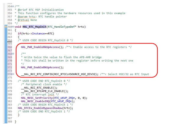

  1. Find stm32wbxx_hal_msp.c and add the following lines of code inside HAL_RTC_MspInit().

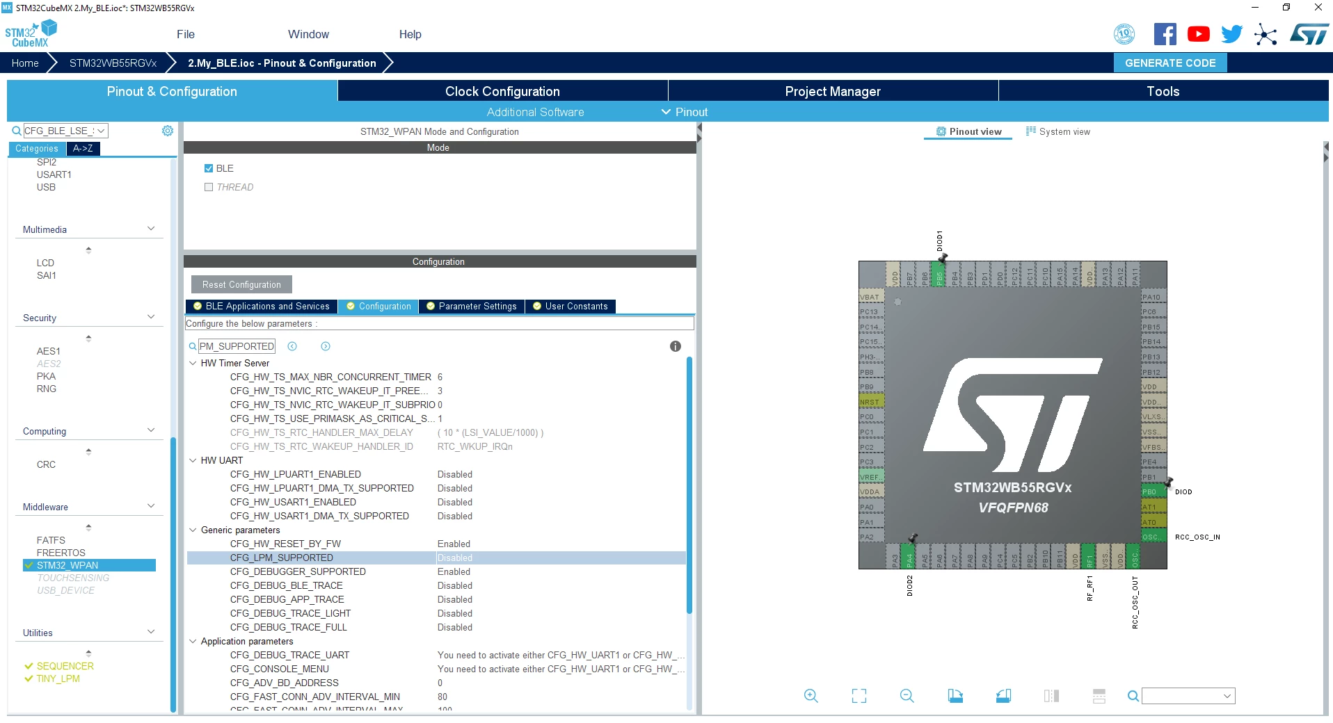

Hi, thank you so much for your answer.

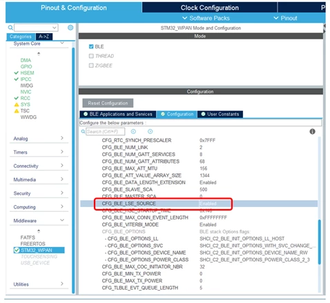

Can you a little clarity about - CFG_BLE_LSE_SOURCE  and CFG_RTC_ASYNCH_PRESCALER
I don't have this setting in my CubeMX, please see the attached image. Do you know how I can fix it
_legacyfs_online_stmicro_images_0693W00000UnrDBQAZ.png?
gongw
October 12, 2022
First please use the latest CubeMX v6.6.1 and CubeWBv1.14.1.
Please go down to the middle position of Application parameters by scrolling the lightblue scrollbar
_legacyfs_online_stmicro_images_0693W00000UnsqYQAR.png​Br,

October 15, 2022
Hi Laura, thank you for your response, I did your recommendation, but still in my CubeMX don't have settings for CFG_BLE_LSE_SOURCE
if I correctly understand I can use the command in the code to fix it, how do you think?

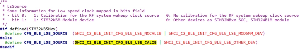

#define CFG_BLE_LSE_SOURCE 1
and CubeWBv1.14.1 is it only examples of code, not more, yes?
gongw
October 16, 2022
For settings for CFG_BLE_LSE_SOURCE, you need to modify CFG_BLE_LSE_SOURCE as below after generated code.
Br,

I'm trying this now with STM32CubeIDE 1.19.0, and there have been some changes since the original post was written.
As @IRakh.1  has found, the .ioc settings for BLE no longer include CFG_BLE_LSE_SOURCE.  However, this is no longer necessary because apparently now the auto-generation code looks at your clock configuration and autogenerates the change in app_conf.h to add SHCI_C2_BLE_INIT_CFG_BLE_LS_CLK_HSE_1024 in place of SHCI_C2_BLE_INIT_CFG_BLE_LS_CLK_LSE in the CFG_BLE_LS_SOURCE.
Once I did steps 1, 2, 3a, 3c, 4, and 5, I was up and running without the RTC crystal.   Then I noticed I still needed to do steps 6 and 7.    I did those steps also, and everything still worked.  Bottom line, don't worry about step 3b and the change that @gongw mentioned in 2022 is now taken care of automatically.
