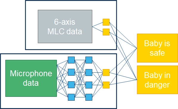

While the other devices only focus on detecting the presence of the baby, it can be useful to have information to the environment status in which the baby is. Knowing if the baby is in danger is almost as important as knowing if the baby is inside the car. To classify the level of danger for a baby inside a car 2 parameters could be kept into consideration: the presence of an adult and the temperature of the environment.
  • For the main task of the baby detector, it was decided to use a MP23ABS1 analog microphone to check if a baby is present. Thinking that a baby in danger would cry out loud, an Artificial Intelligence (AI)-powered baby crying detection system was developed using Deep Neural Network (DNN), running on and STM32 microcontroller.
  • If an adult is inside the car with the baby, the danger level is low, but to be able to sense an adult inside a car is not an easy task. This feature is performed with the Machine Learning Core of the 6-axis motion sensor LSM6DSOX: it can detect if the car is moving, so that an adult is driving the car, having the situation under control.
  • Temperature plays an important role because if the it is within an acceptable range the parent should be informed of the danger of the baby, but when the temperature rises, a small delay can become vital and if the parent does not immediately responds other recipients should be notified.
The concept of "fusion of sensors" or "sensor fusion" is based on the possibility to use a sensor strong point to make up for another sensor shortcomings. In this case the microphone can detect the presence of a crying baby but does not know if there is a dangerous situation ongoing. The context recognition provided by the 6-axis device with the help of the temperature sensor can improve the accuracy of the system. The microphone is a sensor that has a higher power consumption (up to several hundreds uA) with respect to accelerometers or pressure sensors, but it can be reduced with the help of context recognition: it is not useful to keep the microphone running while the car is moving, so the microphone should run only if the accelerometer detects that the car is still, and should be kept off while the adult is driving. All the sensors involved in this system must be managed by the STM32 microcontroller. For our application, the L4 family was chosen to show that the computational power of the algorithm developed is within a medium tier microcontroller’s reach. This also enables to have lower current consumption and less area occupied by the system itself.

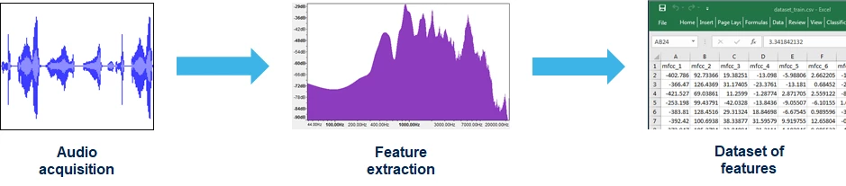

When building a Neural Network (NN), the usual starting phase is the creation or search of a suitable dataset, i.e. a collection of samples from which the NN can learn. This phase involves the acquisition and the proper labeling of homogeneous
The next step is the "features" extraction from the samples of the dataset: these are specific characteristics (mean, variance, or more sophisticated data elaborations) that can be recognized in an easier way by the algorithm.

  1. 2.1.2 Features
After a proper dataset preparation, samples could in principle give feeding to a machine learning program. It’s however a good practice to select and extract certain features from the data, to help the network to learn. The features are measurable characteristic of the phenomenon being observed, for example the Fast Fourier Transform (FFT) of an audio signal (for audio recognition), the brightness of an image (for day/night image classification), or again the standard deviation of a motion signal (for activity recognition). In more detail, when working with audio classification NN, the state of the art is using the MFCCgram of an audio signal. The MFCC (Mel Frequency Cepstral Coefficients) are a mathematical transformation of the FFT of the signal -obtained after a "mel filter", used to enhance frequencies audible by the human ear-, while the MFCCgram is a visual representation of the changes in time of the MFCC plot, like the spectrogram is for the FFT.
Considering that the NN has to run on a microcontroller and not on a server mainframe, we tried to use methods that should have lowered the computational work performed by the CPU. The idea was to utilize only the MFCC of one second of audio, because the cry of a baby is not something that comes and go in a matter of milliseconds, in conjunction with some other features. In the first tries a lot of different features were chosen (MFCC, mel spectrum, chroma, contrast, tonnetz, mean energy, centroid and roll off frequency), but going on with tests we realized that incrementing the MFCC and mel spectrum accuracy (using a higher frequency resolution) and getting rid of other features worked better. In the end a set of 158 features, composed by 128 mel spectrum samples and 30 MFCC samples gave the best results for this application, proving that sometimes, the computation power is not as important as the work behind the development.

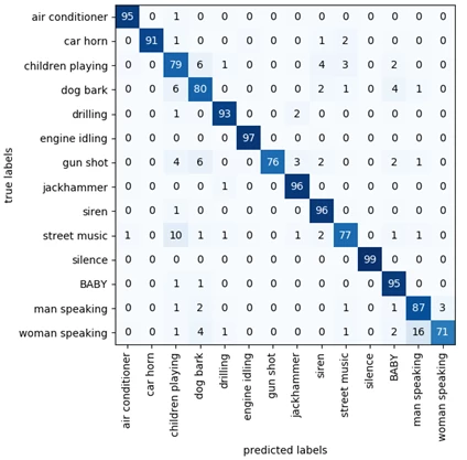

  1. 2.1.3 Training and analysis
The network development and its training were performed using Keras tool (based on Python) and they were subject to a lot of changes during the process: every time the training steps ended the results were analyzed with the help of the "confusion matrix", that is a mean to know which categories were mistaken with which categories, a measure of the "cross-talk" (false positives and negatives) among categories. In the current application case, the confusion matrix shows the number of times and the percentage a baby cry was mistaken for a dog barking or a men talking was mistaken for a baby.
As lessons learnt, this matrix led to the recognition of different errors: the above-mentioned too high amount of "not baby" data, the use of wrong parameters for the training phase, the fact that a higher number of nodes does not help certain categories, and, most important, that different features help recognizing different categories, so, for example, if using tonnetz gave an advantage in classifying the street music with higher accuracy, on the other side the higher complexity gave problem to the recognition of baby cries. A linear network was initially tested along with a neural network to compare the results and see if it managed to get a good accuracy, but it was not enough, so the focus shifted on a deep feed-forward neural network. Several tests were then performed using different structures for the network: the number of hidden layers and their neurons, along with the activation functions were changed to get the highest possible accuracy. In the end, the best trade-off between accuracy and complexity was found to be a neural network with 2 hidden layers of 100 neurons each.
The overall accuracy of the final network is now 85% over the whole dataset, and almost 90% on the baby crying category for both training and cross-validation results. This result is theoretically good, but when the network analyzes real data a whole new set of variables comes into consideration and the resulting accuracy can be slightly lower.

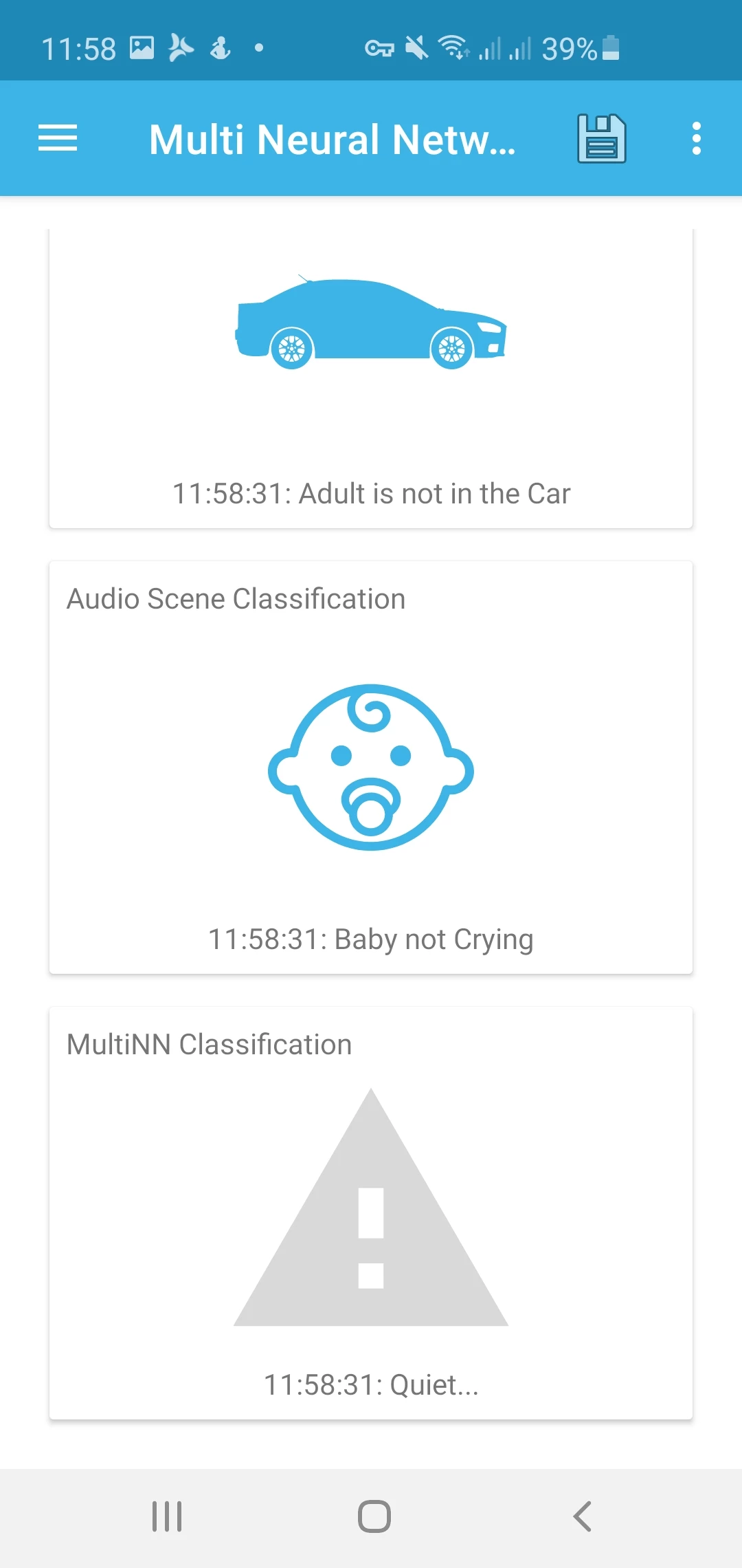

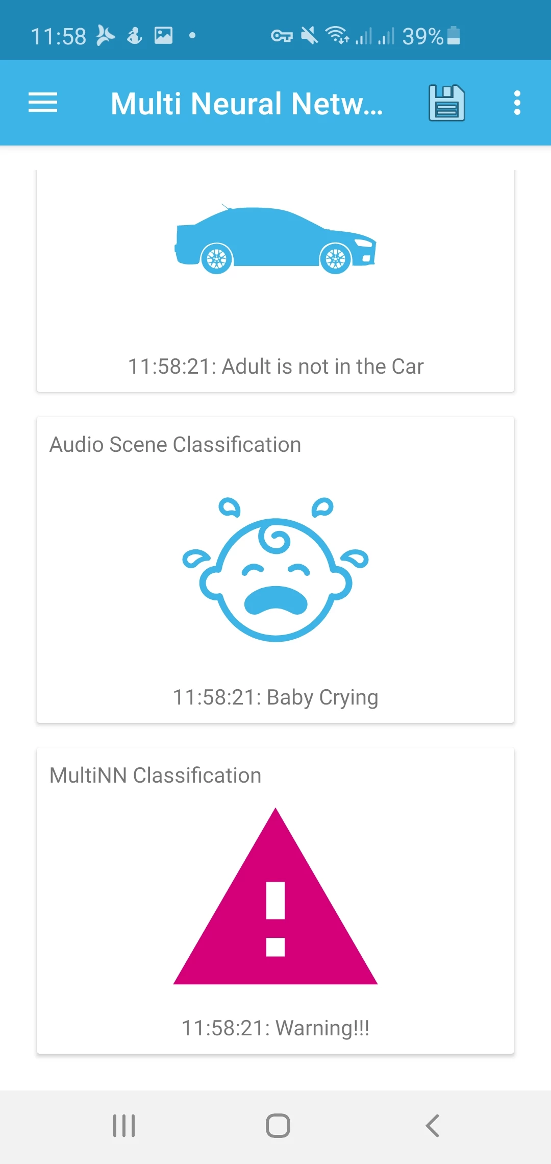

After converting the feature extraction algorithm, the application was finally ready to be tested. The chosen platform is the SensorTile.box, since it is a board already available packing together a MEMS microphone, a LSM6DSOX and a temperature sensor connected to an MCU (STM32L4R9). This demo board is also able to connect to a phone app (ST BLE Sensor ) to give a graphical feedback to the user. This allows to display both the NN and the MLC network on the same page, with a third icon that alerts the user only if both the baby is crying and the vehicle is still. The temperature threshold for which the situation is very dangerous was not decided yet, so it is not implemented, but the system is ready to import that feature too.
