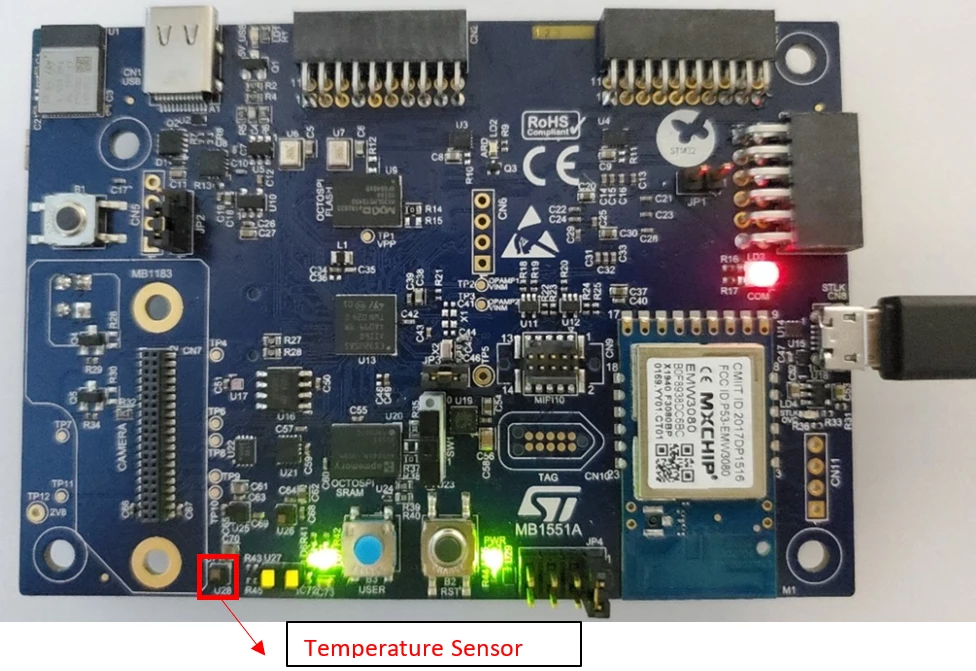

The board we use is a B-U585I-IOT20A board. It provides functionalities such as a temperature and humidity sensor (highlighted in red) as well as a low power microcontroller and other sensors such as a magnetometer, accelerometer, gyroscope, pressure, Time-of-Flight, and gesture-detection. It also provides a Wi-Fi module, which allows us to connect it to Azure IoT Central.

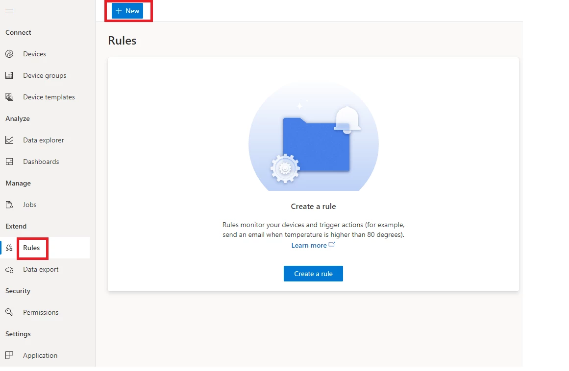

  1. In the left pane, select Rules.
  2. If you have not created any rules yet, you see the following screen:
  3. Select + New to add a new rule.

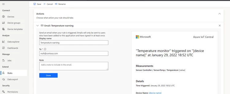

  1. Select + Email in the Actions section.
  2. Enter Temperature warning as the display name for the action, your email address in the To field.
Note: Emails are only sent to the users that have been added to the application and have logged in at least once.

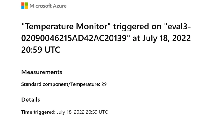

  5. After a while, you receive an email message when the rule fires:
