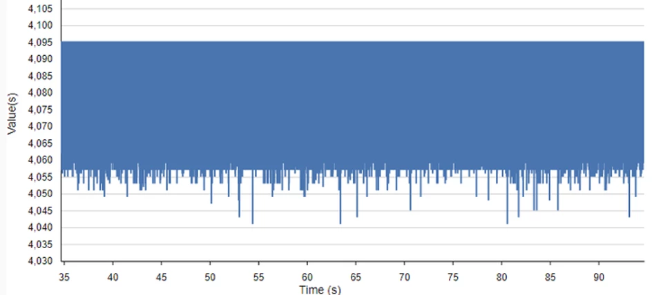

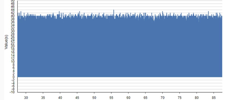

Below is an example of the noise that we observe with ADC on an STM32F7 when ADC is connected to ground and to VDD with 12b resolution respectively. This is induced by the phy clock input of the Ethernet peripheral:

  • Issue: The 50 MHz RMII clock (PA1) affects the measurement on ADC1_IN0 (PA0), causing noise levels of approximately 100 codes in 4096.
  • Observation: When the ETH_REF_CLK is removed, the noise level drops to around 10 codes in 4096, similar to other ADC channels.

  • Configuration: The board runs at 216 MHz with APB2 at 13.5 MHz. The ADC is configured with a 12-bit resolution and a sample time of 480 cycles.
  • Issue: The ADC and DMA function correctly, but the signal is very noisy, even with the input shorted to AGND or connected to AVDD.
  • Observation: Various attempts to smooth the signal, such as using a high-quality potentiometer and resistors, did not significantly reduce the noise.

  • Configuration: NUCLEO-H743ZI2 board with a 16-bit ADC. The Ethernet clock is outputting the 50 MHz clock.
  • Issue: The actual dynamic range of the ADC is low, with significant noise observed even when the ADC input is directly connected to ground.
  • Observation: The 16-bit ADC appears to provide less than 10 bits of true resolution due to the noise.

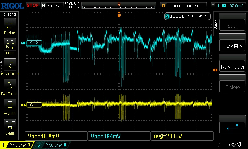

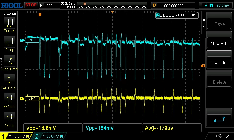

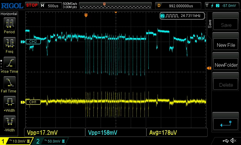

My research on nucleo-H743zi2 shows that problem is not 50 MHz clock itself, but Ethernet IC:
Pictures demonstrate spikes on Vdd = 3.3V power line.
This affects not only ADCs, but DACs as well via V-Reference.
Spikes on voltage rail are always there, I mean on my nucleo-H743 Ethernet was not configured, all jumpers associated with Ethernet were Removed as described in UM2407.
The solution is to cut power to IC: LAN8742a de-soldering L1 inductor, completely shouting down Ethernet feature .
For new design, I'd suggest install another 3.3V LDO exclusively for powering Ethernet sub-module. Basically, "split" power domains between main uCPU and Ethernet.
