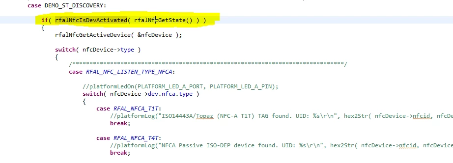

Now I'm stuck at
case DEMO_ST_DISCOVERY:
if( rfalNfcIsDevActivated( rfalNfcGetState() ) )
I'm getting RFAL_NFC_STATE_POLL_TECHDETECT:

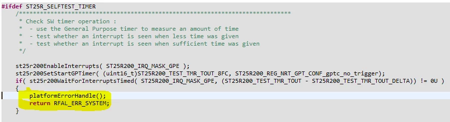

could you enable ST25R_SELFTEST and ST25R_SELFTEST_TIMER compilation flags?

I Enabled Self Test, going to error platformErrorHandle();
RFAL_ERR_SYSTEM 8

I commented the ST25R_SELFTEST_TIMER and proceeded, now I could able to detect the card and read the UID.

commenting the ST25R_SELFTEST_TIMER may cover issues which you encounter in future. From a first glimpse your timer is slower than expected - might be acceptable, depending no how much it is off.

Could you reenable the ST25R_SELFTEST_TIMER: do you still face the issue? If yes, could you connect a logic analyzer on SPI (CLK, MISO, MOSI, CS), ST25_RESET pin and ST25_INT pin and provide a log from power on up to the issue?

I reenable the ST25R_SELFTEST_TIMER, same issue I'm facing. i will try to get the logs from logic analyzer. but
But if i disable  and run discovery i could able to do read write to my nfc tag 216. problem is if u use same code in different my colleague board, card discovery not happening.so i thought of asking
