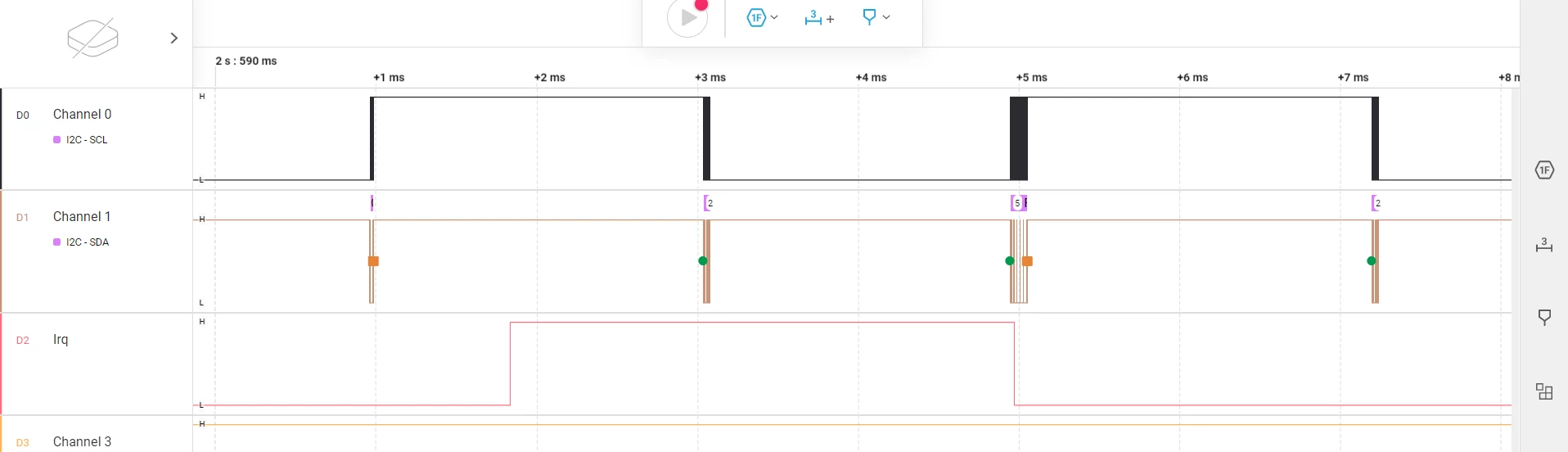

I am using X-NUCLEO-NFC08A1(ST25R3916B) with Dialog DA14706 MCU , ported the X-CUBE-NFC6 library and first tested for SPI , and it has worked fine(getting Tag UID) . Then i have done some modifications in hardware (Pull-up resistors 1.6K , Made i2c_en high, solder bridges) as well as in Software (defined the macro RFAL_USE_I2C). Still can't get tag UID.

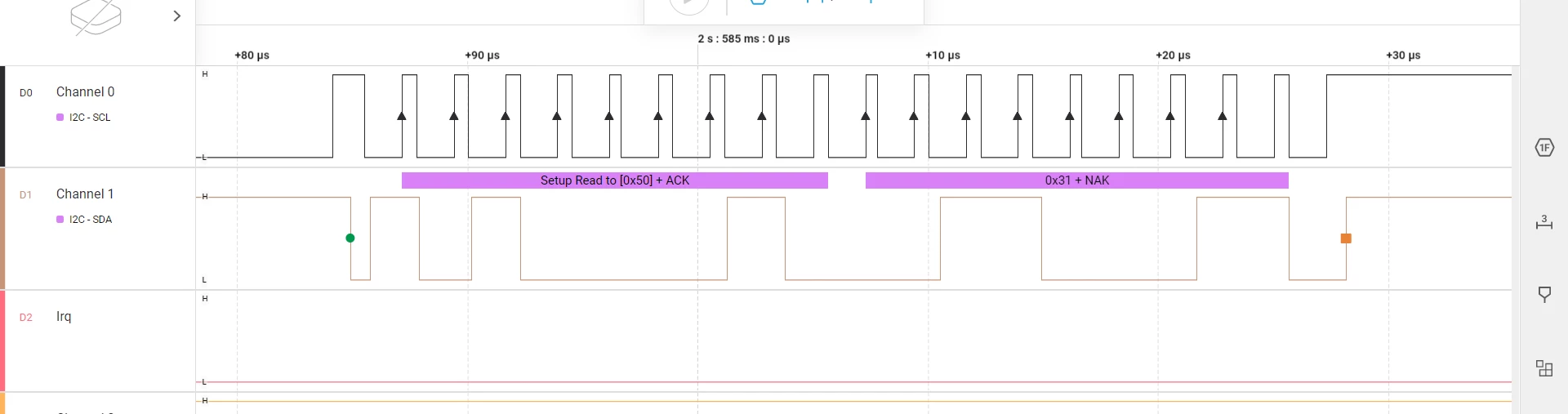

By the way ,both Timer tests , antenna RF field (13.56MHz) and chip id (0x31) , all are checked, found correct.
Thanks for your help

Hi BS,
as feared before: With such slow I2C more issues will be ahead:
You are seeing here:
  1. C6 command: Send NFC-A REQA
  2. 5A - 38 ..., the 38 denoting that data has been received (I_rxs, I_rxe, I_txe)
  3. 16 - 87 : Clearing of interrupts, software does that if no interrupts have been received within I think 1ms
So the actual data is disregarded by software due to slow IRQ handling. Above I find almost  2ms between sending the 5A byes until starting to receive.
I think you need have few fronts to work: Assure that interrupts are handled before the timers expire. And overall I recommend to remove those delays in the I2C.
Also I consider it likely that you can remove some technologies if you only want to read normal cards: AP2P and maybe also ST25TB.
BR, Ulysses

can you enable the ST25R_SELFTEST compilation switch and make sure st25r3916Initialize() function returns no error?
Can you connect a logic analyzer on I2C (SCL, SDA) and IRQ_3916 and send the trace (raw file)?

I enabled the ST25R_SELFTEST & ST25R_SELFTEST_TIMER and debug the code , st25r3916Initialize() returns RFAL_ERR_NONE.
I captured the Logic analyzer data , i have attached the file, PFA.

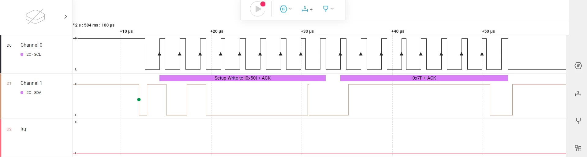

thanks, Saleae trace is welcome. In a future step it would also be useful if you share not only the initialization but also the complete failed attempts to read a UID.
In any case I analyzed based on your Excel and I found an unexpected behavior as repeated Start is performed where it shouldn't:
Please fix these repated starts and maybe it starts working. What I am seeing as well that your I2C driver has huge delays - this will for sure also lead to one problem or the other.
BR, Ulysses

Solved the issue of repeated start in i2c, but UID not found.
I captured the data by logic analyzer with failed attempts also. In the example code i have disabled the PLATFORM_USER_BUTTON_PIN, so this LA data is for the continuous execution of MX_X_CUBE_NFC6_Process function, and the tag is placed on the NFC antenna.

Problem resolved, Thank you so much, I am deeply indebted to you for your invaluable assistance. Actually, i am using RTOS, so i had created a distinct task to read registers post interrupt. And my mistake was, this task priority is set same as normal running task.
The reason I overlooked the priority parameter is because I obtained the UID from SPI using the same code and timer tests were also passed.
After all the issue has been resolved.
