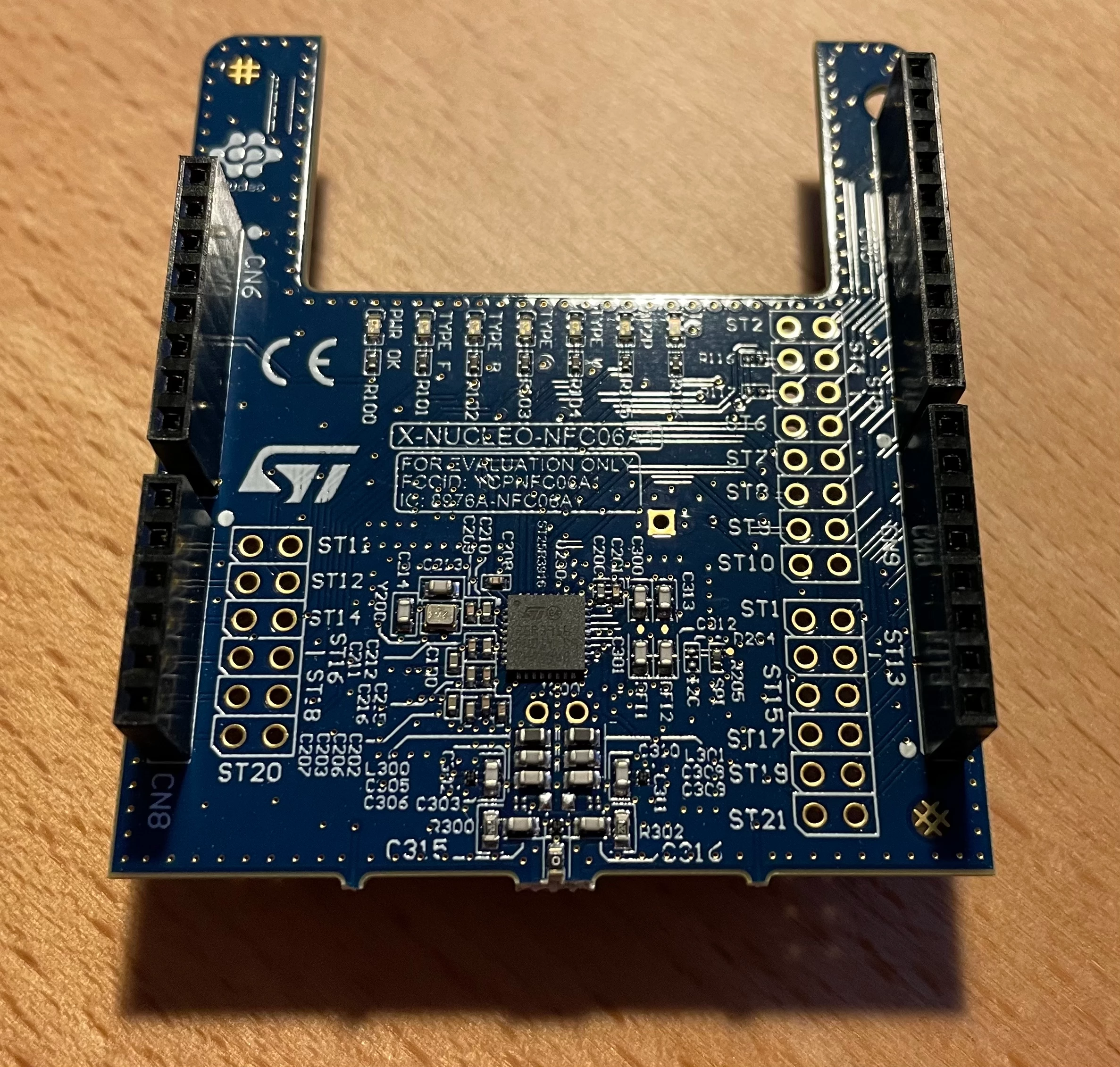

    JGreve
    November 23, 2022
    When you break off the antenna, the three pads stay on the antenna rendering the NFC06A1 board useless. Unless there is another way to attach an antenna?
    @Rene Lenerve​ can you tell me where in the documentation that you have linked, you find the information you need to match and connect an external antenna? Unfortunately, I can't seem to find it anywhere.
    Br. Jørgen

    Rene Lenerve
    November 29, 2022
    Hi @Jørgen Greve​,
    If you look at the schematics https://www.st.com/resource/en/user_manual/um2615-getting-started-with-the-nfc-card-reader-expansion-board-based-on-st25r3916-for-stm32-and-stm8-nucleos-stmicroelectronics.pdf, you can have access to the two lines of the antenna with R300 (ANT2) and R302 (ANT1). The third one is connected to the ground with R304.
    Kind Regards.

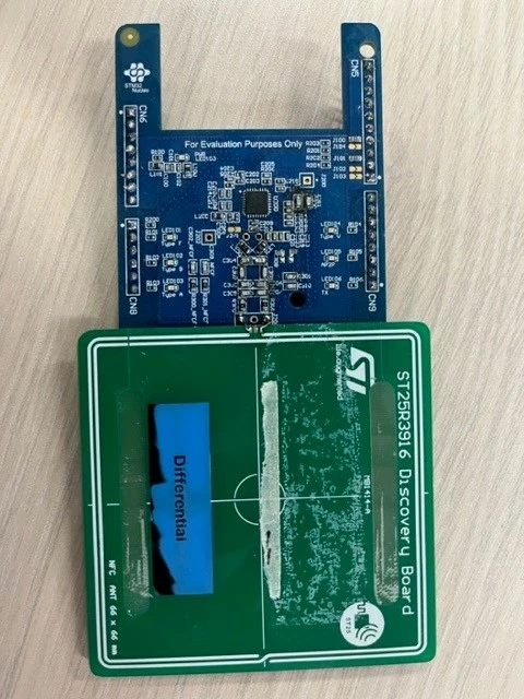

    Arimsa Has
    November 30, 2022
    Hi @Jørgen Greve​ ,
    On this picture you can see one example : the NFC06A1 board connected with 66x66mm antenna.
    0693W00000WJqNSQA1.jpgFirst step is to measure antenna parameters. In this app note (Antenna matching for ST25R3911B/ST25R391x devices - Application note) on the page 16 you will find all information how to measure antenna parameters of antenna. So values that you need for matching circuit depend on your designed antenna.
    After you have antenna parameter, you can use the "STMicroelectronics ST25R Antenna Matching Tool" to determine the matching components. (See page 27, 28,29 Antenna matching for ST25R3911B/ST25R391x devices - Application note ).
    I hope this can help you.

    JGreve
    November 30, 2022
    Hi @Arimsa Has​
    I am aware that you design an antenna and afterwards match it to the RF IC with a matching network, but that is clearly not the intended way to do it on the NFC06A1 board since there is no solder pads on the ST25R3916 side of the matching network.
    Both your picture and @Rene Lenerve​ suggest that the new antenna is soldered directly to the output terminals of the matching network. And since ST has not provided the necessary information in the documentation for me to do da that, I am a bit in a pickle.
    What is the intended way to attach a new antenna to the NFC06A1 board and why is it not properly described in the NFC06A1 documentation?
    Br. Jørgen
    Arimsa Has
    November 30, 2022
    Hi @Jørgen Greve​ ,
    There is no possibility to add additional components for the new antenna, as there is no spare/free pad.
    You will need to replace the existing matching components with the ones to make it suitable for the new antenna.
    Best regards
